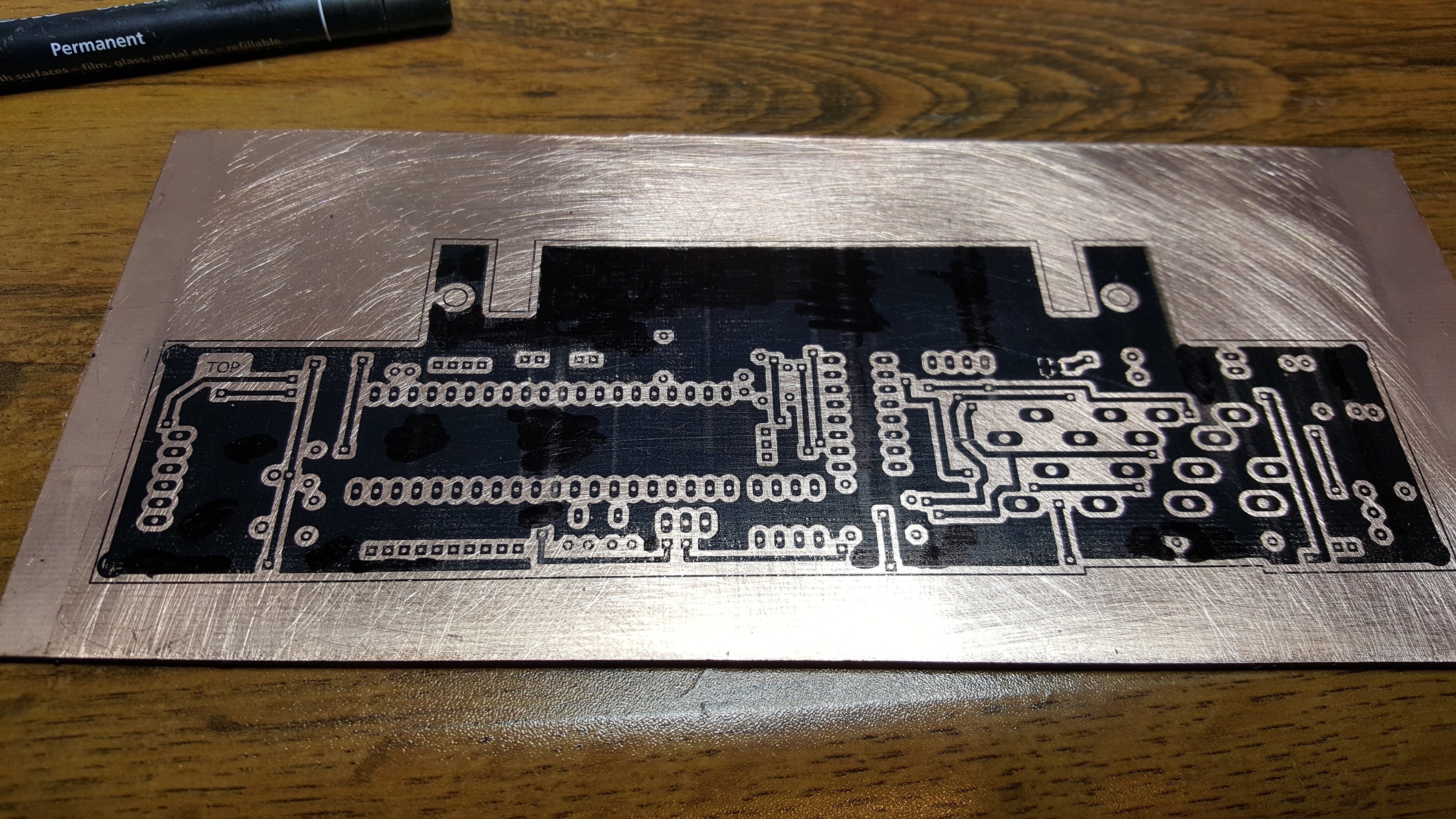

    Well, I'll praise you. After many attempts and something came out. I do not know why Eagle prints very poorly. The effects are just like in Eagle will print to PDF and then scream for the printer.
    No paths. The thinner they are, the better the blackening, and the thick ones do not come out very well. In the picture, the path is 8 mils, and unfortunately [with these dimensions some are already drained, so 10 mils is probably the maximum of this technology.
    Printing with a laser printer on a PCB laminate
    When printing this second tile, I "killed" the drum. :D

    I did 8 or even 7 mils between pads and it came out pretty. It is true that this "print wizard" in the Eagle is some kind of lip, especially with large tiles, strange things do, sometimes it also does not keep dimensions when moving away from the margins, etc., hence combines when printing with older versions of EAGL or PDF. The second thing is drums, and massaging the tiles. One of the drums, or toners, some "prefer" a perfectly smooth surface, other 400/500 paper. As for the amount of toner, try printing on a sheet, how it will print perfectly on a piece of paper, then print on a plate.
