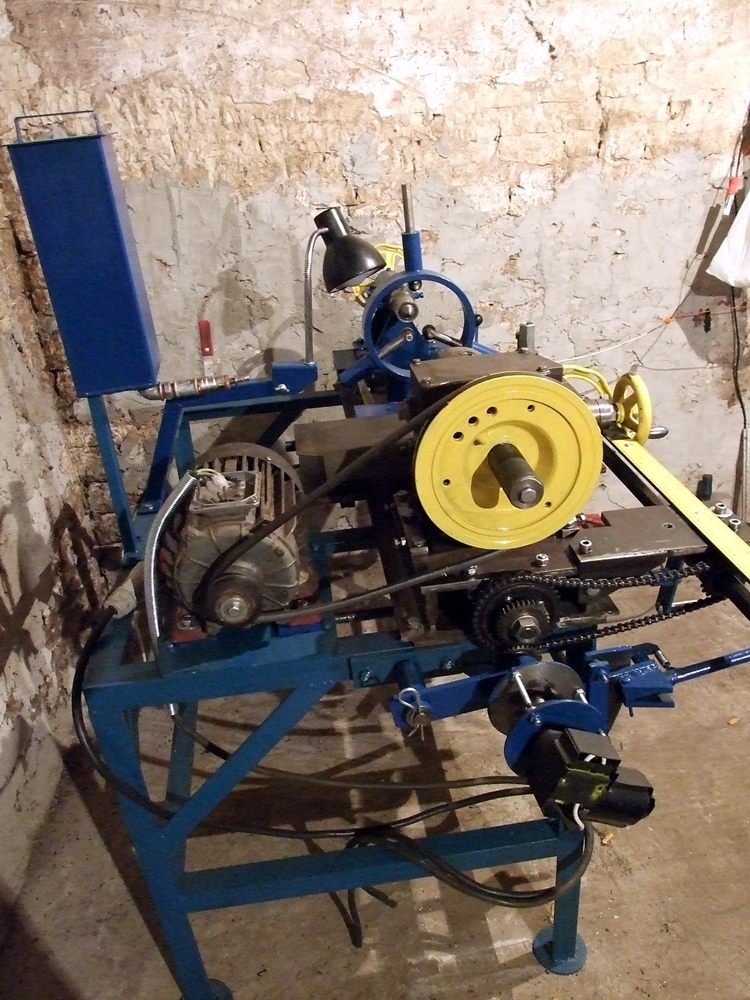

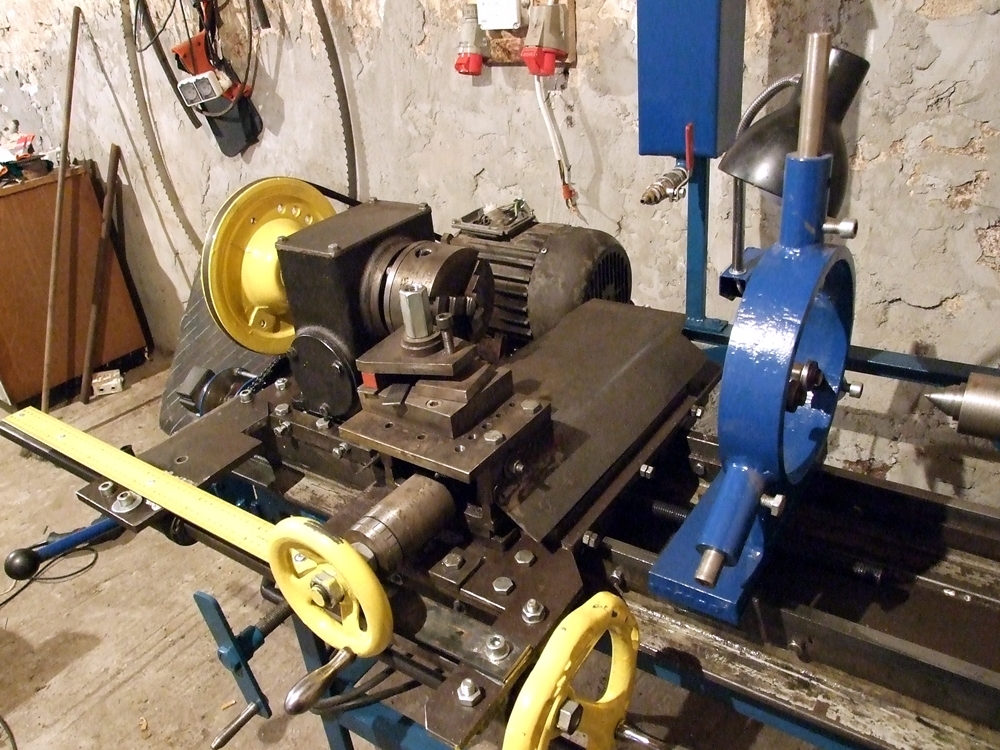

  • A DIY metal bench lathe was built from scratch for rolling, threading, and machining small parts like shafts, bushings, and washers.
  • The machine uses a spindle on two tapered roller bearings, a 3-phase 0.55kW motor with inverter, Tr20x4 lead screw, and custom bed, carriage, and tailstock.
  • Longitudinal feed combines 17z to 34z gearing with a 17z rack, giving 1 handle turn = 40.055mm, and threading setup covers metric pitches.
  • It can successfully re-thread small parts; for fi25 material, one pass reaches about 0.6..0.7mm at 0.05mm/rev, but it is not a factory-class lathe.

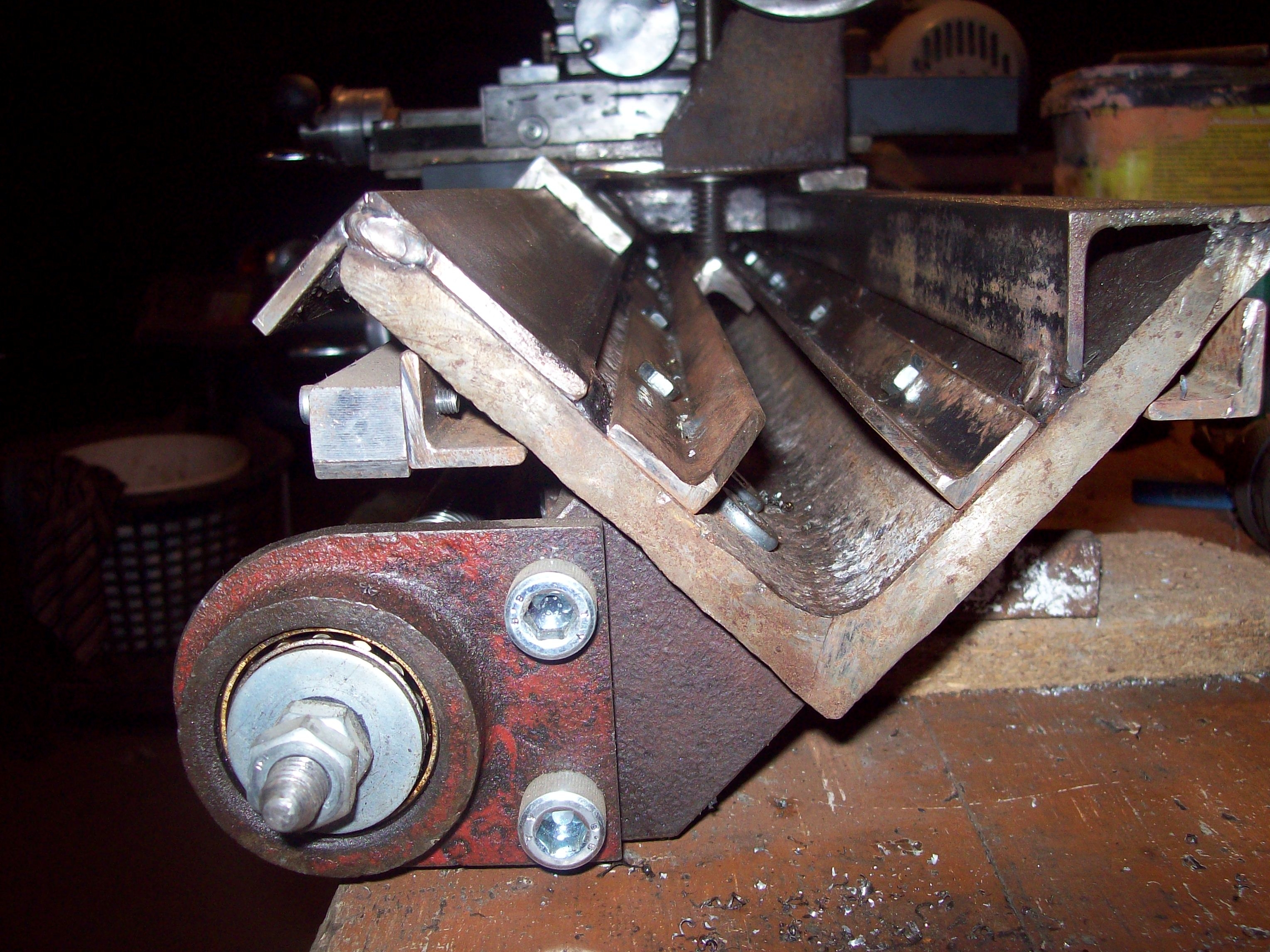

    I have a question about the material used to build the bottom bracket, is it the most popular structural steel (probably S235) or maybe some better material?
    How long have you been using this clipper and is there any problem with the bottom bracket guides getting stuck?
    I'd love to see the machine you grinded dovetail. I am curious how you solved grinding at an angle. An attachment or maybe an angular vice?

    I would not worry about scuffing because in every machine with exposed guides, they should be regularly cleaned of swarf and dirt and maintained (lubricated with oil). The machine will do its job for lighter periodic work, while continuous operation will wear out faster.
    The only thing I miss in this project is a real tool holder with the possibility of attaching 4 knives at the same time.

  • #36 16914120
    jalop
    Posts: 771
    Help: 40
    Rate: 204

    If so, where is the bottom bracket sealed to the bed guides?
    The center angles are for tailstock locking only.
    It is a pity that the author did not reveal / add up the cost of execution because they could be higher than the purchase of a larger machine for renovation (sometimes they are literally in the price of scrap metal).
    Hmm, if only I found some tsb in the "... scrap price" as you write, unfortunately the only one that I got was ZUCH probably 8M but I don't like this construction: a tube bed and a longitudinal support on a screw.
    I am not able to state the cost as I had most of the materials
    (recycled, from scrap, e.g. spindle, motor, inverter, bearings), e.g. an old damaged hydraulic jack (jack) was used to build the tailstock.
    Trapezoidal bolts and nuts as well as gears and a few bearings are so bought in a mail order store.
    In use since June, there is no problem with mashing (a brush and an oil can at hand), the material for the support is pieces of steel plates, what material - ??? but not some particularly hard one.
    Angle vise with guide attached to the table of the bench drill and angle grinder firmly attached to the spindle, lockable at a certain height, something like this video.
    Someone asked about the controller at the switch - there is no need to describe a simple system, the point is that after switching on, for example, the limit switch and withdrawing the support, it will not turn on automatically, but you need to turn it off and on again with a switch, such a protection against accidental activation.

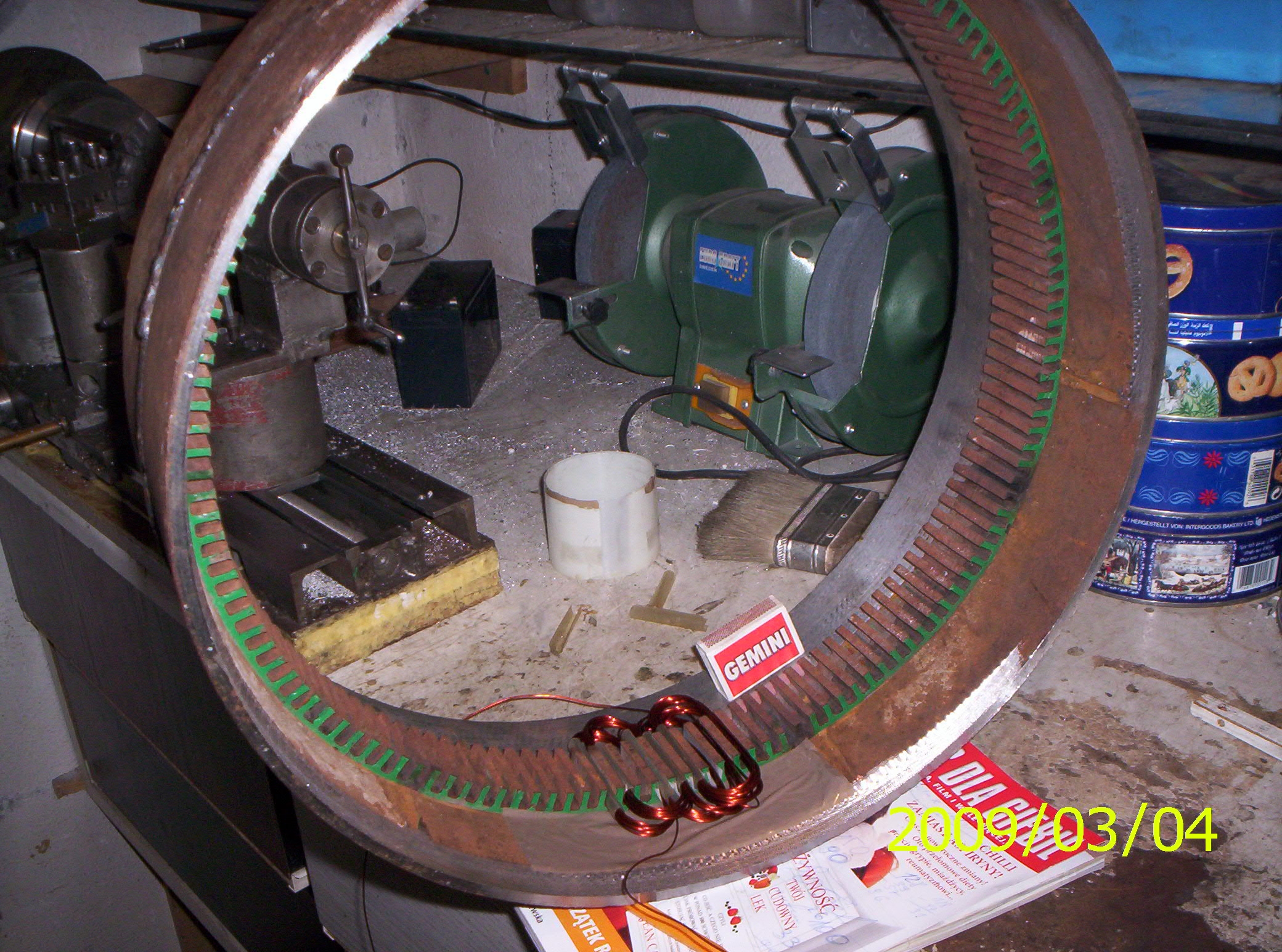

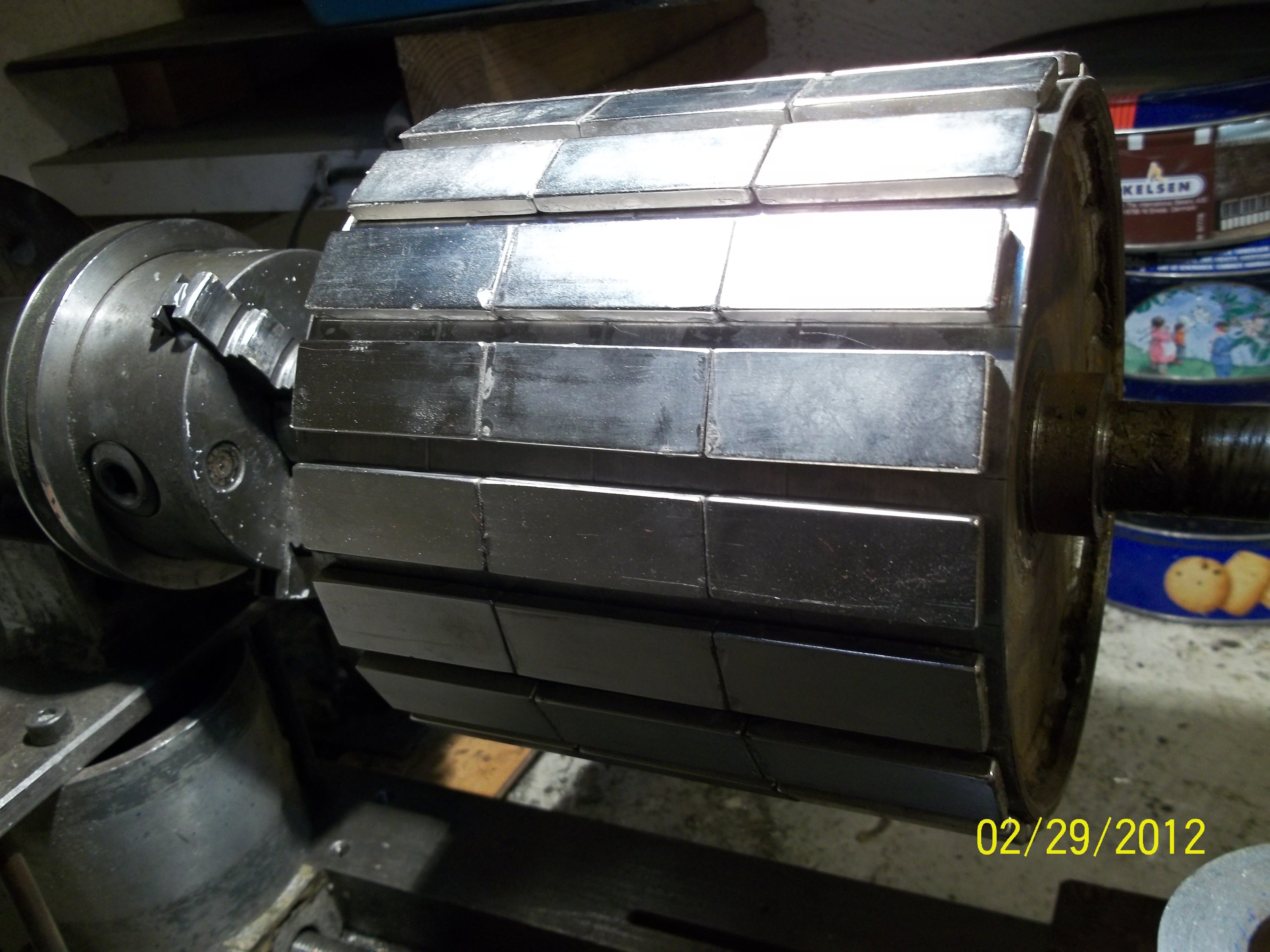

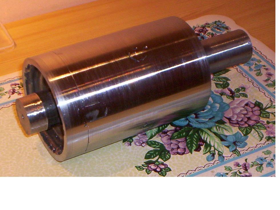

    Mine is better - made with a ball and file over 45 years ago, when the cheapest drill cost over a month my earnings.
    It rolls everything :D 400 mm long in centers and 200 mm turning diameter - suitcase, even side sled, guitar too.
    DIY metal bench lathe DIY metal bench lathe DIY metal bench lathe .
    Now also - I do not see a better one on the market.

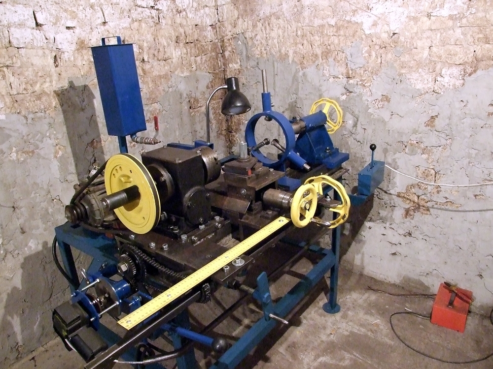

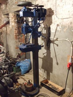

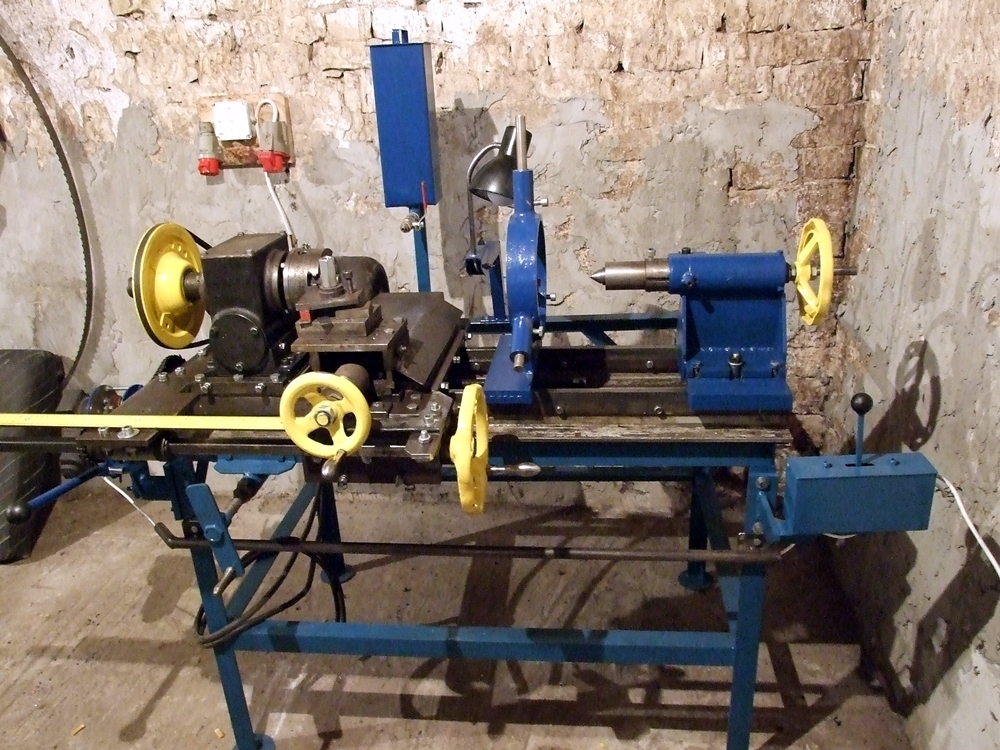

    Promised lathe pics.
    And a device called a pillar drill, the components of which I made on this lathe.
    All while moving to a new room.
    DIY metal bench lathe DIY metal bench lathe DIY metal bench lathe DIY metal bench lathe DIY metal bench lathe
  • #46 16935292
    Freddy
    Posts: 19997
    Help: 1394
    Rate: 2822
    The more well-known name is rather columnar :)
    This chain is a bit loose in photo no. 3.

    Well, there is a bit of a loose chain. I have been doing the tensioner for two years :D I mean, all the components are done, just put it together :D
