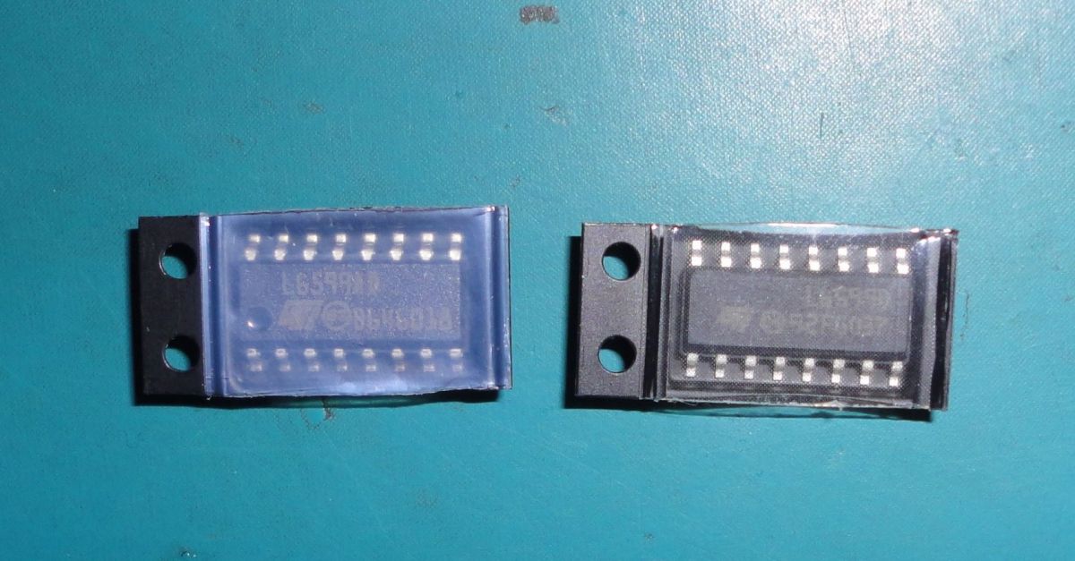

    Has anyone put L6599D there or others that I can have by Friday?
    I put L6599D and everything is OK, it so happens that I also could not buy the AD version and from the "Aledrogo" auction I bought 3 pcs of the D version; when they came, I didn't even notice that the seller gave me one AD and 2 pieces of D
    Hilti C4/36-350 Charger Issue: Green LED Flashing Every 2s, Battery Not Charging
    to sum up, both systems will work in this charger;
    if the diode does not light up, you have damaged IC2, and when it flashes for a moment, something sticks around IC1; remove keys chip IC1; check if its outputs are sticky; check diodes and capacitors for short circuits; search until the LED lights up and there is 13V, i.e. described above / earlier ... and when the LED is on, you can proceed to the assembly of IC1.
    I also could not buy the original insulated keys and how I dealt with it read above ... good luck

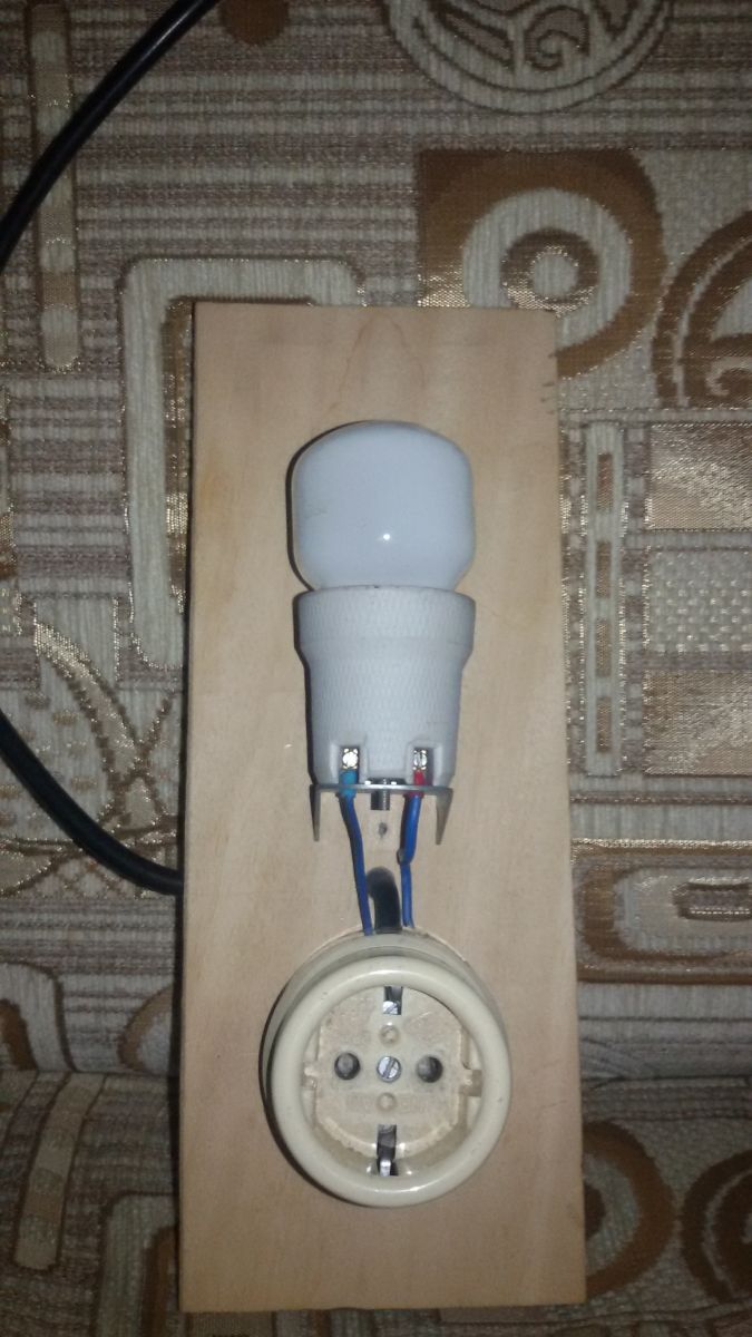

    şarj cihazlarını test ederken seri lamba kullanmanı tavsiye ederim bu sayede parçalar zarar görmeden denemeler yapabilirsin Hilti C4/36-350 Charger Issue: Green LED Flashing Every 2s, Battery Not Charging
    jumper kontrol edebilirmisin bazen sigorta patladığında kopma oluyor.

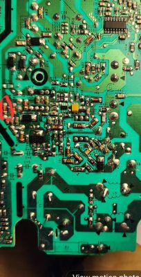

    marcocand
    Posts: 9

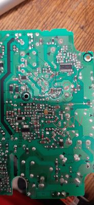

    I attach photos. Hilti C4/36-350 Charger Issue: Green LED Flashing Every 2s, Battery Not Charging

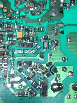

    Photo with zener diode position. Circuit board with marked Zener diode locations.

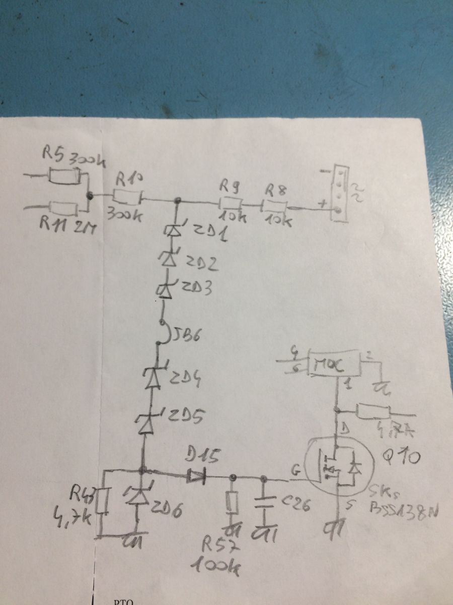

    >>20594619
    Hi, double check, because in my case Q5 is a MOSFET type BSS138N marking SK𝚜. I attach the diagram with Q5 and components connected correctly.
    Hand-drawn circuit diagram with electronic components, including a MOSFET BSS138N marked as Q5.

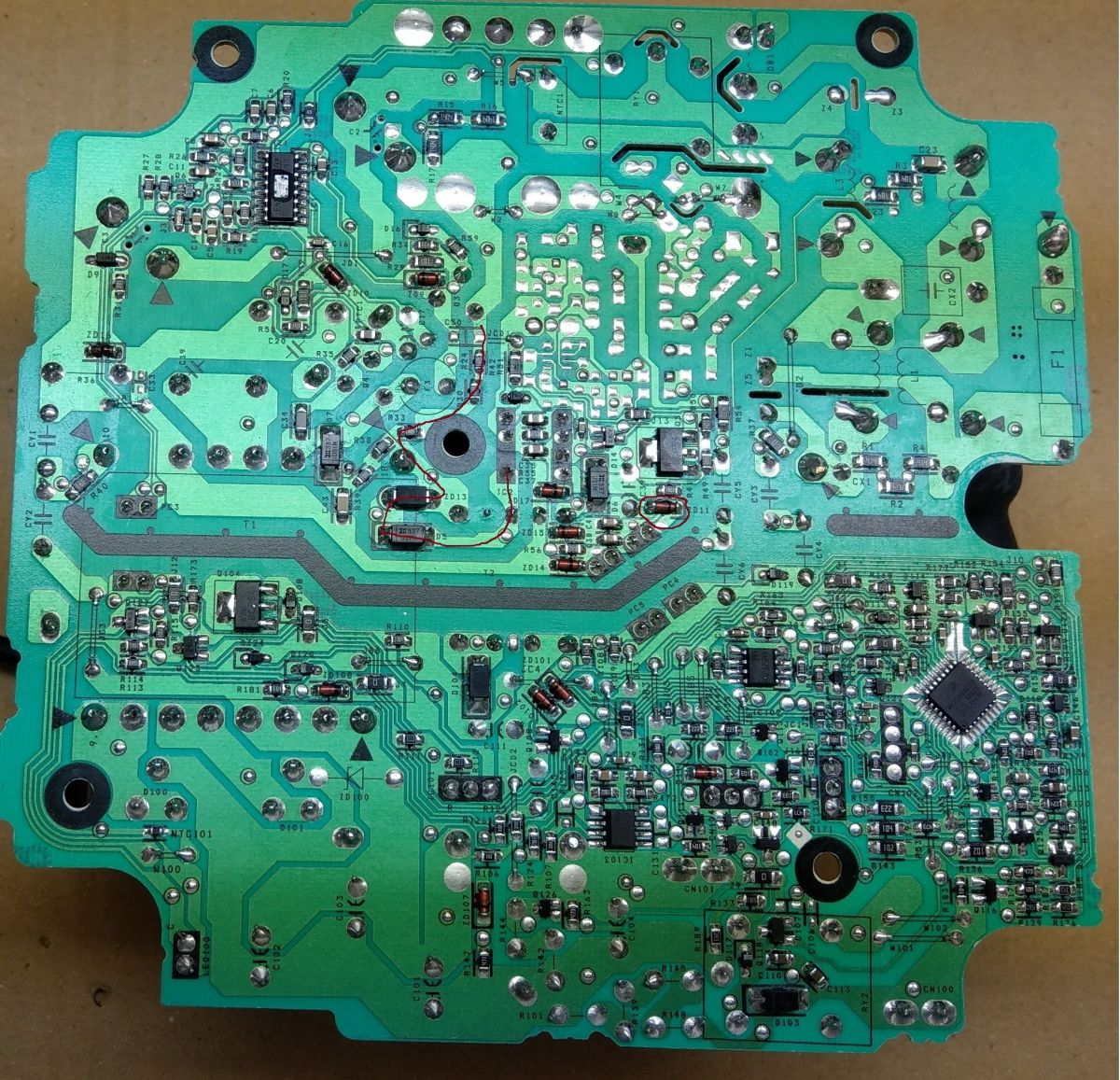

    Damaged parts: R36; Q3; Q4
    No voltage on IC2 pin 4 source ZD14 dead short
    Need the voltage of ZD14
    Added after 16 [minutes]:
    Circuit board with a marked component.
  • #115 20720876
    marcocand
    Posts: 9
    Rate: 8
    Hello, the value of Zener ZD14 is 11V.

    marcocand wrote:
    >>20594619
    Hi, check carefully, because in my case Q5 is a BSS138N type MOSFET with the marking SK𝚜. I am attaching a diagram with correctly connected Q5 and components.
    Hand-drawn schematic of a circuit with electronic components like diodes and transistors.
    In my case, the Q10 transistor is just shorted (kE or source-drain) and I don't know exactly what transistor it is, I think it's actually BSS138N marking SKs

    I have a charger again, and this time it's actually damaged from the ground up.
    Q10 is BSS138N marked as SKs, i.e. 60V 230mA 3.5Ω N-Fet channel;
    Note occurs:
    the most popular BSS138LT1G marked J1 and has slightly weaker parameters 50V 200mA 3.5Ω N-Fet channel;
    but we also have a more powerful player than the original, i.e. BSS138W 60V 280mA etc.
    diodes ZD1 to ZD5 are the same and they definitely have 15V because I checked, they may have above, but the laboratory power supply was temporarily missing, and the larger one is temporarily grounded because it is in a different place when needed;
    the ZD6 diode is probably 5.1V because that is how it is measured, but I will determine it later;
    I have a damaged D15 diode with "13" printed on it, according to the SMD circuits page it is a 13V Zener diode in a SOD-323 housing; but in my opinion it is not a Zener diode because it would be printed on the ZD board; it's some kind of rectifier diode but I can't determine the specifics;
    damage to the Z15 diode and the Q10 transistor blocks the operation of the Triac and it does not charge the main capacitor;
    continued soon...
