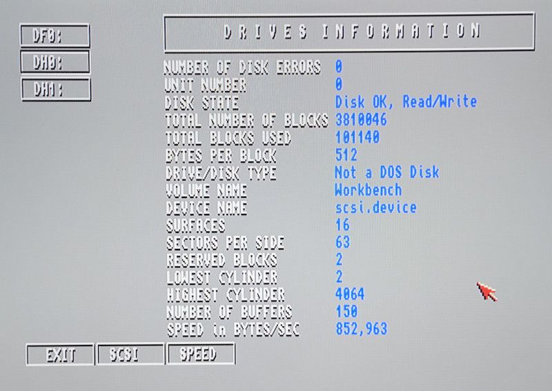

  • SD driver v0.9 adds multiple disk and PFS3 support
    #237 20677771
    piotr_go
    DIY electronics designer
    Posts: 2913
    Help: 94
    Rate: 3354
    Mikan v0.1.5:
    - PAULA reset fix
    - collision fix
    Driver SD v0.9:
    - obsługa wielu "dysków"
    - obsługa PFS3
    - nie trzeba patchować ROM'ów (zmieniamy nazwę załączonego pliku na "SD.ROM" i wgrywany z innymi)
    Option 1:
    Whole card is single Amiga HD.
    Remove card MBR and create partitions with HDToolBox.
    Option 2:
    1 card partition = 1 Amiga HD
    Card must have MBR. Primary partitions only.
    Choose partition type "F0" for Amiga RDB.
    Example: If your card have 3 paritions [fat12, "F0", fat32] disk order on Amiga side will be ["F0", fat12, fat32] (unit 0, 1, 2).
    Warning: Do not touch you FAT disks with HDToolBox.
    For FAT support install fat95.
    FileSystem = l:fat95
    Device = scsi.device
    Unit = 2 /* change unit number here */
    Flags = 0
    LowCyl = 0
    HighCyl = 0
    Surfaces = 1
    BlocksPerTrack = 1
    BlockSize = 512
    Buffers = 20
    BufMemType = 1
    BootPri = 0
    Stacksize = 4096
    Priority = 0
    GlobVec = -1
    DosType = 0x46415401
    Changes:
    - v0.9
    - multiple HD support
    - PFS3 support
    - ROM patching not needed
    • mikan_0.1.5.tar.gz (164.73 KB) You must be logged in to download this attachment.
