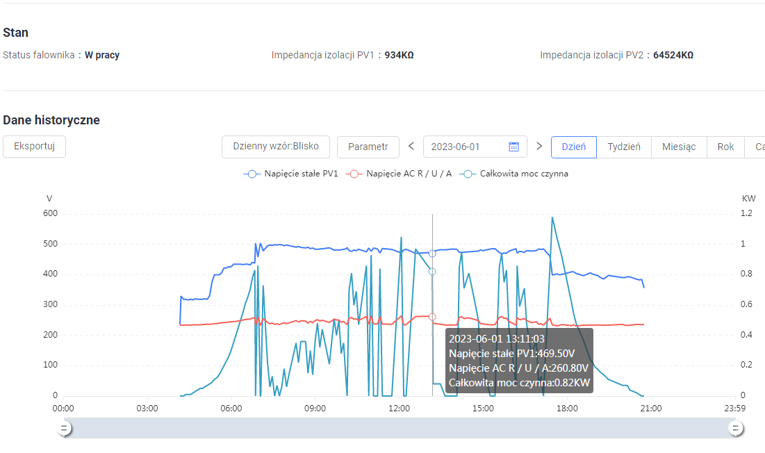

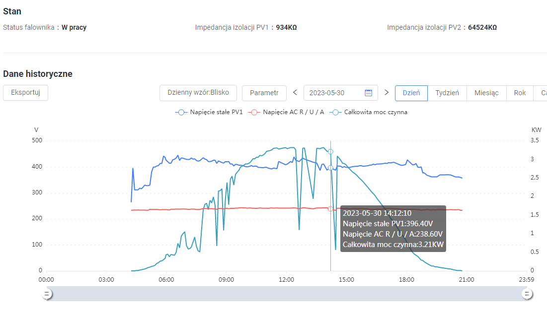

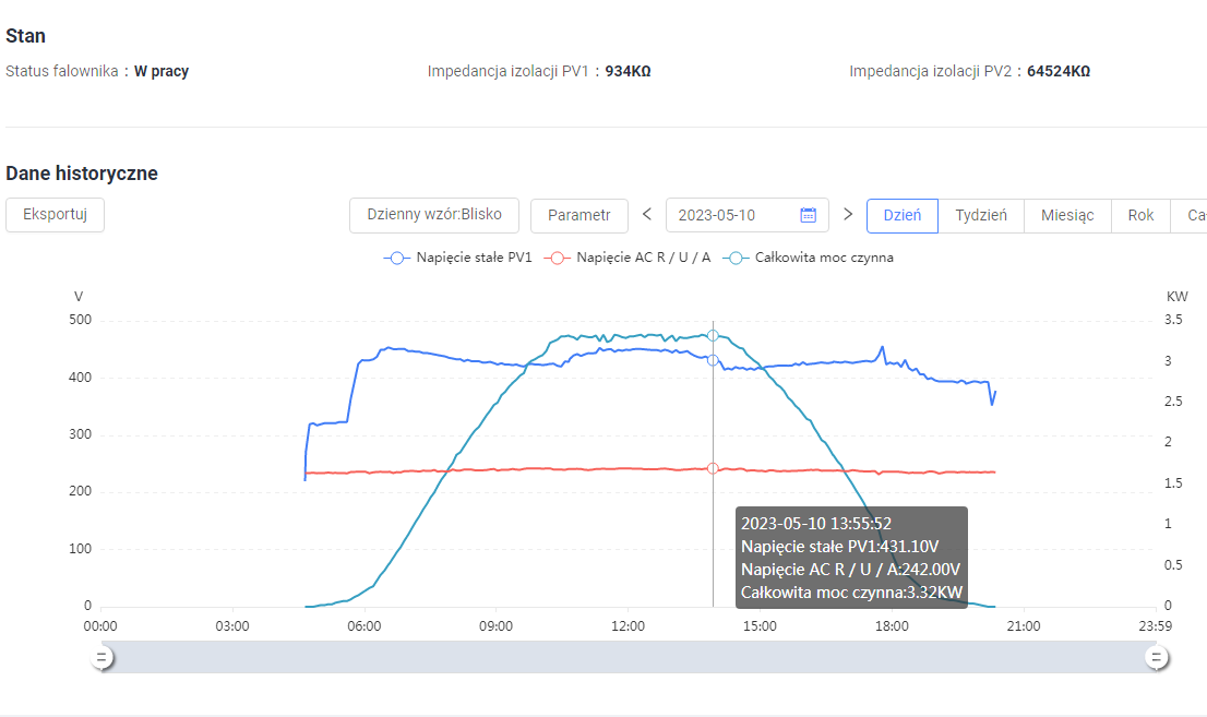

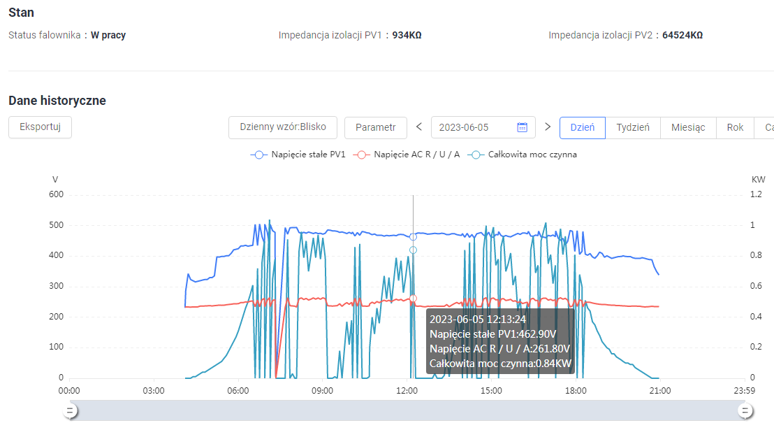

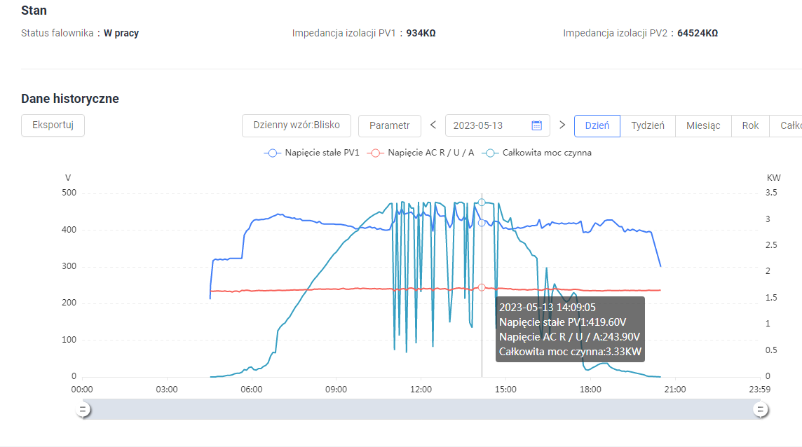

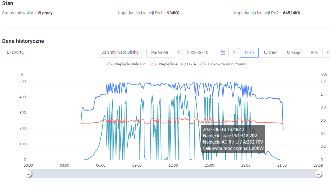

    I think there is some other reason. Until June 1, if there were inverter shutdowns, they were sporadic (I didn't even notice them) and the inverter developed full power of 3300 W around noon. Now it's completely different - not only the inverter constantly restarts, it also cuts the power to 1 kW. I do not think that something has changed in the surrounding network that so suddenly from May 31 to June 1 there were such drastic changes in the operation of the inverter. Maybe it will show some graphs from before June 1st
    SOFAR 8kW PV Installation: Opinions, Durability, Failures & Experiences with Inverters SOFAR 8kW PV Installation: Opinions, Durability, Failures & Experiences with Inverters SOFAR 8kW PV Installation: Opinions, Durability, Failures & Experiences with Inverters
    and some after June 01

    @tomasz.ryszard, however, it's the fault of the voltage in the network, in May you have ~ 244V and in June ~ 263V, which is too much, the inverter is supposed to turn off after exceeding 253V. You should have called the power company a long time ago to lower the voltage on the transformer. You should have 230V in the network, but the power industry reserves the right to 10% discrepancy (both ways), yours is much more. Check the AC voltage graph yourself, what is the lowest and at what times and when it exceeds 250V, if it happens in the morning (7-8) it is very bad for you.

    AT PRO wrote:
    If you have much lower in the socket at the same time, you may have poor connections somewhere or too small a cross-section of wires.
    I measured the AC voltage on the inverter connection cable (4x2.5 mm2 cable, cable length less than a meter) and the voltage is actually different than when I measured it in the socket. When the inverter is getting ready to start ("wait" message on the inverter), the voltage on this wire at the terminals in the AC junction box of the inverter is about 236V. 1 kW turns off. I don't understand something here. When the inverter is not working, the voltage comes to the AC box from the power grid and fluctuates between 236 - 237 V, which is correct and meets the standard (230 V +/- 10%) and I would expect it to come higher (over 253 V) and it, too high would cause the inverter to shut down. Meanwhile, it is the inverter, although the voltage in the network is close to the norm (237 V), it constantly increases the voltage along with the power it generates, until finally at about 260 V and reaching the power of about 1000 W, it turns off. The question is why it constantly raises the voltage if it is relatively low in the network and is it not a symptom of an inverter failure?

    If the inverter raises the voltage so much, there is something wrong with it, it usually only raises 2-3V.

    Exactly. It also seems to me that the inverter should increase the voltage coming from the power grid, but only by a few volts to cause the current to flow from the inverter to the grid at a higher potential than in the grid. So there are grounds to send the inverter for repair. Before I do this, I will check if the high voltage is affected by the VCX surge arrester located in the AC box of the inverter - I will just disconnect it and see if the voltage returns to normal while the inverter is running.
    Nonsense, it's the fault of the line and not the inverter, or there is no load on it or it has too high impedance, then the inverter gives power until the voltage is exceeded when it turns off, it's normal.
    You need to check the line, maybe the connections have come loose.
    Call an electrician to the Author, let him do a review and measure the impedance.

    The devil is always in the details. In fact, it is even better to check the line before sending the inverter for repair.
    Do you mean to check the lines: the cable connecting the inverter to the AC box of the inverter, the connections in the AC box of the inverter itself and the cable between the AC box and the bi-directional meter?
    I excluded the AC box as the cause of the voltage drop (apparatus and connections in it) because I connected the inverter cable directly to the meter cable as a test.
    I understand that for a bidirectional meter to record the current flow from the inverter to the power grid, the voltage at the meter's terminals coming from the inverter must be higher than the voltage at its terminals coming from the grid. So you need to check if there is no too high voltage drop on the above-mentioned line.
    Before checking the line, I will try to check the correct operation of the inverter by connecting a load (2 - 3 kW heater) directly to its AC box, thus excluding the lack of load (internal in the building or external - mains) and possible faults on the inverter line, meter terminals.

    When the inverter starts working, as the power increases, it raises the voltage from 236 V to 264 V and at exactly 1 kW it turns off.
    You have high line impedance. Turn off the inverter and load this line with a 1kW heater. The voltage will probably drop by the same amount as the inverter picks up when it shuts down. If so, you have loose wires somewhere in the connector.
