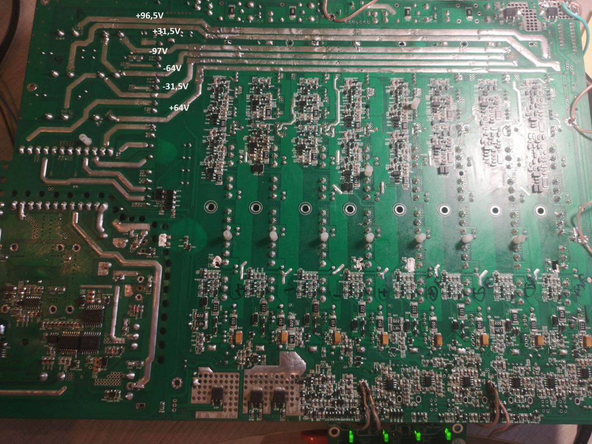

    I was able to sit down on the weekend, so here's my report - 2 channels already covered. Waking up was caused by a corrosive grommet leading to the R171 (I feel that in this copy I will have more such surprises because it turns out that it was lying somewhere in a damp room). There were the last 2 to be taken - the ones that were stoned. Have any of you figured out what the signal control at the end looks like? I mean the connections of opamps - because the outputs from those responsible for the burned out channels have 2 times lower amplitude of the output signal than the efficient ones (with the same input). I am posting the photo for which there was a request. Hope it helps :)
    T.amp TSA 4-1300 Power Amplifier Issue: Not Turning On, Red Diode Flashing, No Visible Damage

    Krzychu1843 - good job, one thing puzzles me - the converter for two IGBTs probably does not give full voltage to the trafo, because your measurements show that the maximum voltage available for the power amplifiers is 97V [H3] symmetrical, so the maximum power for this voltage is ~ 580W for 4 ohms, unless you don't know something :) .
    As for the op-amps - I did not have time to do this this week, but I have a similar problem (as described above) - constant 200mV on the CH2 output despite removing the CH2 power block and strange power supply - all op-amps +/- 15V a op -amp from the released + 15V / -12V channel, i.e. something shortens on this line. After removing the suspect op-amp, the power supply is still about this value, so it's not the op-amp's fault.
    A request for one more measurement - auxiliary voltages, if you could measure it, it would be great, I mean the +/- voltage on the conduits on the SMD bridge.
    Kind regards

    Yes, the converter may not give full voltage (I also wrote that I do not know if it will help you :) ) but its value is quite enough to make the amplifier fully functional. From what I remember, the auxiliary voltages fluctuated within + - 13.8V for me. I am waiting for the electrolytes that are responsible for powering the opamps in the damaged channels (the original ones were really hot, so for the sake of peace, I prefer to replace them) and I will take a measurement. I will also put the voltages at the full converter, but I prefer to embrace the other channels first - it will hurt my pocket less than it shoots 2 igbt instead of 4 :P
    Added after 4 [minutes]:
    Do you mean measuring on capacitors after rectification from EF8 diodes? If so, the output from the capacitors is + -15V - even :)

    Oh crap, +/- 15V? It's a bit strange because there are 7815 and 7915 on the way to opamps, they can function with such a low auxiliary power? Stupid question but I encountered different behavior of the 78xx series rulers when the power supply is too low.
    Regards
  • #128 18431355
    Krzychu1843
    Posts: 52
    According to the documentation, it's true - there should be 2V more than the output, but it works - it gives the output what it gets at the input. Operational amplifiers do not have any problems when operating with a slightly low voltage, so there is no point in trying to mess around. Probably after bringing the inverter to the original, the supply voltage will increase (so the stabilizers will start working as they should).

  • #150 18506081
    kudlatyy1
    Posts: 104
    Rate: 45
    I gave up, I bought two-channel modules from the Chinese, two pieces, 60v power supply and 300 watt power and now the question is whether a 1500 watt converter is enough ?. As if someone would need some parts to write boldly.
