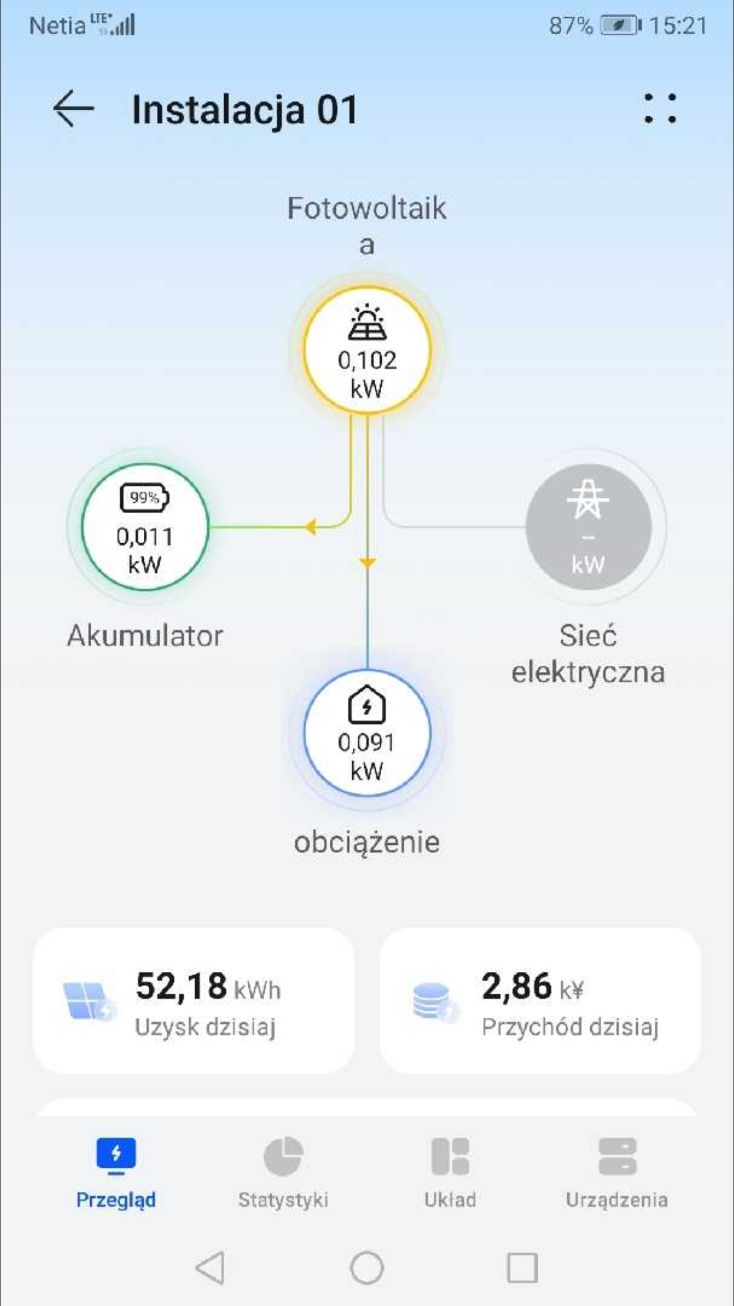

    We with a colleague are playing with Sun 10KW and Luna x2 plus slightly converted BackupBox (plus 15KW on the panels). Well, and we would not like to damage it too much.
    Added after 30 [minutes]:
    Men. Interestingly (phone call just now) at a buddy's place in OffGrid mode and during the day (when there is production) Luna charging works - that is, the above-mentioned combinations with aggregates are pointless.
    Solar system application screen showing power and energy values, including battery charge and load.
    It's a weak charging (because the battery is almost full) but, as you can see, the city grid is disconnected, the inverter is in OffGrid mode and yet it charges Luna and gives electricity to the house.

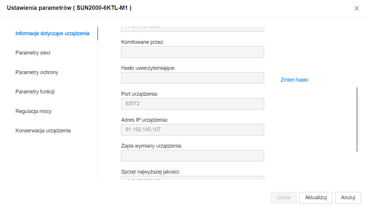

    When adding the inverter to the installation, I changed the password, but unfortunately I don't remember what it was. Is it possible to change this password while logged in via the browser (as an installer)?
    I only found something like this
    Screenshot of the inverter settings interface with an option to change the password.

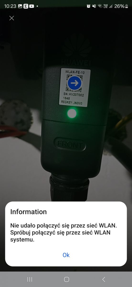

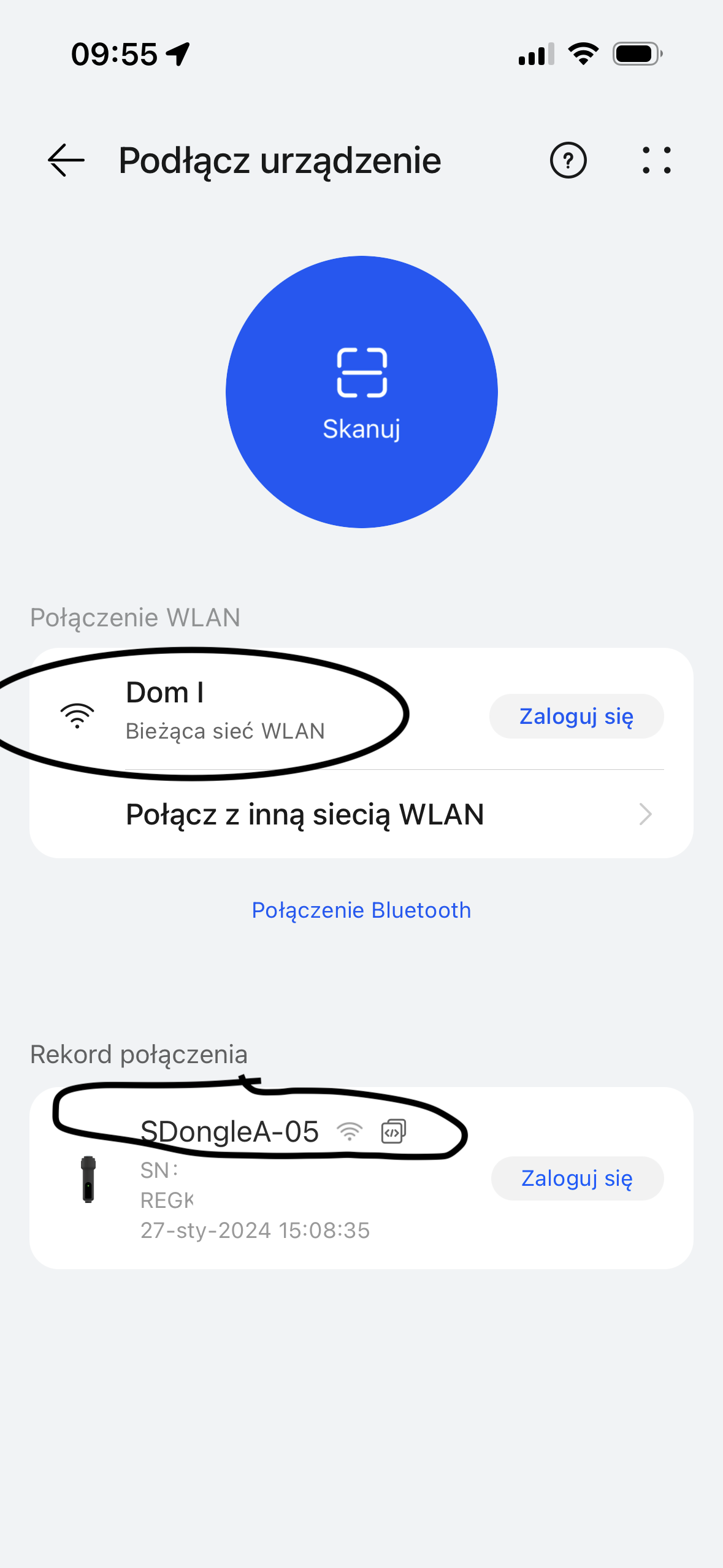

  • #1194 20963798

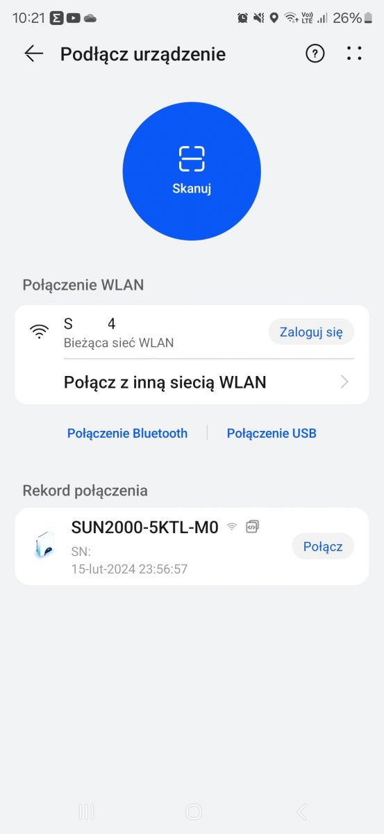

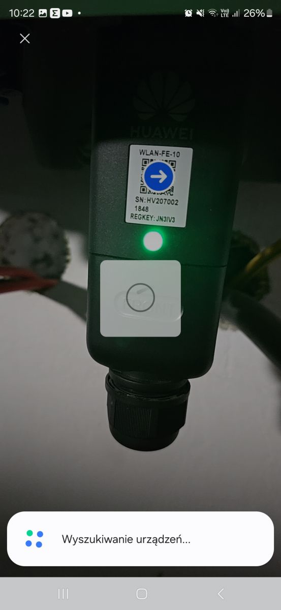

    Hi,

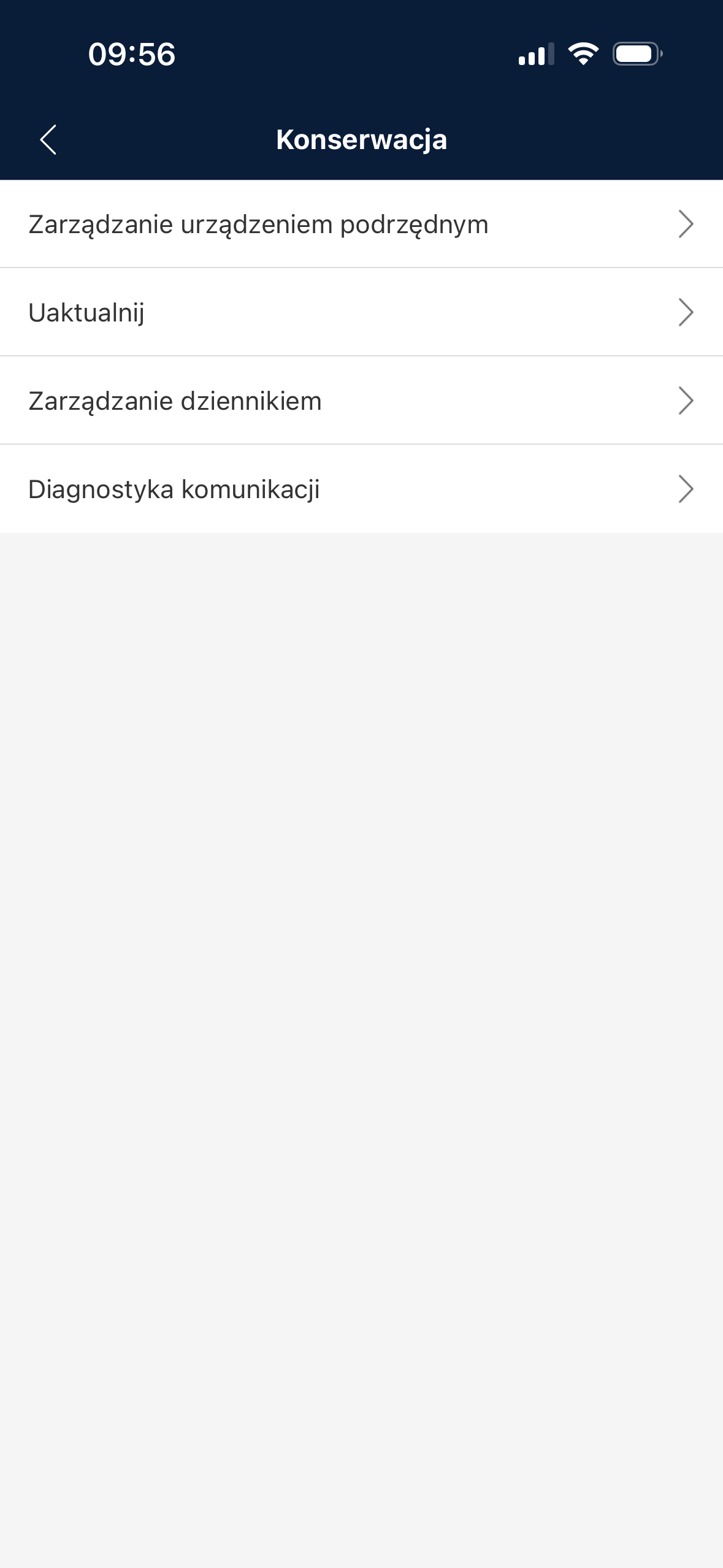

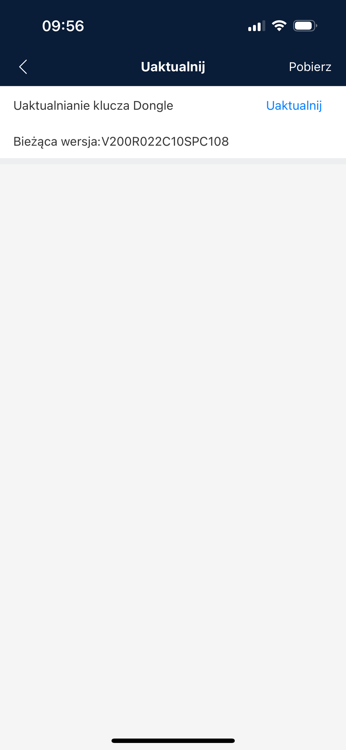

    Is it possible to update the dongle using the current version of the FusionSolar application? I used to be able to connect to it normally by scanning the QR code, but for some time now I can`t :/ I log in to the inverter normally.
  • #1195 20963870
    xszuflax
    Posts: 53
    Rate: 7
    Hi,
    When you are connected to the same WiFi network with the dongle, you can find it via the FusionSolar app. On the bottom bar, go to "Services" > "Putting the device into operation".
  • #1196 20963876

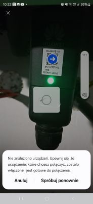

    Hi,
    should I be connected to the same wifi network that the dongle is connected to? Should I be connected to the Wi-Fi network that the dongle broadcasts (and probably only a moment after turning it on?)?
    If it`s the first one, I tried it and it couldn`t connect (it connects to the inverter). I will take a screenshot of this message later, maybe it will help :)
  • #1197 20963882
    xszuflax
    Posts: 53
    Rate: 7
    To the same one as the dongle is connected:

  • #1198 20963927
    szeryfff
    Posts: 997
    Rate: 43

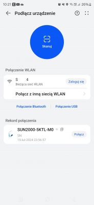

    I don`t have a dongle on the list of devices (because I couldn`t connect to it), so I scan via QR, and after a while I get a message that no devices were found. If I click "try again", after a while another message appears, and when I click OK, it takes me to the WiFi network, and the dongle now does not broadcast its WiFi because it is connected to the network.
    About half a year ago, when the application looked a bit different, I connected without any problems.
    Screenshot of an app for connecting devices via WLAN. Huawei device with a QR label and button on the casing, showing a green LED light. Huawei device with a label and illuminated LED indicator, along with a notification about no devices found on the phone screen. Display showing a Huawei device with a WLAN error message.
  • #1200 20963976
    szeryfff
    Posts: 997
    Rate: 43
    I saw such options once, now I don`t see them, I have to look better :)
    I don`t have an installer account, so I can`t update via the website :/
