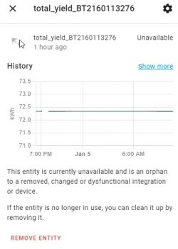

    Sesjusz
    Posts: 35
    Below what it looks like after opening the entity. I've been working on it for a long time, something I probably don't know, or maybe something wrongly entered in the scripts :(
    Of course, in the information in the application from Huawei, it normally shows production.
    - Only this data displays from yesterday the same:

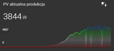

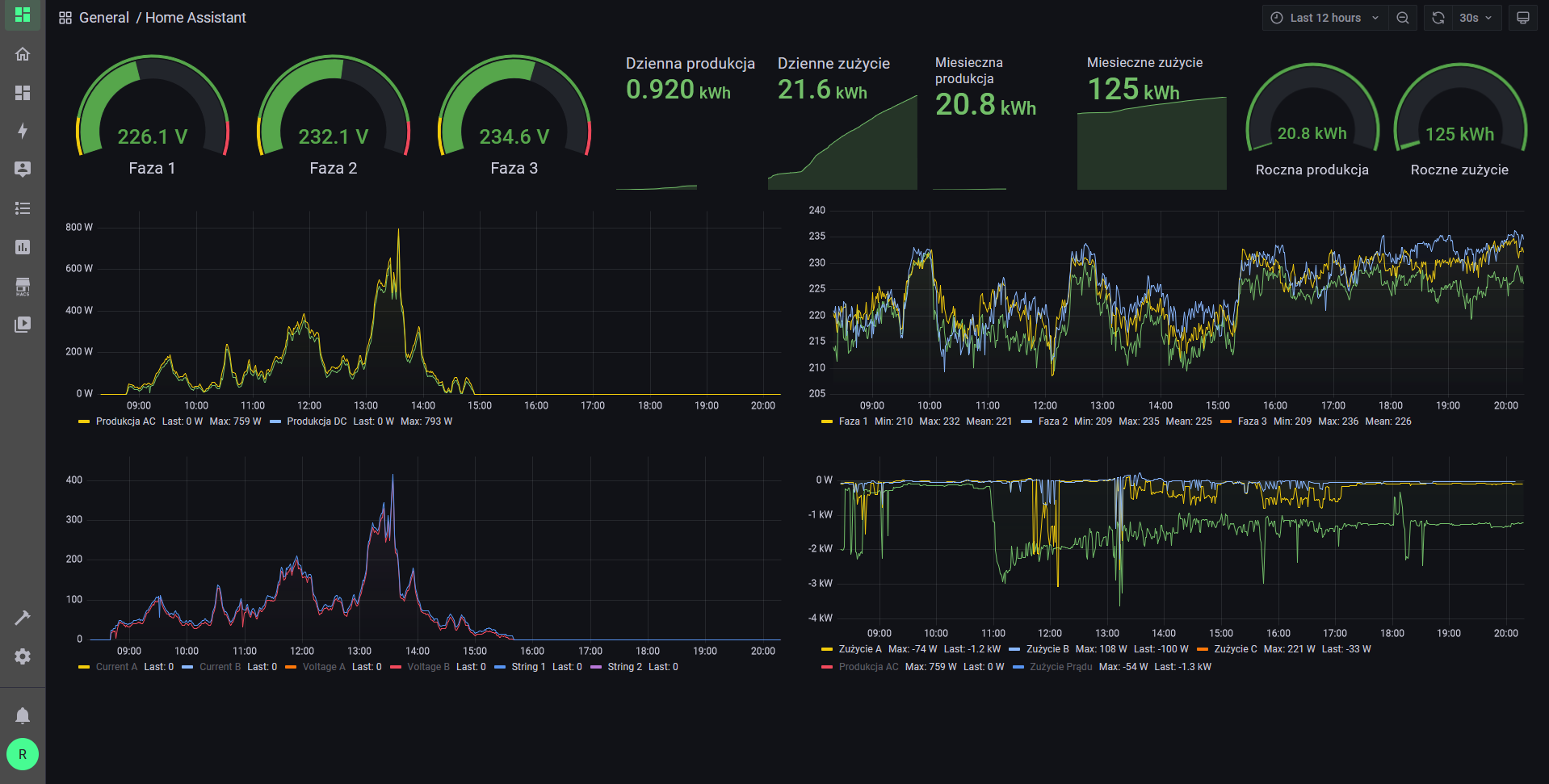

  • #427 19801245
    akir19
    Posts: 38
    This is what it looks like here Huawei SUN2000 Inverter: WIFI Dongle Connection, Firmware Update & FusionSolar
  • #428 19801272
    Sesjusz
    Posts: 35
    Akir, it looks beautiful.
    Could you please send your configuration in a free moment? :) I have no idea what is wrong with me. Do you have the latest dongle firmware * 126? And inverter * 140?

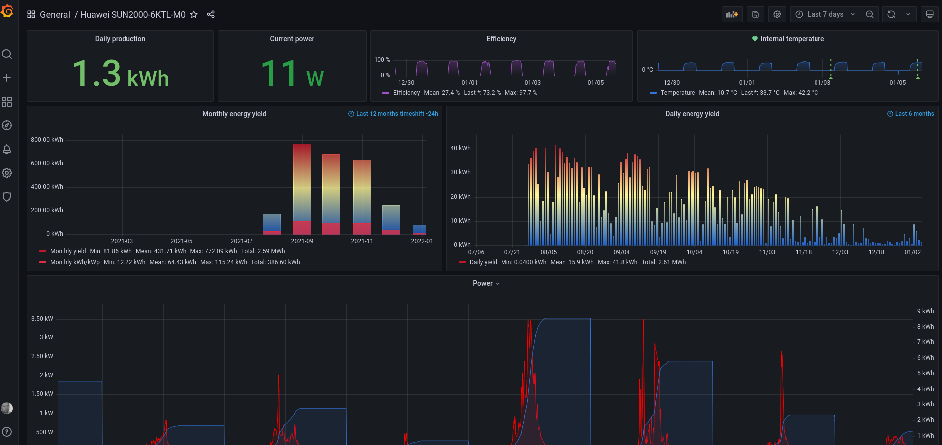

    @Session, if you are still struggling with this and you want to eliminate the wrong home assistant configuration, you can try my hard-a .
    This is my automation program that can monitor most of the SUN2000 parameters.
    The HA is probably cool for some applications, but I preferred to keep it simple.
    The program in the appropriate configuration, on the one hand, connects to the SUN2000 over TCP / Modbus, and on the other hand, it puts the data into the graph. I don't think it could be easier :)
    I make a chart for myself from it:
    Just in case: configuration description here

    akir19
    Posts: 38
    I am not a fan of charts, I saw on some home assistant forum our compatriot wrote down the charts beautifully.
    sensor:
      - platform: huawei_solar
        host: '192.168.0.161'
        optimizers: false
        battery: false
        slave: 1
      - platform: template
        scan_interval: 1
        sensors:
          daily_yield:
            friendly_name: "dzienna_produkcja"
            value_template: "{{ state_attr('sensor.sun2000_6ktl_m0', 'daily_yield') }}"
            unit_of_measurement: "kWh"
    etc. with other sensors available from the sensor.sun2000_blablabla entity
    in each version of the firmware of the phono and dongle it works the same.

    How to make a template to count the production from the last month?
    I still have a problem, I add a battery to the installation from time to time. I've already done two updates and the problem still comes back. Anyone met with this?
    • Huawei SUN2000 Inverter: WIFI Dongle Connection, Firmware Update & FusionSolar Screenshot_2022-01-08-08-40-12-36.jpg (271.74 KB) You must be logged in to download this attachment.

    I will only add my three cents, because I also have an inverter connected with HA, that all these charts look cool on the screens and I was also fascinated with them before they connected the panels to me, but in the end I'm from people who look there several times a day (I have PV 2 weeks maybe it will pass :P ) and looking at these graphs I would simply get nystagmus. There is nothing like a simple and clear card with delicate graphics, designed by a friend whose source code has already appeared in the posts above.
    I am still waiting to connect the dtsu666-h meter, hence the nonsense at the top of the picture.
    For this simple chart colored according to current power and everything on a tray.
    Violet and orange over the blue one, I greet the perceptive ones :)
    EDIT: There were questions about the card from the first picture - as I am not its author, please refer to the place where the author published it:
