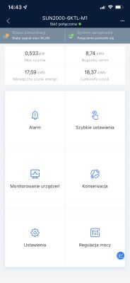

    I have a question that I have not found a clear answer to. I would like to connect to the FusionSolar app via a dongle network, not an inverter network. It's mostly about range and convenience. The inverter has FW V100R001C00SPC140 and the dongle V100R001C00SPC126. I have just turned on MODBUS without restrictions (I did not restart the inverter). When trying to connect via FusionSolar, he gets the login screen and enters the installer password, but he gets the error "Unable to connect. Try again" of course, the password works when connecting via the inverter WiFi in both FusionSolar and SUN2000.
    I will add that the network scanner sees the IP with the 502 TCP port open, so I assume that MODBUS works OK:

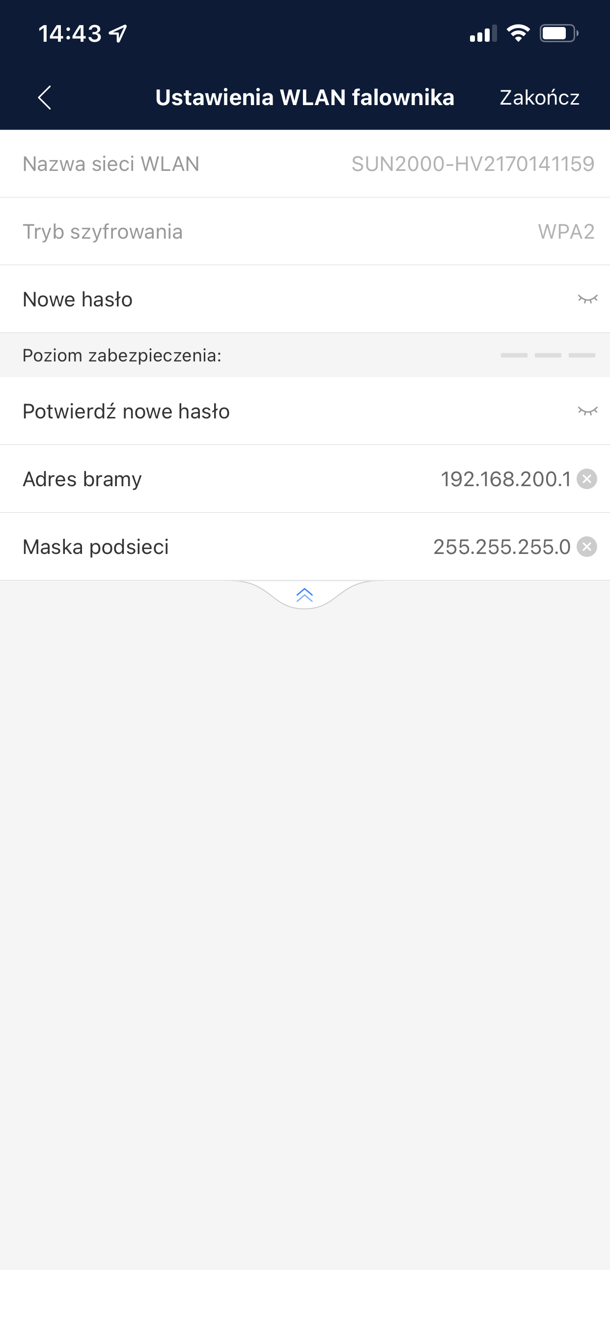

  • Dongle login screen uses default 00000a password
    #468 19833489
    xszuflax
    Posts: 53
    Rate: 7
    I think I found the answer to my problem. It turns out that the login screen that I see in the FusionSolar application when I connect to the local network (so-called through the router) is the dongle login screen. The standard password is 00000a and you can update the firmware there. From what I read, it is impossible to connect to the inverter itself in the "Putting the device into operation" option via the router. Either the inverter AP or the FusionSolar website (of course, some settings are missing: modbus etc.)
    If I am wrong, write to me, my dream is to connect to the inverter in "Putting the device into operation" via a router :-)
    Greetings,
    Marcin
    I do not know about you, but in this option I connect to the inverter via the router, the login password is, if not changed, the standard 00000a.
    For this to happen, you must have a home WiFi network set up on the inverter, the same way as I connect using the SUN2000 or FusionHome app.
    When you connect via the inverter network, you must be within its range, i.e. at the inverter, when connected via a router, it is enough to be within the WiFi range of the router.

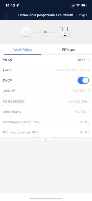

  • Clarifying inverter home network setup via dongle
    #470 19833680
    xszuflax
    Posts: 53
    Rate: 7
    Can you tell how you have set up your home network in the inverter? I assume that the inverter connects to the home network via a dongle and only issues the AP for local connections (not via a router). I assume it works because the data is sent to the FusionSolar portal.
    I have already deleted the apke and installed it again (iPhone v 5.7.065 apk) and when I am logged in to the installer accounts (FusionSolar System, not to be confused with local accounts on the inverter). for operation "
    Thanks
    MT
  • Check router connection settings in inverter menu
    #471 19833761
    rokbok
    Level 40  
    Posts: 4386
    Help: 646
    Rate: 1027
    I will not help you in this topic, I do not have a dongle, but only a built-in WiFi in the inverter, so there may be differences.
    Maybe someone with a single was reworking the topic and will say something.
    Maybe try to log into the inverter, select Settings -> Communication configuration, is there an option Router connection settings, that's where you set the SSID and password of your WiFi network.
  • Home network access to inverter AP range

  • Inverter AP settings verified on built-in WiFi
    #473 19834058
    xszuflax
    Posts: 53
    Rate: 7
    lizak1983 wrote:
    I have such an AP connection at home, an inverter -> router (bridge) -> switch, and a home network connected to the same switch in a different address class (such a combination to access the inverter from the Home Assistant level) and when I assign an IP address on the phone in the AP range of the inverter, I do not need to be connected directly to the inverter to connect to the sun2000 application, it is enough to be connected to the home network.
    Well, it's a mega combination of connecting two networks from other subnets to the switch. And it was not easier to put MODBUS on donglu. It seems that on FW 122 + you can do this and then HA talks on MODBUS with a dongler in the same local network, aka home.
    Added after 4 [minutes]:
    rokbok wrote:
    I will not help you in this topic, I do not have a dongle, only built-in WiFi in the inverter, so there may be differences.
    OK, I went to the inverter AP to verify the configuration. IMO settings are correct, however, this connection is made by a dongle even though they are set in the inverter:

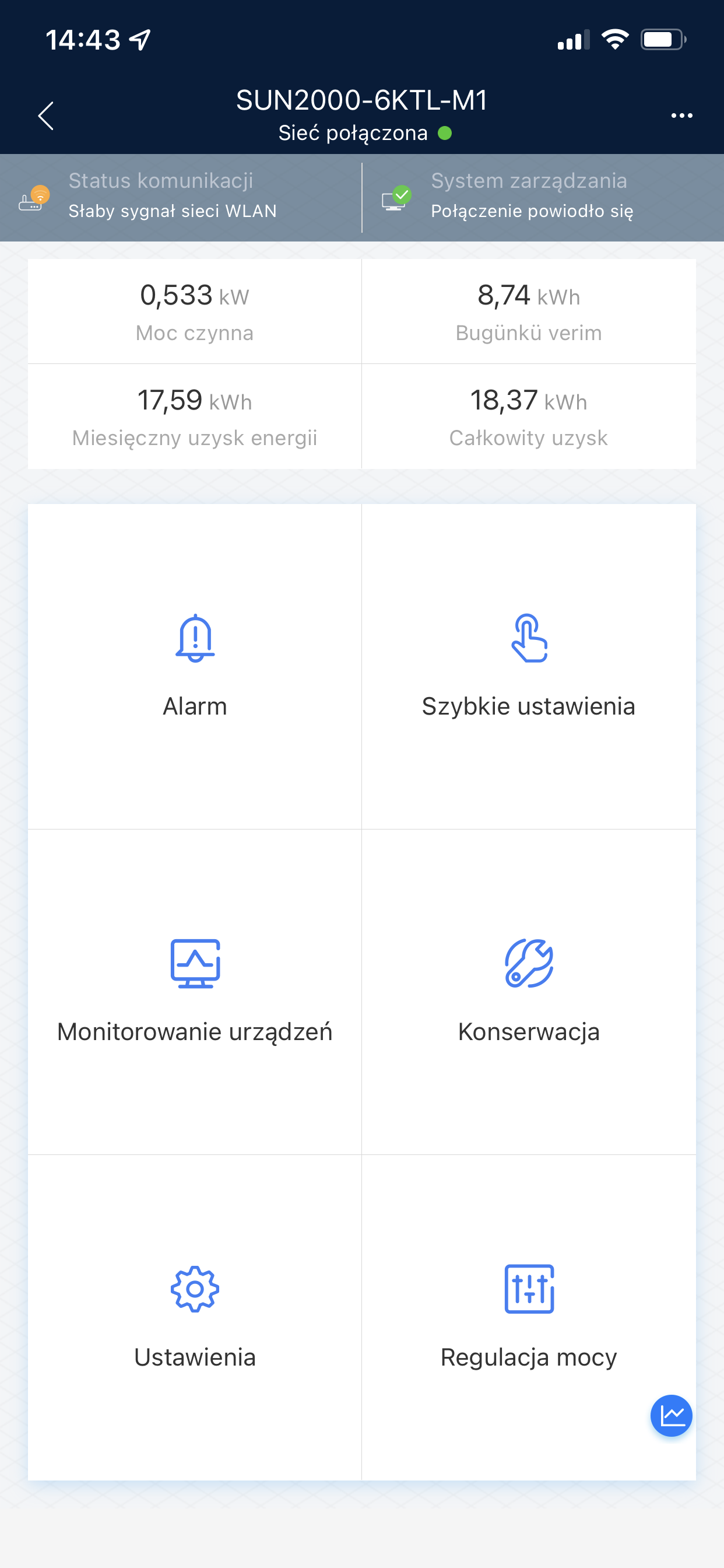

  • Dongle connection proved slower and less stable
    #474 19834146
    lizak1983
    Posts: 133
    Help: 5
    Rate: 36
    Maybe a combination, but I had an unnecessary additional router, and as I set it up almost two years ago, there was no other way to connect the inverter with the HA. As soon as it was possible to connect to the dongle, I tested it, but the communication is much slower with the dongle and less stable, so I went back to the additional router.

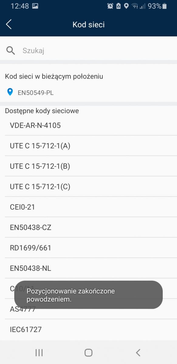

  • Default en-50549-pl settings are sufficient
    #475 19834858
    xszuflax
    Posts: 53
    Rate: 7
    Hi,
    I have already agreed with the configuration of the inverter by AP. But I wanted to ask if there are any options that should be set for the SUN2000-6KTL-M1 inverter with Ulica panels with a total power of 6.4 kWp (2 MPPT, 3.2 kWp) in the Tauron network. Installation on the roof from the south, the angle of the roof is 40 degrees. Generally I have the default settings with the profile of the electric network en-50549-pl. I don't have optimizers.
    In general, the installers were poorly able to start up and configure the inverter and when I saw that they had a problem with entering the WiFi password, I decided to configure the device myself. Anyway, it paid off, I have my installer account and I set up the networks myself. The scary thing is that hardly any team changes AP passwords and default system passwords.
    Greetings,
    MT

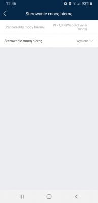

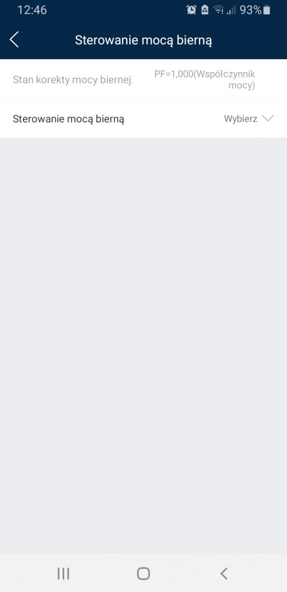

  • Grid voltage rise likely causing inverter cutoffs
    #477 19838744
    xszuflax
    Posts: 53
    Rate: 7
    qrko wrote:
    In our street, 10 houses have PV and when the sun is shining, the graph resembles a hedgehog. Tauron wrote back to check the reactive power compensation settings (what do you have set on your Huaweia?) But I have a flip that it is helpdesk gibberish.
    In Poland, if you want to have something very well done, you first need to educate yourself and become an expert for a given investment. Something that I am discovering and practicing in connection with photovoltaics.
    As for your problems, there may be many reasons for this, but if such jagged graphs appear in all of your neighbors, it may be due to the outdated infrastructure of Tauron in this area. A single thread without the possibility of dispersing the energy you produce to other recipients. And, of course, by raising the voltage on the grid by your installations. Basically, the network should be around 230V, but for your installation to be able to return energy to the network, you must supply a higher voltage and so on to each of your neighbors. When you bid like this, you get to 253V and at this point the inverter cuts off the production. The tension drops and the bidding begins again.
    The Sun 2000 inverter itself has a lot of settings, but nowhere have I found a study of what it is for. Of course, there is an instruction, but a lot of settings are specific to the installation (panels, the angle of the panels, the side of the world, etc.) but also to the operator.
    Greetings,
    MT
  • Questioning inverter grid-code and reactive power settings

    qrko wrote:
    For me it looks like below, I am a bit surprised that the app suggests a different setting based on the location (I have selected VDE-AR-N-4105, and it tells EN50549-PL), the question is whether it has a current base and how safe it is to change it to your own.
    As I understood the topic, the EN50549-PL profile is a new thing and it was not there in earlier versions of FusionSolar. I have it set to EN50549-PL. I passed this information to a nice gentleman who mentioned the meter to me and he said that it was OK.
