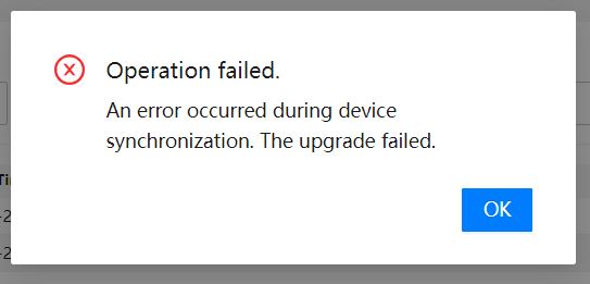

    Guys, I have a Huawei inverter (SUN2000-10KTL-M1) and a SDongle (SDongleA-05). In fact I could easily upgrade to the latest firmware version thanks to this forum. Many thanks for this!
    However I have optimizers too, and I can see possibility to upgrade optimizers. But if I choose this option, I cannot choose the optimizers, only the inverter. And then it gives an error message.
    Huawei SUN2000 Inverter: WIFI Dongle Connection, Firmware Update & FusionSolar
    Is there any possibility to upgrade the optimizers?
    Thanks, Laszlo

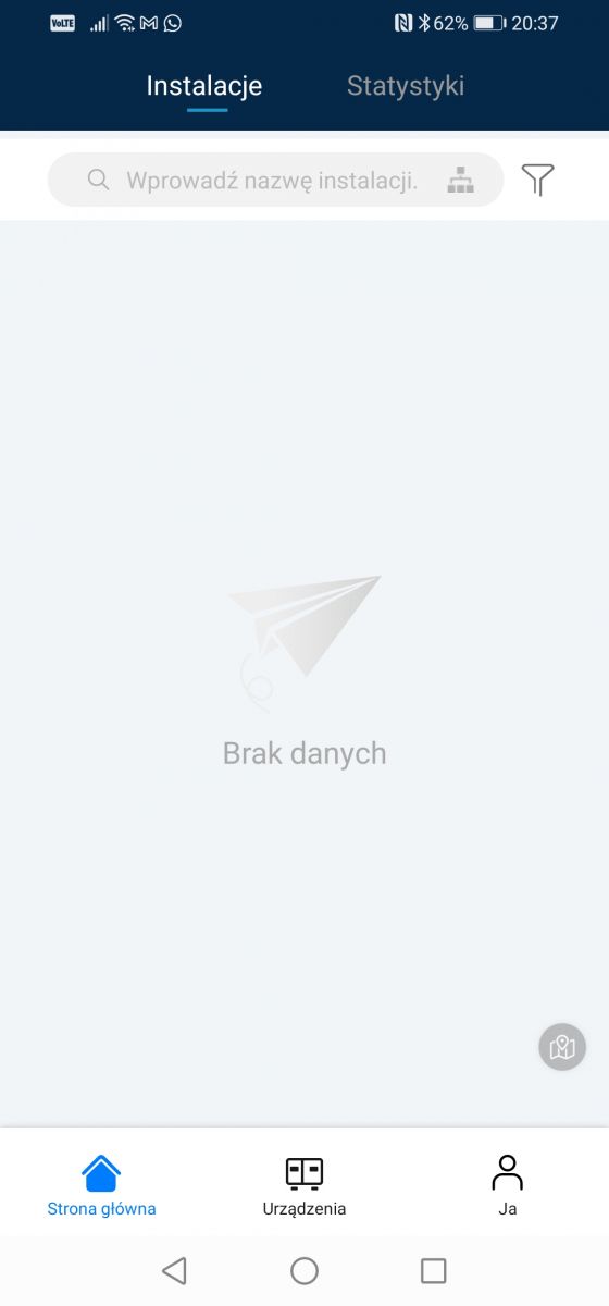

    Do you also suffer from the FusionSolar application? You cannot log in to the computer either. Were their servers down again? The problem started around noon today.
  • #379 19775240
    akir19
    Posts: 38
    You give sign in turn the Huawei icon and it fires up
  • #380 19775248
    karol4000
    Posts: 44
    Yes, I have the same on all my accounts. And on a computer and on a few phones
  • #381 19775256
    szczukot
    Posts: 820
    Help: 6
    Rate: 82
    I was able to log in literally 1 minute ago. Maybe it is already. Before that, I was lying here.
  • #383 19775652
    rookie116
    I did inverter updates using wifi, QR code scanned with fusionsolar app and installer account. The update itself was successful. Soft is spc140. Unfortunately, after disconnecting the inverter from the wifi and entering the fusionsolar, I cannot see my installation, it is empty. Maybe someone familiar will help? How to restore the view of your installation in the application? Please help Huawei SUN2000 Inverter: WIFI Dongle Connection, Firmware Update & FusionSolar
    take care, I also upgraded my inverter to spc140 the day before yesterday, and yesterday there was no production while we had a full sunny day. I consulted with Huawei service and they suggested downgrading back to spc139. I did yesterday and my plant and inverter work well.
    so take care of the latest spc140, it may not work well with some inverters...
