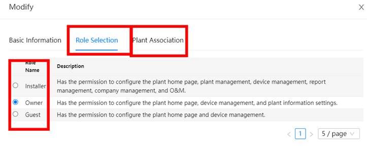

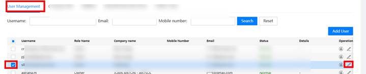

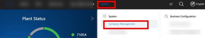

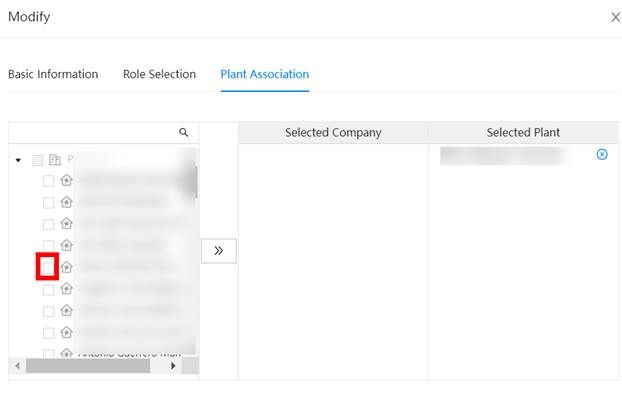

    By e-mailing with support, I got valuable info, well the installer can grant installer rights to the owner of the installation.
    In case someone wanted to ask Zenek the editor to do us such a favor, and it turned out that the last foreign language Mr. Zenon dealt with was Russian in primary school, I am throwing in the text and picture info received from Huaweia. Maybe it will be useful to someone.
    System-> Company Management-> select the user-> click Modify button-> Role selection (here he must select Installer) -> Plant association (here he must check that is selected only your plant)

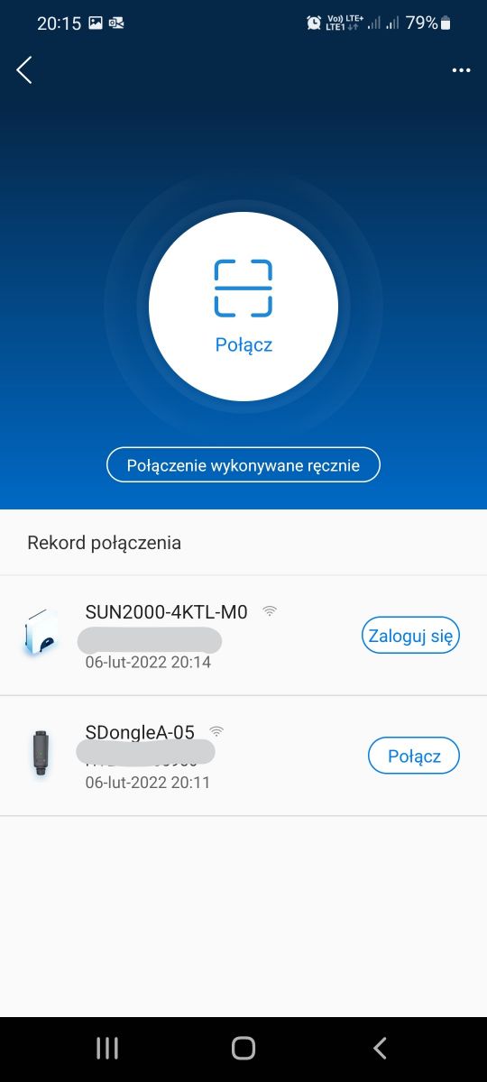

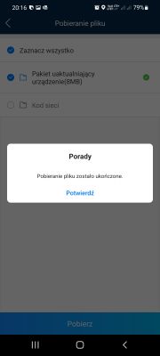

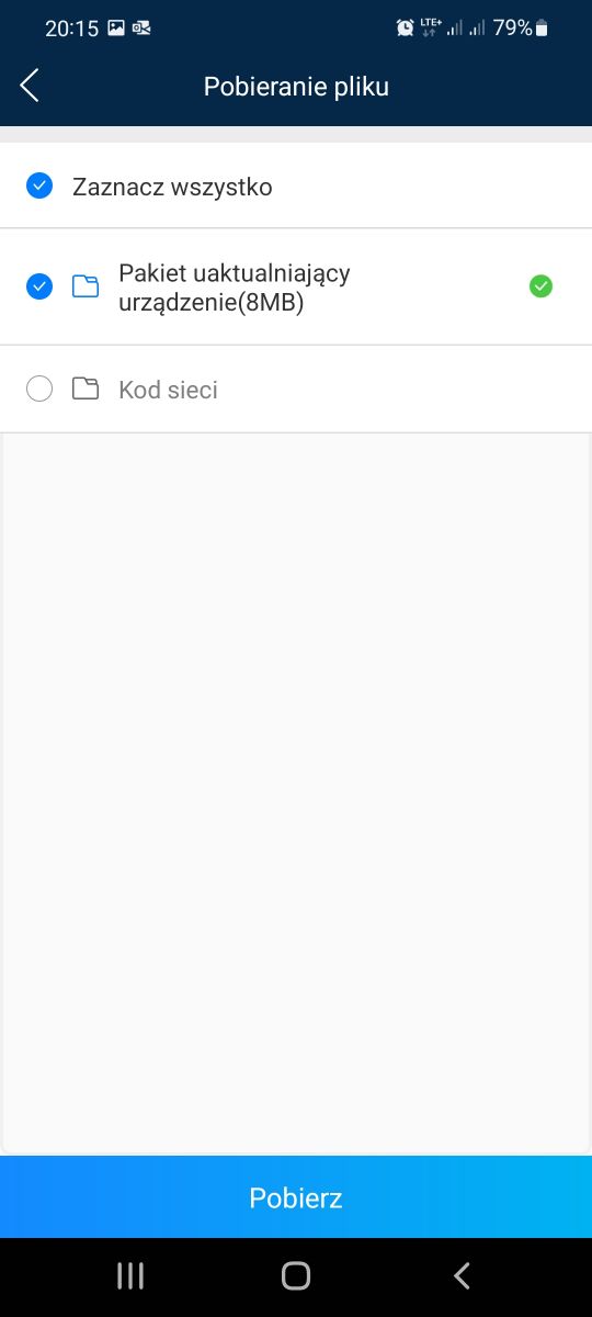

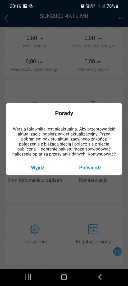

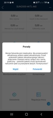

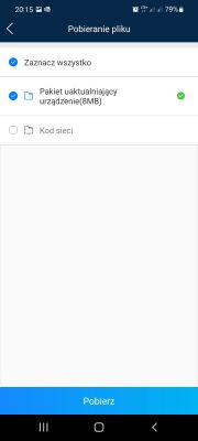

    Gentlemen, I am asking you for help because I am about to cry over this inverter.
    I have a problem updating the Inverter
    1. I run Fusion Solar on the user's account
    2. Go to the option: Commissioning the device
    3. I choose the device (INVERTER) and log in: installer
    4. Receives a message that updates have been detected - should Download the update (YES)
    5. I'm downloading the update
    6. After downloading, I have to go back - but this operation throws me to the device selection screen and I have to log in again
    7. Back to point 4 - and so on and on ..... :(
    Am I missing an obvious fact?
    I have a problem updating the Inverter.
    I don't know what you are doing wrong but when I updated the 2x inverter it was a different method. The first time after sun2000 entered it, it itself said that it detected the update and whether I want to do it. It was probably from spc124 to spc140. Spc141 did not detect it anymore, so after getting the package from the support (I posted a few posts above) I entered the inverter as an installer via sun2000, chose to update the device, manually indicated the zip package on the phone and it also went from the shot.

    qrko wrote:
    after getting the package from the support (I posted a few posts above) I entered the inverter as an installer by sun2000, I chose to update the device, manually indicated the zip package on the phone and it also went from the shot.
    Yes thank you, I used your package for the WIFI dongle update - everything flashes. (I marked the post as helpful)
    It's all clear
    Since I use Samsung, it turned out that the FusionSolar app does not update me on a regular basis. It seemed to me that I have the latest version 5.7, but after downloading the apk and installing the update, the loop is no longer present. Apparently it had to be 5.7.000xx with the last revision.
    Sorry for the confusion.

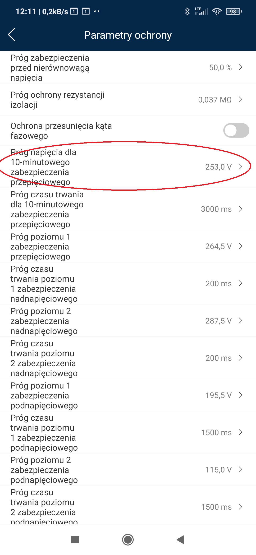

  • #527 19887482
    k_zako
    Posts: 9

    Here is a good mic for such a situation Link

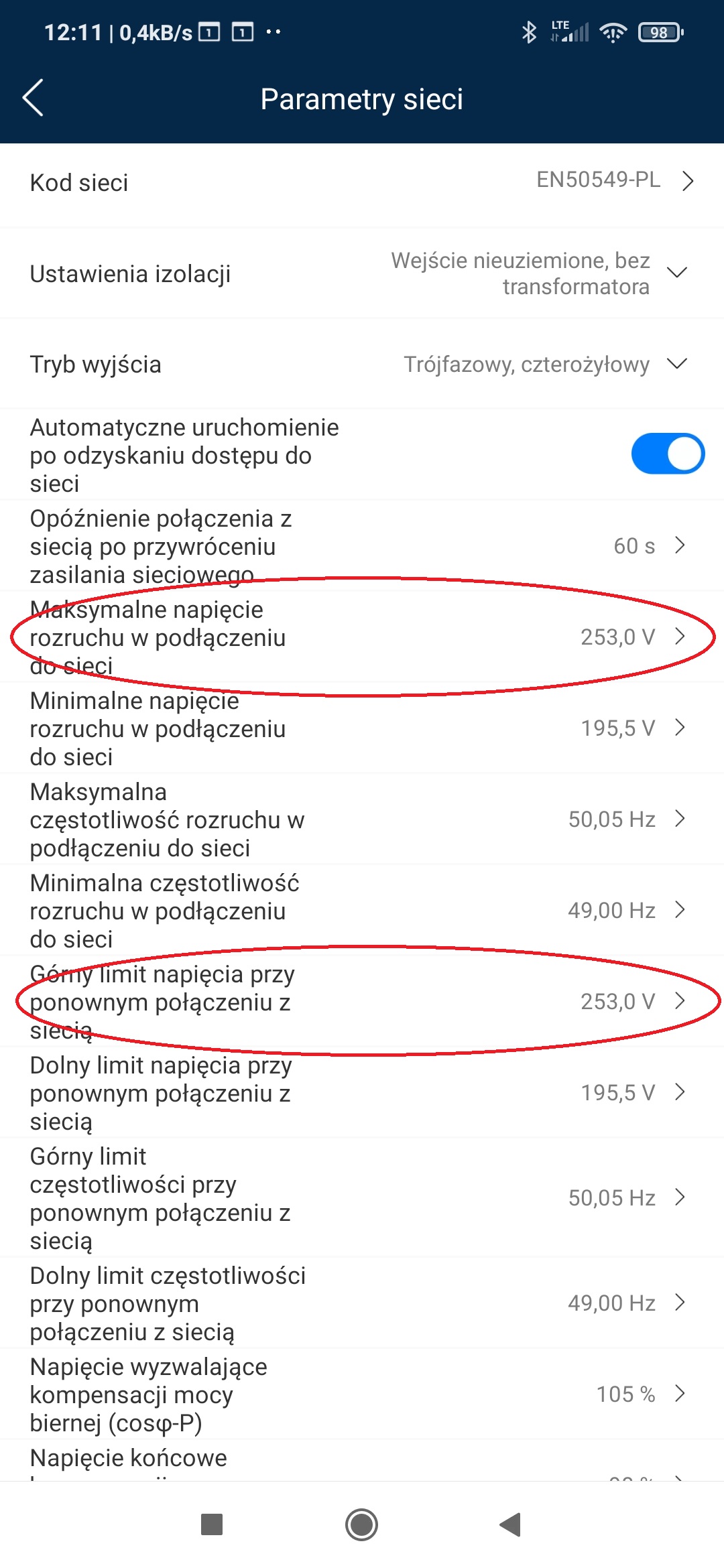

    Today I reached the operator of my network, ie ENEA, reporting the problem of switching off the inverter due to too high voltage in the network above 253V. The gentleman from BOK asked me how much the voltage is increasing above 253V? I replied that looking at my graphs in the Fusion Solar application they did not exceed 256V. He advised to increase the voltage on the inverter by these 3V from 253 to 256V, he added that nothing would happen because in strong sunlight, the voltage in the network may still increase, they consider up to 5V as the standard, i.e. up to 258V. I would like to raise this voltage on the inverter to 256V.
    At the moment, I have the network code set to EN50549-PL when I set the German standard, will it be ok? Watching all the videos and on our forum, the fact that the information and videos are more or less 1.5 years ago is the German standard everywhere, i.e. the threshold up to 260V correct? If I left the Polish standard, how do I change the voltage marked on the screens to 256V in the inverter settings, will it be enough? Should I change something else or maybe just change the 10 minute voltage threshold?
    Thanks for the advice, screenshots of the inverter settings and the selected parameters that I am asking about are attached.

    Seriously, a guy from Enea's BOK said that? It's illegal as far as I know. And the German standard has the same voltages as PL. Czech has higher.
    Check what your reactive power compensation setting is, this feature works wonders. For me, it has reduced the number of exclusions by 3 times.
