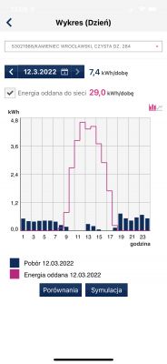

    rokbok wrote:
    roberto33333 wrote:
    I would also like to see on this graphic what value is taken by home appliances and how much goes into the network.
    You will not see how much goes into the network in this graphic, but you can see it in the "Statistics" tab, at the bottom next to "Overview", but you would have to install the DDTU666-H counter for 3F installations or DDSU666-H for 1F installations.
    If you are in Tauron, it is also a non-invasive option with the eLicznik service. Rather, they do not nod and at 100% it is the value that you will see later on the FV. This is what the daily chart looks like. There are also per month and year and meter reading remotely:

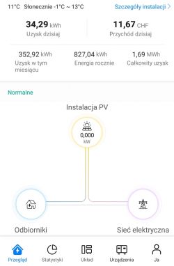

    I'm not interested in spending PLN 700 on the meter?
    rokbok wrote:
    As for the zero indications, try uninstalling Fusion Solar and reinstalling, maybe there is an error in the app.
    I don't want to uninstall, because this app likes to hang and it may turn out that I won't see anything (once I couldn't log in for 2 weeks, then something bounced her and she accepted the same login and password without any problems). It just doesn't work for friends?
    My question was whether there is some option to check / enable somewhere that I have no idea about to trigger it. Previously, it worked itself, and in the shortened manual on the Huawei website there are pictures that even with the stamp of home devices, it gives a value and also with this energy pole, so somehow you can turn it on or some software version supports it. Huawei SUN2000 Inverter: WIFI Dongle Connection, Firmware Update & FusionSolar

    roberto33333 wrote:
    I don't want to uninstall because this app likes to hang
    There used to be problems, now it's fairly normal, the latest version of the app is 5.7.073, check what you have.
    There is no option to turn it on or off, the indications are automatic.

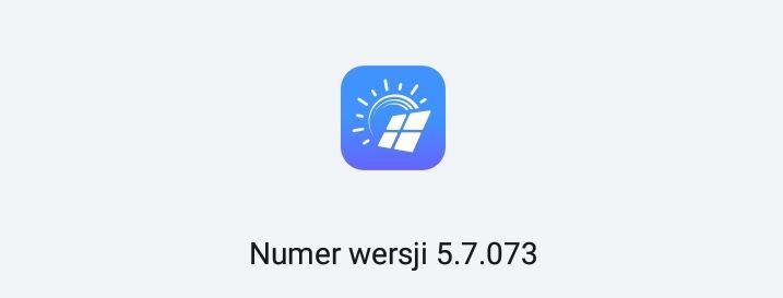

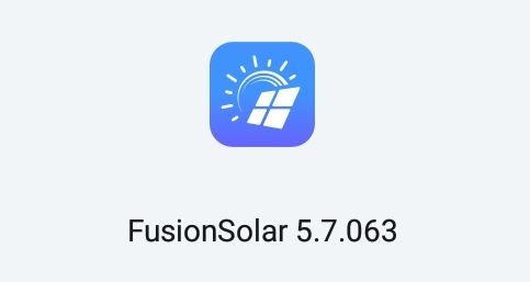

  • #576 19928896
    rokbok
    Posts: 4251
    Help: 622
    Rate: 992
    Download the latest and update, you can download from appGalery, or from the attachment, if you download from the attachment, change the extension from * rar to * apk
    • FusionSolar_5.7.073.rar (94.93 MB) You must be logged in to download this attachment.
  • #577 19929496
    roberto33333
    Posts: 6
    I updated, tomorrow I will see if it worked, because now it is dark and the panels do not produce electricity, thanks for your help

  • #586 19930971
    roberto33333
    Posts: 6
    rokbok wrote:
    Download the latest and update, you can download from appGallery, or from the attachment, if you download from the attachment, change the extension from * rar to * apk
    Unfortunately, updating the app to the latest version did not help, they are still zero Huawei SUN2000 Inverter: WIFI Dongle Connection, Firmware Update & FusionSolar
  • #587 19931960
    dprzyb
    Level 22  
    Posts: 504
    Help: 36
    Rate: 119
    I don't think it is an application version issue. Recently, it also showed me zero for several days, although when I switched to the statistics tab, I saw the production graph.
    It just happened after a few days and, for example, today everything is ok
  • #588 19933212
    roberto33333
    Posts: 6
    dprzyb wrote:
    I don't think it's an application version issue. Recently, it also showed me zero for several days, although when I switched to the statistics tab, I saw the production graph.
    in my case, in the statistics tab, it also shows the production ... but in the first tab, zero, even though there was information about the current production of PV panels earlier.
  • #589 19933654
    dprzyb
    Level 22  
    Posts: 504
    Help: 36
    Rate: 119
    Exactly. So it's not the app's fault, but more of their servers or clouds
  • #590 19933704
    qrko
    Posts: 153
    Rate: 34
    Check the color of the LED on Donglu when the first page of the app is all zeros. From what I know, the first page is live and if the dongle will glow red, there will be nothing there. If, for example, it is at the router's range contact and it disconnects every now and then, it may be that the first page will be zero most of the time, and yet the production statistics will match because the inverter has a buffer in which it holds data and sends them when will catch the connection, so it is enough for it to connect e.g. once a day.
    For me, the red LED appears a few x a day for a short time and then the app does not show anything, I have not figured out where it comes from yet, but I suspect that it is the fault of 3 routers with the same SSID, maybe it caught the most distant one during the configuration and now there are circuses.
