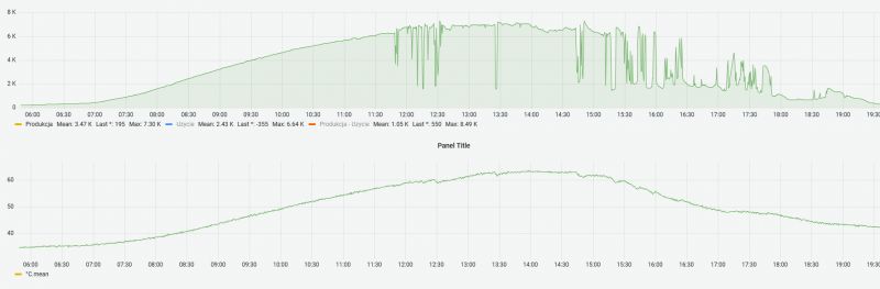

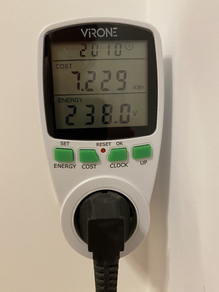

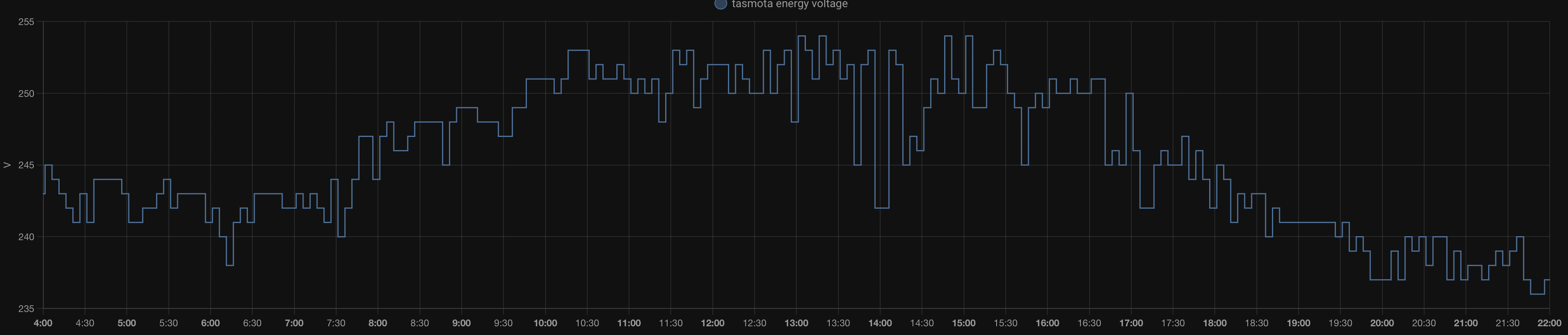

    szczukot wrote:
    Take the tension yourself first. What is the peak weather like at night.
    Hey, I know exactly what my tensions are:
    Huawei SUN2000 Inverter: WIFI Dongle Connection, Firmware Update & FusionSolar
    Now 21:18, when there is no production anymore and I think there is still power consumption in the area, it looks like this:
    The voltage on the vases is consistent +/- 1V. Tasmota is in a different phase than this measure.
    As for the power consumption of the neighbors, they pay the same for electricity from coal from Tauron as for mine. The difference is that Tauron is canceled for both sources, so IMO the more profitable it is to sell my local current by lowering the V on the transformer. They'll save on it from the net and maybe send it to some local factory.

    Exactly - this is how I thought that the "output" value was much over 230V :(
    And there is probably nothing to be done about it, because it is within the norm.
    I looked at my place - the output is also 237V. They conquer pretty well.
    however, I have a smaller number of PV installations. Some 60 houses are connected to the transformer. I don't want to count, but the installation is maybe 15-20.
    As for the fact that they will sell this electricity, it shouldn't be true. BO they assume that you are doing the installation as needed. So you will use as much as you produce (because you will buy some cheaper at night but ...)
    And at this point, dozens of houses next to you are paying more.

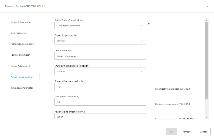

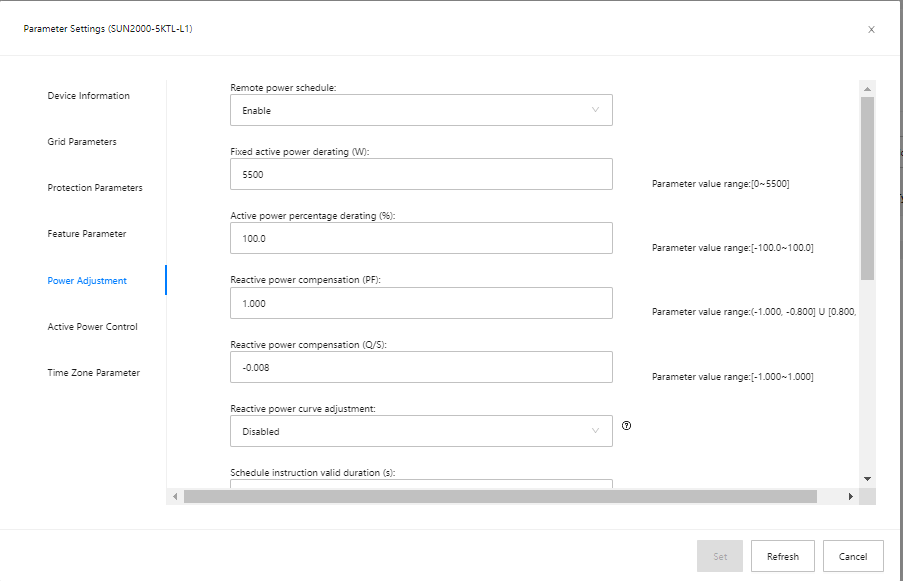

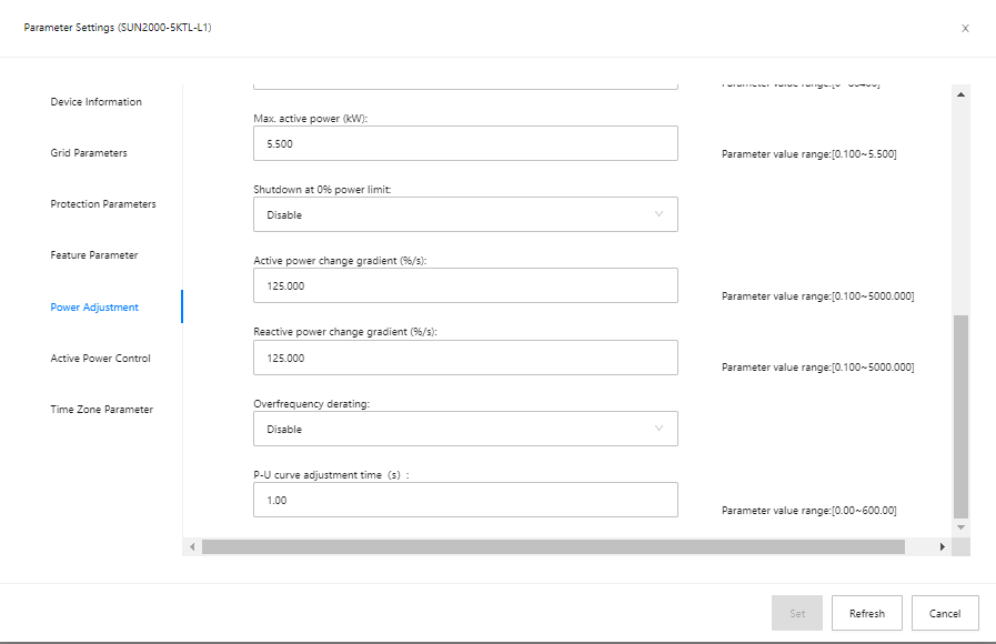

    Could anyone help me optimize my inverter settings it is a SUN2000-5KTL-L1
    First problem is not all short events are recorded for example if I use a kettle for a few minutes its not shown in the energy management graph so my energy consumption is not accurate.
    Second problem I have never produced the full 5kw that the inverter should supply I have only been able to generate 4.1kw with a 6kw demand despite bright sunshine at noon in May.
    I include some screen shots any help or suggestions would be great.
    Thanks
    Mick
    Huawei SUN2000 Inverter: WIFI Dongle Connection, Firmware Update & FusionSolar Huawei SUN2000 Inverter: WIFI Dongle Connection, Firmware Update & FusionSolar Huawei SUN2000 Inverter: WIFI Dongle Connection, Firmware Update & FusionSolar Huawei SUN2000 Inverter: WIFI Dongle Connection, Firmware Update & FusionSolar

    You have not even written what power panels you have installed.

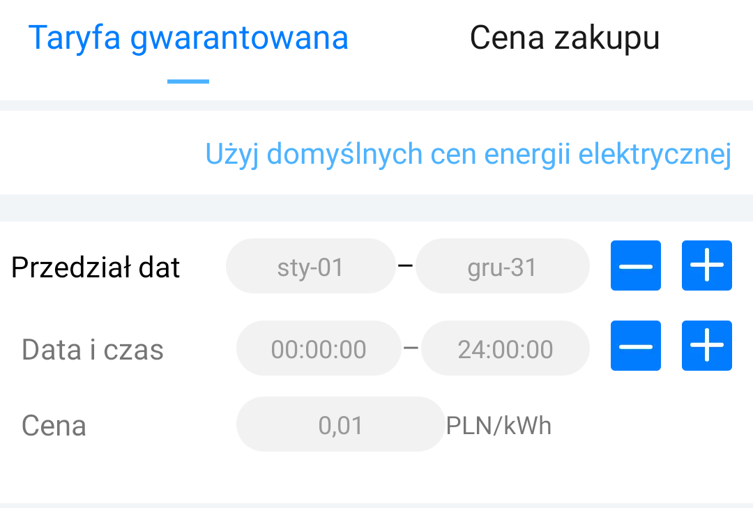

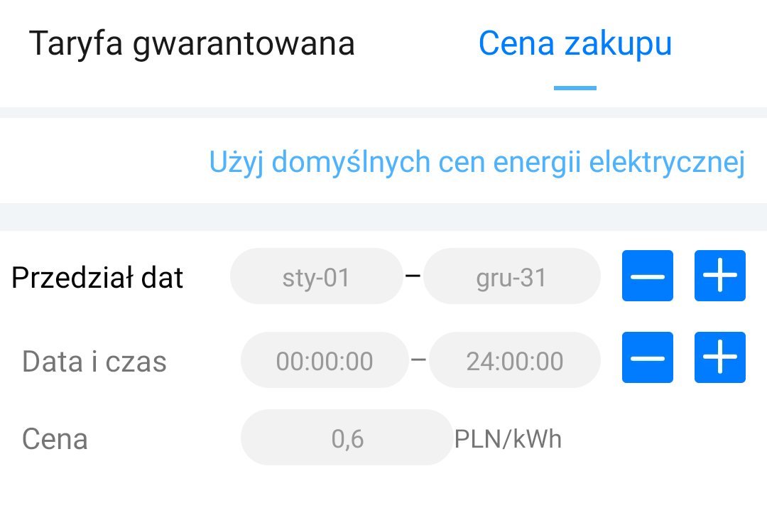

    I have a request.
    Suggest what amounts are entered as "Guaranteed tariff" and "Purchase price"?
    I think I configured it wrongly because I do not fully understand these two concepts.
  • #728 20017502
    rokbok
    Posts: 4251
    Help: 622
    Rate: 992
    I divided the gross amount on the invoice by the amount of kWh I used and I got a price of 1 kWh.
    The price we pay consists of so many derivatives
    that it is impossible to determine it exactly, therefore I took this and no other calculation.
    I entered the calculated amount in both positions in Fusion Solar, I take it with a grain of salt, as an approximate / approximate price for 1 kWh ;) .

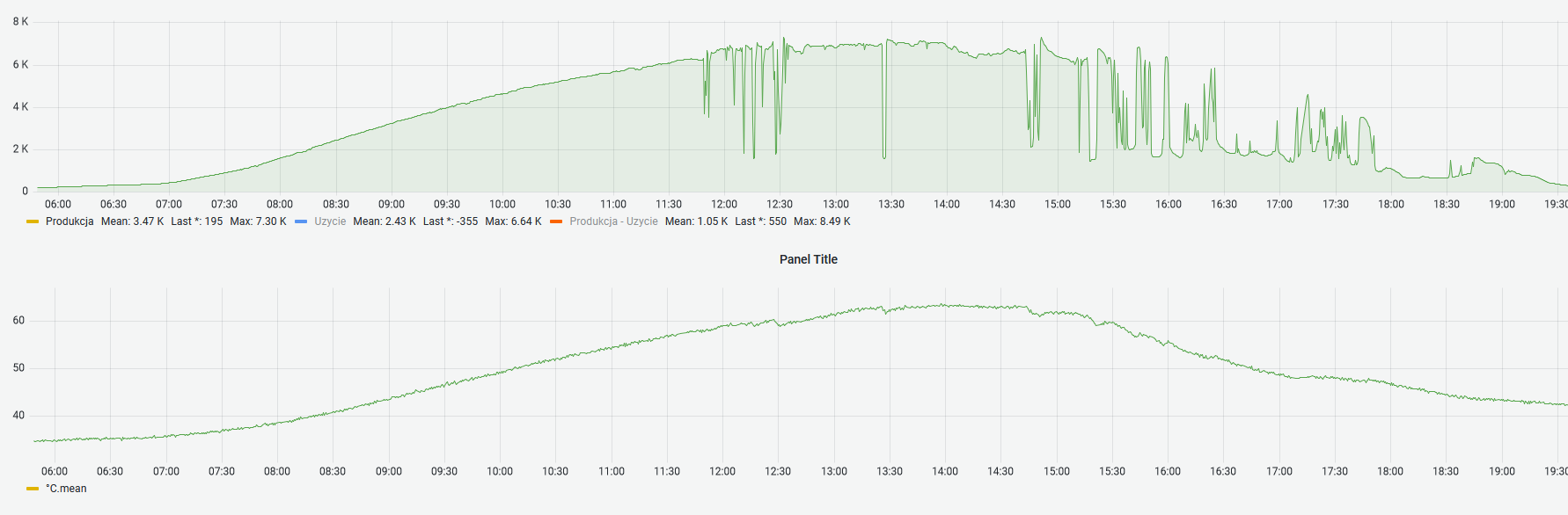

    It was mentioned on the previous page about temperature, is there any info given at what temperature the power reduction begins?
    I have M1 installed in the garage, so far it is cool in the garage and Huawei is hitting 51 degrees.
  • #731 20020048
    lizak1983
    Posts: 133
    Help: 5
    Rate: 36
    Do you know to what extent this affects electricity production? In my summer, the temperature usually remains below 60 ° C during the highest production, but I found a day (July of the previous year) where it was 63 ° C. However, it is difficult to deduce anything from the graph, probably when the weather is nice and the day is hot, I will try to cool the inverter and see how the production will change, unless someone else does it before and shares the results of their observations.

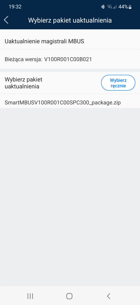

    Anyone update it? Huawei SUN2000 Inverter: WIFI Dongle Connection, Firmware Update & FusionSolar

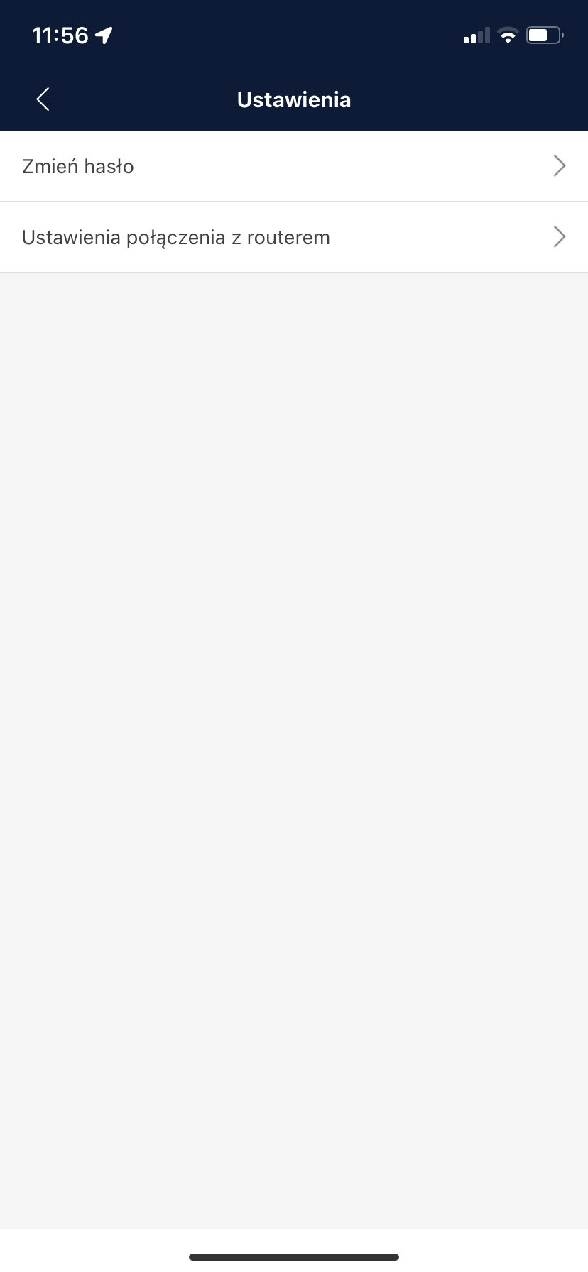

  • #733 20021120

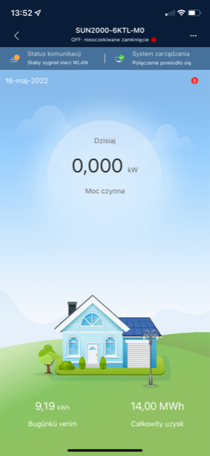

    jmper
    Posts: 13

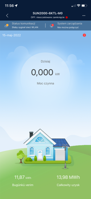

    I haven't used the application to configure the inverter for a long time and now, when I logged in to FusionSolar, I saw this view:
    There is nothing about any configuration of parameters here, to be honest there is almost nothing but a nice picture, if I click on the 3 dots at the top, I have there, among others. 'Settings' and only so much in them:
    What to do how to live? I am using the latest version of FusionSolar for iOS, does it matter?
  • #734 20021202
    rokbok
    Posts: 4251
    Help: 622
    Rate: 992
    After all, it says "Management System - Cannot Connect" at the top right.
    Without connecting to the inverter, you will not set anything, find the reason for the lack of communication.
  • #735 20021209
    jmper
    Posts: 13
    rokbok wrote:
    It says "Management System - Cannot Connect" at the top right.
    If it were that simple, I wouldn't be writing here. This message was due to the problem that the dongle had with connection to Huawei's servers.
    Now everything is connected and I have exactly the same:
  • #736 20021247
    rokbok
    Posts: 4251
    Help: 622
    Rate: 992
    I wrote about what I noticed, maybe someone from iOS will say something more.
  • #737 20021279
    karol4000
    Posts: 44
    Are you logging in as an administrator?
  • #738 20021403
    jmper
    Posts: 13
    karol4000 wrote:
    Of course. Exactly as an installer. Interestingly, the installer password also works when logging in as a regular user. I don't know if it should be like that, but never mind. Unfortunately, the documentation of Huawei, to put it mildly, leaves much to be desired.
    I also wrote to the support, we'll see what they say.
  • #739 20021529
    handsmick
    First problem is not all short events are recorded for example if I use a kettle for a few minutes it's not shown in the energy management graph so my energy consumption is not accurate.
    Solar panels 12 Amerisolar 460W AS-6M-HC =5520 watts
    Thanks
    Mick

  • #741 20022145
    jmper
    Posts: 13
    Pitercom wrote:
    Check if you have a strong WiFi signal because the inverter has a weaker sensitivity.
    If the signal is weak, it cannot connect.
    Thanks, but that's not the problem at all. The signal will not be stronger because I am standing next to the inverter, the application on the phone connects to the inverter without any problem. Only then do the stairs begin, because earlier (as far as I remember) on the home page there were various configuration options to choose from, and now I have this charming picture with a house and current energy production and I can't see the possibility of setting / changing parameters anywhere for anything.
    I am beginning to have suspicions that they just threw out the configuration option from the iOS app, and I do not have an Android phone to check it. If someone could upload a screen from an android app, I would be grateful because I would know if it looks similar and where to enter the settings.
  • #742 20022225
    xszuflax
    Posts: 53
    Rate: 7
    The iOS application works without any problems with new software, I tested from 140 - 142. Maybe you have too old firmware in the inverter and maybe the API has changed. Update the software via the website to 141 (142 not recommended).
  • #743 20022425
    rokbok
    Posts: 4251
    Help: 622
    Rate: 992

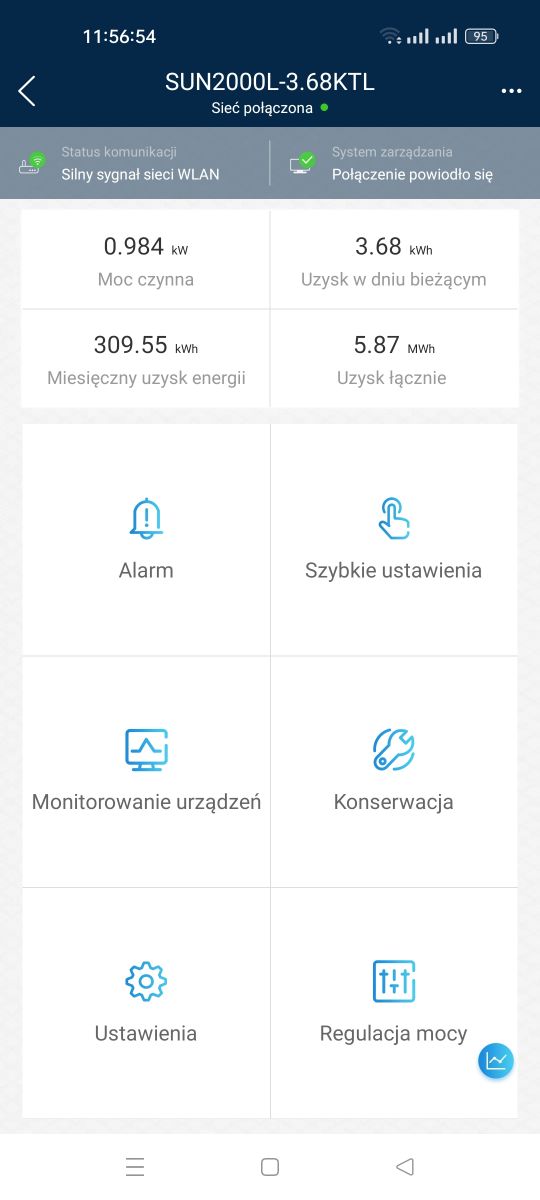

    This is how it looks on andku, maybe try to clear the app's cache at home, or uninstall and reinstall it.
    I wrote it like this:
    I took only the variable fees into the unit price of kWh, because fixed fees would be independent whether I have PV or not.
    From what I received, I subtracted 20%, because what I produce for the warehouse, I can pick up less by 20% later, so in fact I will lose the 20% that I would "save" now.
    This app charges the same rate for auto consumption and exports, so it can't be otherwise.

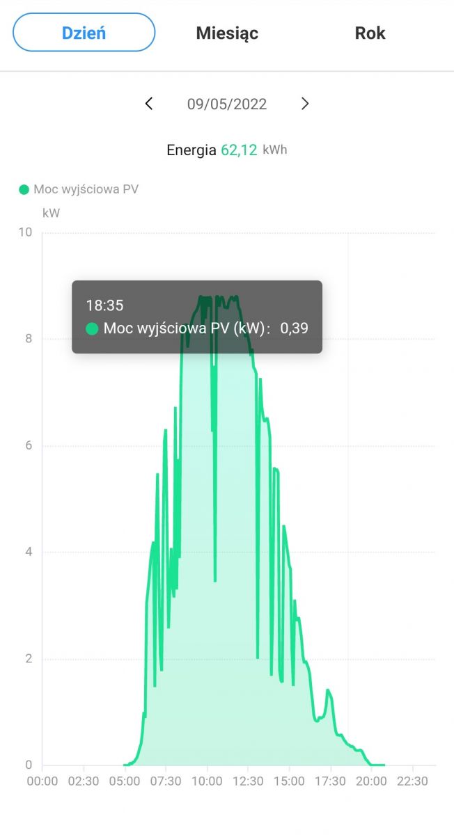

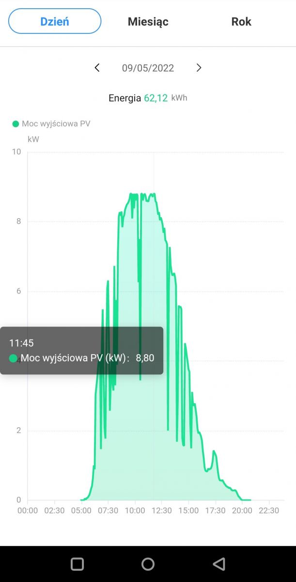

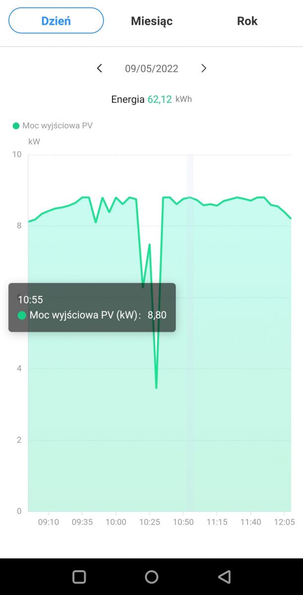

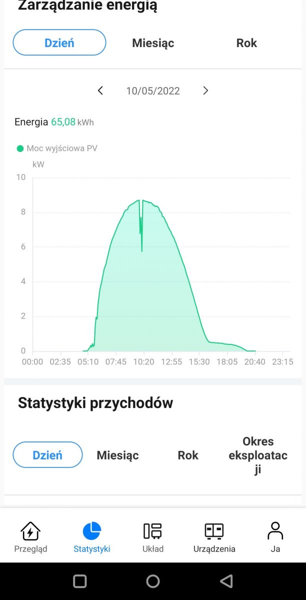

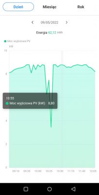

  • #749 20023711
    miikew1
    Posts: 10
    for installation 9.69 and sun2000-8-m1, are the graphs below correct? cloudless sky, and it does not reach the maximum of 8.8, and on days with clouds it is from time to time it is 8.8 - is it the fault of the panel temperature?
  • #750 20023731
    zenq
    Posts: 28
    You have an 8kw inverter and are you surprised that it does not release 10?
    8kw inverter, will not output more than your 8.8 because that is how the limiter is set.
    For example, a 10kw inverter is factory set to a limit of 11kw.
    It is configurable in the app, but if you overdo it with max power, it will probably be limited by the temperature.

  1. On the router set the new SSID and password identical to the old ones – the inverter reconnects automatically [Elektroda, lizak1983, post #19657944]
  2. If you prefer to edit the inverter, open the SUN2000 app, connect to the inverter’s AP, choose Maintenance > Communication > Router Wi-Fi and enter the new credentials; save and wait for the LED to turn steady green.

My Wi-Fi dongle flashes red every few days – fix?
LED red blink means router unreachable. Common causes: weak signal or changed password. Move a repeater within 5 m (-55 dBm or better) [Elektroda, JackRze, post #19489219] If stable signal still fails, reboot the dongle or update its firmware (see above).
