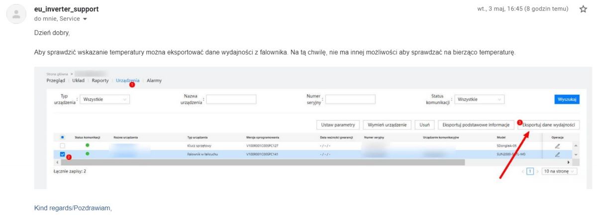

    I decided to explore the subject of this unfortunate Temperature. I really care about it.
    I wanted to somehow get in touch with service / support to ask there. Unfortunately, after selecting the tab: "System -> Contact us", such a window pops up. I don't know what it is about and where and how to set it up.
    Huawei SUN2000 Inverter: WIFI Dongle Connection, Firmware Update & FusionSolar
    I have no idea in what other form and where I could turn to Huawei for help and support to explain the invisible Temperature preview on both my inverters. Maybe it can be turned on somehow, e.g. through Huawei service / support?

  • #701 19997699
    domelek
    Posts: 275
    Help: 10
    Rate: 44
    I wanted to somehow get in touch with service / support to ask there. Unfortunately, after selecting the tab: "System -> Contact us", such a window pops up. I do not know what it is about and where and how to set it.
    Write to eu_inverter_support(_at_)huawei.com, they reply reasonably well.

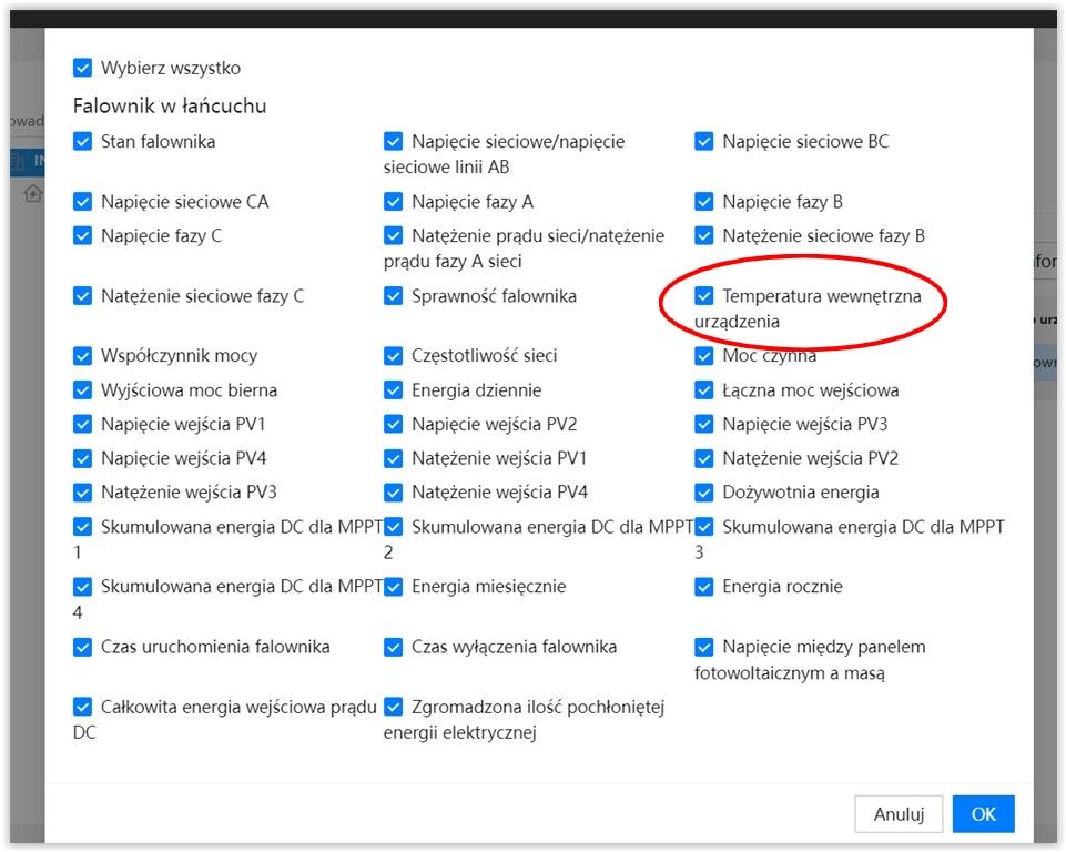

    @Yorkus I exported the data to xlsa and made a graph :)
    Added after 9 [minutes]:
    With the temperatures it was so that up to a certain version of the FW it was normally visible on the parameters screen (where there are voltages, etc.) then with some update this temperature was hidden and can only be extracted through data export (I do not have it in the historical data referred to above - I suspect that the firmware version may be important here - I have the newest one and of course I'm an admin). There was a lot of buzz on the Huawei forum after removing the temperature view straight - they explained it with a large number of complaints due to high operating temperatures, which they say is normal.

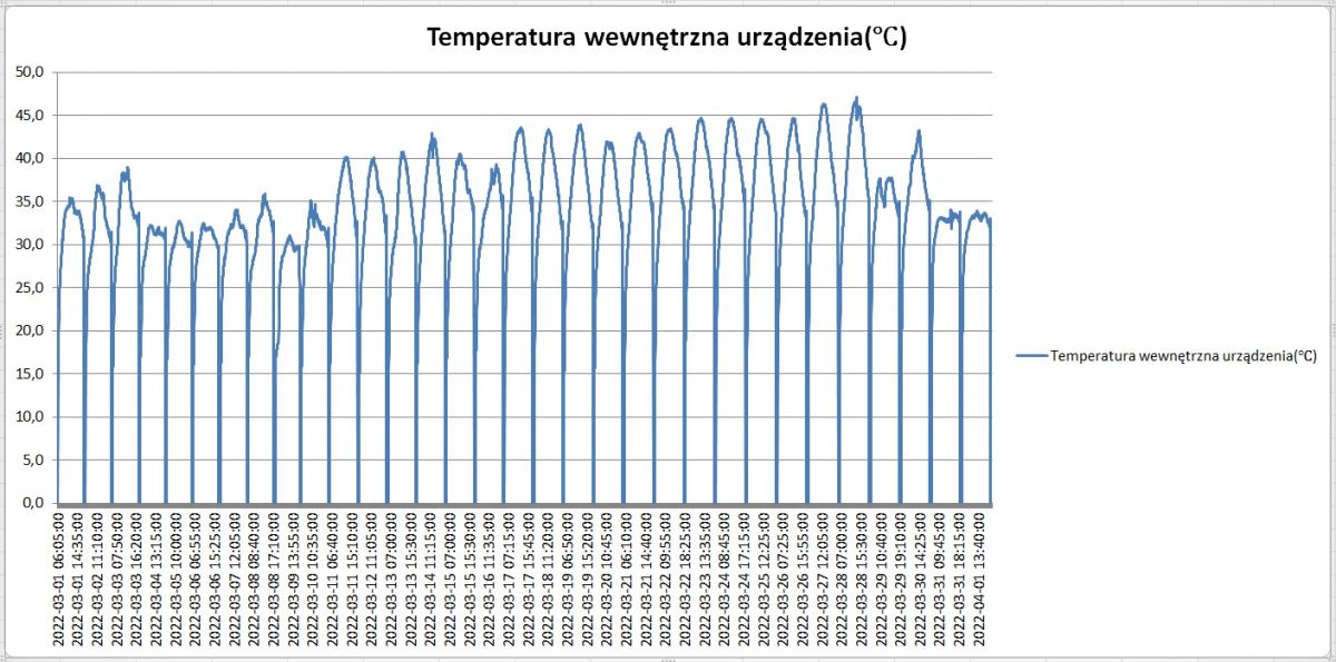

  • #709 19998821
    Math13
    Posts: 112
    Rate: 34
    Is a "normal" user with Admin / Installer privileges able to export this data, having a connection to the inverter only via wi-fi and a website or an app?
  • #710 19998941
    karol4000
    Posts: 44
    yes, device management, export performance data
  • #711 19998964
    rokbok
    Posts: 4251
    Help: 622
    Rate: 992
    Such a window should appear, you choose what should be exported to the * xlsx file, the file itself is packed into a * zip archive.

    Math13
    Posts: 112
    Rate: 34
    Thank you @All for the tips and invaluable help.
    It worked, and this is what it looks like for me, for example, in March 2022. Despite a slight exceeding of the temperature of over 45C, on 27 and 28, I did not notice that the inverter was turned off. :-)
    I also wrote an email to "eu_inverter_support" asking for a temperature view.
    They wrote back quite quickly and asked for the SN of the inverter, which I did. I am waiting for a response.

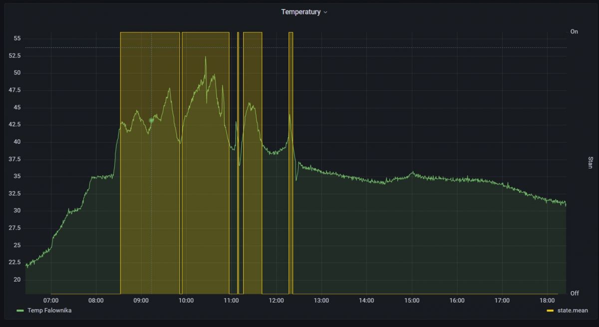

    My M0 inverter is reducing power sometimes. Most often by turning off. I have one 3.3kW string and the other 3kW - disconnecting one circuit of the panels on the DC side helps the inverter not to turn off.
    I got a reply from "support". Unfortunately, it coincides with the prompts I have already received.

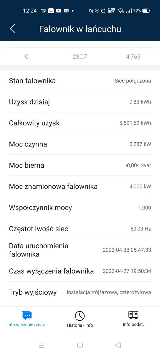

  • #718 20008641
    dprzyb
    Level 22  
    Posts: 504
    Help: 36
    Rate: 119
    I wonder how should I do it since I can't see the "Export performance data" function.

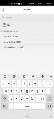

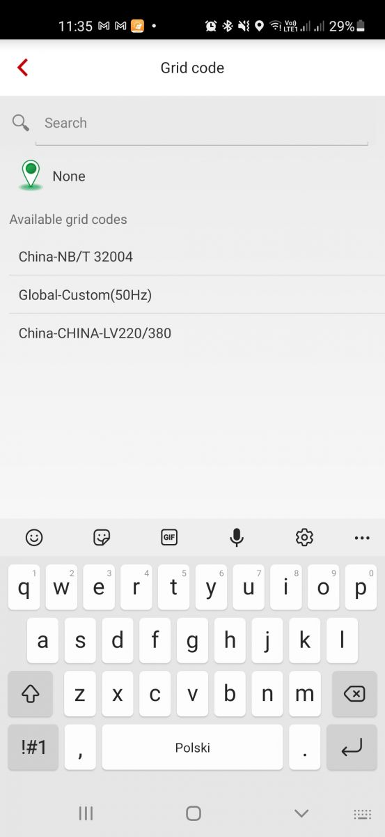

    mail2
    maneks wrote:
    A friend asked me when I started the installation on the SUN-2000-8KTL-M0 inverter (this is what the stickers show). It was supposed to be a walk - and it turned out to be crap. What's the matter - an inverter bought at a fairly attractive price from a Polish company with an invoice - unfortunately the problem is the GRID CODE - or rather the lack of it. Evidently the inverter intended for the Chinese market. After calling the seller, we found out that:
    - the inverter can be used in our network despite the lack of a GRID CODE selection, e.g. Germany or the Czech Republic
    - the Huawei warranty is valid in Poland, what's more, it can be extended for the next years
    My question
    - Can the Grid CODE be recorded somehow?
    - What exactly does the Grid CODE contain - or just the top-down standardized network parameters that can be manually set?
    - Has anyone encountered this type of problem before?
    - Will ZE not bother when accepting such an installation - I assume that "Business Janusz" - probably such inverters are pushing customers?
    - Has anyone reported such an inverter under the warranty in Poland?
    Tomorrow, an application will be sent to Huawei Polska - we will see what they answer. Just wondering how to report it.
    Whether as the inability to select the correct GRID CODE, or as a request for a possible use and form of the guarantee. Because I would not be surprised if the inverter could be sent back for repair to CHINA ONLY
