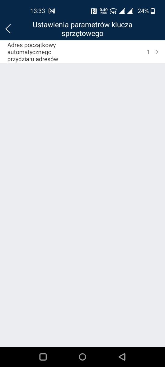

    I have a problem with connecting to Modbus
    soft in the inverter is probably ok, because if you connect to it via its hotspot, the modbus works and I can view some register
    unfortunately I can't cope with getting data through my router indirectly.
    or how to connect via hotspot 192.168.200.1:6607 - it works
    how to connect via router 192.168.12.68 cable (59WIFI): 6607 - does not work
    when I enter the inverter option via sun2000, the protocol is set to modbus, but it is not possible to save the settings:
    SETTING THE COMMUNICATION PARAMETER OF THE PARALLEL SYSTEM: NA / RS485 / MBUS
    after selecting RS485 and exiting the application, it is still set to ON
    What to do ?

  • #664 19994094
    miikew1
    Posts: 10
    I don't have this setting

  • #666 19994109
    miikew1
    Posts: 10
    sun2000 3.2.00.013

    miikew1 wrote:
    sun2000 3.2.00.013
    I don't know if sun2000 supports these options
    fire up the fusionsolar
    sun2000 sucks so much that even device commisioning failed to do it (at least in my case) ...

  • #670 19994276
    miikew1
    Posts: 10
    It works, maybe it will be useful to someone, I used the SUN2000 application hard to enter the inverter settings (via its hotspot), unfortunately it turns out that not all options are displayed in this case
    I did not know that the functionality of the SUN2000 application was transferred to the FUSIONSOLAR application in the JA tab and the Device commissioning item, there is an option for MODBUS which is not present in the SUN2000 application.
    So, summing up my adventures, I also found out that:
    Inverter has its WIFI (its AP)
    The dongle has its own WIFI (its AP) and its ethernet port
    via FUSIONSOLAR and forwarding .... you can connect to both APs mentioned above and all options appear
    of course via the installer / 00000a

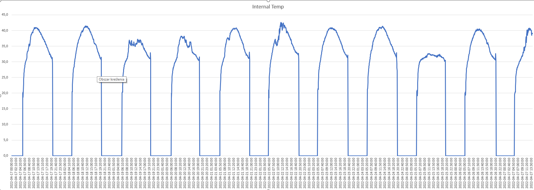

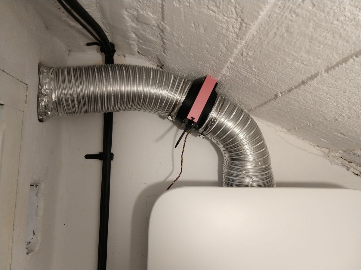

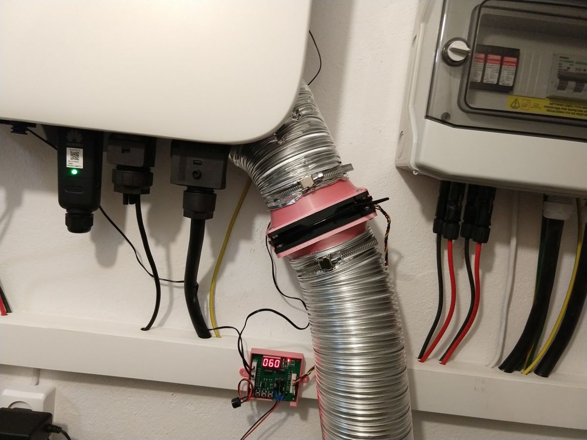

    I did something like this:
    Huawei SUN2000 Inverter: WIFI Dongle Connection, Firmware Update & FusionSolar Huawei SUN2000 Inverter: WIFI Dongle Connection, Firmware Update & FusionSolar
    And the temperature dropped down nicely
    what are these fans? what temp did you have before and after?
    Anyone know how the temperature above 45 degrees affects the production?
  • #676 19997108
    noogi
    Posts: 58
    Help: 6
    Rate: 38
    Two PWM fans (120x120x25 AVC DS12025B12H 4PIN) and a two-channel controller with temperature sensors attached to the fins - one fan draws air through the spriro pipe from above the tiled floor (cold) and pushes it under the ribs, and the upper one pulls it out and throws it into another room.
    I installed the cooling right away, because I have a small room and working with higher temperatures shortens the life of electronic devices
    The temperature measured on the fins does not exceed 34 degrees C (while the fans are running)

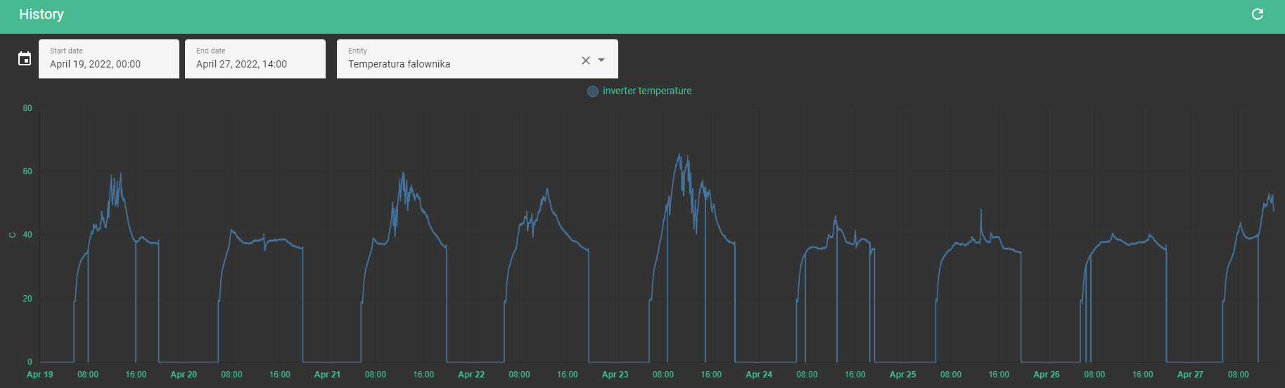

    szczukot wrote:
    And where did you check the temperature?
    I check via Home Assistant.
  • #682 19997182
    qrko
    Posts: 153
    Rate: 34
    Wow, that's actually not enough. I have 10KTL and only 8.1kWp of panels, and it hits 65 when the sun shines.

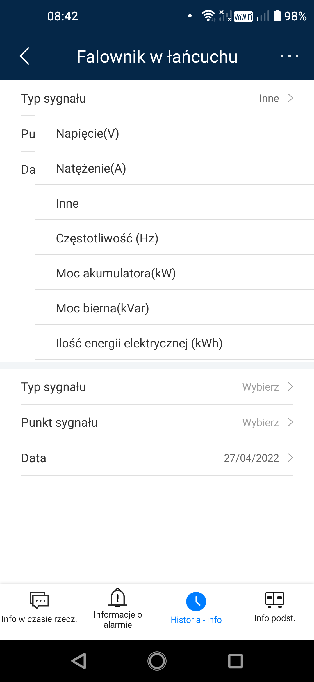

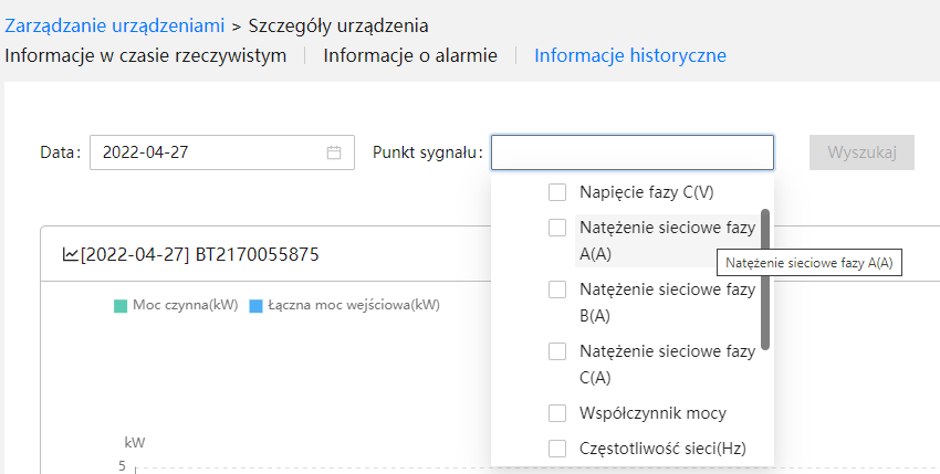

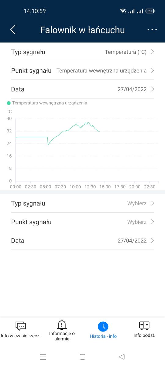

    noogi wrote:
    I'm also looking - once I knew where to get it through the WWW, but a lot has changed ..
    It depends on your permissions, I can check the temperature in Fusion Solar on the web, Installations -> Device management -> click on the device -> Historical information -> click Signal point -> you select Internal temperature.
    In Fusion Solar mobile, Devices -> click on the device -> History-info -> Signal type -> click on Temperature -> Signal point -> select Internal temperature of the device -> Confirmed and display a graph with the temperature.

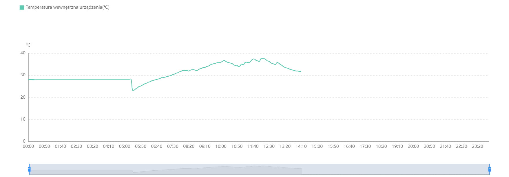

    Cool, unfortunately in my case the temperature in M0 is not available in these options.
    But from the export data, I have this:

    I also have M0, but as I wrote earlier, it probably depends on what permissions you have given by the installer, "press down" it a little for more permissions.

    Math13
    Posts: 112
    Rate: 34

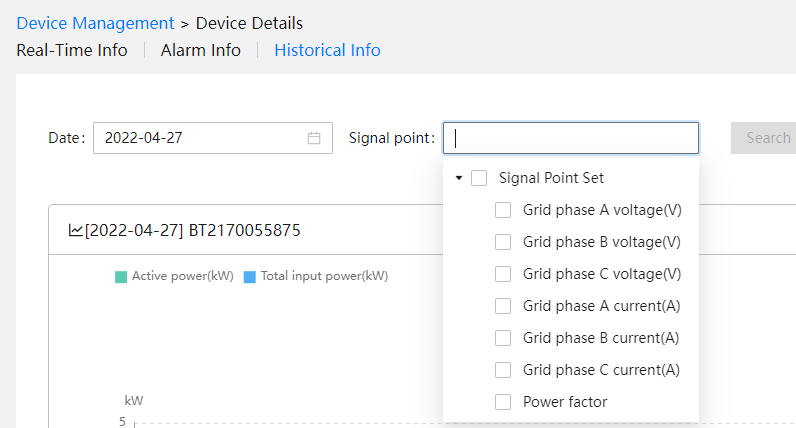

    I have full authority. Unfortunately, in my latest version, I do not see the possibility of viewing the Temperature. I only have the following:
    [img-0] Huawei SUN2000 Inverter: WIFI Dongle Connection, Firmware Update & FusionSolar
    and under "Other" additionally only "Power factor".
    Why can't I see Temperature in myself? Should I maybe install an additional sensor?

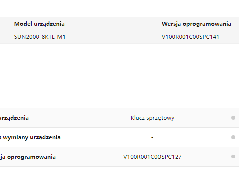

    Hmm, interesting. I have it like @ math13 - I have the highest permissions (installer), and I have no temp in the mobile or web app. Interestingly, the web site, after changing the language from Ang to Pol, has 3x more measurement options, but there is still no temperature among them.
    Model SUN2000-10KTL-M1
    Software version V100R001C00SPC142
