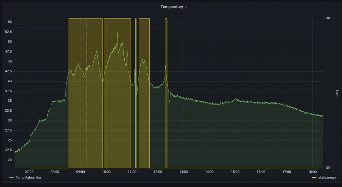

    As for the temperature. It only shows it in real time.
    I still do not see this option in historical information, which is a pity, because it is an important and interesting parameter.
    Do you have that too?

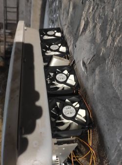

    In the app, yes. I have a short-circuited inverter with HA and thanks to this I have access to the temperatures from all day. During the season, he reached 70C with his light hand at the peak of production. I added 6 60mm fans triggered when exceeding 50C and they have no major problem with maintaining the set temperature. Probably 2-3 degrees lower to go down but I don't have time to play.

    In the app, yes. I have a short-circuited inverter with HA and thanks to this I have an overview of the temperatures from the whole day. During the season, he reached 70C with his light hand at the peak of production. I added 6 60mm fans triggered when exceeding 50C and they have no major problem with maintaining the set temperature. Probably 2-3 degrees lower to go down but I don't have time to play.
    I am also thinking about such a solution and adding fans. However, I have no idea how to solve it yet.
    Do you have your windmills connected to a 220V power supply and triggered by a temperature sensor mounted between the rear ribs of the inverter?
    I would be obliged for some information, e.g. type of power supply, fan parameters, sensor type, etc.

    A total makeshift. 6 12V fans connected with each other with wires, suspended under a heat sink. Wiring connected in parallel and connected to a 12V 1.8A power supply. The power supply is connected via a smart socket, and it is scripted in HA for activation at 50C on the inverter and deactivation at 48C.

    I also have 4x Arctic 80 x 80 mm F8 TC (variable rotational speed) fans connected to the HA - they turn on from 40C ... Huawei SUN2000 Inverter: WIFI Dongle Connection, Firmware Update & FusionSolar Huawei SUN2000 Inverter: WIFI Dongle Connection, Firmware Update & FusionSolar
