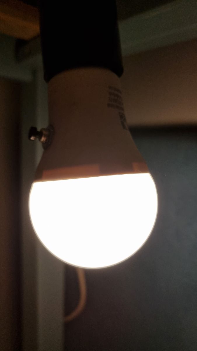

    Dark Man wrote:
    Great, great job, but can you somehow make it so that when you hold the button (OnHold), when it reaches 100% brightness, the brightness again starts from zero or starts to go down, and at zero it goes up again.
    Good point, will you check?
    https://github.com/openshwprojects/OpenBK7231...mmit/8bb86176c8e603bb6fa5e73784aff366d8750c00
    It works great - my son (8 years old) is happy and I'm happy, because he used to use some strong dummy wall lamp suspended from the bottom of the bunk bed and often left it on, so now I can turn it off automatically at night and when I'm away from home :)
    [BK7231T] My HTTP server, configurator, MQTT support from Home Assistant [BK7231T] My HTTP server, configurator, MQTT support from Home Assistant
    I tested it for a while and sometimes it happened that the doubleclick function was activated while holding the button, but I think it's probably the fault of the button itself rather than the program.
