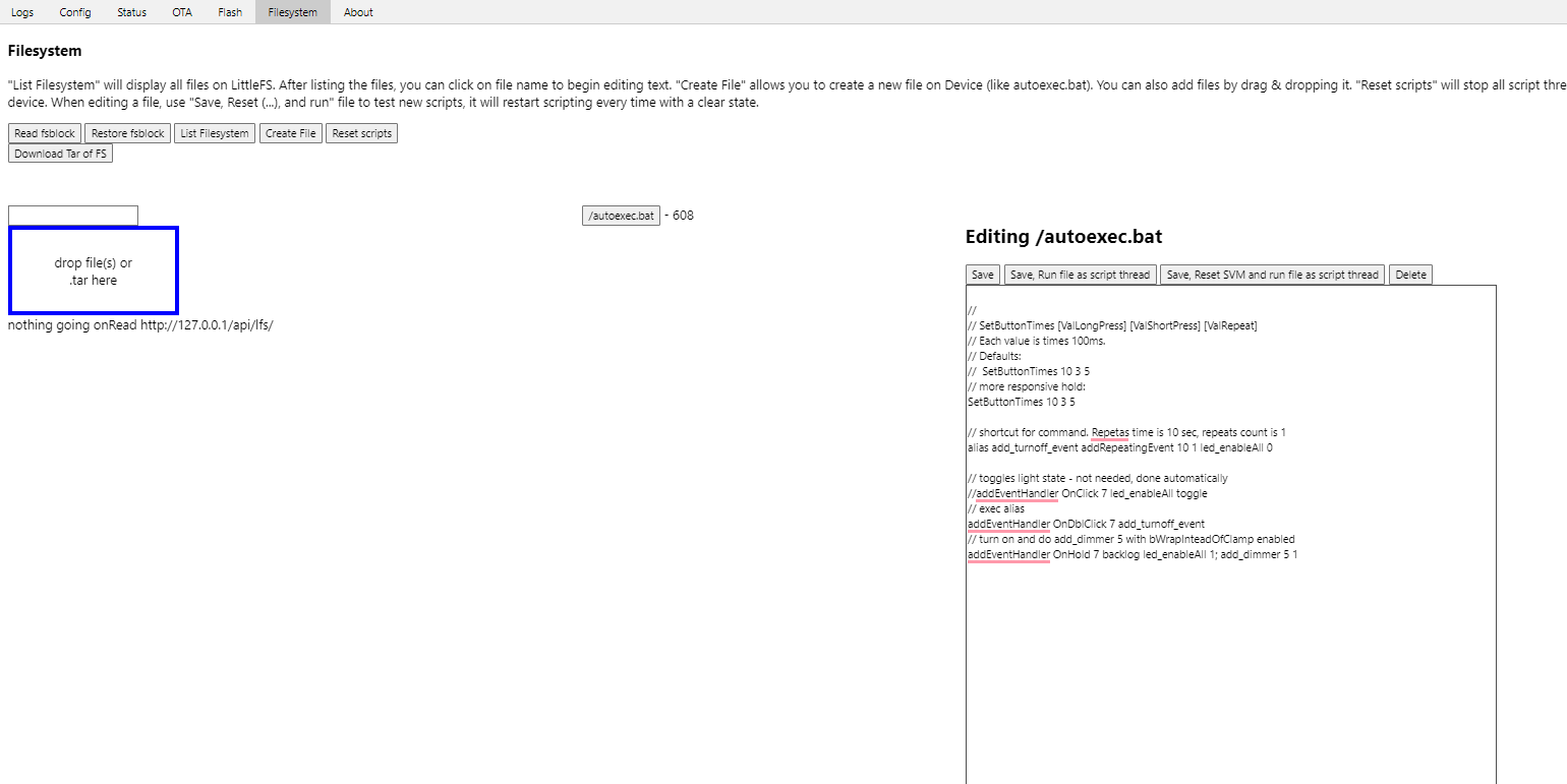

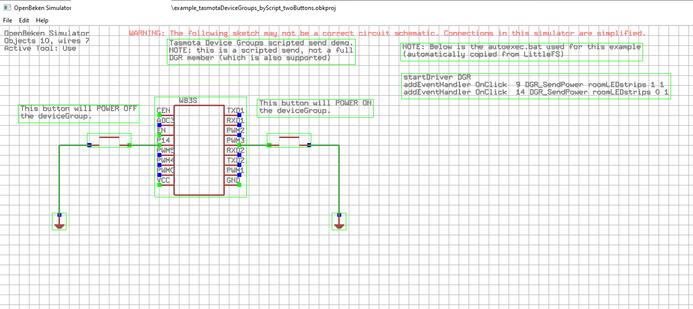

  • Windows OpenBeken simulator with LittleFS emulation announced
    #1091 20326478
    Posts: 14725
    Rate: 12810
    @ferbulous this script might need some fixes, but in general, if the "ping watchdog" doesn't work then I am not sure what might be happening. We might need to investigate it a bit more, any possibility of getting UART log of such device?
    In worst case I might consider adding some kind of self-logging history to the LittleFS.....

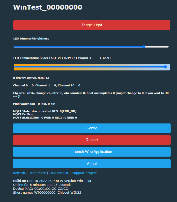

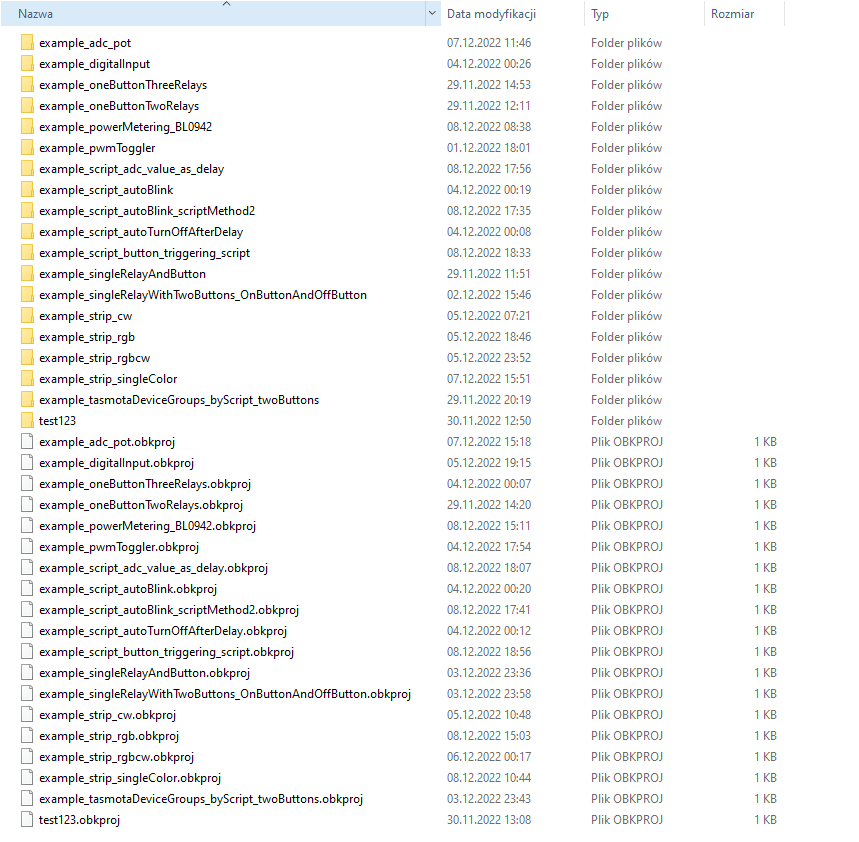

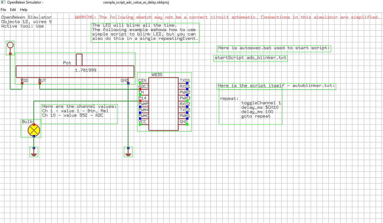

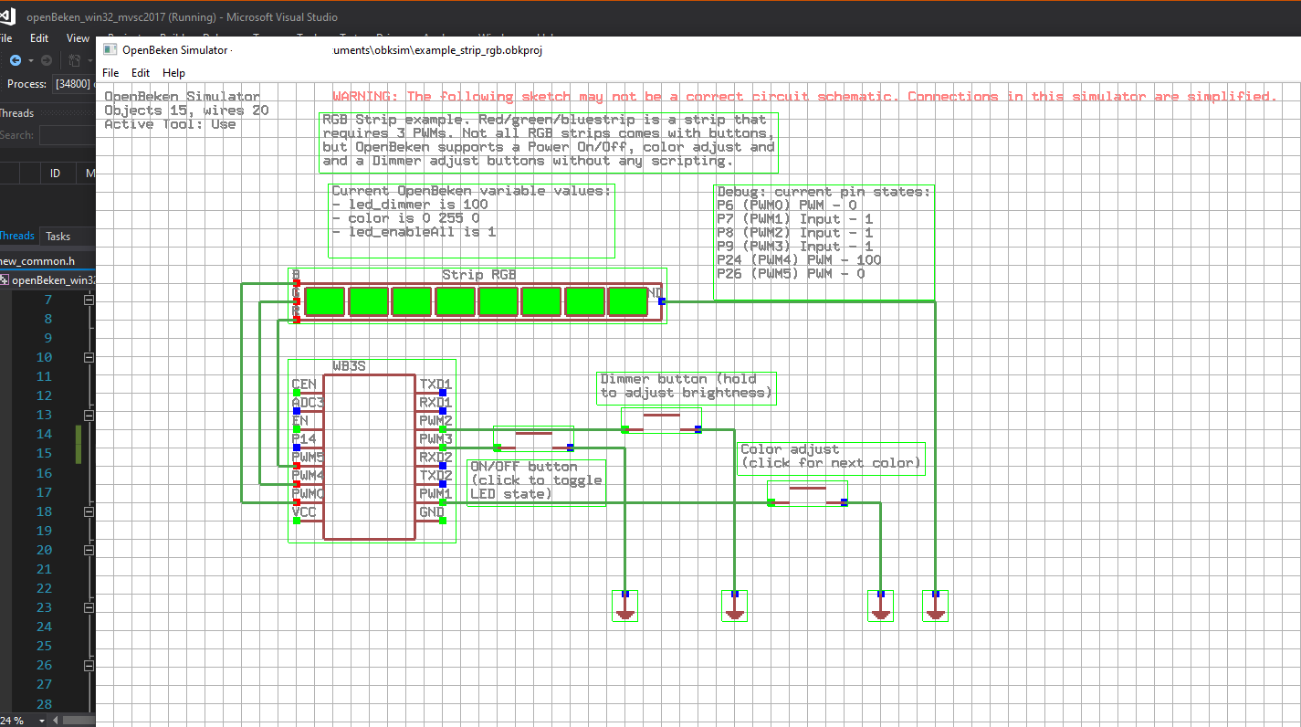

    Important release coming:
    We will have a working IoT device simulator soon. It's basically an OpenBeken running on Windows with extra schematic editor. It will allow you to write scripts and test them easily on your PC. You can also export your design and send it to me, so I can check the scripts, etc, etc.
    Examples:
    @ferbulous , I remember you had very good ideas for scripts, can you take the time and list here what you'd think would be cool to do with scripting?
    We can even send power usage data (voltage, current, etc) to PHP server with our scripting system and SendGet command.
    OpenBeken development will now go really fast, with the ability to run firmware on Windows... our Windows port can even control Tasmota Device Groups devices (send and receive!), send HTTP GET's and much more... even LittleFS is emulated on Windows.

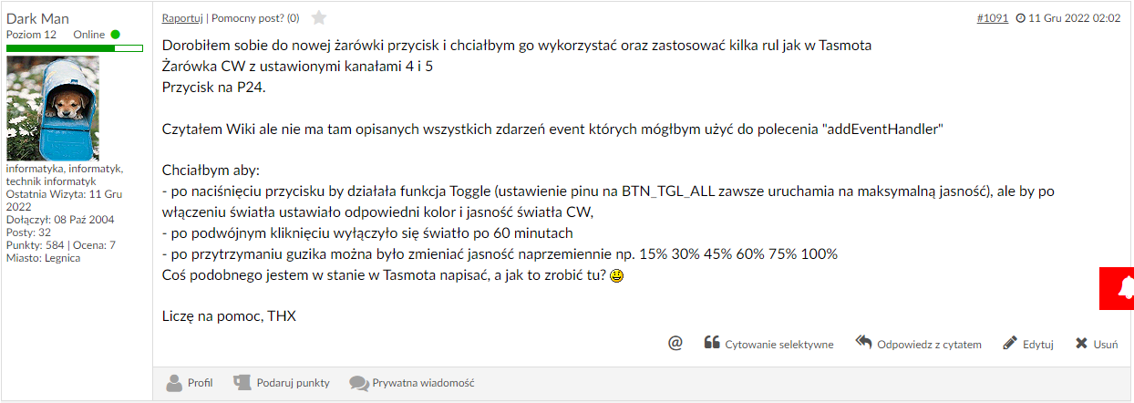

    I made a button for a new light bulb and I would like to use it and apply a few rolls as in Tasmota
    CW bulb with channels 4 and 5 set
    Button on P24.
    I've read the Wiki but it doesn't list all the event events that I could use for the "addEventHandler" command
    I would like:
    - after pressing the button, the Toggle function would work (setting the pin to BTN_TGL_ALL always activates the maximum brightness), but after turning on the light, it would set the appropriate color and brightness of the CW light,
    - when double clicked, the light turned off after 60 minutes
    - after holding down the button, you could change the brightness alternately, e.g. 15% 30% 45% 60% 75% 100%
    I am able to write something similar in Tasmota, but how to do it here? :)
    I'm counting on your help, THX

    See this simulation (made on "Virtual OpenBeken" on Windows):
    Code:
    // SetButtonTimes [ValLongPress] [ValShortPress] [ValRepeat]
    // Each value is times 100ms.
    // Defaults:
    //  SetButtonTimes 10 3 5
    // more responsive hold:
    // shortcut for command. Repetas time is 10 sec, repeats count is 1
    alias add_turnoff_event addRepeatingEvent 10 1 led_enableAll 0
    // toggles light state - not needed, done automatically
    //addEventHandler OnClick 7 led_enableAll toggle
    // exec alias
    addEventHandler OnDblClick 7 add_turnoff_event
    // turn on and do add_dimmer 5 with bWrapInteadOfClamp enabled
    addEventHandler OnHold 7 backlog led_enableAll 1; add_dimmer 5 1
    Save the version you have now and you probably need to OTA to the latest version, but I'm not sure.
    The button has the second channel set to 10 (unused channel) to bypass the default behavior of changing its state when double clicked
