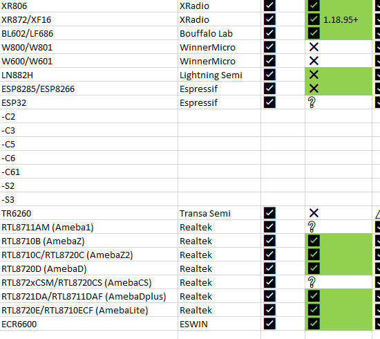

    >>21615185
    I see
    are one row now in platforms.md. I have a yes for WPA3 on DN, presumably yes for CS too
  • #1262 21630210
    insmod
    Posts: 1397
    Help: 164
    Rate: 436
    >>21630205
    ECR6600 supports WPA3?
    Is it with current or with new?
    Does Ameba1/AmebaZ support it?
    LN882H will support WPA3 by default in next release.
  • #1263 21630212
    Posts: 5065
    Help: 438
    Rate: 893
    I have ticks in spreadsheet from testing a couple of weeks ago,
    Wi-Fi module comparison chart showing WPA3 support
    I don't have any Ameba1 but I'm sure you posted that Ameba1 supports WPA3 if AmebaZ does. Have I imagined that? I can't find the post.
    I reverted Ameba1 to unknown for WPA3

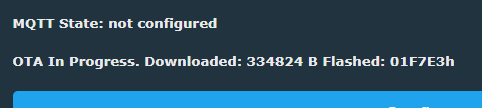

    I am making now OTA_Progress guard check public. I will probably also disable driver ticks when OTA is in progress. However, the OTA_Progress is not implement for other OTAs already, so I have to add it as well.
  • #1277 21635872

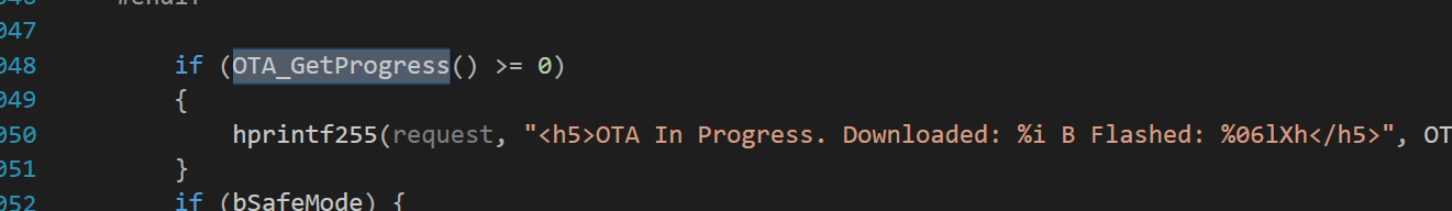

    Help: 655
    Rate: 12639
    Latest commit is this:
    https://github.com/openshwprojects/OpenBK7231...mits/ffa9ab6f6140b2aaf16346d6f44de04f3feada73
    This should make OTA_GetProgress different than -1 on OTA start on every platform - at least for web app OTA. This should lock drivers and show this message (albeit without valid size info) on HTTP page:
    C code snippet checking OTA progress using OTA_GetProgress
    This should be good enough for the start, but at this stage, it won't track how many bytes were flashed... we would need to connect this counter per each platform, as we don't have universal "OTA_FLASH"-style API

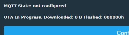

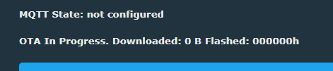

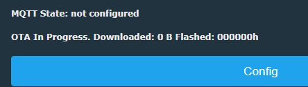

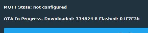

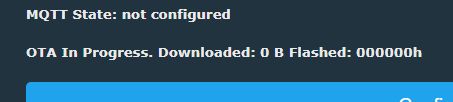

  • #1279 21636006
    Posts: 5065
    Help: 438
    Rate: 893

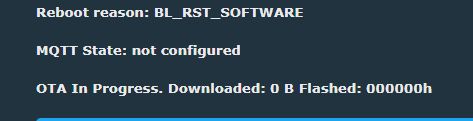

    BL602
    1.18.140 -> 1762_merge_9817f031a022 -> 1.18.154 ✅
    Screenshot with system info: reboot reason, MQTT state, and OTA update progress
    W800
    1.18.145 -> 1762_merge_9817f031a022 -> 1.18.154 ✅
    OTA status in progress. Downloaded: 0 B, Flashed: 000000h
    BK7231U
    1749_merge_d7303c6b5b1d -> 1762_merge_9817f031a022 -> 1.18.154 ✅
    Screen showing OTA status with 0 B downloaded and 033000h flashed
    this kind of test result ?
    Added after 27 [minutes]:
    W600
    patch-1_387f507681ec -> 1762_merge_9817f031a022 -> 1.18.154 ✅
    OTA screen showing software download and flashing progress
    ESP32S3
    1.18.102 -> Aug 15 2025 14:55:52 version ESP32S3_Test (ESPs don't have build variable thing yet) -> 1.18.154 ✅
    Screenshot: OTA In Progress. Downloaded: 0 B Flashed: 000000h message displayed

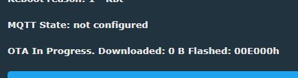

    BK7231N (old SDK)
    1762_merge_9817f031a022_sensors -> 1.18.154 ✅
    OTA update screen showing: 0 B downloaded, 00E000h flashed
    BK7231N (ALT)
    1.18.154 -> 1762_merge_9817f031a022 -> 1.18.154 ✅
    OTA interface with message: Downloaded: 0 B Flashed: 004000h
    how granular - platform/variation etc?
    Added after 25 [minutes]:
    ESP8266

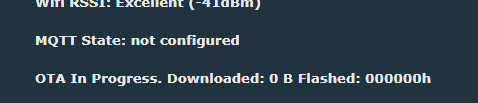

    no progress
    MQTT State: not configured text above a blue 'Config' button
    LN882H
    Screen showing OTA status: 0 B downloaded, 0 B flashed

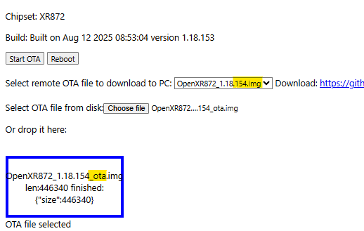

    XF16/XR872
    1.18.140 -> 1762_merge_9817f031a022 ✅ -> 1.18.154 ❌
    says it's flashing but then doesn't reboot. after manual reset it comes back up as 1762_merge_9817f031a022
    OTA Status: in progress, no data downloaded or flashed yet
    Added after 39 [minutes]:
    WAIT. XF16 OTA does work. I've been using the downloaded file from quick list which is UART flash file not OTA, Will find and do PR
    Screenshot of OTA interface for XR872 chipset with 1.18.154 file selected
    so..

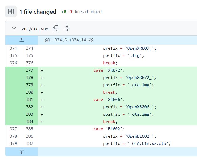

  • #1280 21636077
    Posts: 14622
    Help: 655
    Rate: 12639
    Oh, so we accidentally found Web App bug, nice! Thank you for testing
  • #1282 21636131
    Posts: 14622
    Help: 655
    Rate: 12639

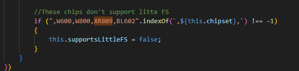

    Yes, this needs to be done:
    Code change in vue/ota.vue: XR872 and XR806 cases added with specific prefixes and postfixes
    Variants are not covered at all there yet, it's open question how to handle them. Probably just put them on the same list and hope that users can read...

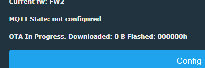

    Rate: 893
    ECR6600
    MQTT State not configured, OTA in progress, 0 B downloaded, 000000h flashed
    RTL87x0C
    MQTT state and OTA progress message with a Config button
    RTL8710B
    OTA progress interface showing 0 bytes downloaded and 0 flashed
    XR806
    MQTT state not configured, OTA update in progress, 0 B downloaded

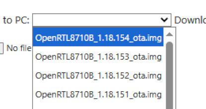

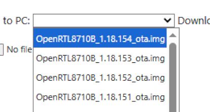

    added RTL-A/B/D/DA/E and ECR6600
    Added after 21 [minutes]:
    yay
    List of .img files for OpenRTL8710B versions 1.18.151 to 1.18.154
    just missed some late RTLs by a few seconds :)
    https://github.com/OpenBekenIOT/webapp/pull/214

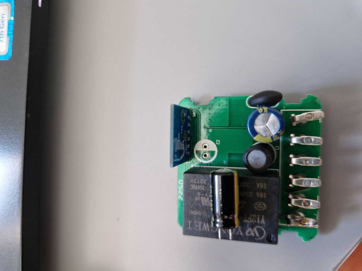

    rysiulg wrote:
    Testowaliścoie może wersje 2 portowy przełącznik bez N, ale również aktywowany z pilot 422MHz? -będzie to działać?
    Chip CB2S, RX i TX podlaczony do pinów układu SC92F8363BX z którego wyprowadzone są piny ?GND?VCC oraz uklady zh1620h i mniejszy 590R 2149
    Touch-sensitive light switch with two buttons on a white panel.
    Moes smart switch with labeled terminals and technical specifications visible on the cover, viewed from above.
    Printed circuit board with electronic components inside a plastic housing, likely a wall thermostat.
    Green PCB board with visible tracks and a pin connector.
    Green PCB with a CB2S communication module and electronic components on a background with notes.
    Yes it's Tuya. It is possible to read/write thsi MCU as BK7231N but this is only maybe part of communication module it communicate with components only by internal RX/TX. SC92F8363BX makes direct input output connections -so mapping in BK7231N -doesn't make sense without debugging RX/TX communication -so more complicated do convert;( -Model WS-EU-L (Single Live)

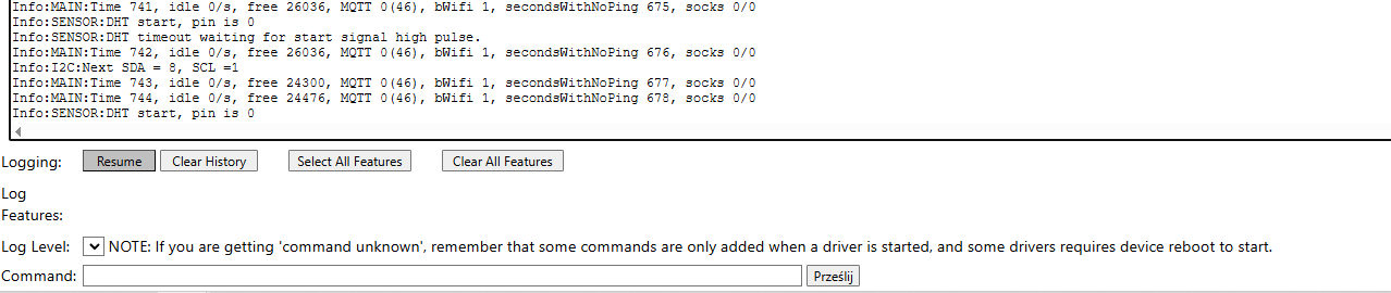

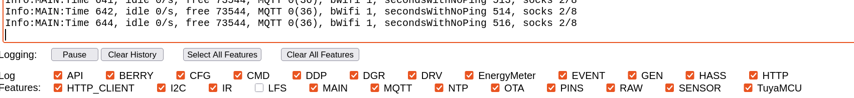

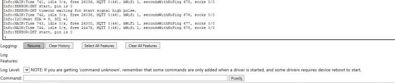

  • #1285 21759033
    Posts: 14622
    Help: 655
    Rate: 12639
    Is it just me or did something break in recent release with logging flags (features)? I may have missed something in Girier MCU pull request. Not sure right now. Can anyone confirm?
    Diagnostic interface screenshot with DHT sensor logs and MQTT connection info.
  • #1286 21759041
    insmod
    Posts: 1397
    Help: 164
    Rate: 436
    >>21759033
    Ok on #1869 pr, RTL8720D
    Screenshot of logging interface with debugging features enabled

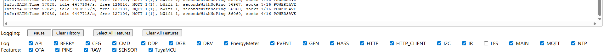

  • #1287 21759124
    max4elektroda
    Posts: 756
    Help: 48
    Rate: 187
    Same here - working fine on W800 - PR #1792 (DS3231):
    System logging interface with function list and selection options
