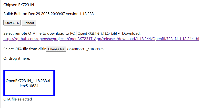

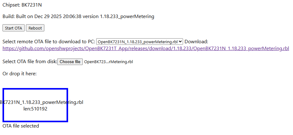

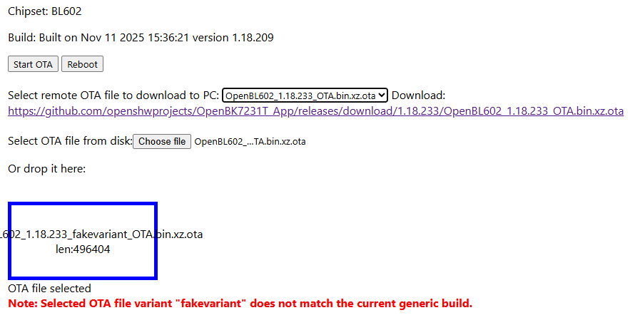

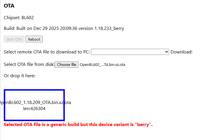

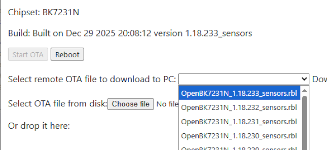

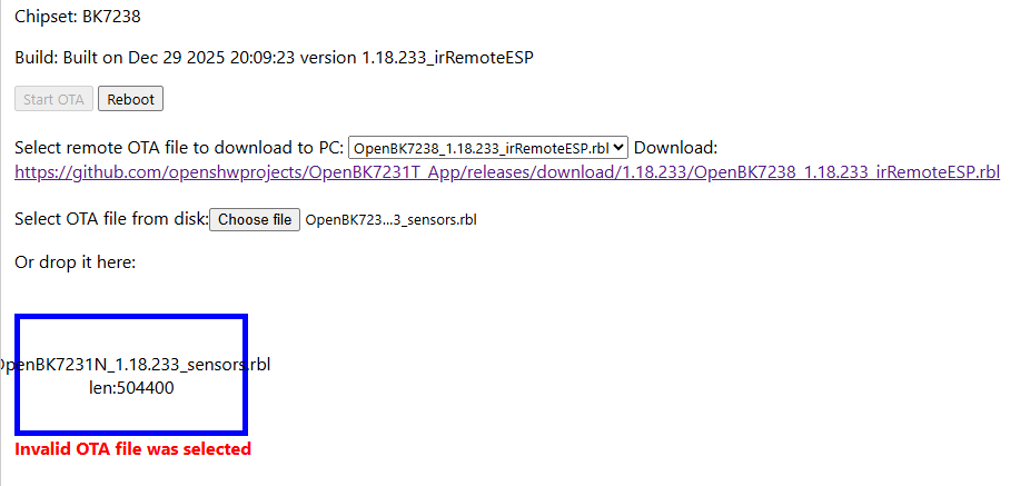

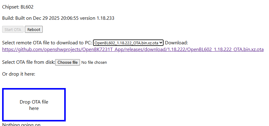

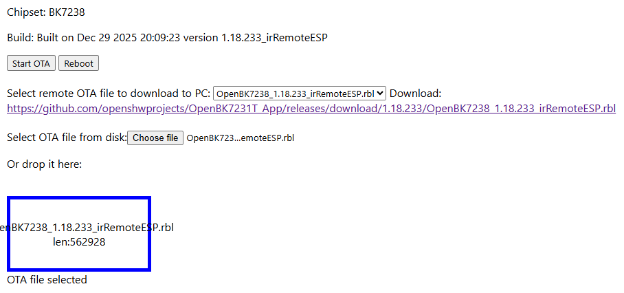

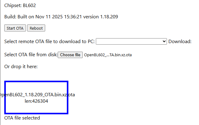

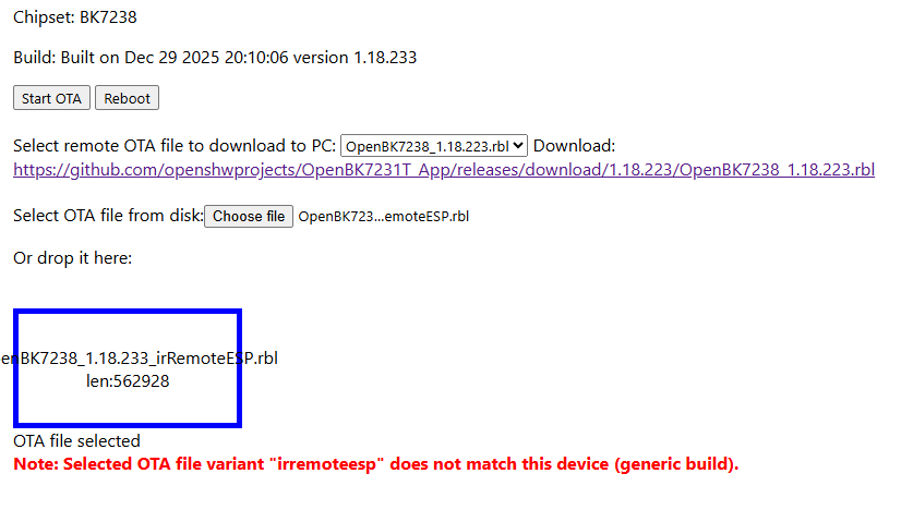

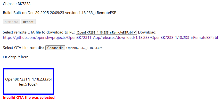

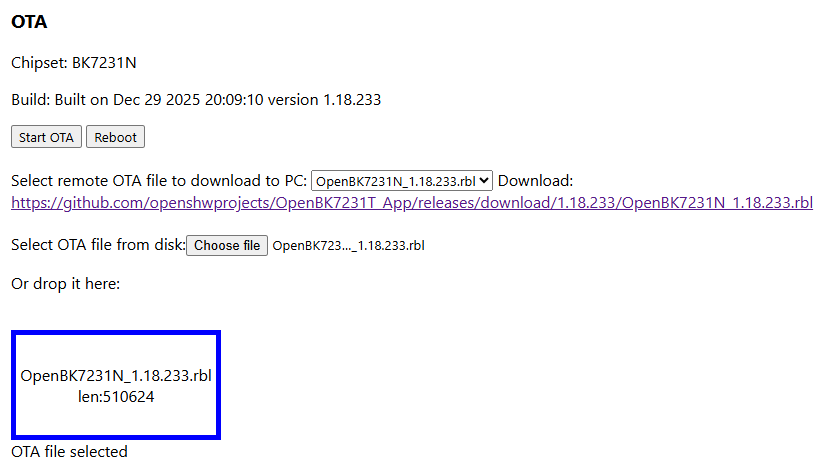

    divadiow wrote:
    and I guess all the new variants need catering for too or users will OTA to default release?
    just playing with this https://github.com/OpenBekenIOT/webapp/compare/main...divadiow:OpenBekenIOT-webapp:hlwota
    the intention being that OTA now prefers Open<chip>_<ver>_<variant>.rbl (chip + variant) based on the device’s build suffix, and falls back to Open<chip>_<ver>.rbl (generic) if no variant asset exists.
    seems OK so far, but needs more testing.

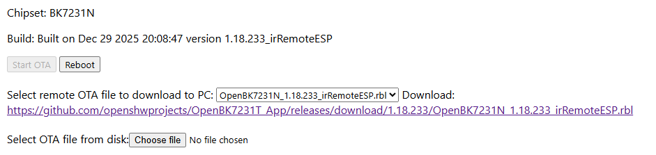

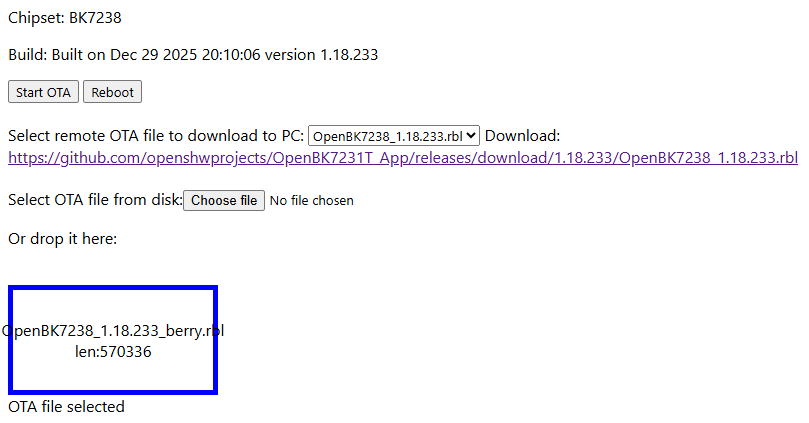

    Dropdown list showing OTA files for OpenBK7231N, versions from 1.18.230 to 1.18.233_sensors
    OTA interface showing BK7231N chipset and file OpenBK7231N_1.18.233_irRemoteESP.rblOTA interface with selected file OpenBK7231N_1.18.233.rbl for upgrade
    OTA interface for BL602 chip with selected update file and its sizeOTA interface with selected OpenBL602_1.18.209_OTA.bin.xz.ota file
    OTA interface with BK7238 chipset and OpenBK7238_1.18.223.rbl file selected
    let's you go from generic to variant at the moment
    OTA interface with selected file BK7238_1.18.233_irRemoteESP.rbl
    OTA interface for BK7238 with buttons, file selector, and download link
    currently with hard-block if choosing different variant
    OTA error: selected file powermetering doesn't match device variant sensors
    doesn't cater for the _ALT variants though as they're not as <buildver>_ALT in /api/info

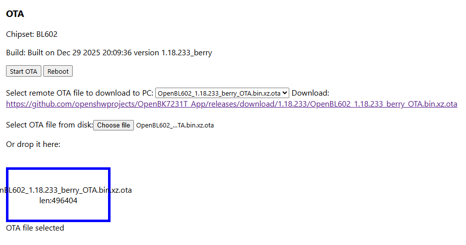

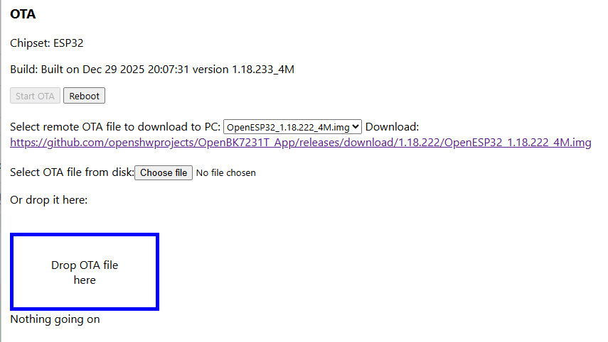

    Added after 51 [minutes]:

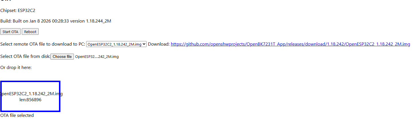

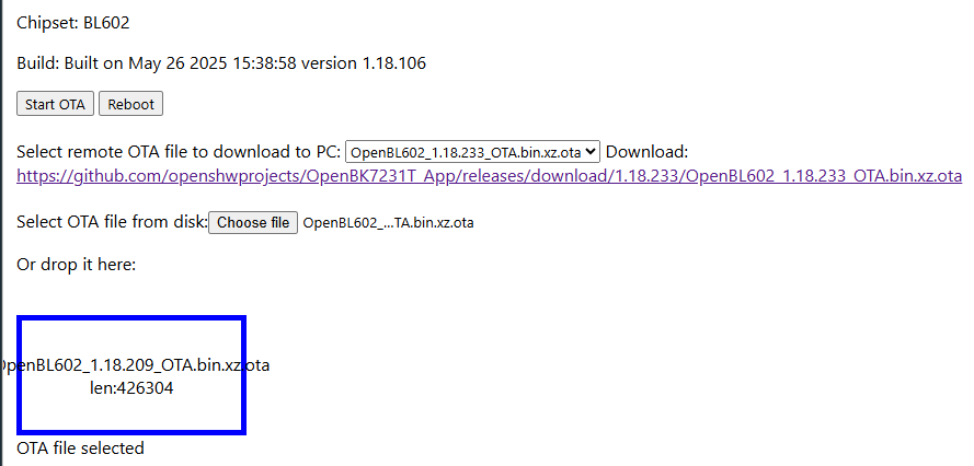

    ESP+BL602 ota extension for variants https://github.com/divadiow/OpenBekenIOT-webapp/commits/hlwota/
    OTA interface with OpenESP32S2_1.18.233_4M.img file selected for download
    OTA interface with file selection and ESP32 version information
    OTA interface with file upload field and chipset version details displayed
    OTA interface with chipset info and option to upload .ota file

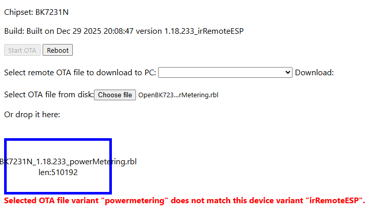

    should I pursue this or is the code rubbish?

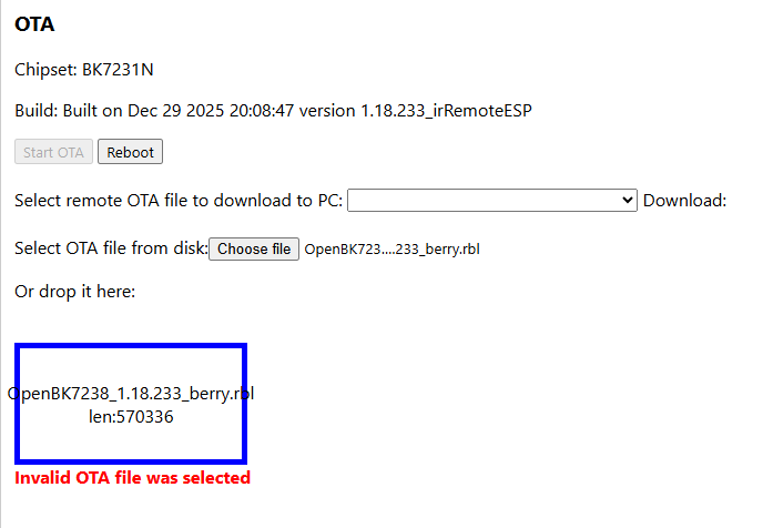

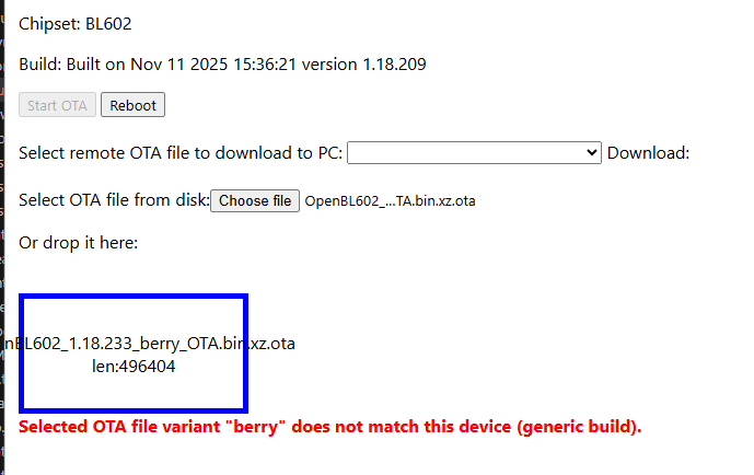

    Added after 1 [hours] 1 [minutes]:

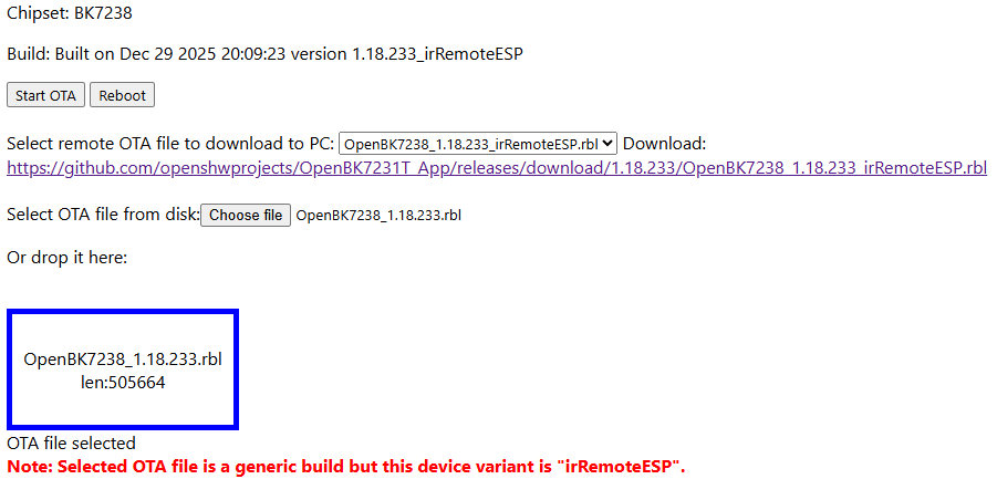

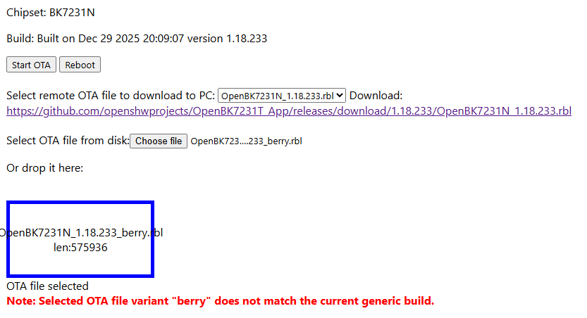

    latest commit doesn't allow any variant cross-flashing. legacy wrong chipset "invalid ota file was selected" warning remains intact
    Selected OTA file is a generic build for BK7231N; device needs irRemoteESP variant
    OTA interface showing error after selecting mismatched OpenBK7238 file for BK7231N
    OTA error: file variant powermetering does not match device irRemoteESP
    OTA interface with selected file OpenBL602_1.18.209_OTA.bin.xz.ota
    OTA error: variant berry does not match this device (generic build)
    OTA screen with OpenBL602_1.18.209_OTA.bin.xz.ota file and device variant berry
    Personally I think this is too much. I think a warning would be fine, or a switch "allow change in variants".
    Just imagine I realize I used the wrong variant or added a new sensor and can't change to the needed file.
    Just as a possible extension, no idea if/how to realize (but my PR to include the defines in a build might be a start): The top version would be to extract the drivers per variant so the user can see/decide if the variant fits the requirements.
  • #1296 21797177
    Posts: 5076
    Help: 441
    Rate: 899

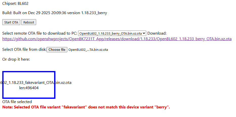

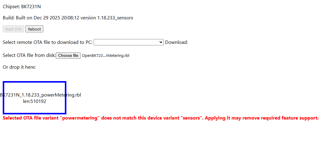

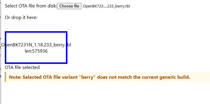

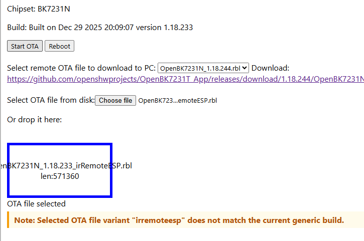

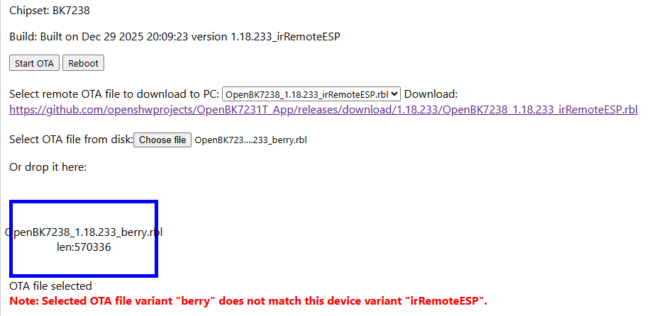

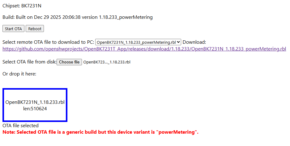

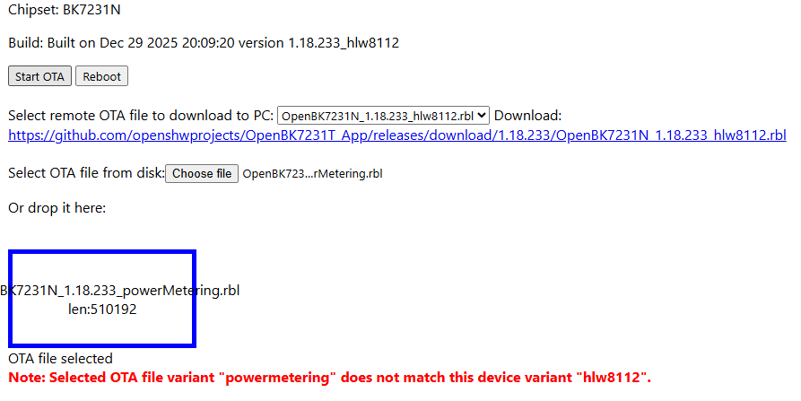

    I agree. I had imagined directing people to the other OTA option in main gui, but why make it unnecessarily hard. A warning note would be enough

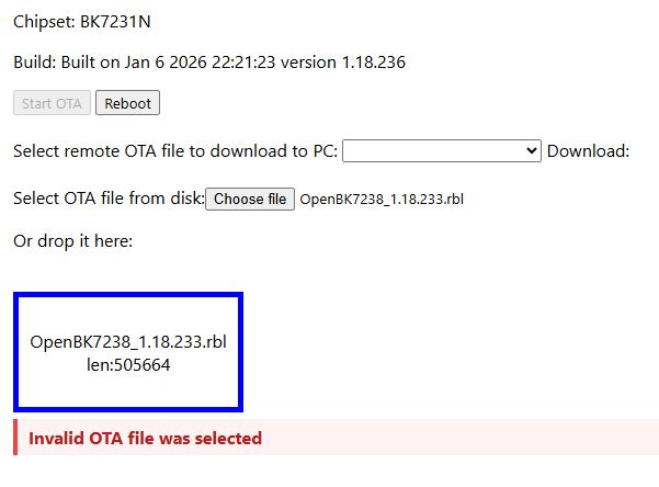

    Added after 1 [hours] 2 [minutes]:
    Relaxed.
    Warning generic->variant
    Warning variant->generic
    Selected OTA file is a generic build; device requires irRemoteESP variant.
    warning variant->variant
    OTA file with variant berry selected but does not match device variant irRemoteESP.
    block still for wrong platform
    Error: invalid OTA file selected during firmware update attempt

    Thanks, this change really improves the usage in a very helpful way!

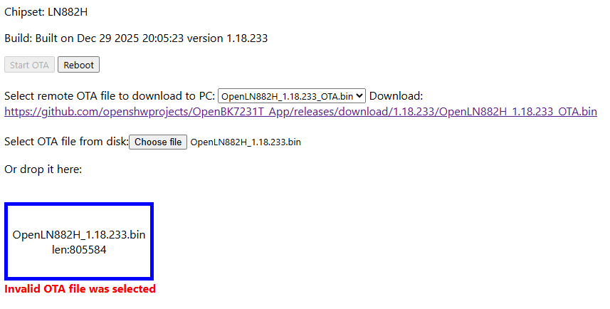

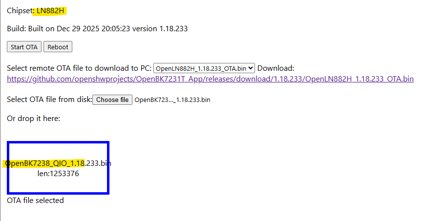

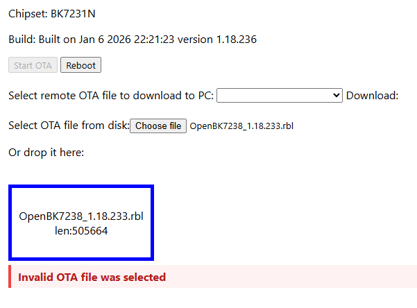

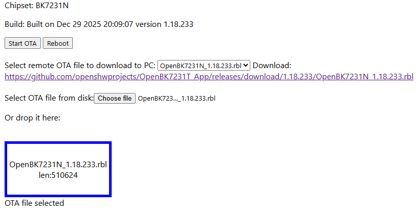

    Added after 1 [hours] 4 [minutes]:

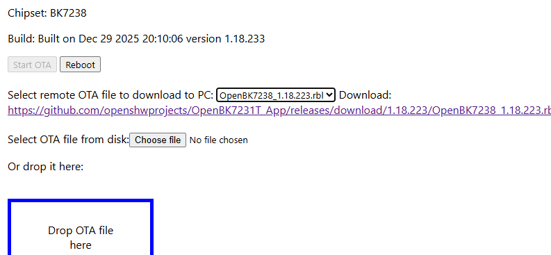

    it seems LN882H only matches on file extension so will look to add filename pattern check too

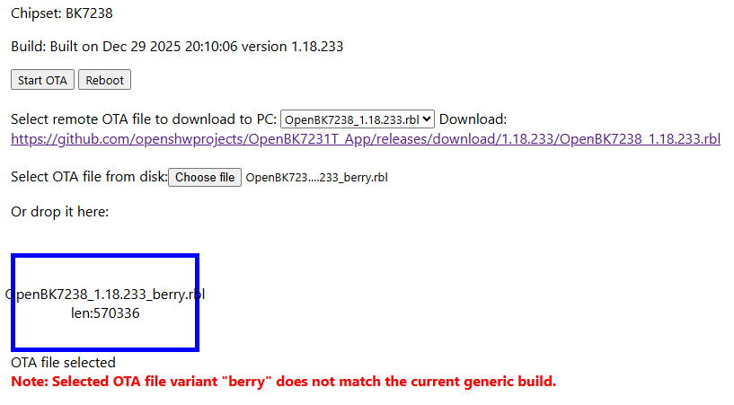

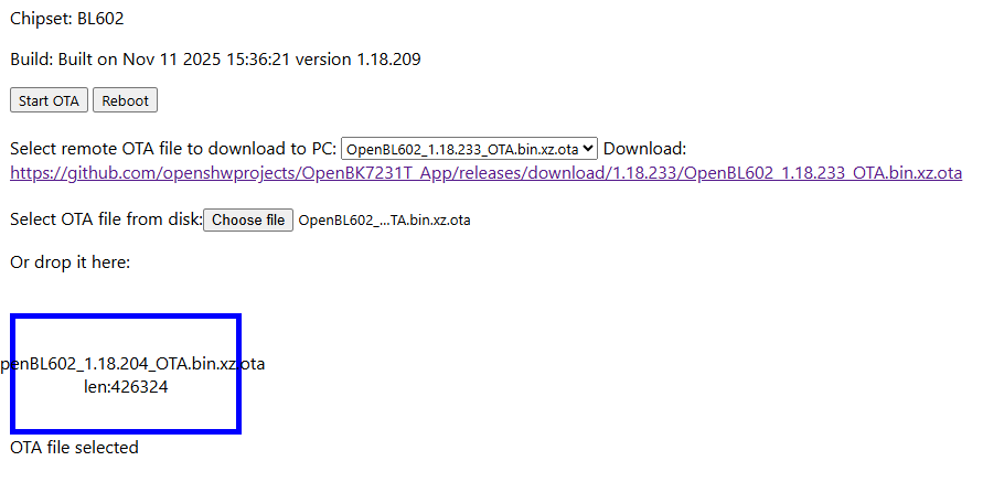

    Added after 2 [hours] 1 [minutes]:
    LN882H
    wrong chipset
    LN non-OTA
    correct LN OTA
    BL602
    variant listing + accept variant OTA
    warn on variant to generic
    generic listing + warn on generic to variant
    warn on variant to variant (future-proofing)
    no warning on same to same generic
    BK7238
    wrong chipset

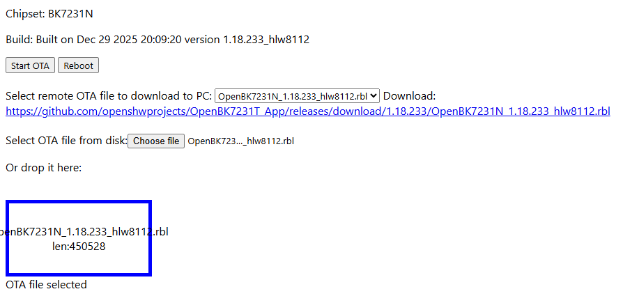

    BK7231N
    wrong chipset
    PR if this looks OK: https://github.com/OpenBekenIOT/webapp/pull/248

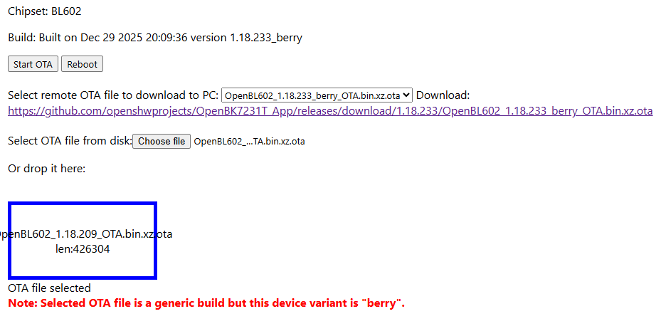

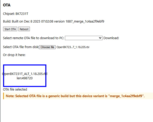

  • #1299 21802662
    Posts: 14637
    Help: 655
    Rate: 12649
    The NOTE (warning) should be orange, not red, red is same as error. OBK is very user friendly and we should try our best to maintain it, so all error messages are clean and readable.
  • #1301 21802788
    Posts: 14637
    Help: 655
    Rate: 12649
    Even better than before, merged. Any other easy improvements at hand?
  • #1302 21802803
    Posts: 5076
    Help: 441
    Rate: 899
    yay cool, thanks! Hope I didn't miss anything major.
    "invalid" class style wasn't committed ;)
    https://github.com/OpenBekenIOT/webapp/pull/252
    note showing on live device now
    OTA interface screenshot with selected OpenBK7231T file and compatibility warning

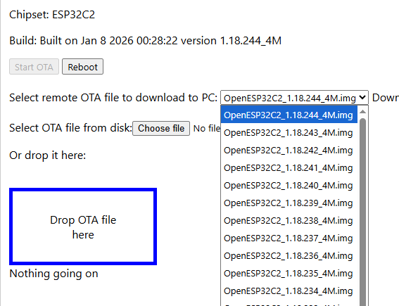

    now showing ESP32 OTA variants available
    OTA interface with file dropdown menu and drop area for uploading a file
    OTA update screen with ESP32C2 chipset info and selected firmware image file

    insmod
    Posts: 1403
    Help: 164
    Rate: 440

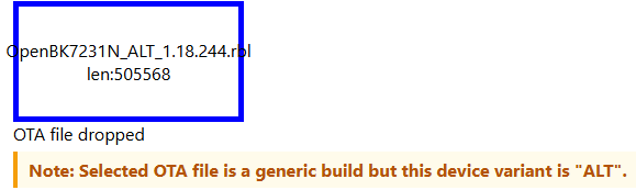

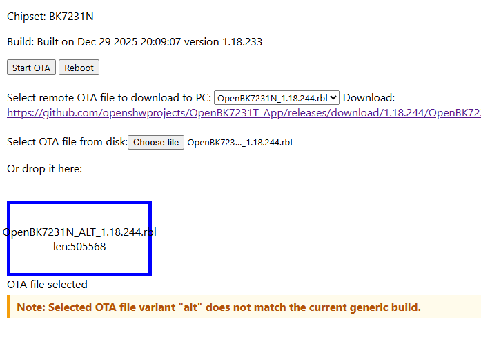

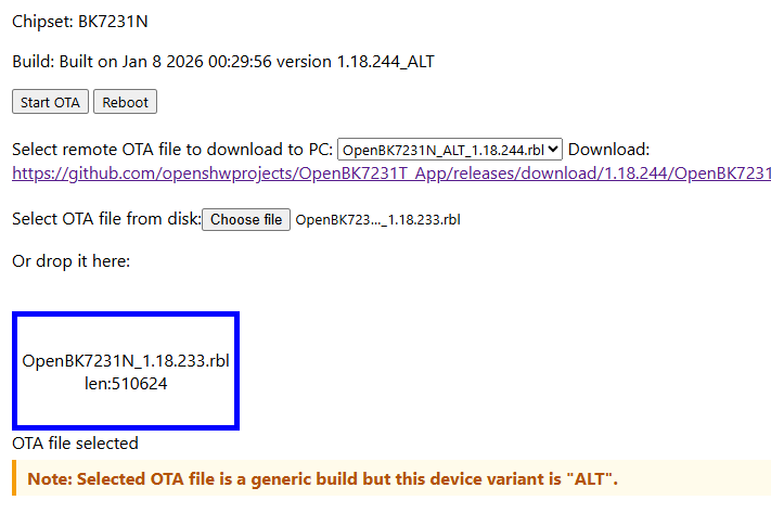

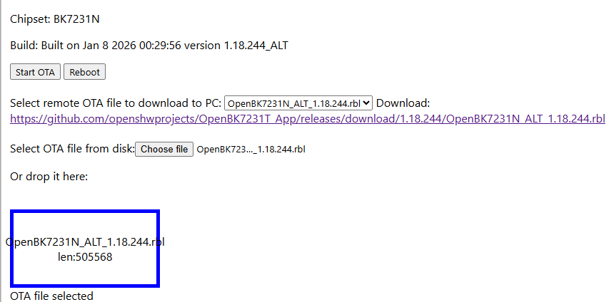

    In ALT builds, _ALT is appended to version since 1.18.235
    OpenBK7231N_ALT_1.18.244.rbl file loaded into OTA system

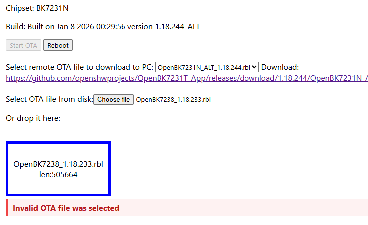

  • #1306 21802968
    Posts: 5076
    Help: 441
    Rate: 899
    ah OK.
    It was only matching on <version>_<variant>.rbl but the _ALT rbls are eg OpenBK7231T_ALT_1.18.244.rbl whereas actual variants are eg OpenBK7231N_1.18.244_hlw8112.rbl
    with https://github.com/OpenBekenIOT/webapp/commit/9c923cc14550d472a5c21b70acb7043dbd671ff9
    _ALT to ...

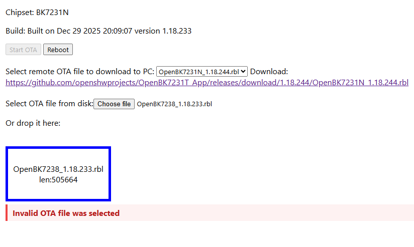

    Selected OTA file OpenBK7231N_ALT_1.18.244.rbl with size 505568 bytesError message after attempting to upload OTA file OpenBK7238 to BK7231N device Screenshot with error message when selecting OTA file of mismatched variant. Selected OTA file OpenBK7231N_1.18.233.rbl mismatches current device ALT variant
    non _ALT to ...
    OTA file OpenBK7238_1.18.233.rbl selected but error message is shown. Uploaded OTA file is OpenBK7231N_ALT_1.18.244.rbl; a mismatch warning appears regarding the variant. Error message during OTA upload attempt for BK7231N chipsetOTA update interface for BK7231N chipset with selected .rbl file version
    this does treat _ALT as a variant though rather than a generic/base release in its own right
    Added after 11 [minutes]:
    is const preferred over let to keep same as others?
    https://github.com/OpenBekenIOT/webapp/commit/08f8a52f2d3618b2a27c973b242b984d9d6dc8ad

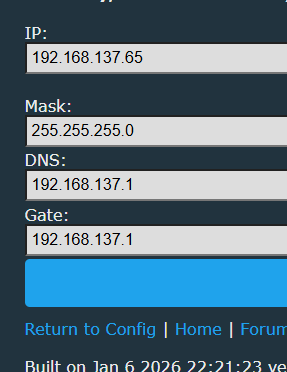

  • #1308 21803307
    Posts: 5076
    Help: 441
    Rate: 899

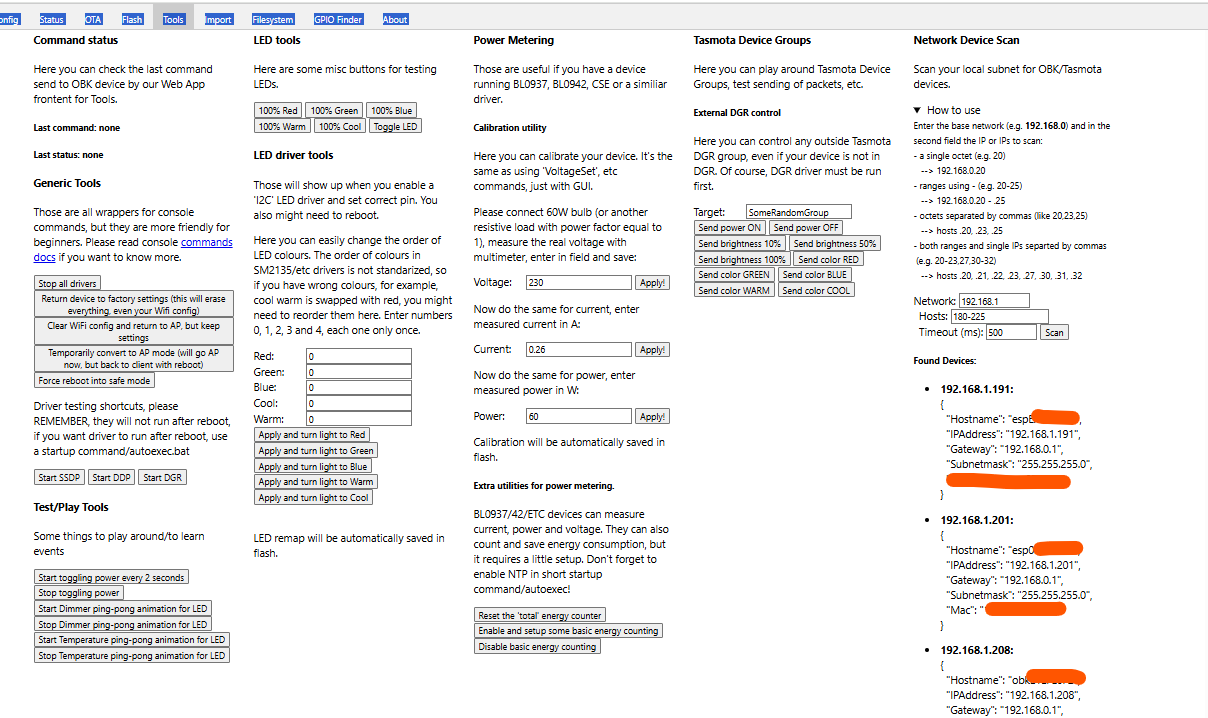

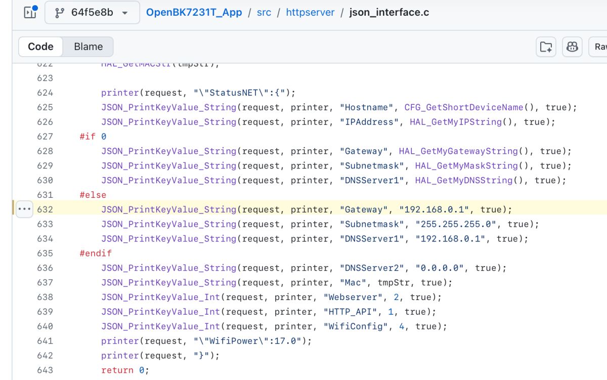

    Can you help me test and review this by @max4elektroda https://github.com/OpenBekenIOT/webapp/pull/225?
    cool. it found some stuff in the range I gave it
    Tasmota configuration interface with network scan results and diagnostic tools
    the gateway addresses returned aren't right though, which stopped further testing
    even when using Windows hot-spot the device states gateway and dns is 192.168.0.1
    http://192.168.137.65/cm?cmnd=STATUS%205
    powershell check a few and
    this doesn't appear to change with a static
    Network interface settings with IP address, subnet mask, DNS, and gateway values.
    Added after 34 [minutes]:
    my 1 Tasmota device by comparison
