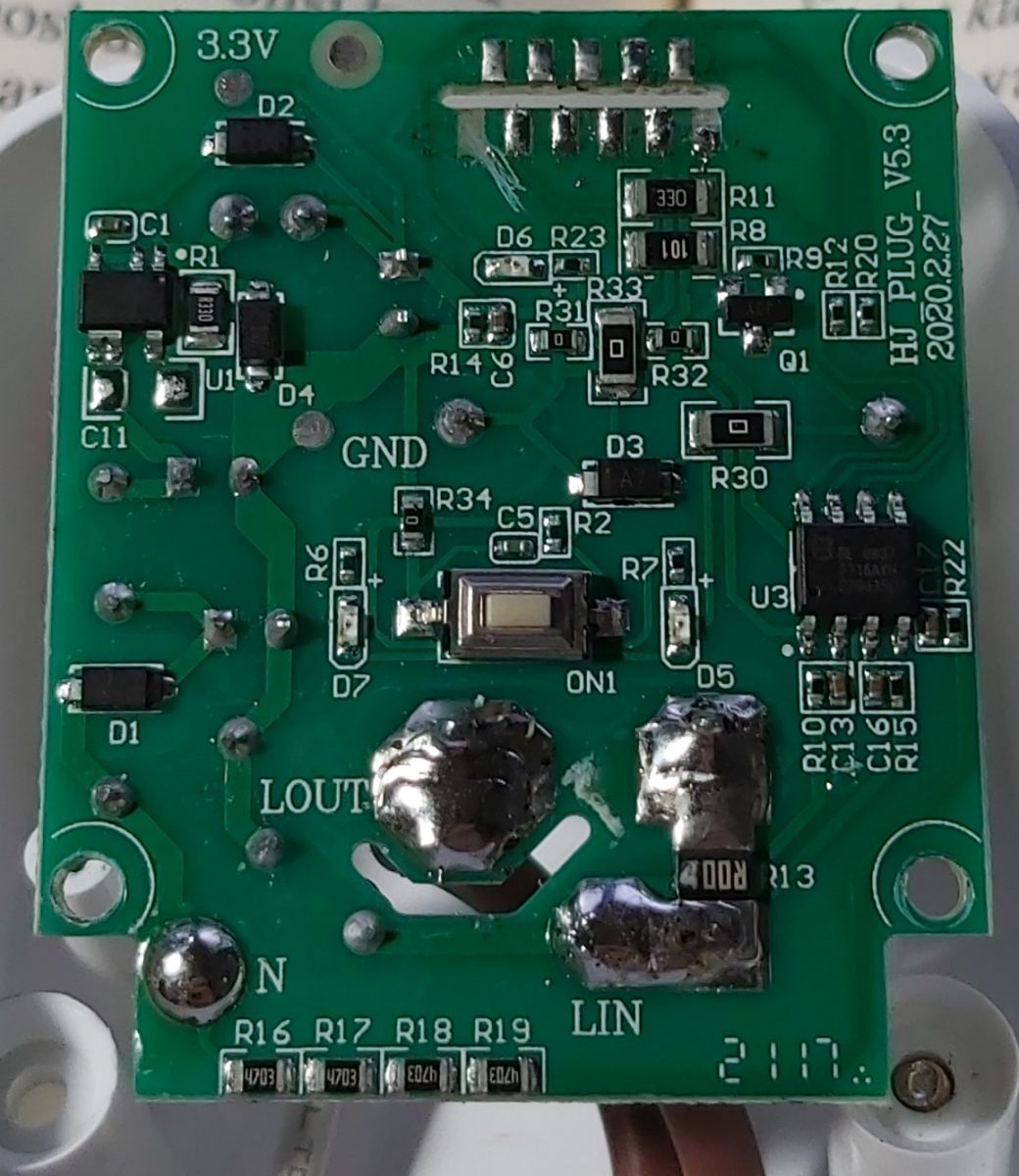

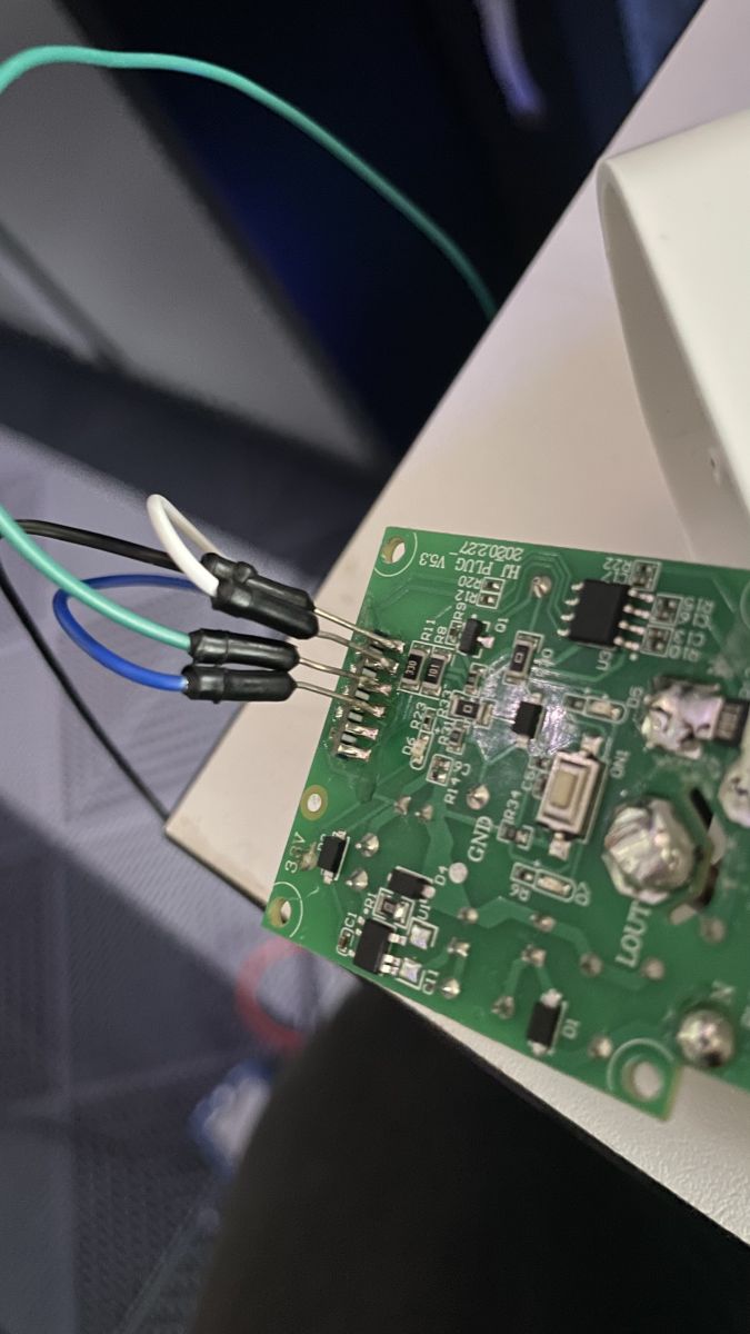

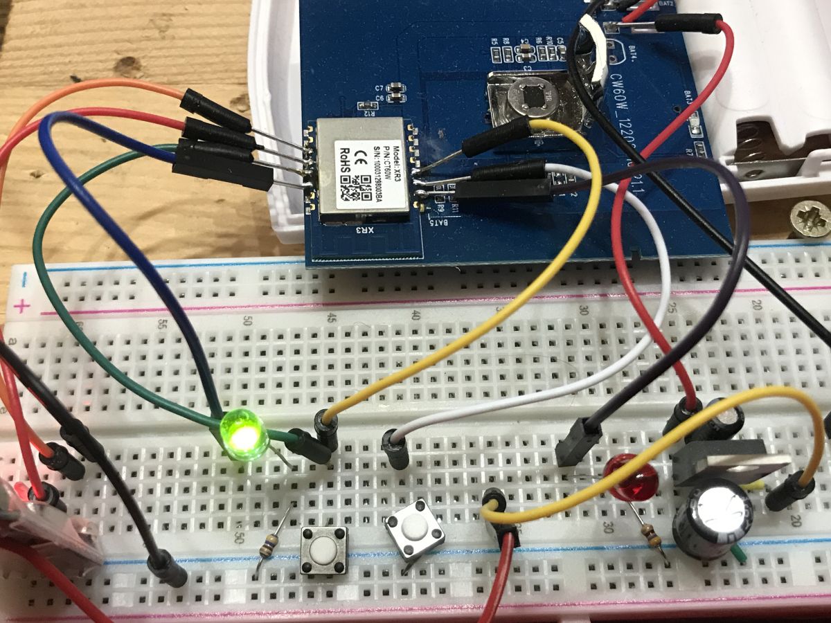

    Hi, I got this Nedis Wi-Fi Smart Plug using the WS2B. I connected the pins directly to the WS2B but I can't get Beken Writer to write. It always times out/fails. I only have one UART connected (as I don't own two currently) so I cant really see what is happening. When running the writer I can hear the relay in the Smart Plug going on and off (after pressing "Program". Also the "pairing" diode keeps blinking so I guess I'm not even in boot loader. Trying to remove power and plug it back in to no avail, relay keeps clicking. Any ideas? I see you mention the "CEN pin". What is that?
    Power is separate steady 3.3V.
  • Main-board connection blocks first flash programming

    Looks like Nedis WIFIPO120FTW. I have wrecked 2 of them while desoldering whole module on the main board. No success for me when I was trying to flash when module is connected to main board. I have figured out the pins for this module and I know that WB2S TX1 bin is connected to button. No success even driving stabile 3.4VDC on external powersource. But if module is off the main board there's no difficulties to flash. But only first flash. When module is correctly flashed and soldered back, it can be reflashed normally like your picture (with CEN wire)
    If you figure out what is preventing flashing when module is connected to main board let me know. I do not want to wreck any more of them.
    pinout for WIFIPO120FTW:
    PWM0 = Led
    PWM1 = BL0937 CF
    PWM2 = BL0937 CF1
    PWM4 = BL0937 SEL
    PWM5 = Relay
    TX1 = EDIT: Connected to nothing
    RX1 = Button
    ah, and the CEN pin. When looking at your picture the CEN pin is connected opposite side of the wb2s module where it soldered to main board (pins viewed at top when VCC is right, CEN, A0, PWM0, PWM1 and PWM2). it must sorted to ground while programming.
    Module Datasheet
  • #154 19882165
    sebastian48
    Posts: 31
    Interesting. I is indeed the WIFIPO120FTW.
    Did you have the same weird relay clicking going on? Something is at least happening, it starts when trying to Program.
    So you managed to reflash if you desoldered it but then you could not solder it back?
    Could you maybe mark it on the image? I don't quite understand where you mean...

    Ah I missed the link. But just to be clear: you had to desolder the module and put it back to work? Or did you never get it to work?
    So connecting the CEN pin to GND is a momentary thing or should it be permanently there while flashing?
  • TX1 pin connection causing Nedis flashing issue
    #157 19882233
    boozeman
    Posts: 73
    I got 2 of modules flashed when totally removed from the Nedis Main board. I think that the TX1 pin causes this problem. It is connected to button. Try to desolder tx1 pin from the main board with tin cucker so there is no connection for module and main board for that pin. The other Nedis module WIFIP130FWT do not have this kind of flashing problem at all.
    Beware! the pin pads of the Nedis main board are really easily destroyed by excessive heat!

    Thanks for the quick replies. Yes I experienced this with the 3.3V pad as you can see in the picture.
    I will give it a try and report back. Thing is this one is IP44 and for outdoors which is what I need.
  • Temporary removal of TX pull-up resistor for flashing
    #159 19882265
    Posts: 14724
    Rate: 12806
    I don't think that you need to desolder whole module just because of button on TX pin. The button most likely have a pull up resistor (a resistor between pin and VDD, while a button is between pin and GND), this resistor is used to set the default high value on pin (then, if you press the button, the pin value is low).
    All you need is to desolder temporarily this pull up resistor.
    Of course, if that's the case - I haven't tested this module, but if you tell me where I can buy it for Paypal, then I will order one right away! Or if you're willing to send me one for testing...
    BTW: relay clicking during programming? Maybe the RX or TX line is used for relay control as well?

  • RX1 button uses R33 and pull-up R2 to 3.3 V
    #161 19882336
    boozeman
    Posts: 73
    Hi, my bad! It is RX1 which is connected to a button.
    TX1 pin has no traces for anywhere in this board. I try to figure out full path to RX1 to button. Button has pull down resistor to the GND (R34). RX1 goes R33 to R2. R2 is pulled for 3.3v and other end is for button.
    Relay goes PWM5 to R8, then Transistor Q1 which is connected to relay coil.

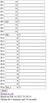

  • #163 19882469
    boozeman
    Posts: 73
    sebastian48 wrote:
    Ok so desolder RX1 then?
    Or that resistor R33. What is easier.
    If and when you get it flashed Pin configuration is likely follows (There is no support for BL0937 current measuring circuit at the moment)
    pin configuration is most likely this:
    P6 LED 1
    P10 Button 1
    P26 Relay 1
  • 5v supply at regulator avoids desoldering
    #164 19882557
    ExploWare
    Posts: 48
    boozeman wrote:
    P6 LED 1
    P10 Button 1
    P26 Relay 1
    R33 is a 0ohm link, likely R8/R11 is the pull-up in this situation, although the picture is not completely clear on that.
    On my powermeasuring plug I managed to power it with 5V at the power voltage regulator, without desoldering angthing. Check U1 on your board, I think thats identical to my U2 [BK7231T] My HTTP server, configurator, MQTT support from Home Assistant
    There I supplied the right-bottom pin with 5volt
  • R33 is a 0 ohm link to RX1
    Ah ok, The RX1 line goes via R33 to R2. That R2 must be that pullup resistor, because it's other end is connected to +3.3VDC.
    R8 is for bl0937 SEL pin and R11 for relay driver transistor. I have not encountered a similar flashing problem with other smart plugs. Another Nedis model has also RX1 for button. And one Emax plug too.

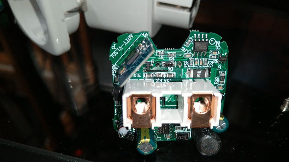

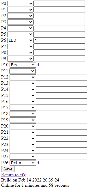

    boozeman
    Posts: 73
    The current version of BK7231T should have working OTA feature, so you don't need any wiring connection to it after flashing it once. Just make sure to flash it with latest version of OpenBK7231T, because @btsimonh did some improvements to config storage system and I am not sure if old config will be retained correctly (it might be, but I am not sure, I haven't tested it so far, I am extending support to differnt platforms right now - XR809 work in progress).
    XR809 update: I have decided to use sysinfo.c method for flash config storage.
    Hi
    OTA seems to work. Tested with de.vi.ce.ip/app link method. Seems like pin config is erased at first time. Second flash will keep pin settings.
    While testing this new webapp method at first time, I wrecked 2 of my modules :) Their MAC addresses converted to c8-47-8c-00-00-00 and I do not figure out what happened or how to Fix it. Well if there is no cure for this I have two spare modules that can be soldered in place and hope the circuit boards don't break :)
    sebastian48 wrote:
    Yes there you go. It’s probably as you mention. I will have a go tomorrow.
    Just flashed new Nedis WIFIPO120FWT at one shot. Just desolder that R33 for first flash. No need to even take the board off the plug \o/
    Pin Config:
  • MAC API added for XR809 and BK efuse save needed

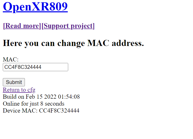

    Posts: 14724
    Rate: 12806
    That's great news! Please submit new device config by pull request. I'm happy that my 'remove resistor' trick works for you.
    XR809 config save & read is very close. I think I'm able to do a first XR809 support release this month.
    I hope that OTA hack maintainer - @btsimonh - will look into that, otherwise I'll try to come up with something, maybe API to change mac manually
    Or oh well, I changed my mind, I added MAC API right now, but I tested it only on XR809 platform so far, I think that BK might need a small fix for it to work fully:
    Probably will need to save it to efuse
  • MAC API works on BK7231T but needs efuse save

    boozeman
    Posts: 73
    Yeah, This was the only module where pulled up button causes any flash problems. That R33 (0 ohm bridge, because the board is only single sided) is also easy to desolder and solder back. I will make PR for this and another Nedis mobule. Nedis WIFIPO120FWT has power measurement circuit, so the pin config will change when BL0937 support arrives. I'll make also some info, how to open devices, what must done before first flash, etc.
    You are right about the efuse. The form works now on bk7231t but the data will not save yet.
    OTA needs some clearance to preventing damages by such "Gyro Gearloose "as I bring about. Whether both technologies require a back-end server with firmware files? The default in ota.c is http://raspberrypi:1880/firmware and this uses bin file. Using this method, the device resets to AP-mode. Settings are also erased and seems like my firmware does not update.
    Webapp method uses the rbl.file. It backups the settings, upfate firmware and restore settings ok. I quess it uses also that OTA backend http://raspberrypi:1880/firmware too?
    Webapp is hosted now by the site https://openbekeniot.github.io/webapp/
    There's setting to change webapp, but what/where is that Webapp code? Can we later bring it to private network too? So one can use the webapp without internet connection.
    Some docs needed.
