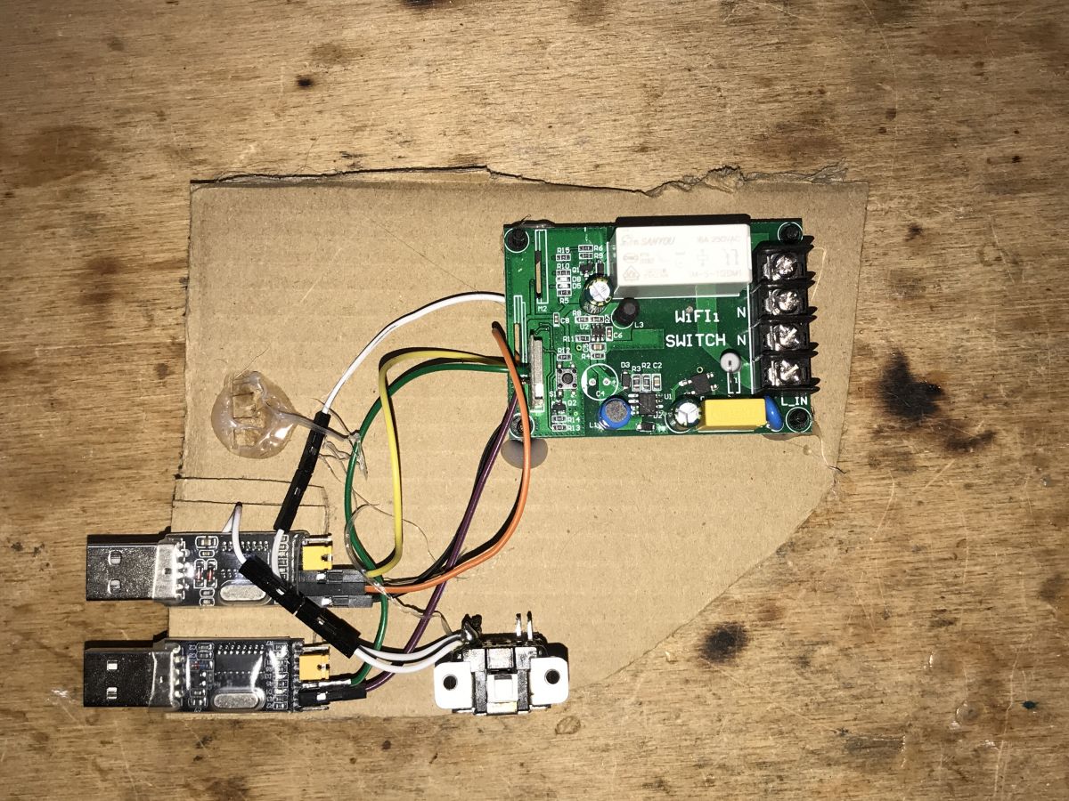

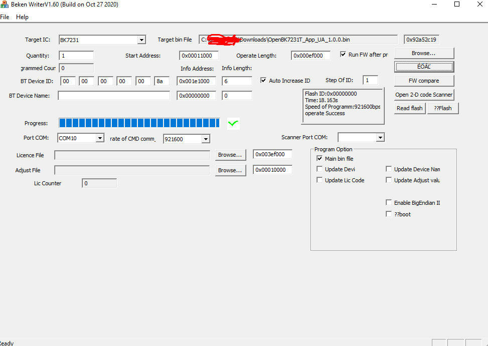

    #94 19874445
    boozeman
    Posts: 73
    Hi,
    Is there anything that I can do to debug that
    17:43:23.291]
    V:BK7231S_1.0.5
    CPSR:000000D3
    R0:ADC9AA37
    R1:FD12CA35
    R2:4311FA1F
    R3:FEF46C99
    R4:DF7B5BFD
    R13:02A64A2E
    R14(LR):3C4FA5CF
    ST:886631A3
    J 0x10000
    prvHeapInit-start addr:0x41c908, size:145144
    init log
    Problem after flashing?
    I even install cygwin env to rule out the possibility that it would be my Debian installation. The chip is the same BK7231TQN32. Some of us succeed in flashing this same device and then again some don’t. What should be the unifying factor in these?
    Flashing do succeed every time, but after booting it freezes.
    I included my last build. Can anyone try to see if it works?
    • OpenBK7231T_App_UA_1.0.0.bin (956 KB) You must be logged in to download this attachment.

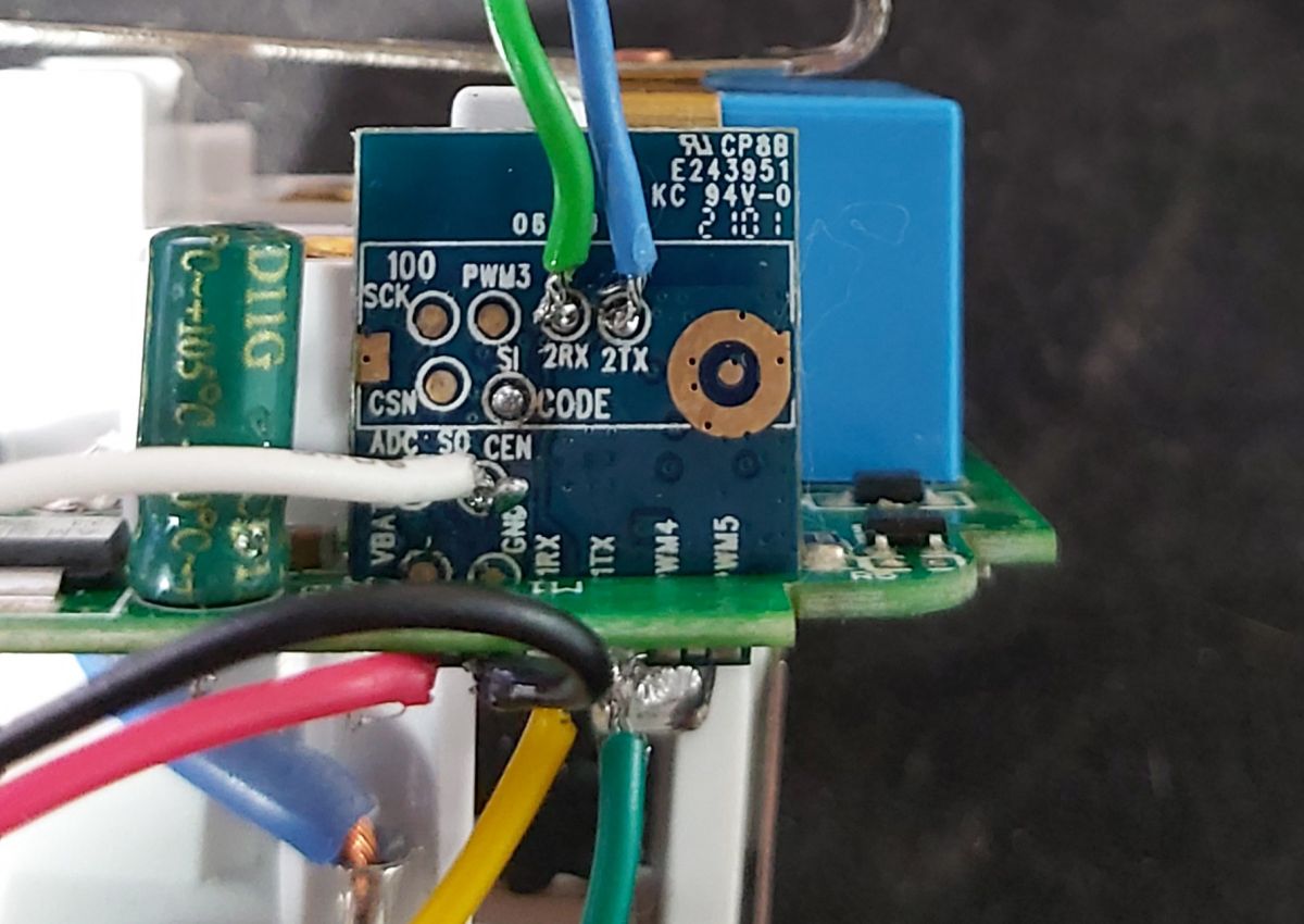

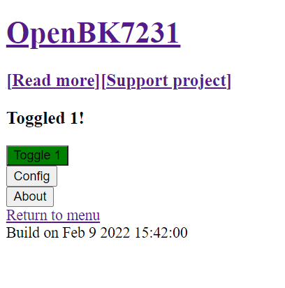

    #95 19874513
    Posts: 14724
    Rate: 12806
    Hey @boozeman , I'm happy to check this out for you!
    Tested on my first device:
    It seems to work, I haven't tested anything more than what's on screenshots but it boots and runs
    EDIT: is this your build date down here?
    Also, please note how WB2S retains its configuration after flashing - the config sections of memory are not overwritten by BKwriter so it remembers my SSID, etc etc
    EDIT: Boozeman, I just realized something.
    Maybe you've set your UART TX pin role to something like digital IO and that resides in your config and breaks stuff?
    Give me a second, I will prepare something for you
    EDIT2:

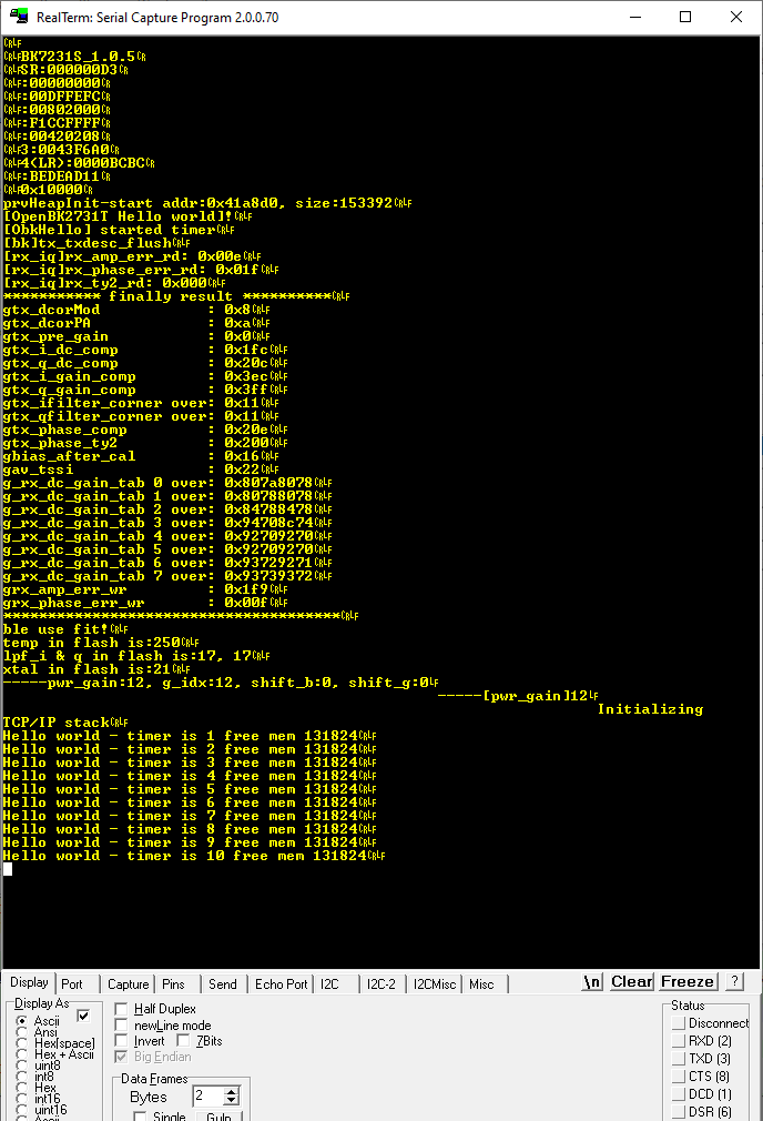

    #96 19874577
    boozeman
    Posts: 73
    EDIT2:
    Can you check if this app works for you?
    Yes it works! Some init at first and then steady
    19:09:15.027] Hello world - timer is 3 free mem 131824
    [19:09:16.031] Hello world - timer is 4 free mem 131824
    [19:09:17.025] Hello world - timer is 5 free mem 131824
    [19:09:18.029] Hello world - timer is 6 free mem 131824
    [19:09:19.078] Hello world - timer is 7 free mem 131824
    [19:09:20.031] Hello world - timer is 8 free mem 131824

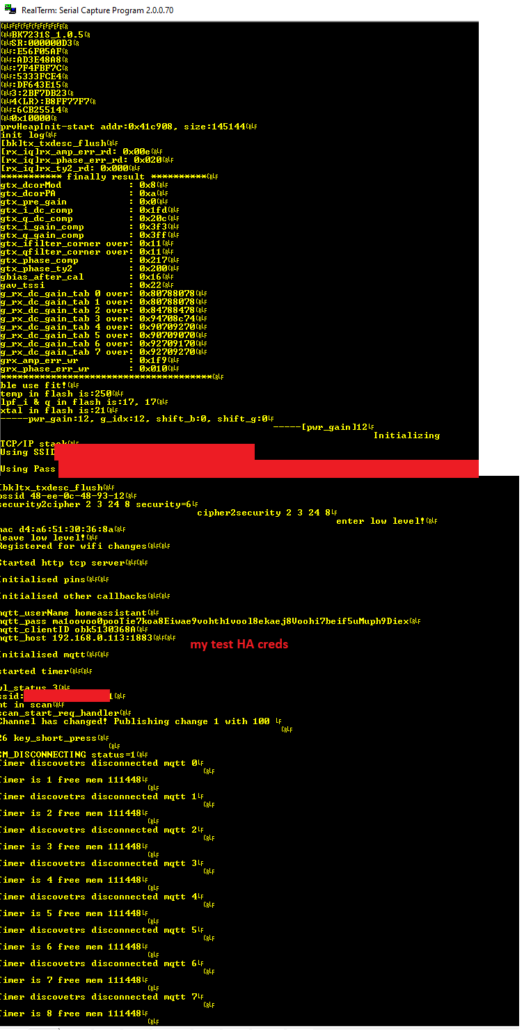

  • UART log breaks during TCP/IP init
    #99 19874628

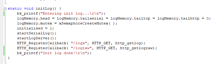

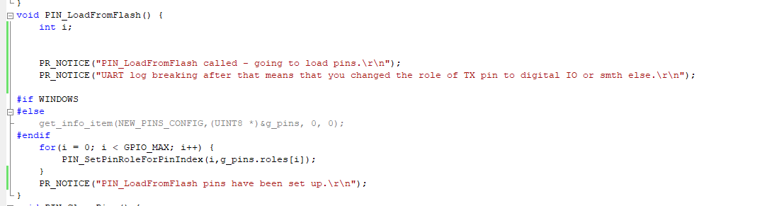

    Posts: 14724
    Rate: 12806
    So you're able to build yourself... good.
    I've added more debug printf at two sections of code:
    Can you compile latest version of App (main app, pull both repos) and paste your log?
    Here is my log:

    Initializing TCP/IP stack
    PIN_LoadFromFlash called - going to load pins.
    UART log breaking after that means that you changed the role of [bk]tx_txdesc_flush
    bssid 48-ee-0c-48-93-12
    security2cipher 2 3 24 8 security=6
    cipher2security 2 3 24 8
    enter low level!
    mac d4:a6:51:30:36:8a
    leave low level!
    do td cur_t:259--last:idx:13,t:250 -- new:idx:14,t:262
    --0xc:08, shift_b:0, shift_g:0, X:2
    TX pin to digital IO or smth else.
    PIN_LoadFromFlash pins have been set up.
    Using SSID [5G_FULL_POWER]
    Using Pass [P@ssw0rd]
    Registered for wifi changes
    Started http tcp server
    Initialised pins
    Initialised other callbacks
    mqtt_userName homeassistant
    mqtt_pass ma1oovoo0pooTie7koa8Eiwae9vohth1vool8ekaej8Voohi7beif5uMuph9Diex
    mqtt_clientID obk5130368A
    mqtt_host 192.168.0.113:1883
    Initialised mqtt
    started timer
    wl_status 3
    ssid:5G_FULL_POWER, 1
    ht in scan
    scan_start_req_handler
    Channel has changed! Publishing change 1 with 100
    26 key_short_press
    SM_DISCONNECTING status=1
    Timer discovetrs disconnected mqtt 0
    Timer is 1 free mem 111472
    Timer discovetrs disconnected mqtt 1
    Timer is 2 free mem 111472
    Timer discovetrs disconnected mqtt 2
    Timer is 3 free mem 111472
    Timer discovetrs disconnected mqtt 3
    Timer is 4 free mem 111472
    Timer discovetrs disconnected mqtt 4
    Timer is 5 free mem 111472
    Timer discovetrs disconnected mqtt 5
    Timer is 6 free mem 111472
    There are right now three options.
    1. you are getting crash/stuck at log init
    2. you are losing TX pin because it gets initialized to digital IO by PIN_LoadFromFlash because
    a) you've set it yourself to digital IO once and disconnected yourself that way from UART
    b) the identifier of flash section used for pins was accidentally used by Tuya as well and our code tried to interpret Tuya config as ours - unlikely?
    3. There is some other error, in which case, we'll debug more.
    Most important parts to check:
    Entering init log...
    Init log done!
    NOTE: your old "init log" UART message is now "Entering init log..."

    boozeman wrote:
    prvHeapInit-start addr:0x41b3e8, size:150552
    UART log breaking after that means that you changed the role of TX pin to digital IO or smth else.
    Using SSID []
    Using Pass []
    Initialised pins
    Actually it means it's not a pins config issue. I'd rather say it's a threading problem. Is it really now crashing for you after that, no timer prints?

    boozeman
    Posts: 73
    It's on normal WB2S?
    This one is inside of Denver SHP-100 WiFi Smart Plug. Anotther one is from Nedis Smart Plug. One bricked reveals the chip BK7231TQN32
    Edit: I am not yet checked this board schematics. Transistor right of the WB2S is the relay coil driver and one of it's legs are connected to rx1

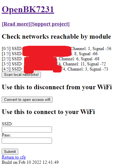

    Access points scan (I will make them clickable soon)
    Network scan button commited - anyone willing to check if it works?
  • #119 19876417
    boozeman
    Posts: 73
    I can confirm. It works as expected. The changes you made to the user_main.c also helped for my crash problem. Feature Request, Possibility to save another backup wifi if main connection fails [like in Tasmota]
