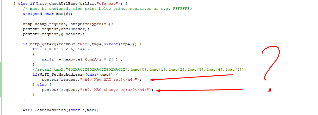

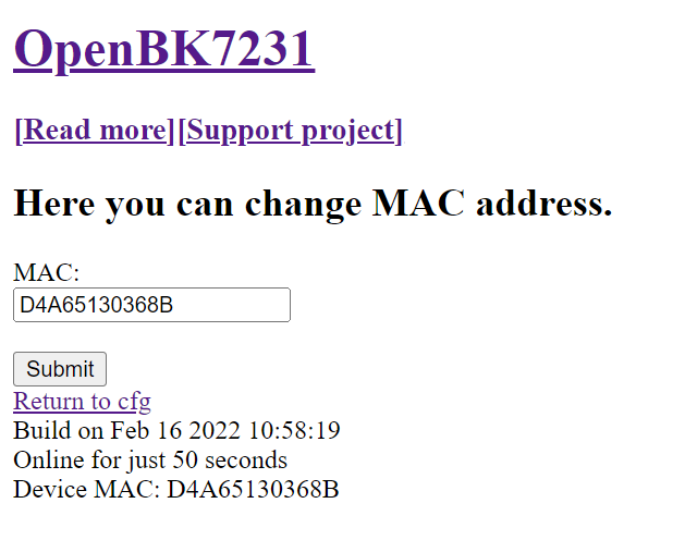

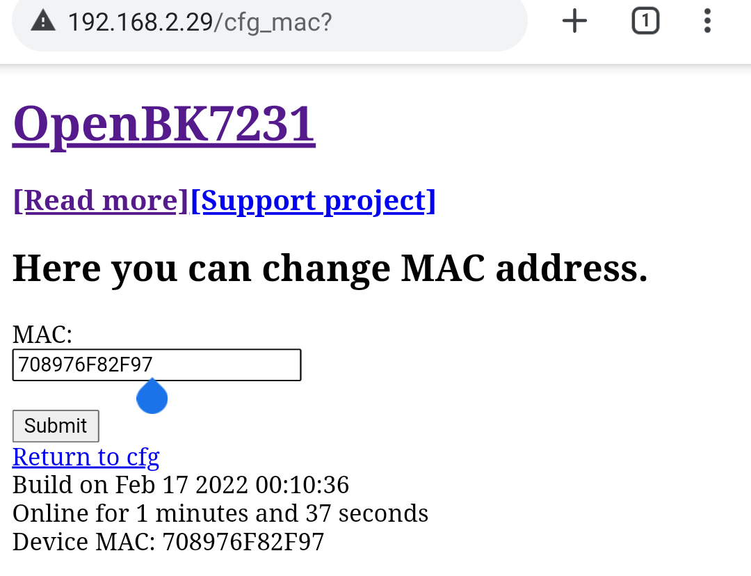

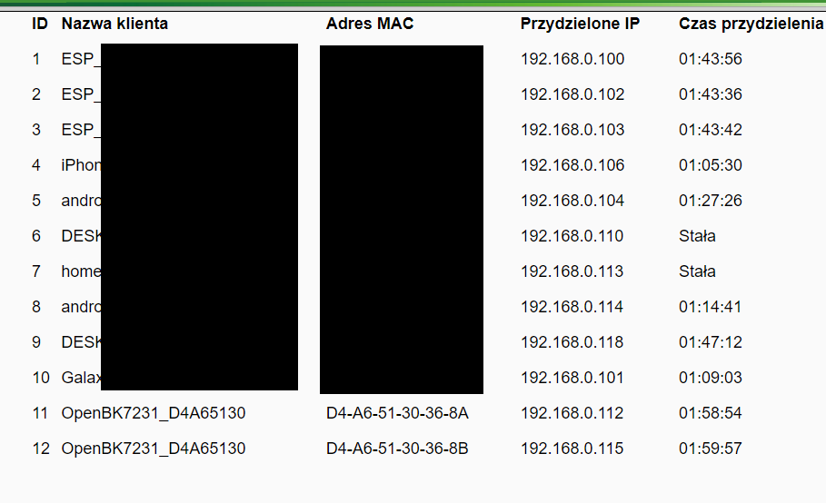

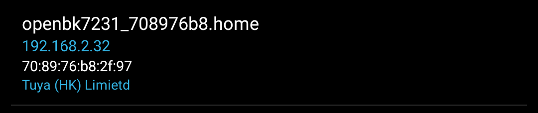

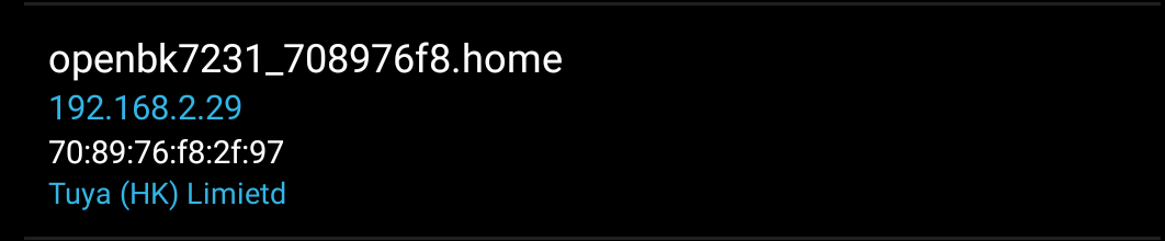

    boozeman wrote:
    @boozeman so you're saying that mac change works (and can be seen by router) but it's not saved and after reboot mac is lost?
    Edit: I will try to be clearer.
    The form works, but the MAC address does not change or be saved.
    Are you really sure about this, @boozeman ?
    Current repository version (as of today).
    Step 1: change mac (I changed only last letter from 'A' to 'B')
    Step 2: manually reboot
    Step 3: See results on router:
    As you can see, it works for me.
    You can clearly see that the same device is on DHCP list twice because it had a MAC address change, and now obviously old IP is not responding and new one works like a charm.
    Can you check again?
    Maybe.... maybe the @btsimonh config change broke something and now that he revoked it (he abandoned his config idea) now it started to work again... anyone, please recheck. Anyone able here, is MAC change working for you? For me it certainly is!

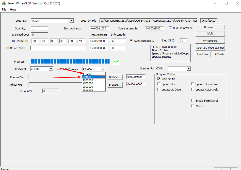

  • Check baud rate, UART wiring, and VDD voltage
    #188 19887746
    Posts: 14724
    Rate: 12806
    Try different baud rate :
    sometimes 921600 worked for me while 115200 didn't (counterintuitive, slower doesn't work but faster works? but it was so)
    make sure that you are connecting TX to RX and RX to TX... that's the way it's with UART.
    Make sure you are using correct UART port and that it is it not in use (for example, Cura Slicer software has a very bad habit of taking over any available UART ports, thus blocking other applications)
    Are you sure that there is 3.3V on VDD of WB2S?

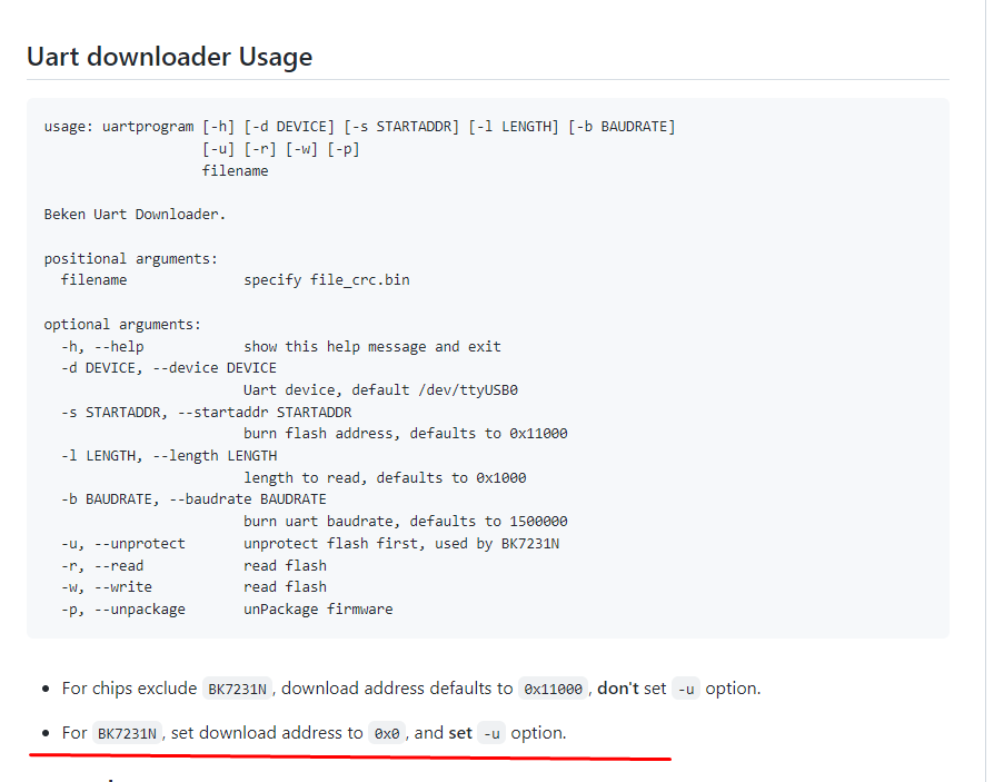

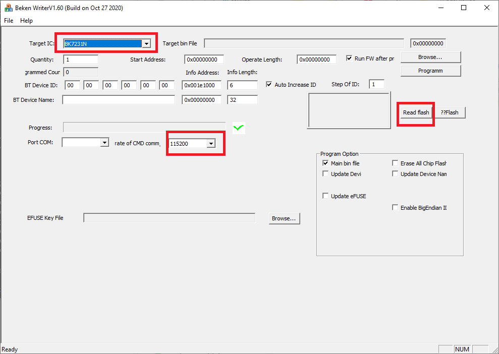

  • BKWriter backup option and BK7231N support
    #190 19887902
    MustangMatt
    Posts: 19
    ferbulous wrote:
    @ferbulous you can try reading original firmware with BKwriter
    Regarding bkwriter, which option in the settings [ i should pick to backup the firmware?
    Also, i have bk7231n device (cbu chip),
    Could i still flash openbkt on this one?
    There's a 7231N variant of the project.
    https://github.com/openshwprojects/OpenBK7231N
    Tom released his project to backup firmware too: https://github.com/khalednassar/bk7231tools

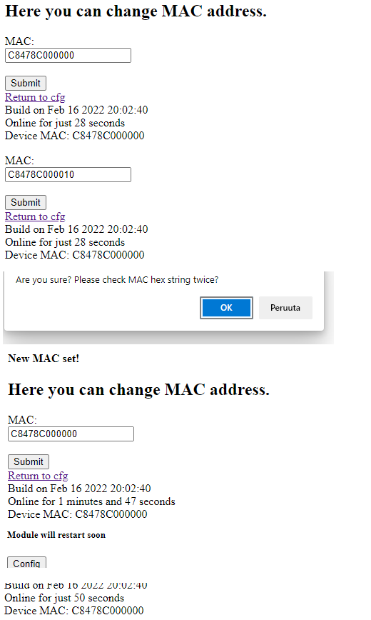

  • BK7231T MAC and webapp settings not saved
    #191 19888351
    boozeman
    Posts: 73
    [/quote]
    Hi, running the latest version and doing the same as before. The MAC address does not seem to be saved. I also tried to change the Webapp address and it couldn't be saved either.
    You can try first at these settings. Backup generated at the same directory where the Beken Writer is. For BK7231T I managed to backup firmware only at 115200 bps. Start the read flash and then sort CEN to GND for a while. It should start.
  • Flash config corruption prevents MAC and webapp saving
    #192 19888772
    Posts: 14724
    Rate: 12806
    It seems that whatever you did, has corrupted the flash config region.
    Basically, you must have overwrote the whole config memory with random data (random bytes that made up ids and lenghts of sectors)
    I will prepare a recovery option for you.
    But first of all - what says the current build?
    @boozeman , please recheck. You should be getting mac change error.

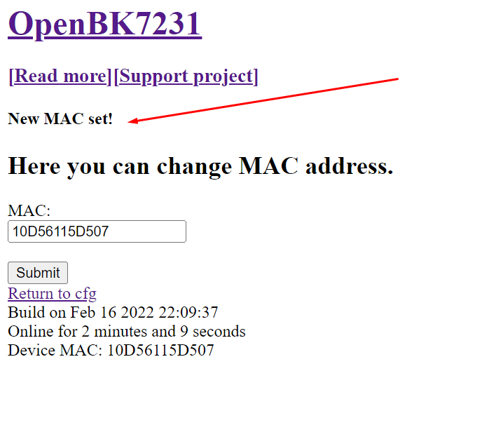

  • MAC change persists after power cycle
    #193 19888842
    ExploWare
    Posts: 48
    I am able to change the mac and got it to persist through a powercycle

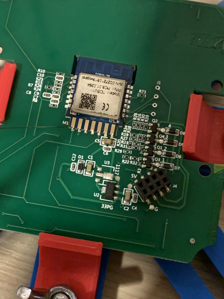

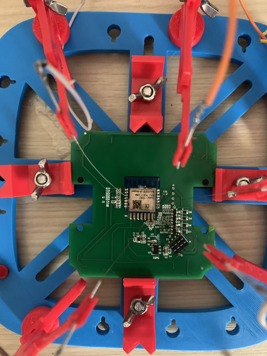

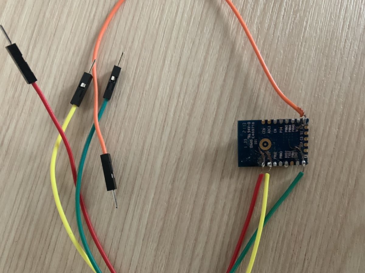

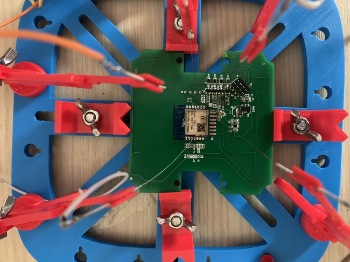

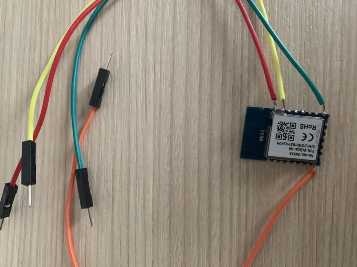

  • BK7231N flashing failure despite CEN reset timing
    #196 19888864
    ferbulous
    Posts: 419
    Help: 8
    Rate: 56
    MustangMatt wrote:
    Is there like bin firmware file?
    I’m not too sure how to do the compiling
    @boozeman @p.kaczmarek2
    Thanks for the backup method,
    I still get failure to flash error
    I’m using probe pins (which usually works to flash esp) and soldered wb3s pins.
    Cen pin is connected to gnd, initiate flash and CEN pin released but I’m still getting same error after 15 seconds
    On the soldered module, flashing time is even shorter at 1-2 seconds?
    [BK7231T] My HTTP server, configurator, MQTT support from Home Assistant [BK7231T] My HTTP server, configurator, MQTT support from Home Assistant [BK7231T] My HTTP server, configurator, MQTT support from Home Assistant
  • #197 19888869
    Posts: 14724
    Rate: 12806
    ferbulous wrote:
    What says the label on this module from the photo, because for me it's too blurry to read?
    Model: ????
  • #198 19888872
    ferbulous
    Posts: 419
    Help: 8
    Rate: 56
    Model: ????
    It’s cbu (bkt7231n) as mentioned in previous photo. Here’s a full res version
  • N-version firmware bin for BK7231N devices
    #199 19888873
    Posts: 14724
    Rate: 12806
    TCBU1, N variant
    https://developer.tuya.com/en/docs/iot/cbu-module-datasheet?id=Ka07pykl5dk4u
    I haven't tested this module yet. I think you might need try using BKwriter in BK7231N mode (not T) and if it fails, try using command line utility :
    https://github.com/OpenBekenIOT/hid_download_py
    I can't tell you anything more because so far I mostly had only BK7231T devices. I am still looking for more various devices to test.
    You can try to figure out how to flash it on your own. Are you able to read the original firwmare from it?
    As for WB3S, it should work. I don't know why are you getting errors.
    Here is a bin file for N version of firmware from current repo. For UART flashing, use UA version. I haven't tested it yet, as I don't have working N devices at hand. If anyone here is willing to test it, please remember to provide full logs:
    OpenBK7231...220216.zip (7.36 MB)You must be logged in to download this attachment.
    This is basically our shared control App compiled with N version of SDK instead of T (and with some basic fixes needed so it compiles), but it was not tested by me on working device yet.

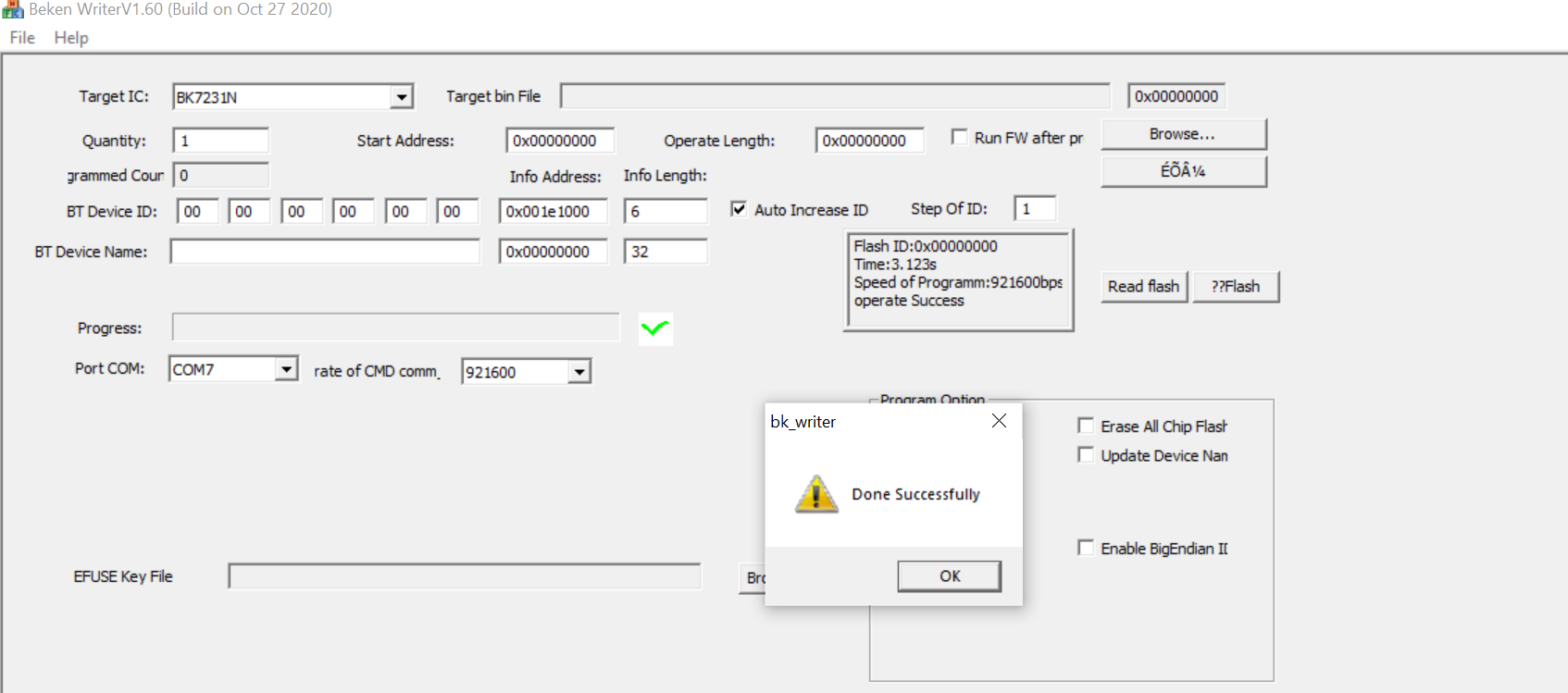

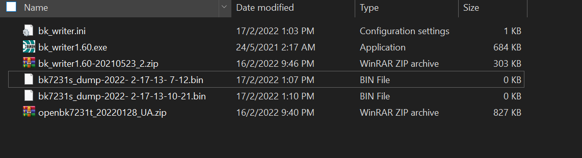

  • BKwriter reads success but dumps are 0 bytes
    #200 19888875
    ferbulous
    Posts: 419
    Help: 8
    Rate: 56
    @p.kaczmarek2
    Thanks for the bin, i will try that one
    No, I'm still unable to read original firmware from wb3s, tried restart the chip by just turn on/off the power and CEN reset pin, this got me scratching my head since I couldn't figure out what I'm missing here
    Also, how do use BKwriter in BK7231N? I mean do i use the same address, operate length and info address like BK7231T?
    I think I'm getting somewhere, tried read and i get success but the bin files are like 0 bytes?

  • Corrupted flash config prevents MAC and webapp saves
    #206 19889035
    boozeman
    Posts: 73
    Like I said i originally tried webapp ota-method with bin file (not rbl) and I got into this situation. The "Last build" for me is an automated script that checks repositories, loads the changes with the git pull command and then compiles the new version and copies the files to my OTA-server.
    For now Current Build: Build on Feb 17 2022 10:03:00
    I have working Nedis WIFIPO120FTW where MAC-address change works like intended. I change last 4 to 5 - > new mac set and it changed immediately. The problem presist with my 2 wrecked modules, so I you kindly can make me that Config Region wiper, I would be happy. Maybe someone other made same mistake and did not read the instructions first :)
