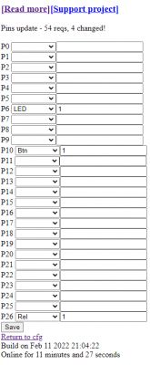

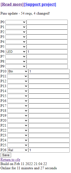

  • Blank MQTT settings may block first-time flashing
    #125 19876784
    boozeman
    Posts: 73
    Seems like Tuya is like Keepers in Babylon 5. They do not give up easily :D

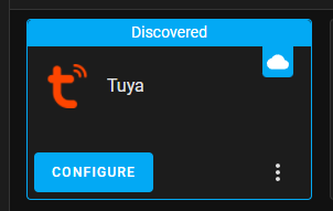

    My Homeassistant discovers openBK device as Tuya while I was guessing the pin setup. Seems like I cannot connect now to my mqtt broker. Hmm...
    EDIT; My previous build (Build on Feb 9 2022 15:42:00) before todays GiT chages works now OK and I can Save MQTT settings too. I think that my issue is blank mqtt settings when flashing new module at first time and there's nothing on flash memory. Does this sound reasonable?
  • Home Assistant MQTT configs need regeneration after device ID change
    #126 19877080
    Posts: 14724
    Rate: 12806
    First of all, do you know that recent change in unique device name generation (using latter bytes of MAC instead of first four) has invalidated all Home Assistant MQTT configs (because MQTT device names has changed) and thus all configs have to be regenerated? Options->Generate HA Config
    (don't worry, your pins setting are left intact, only device ID changed)
    That is utmost peculiar. I don't know right now how HA searches for devices - anyone?
    Maybe it just recognized the module by MAC address (MAC address have vendor-specific section).

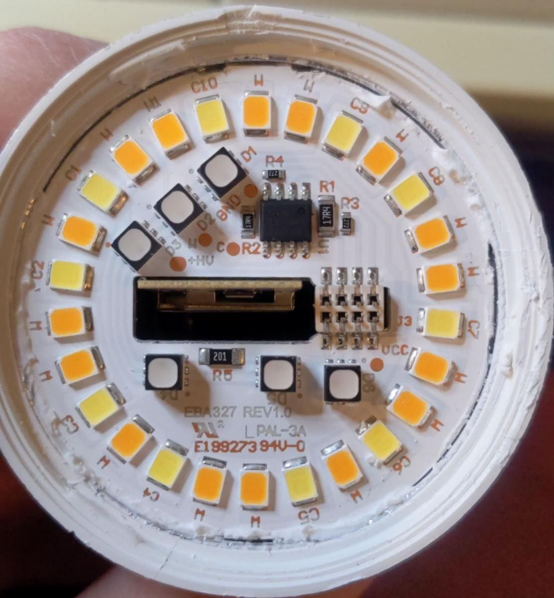

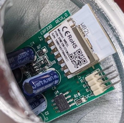

  • White 8-pin block holds the boards together
    #127 19877417
    MustangMatt
    Posts: 19
    I just bought a 4 pack of these and got the new version.
    https://templates.blakadder.com/feit_electric-BPA800RGBWAG2P.html
    I guess it's time to give the new firmware a go. Any tips for breaking open the bulbs without destroying them? I got the top off but I don't see any easy way to remove the board yet.
    [BK7231T] My HTTP server, configurator, MQTT support from Home Assistant [BK7231T] My HTTP server, configurator, MQTT support from Home Assistant
    Okay, got it with some destruction. That white 8 pin block holds the two boards together.
    I can just barely get to the 5 pins it looks like but I can't get to RST. U1 is serial, U2 is log
    https://developer.tuya.com/en/docs/iot/wb2l-datasheet?id=K9duegc9bualu

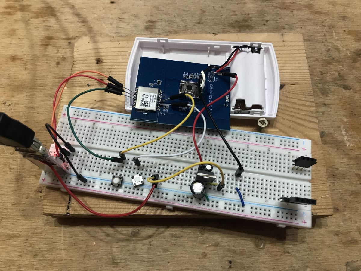

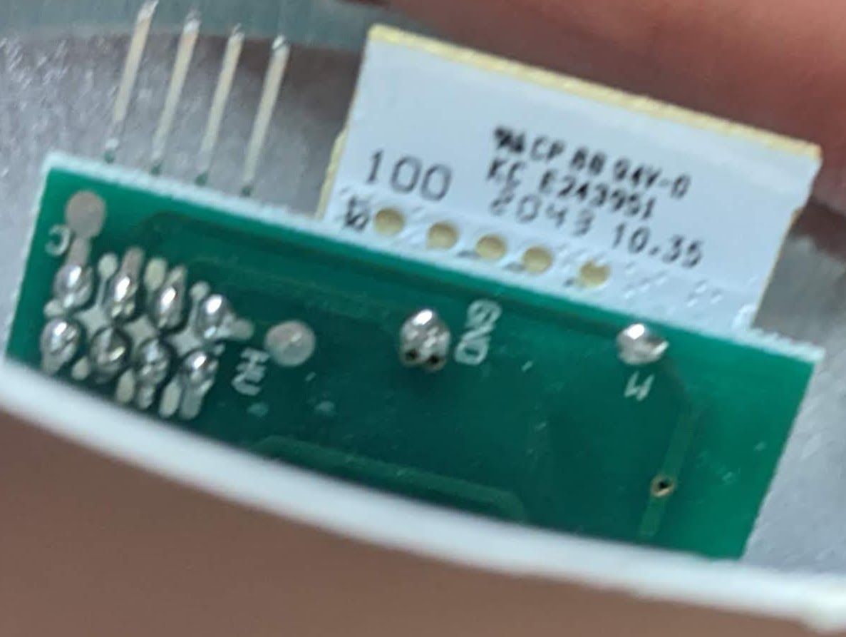

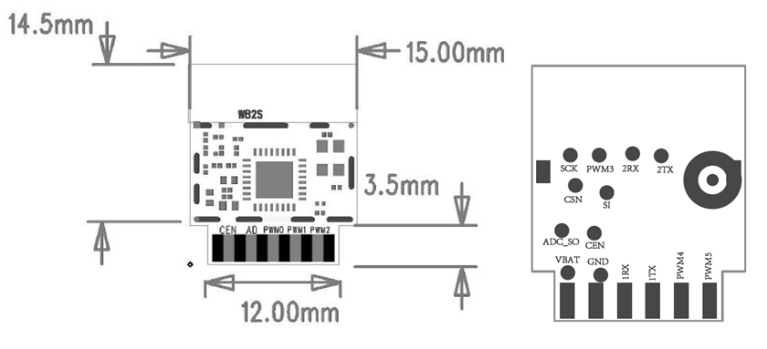

  • Serial console wiring issue on WB2S module
    #128 19877525
    pepesuriano
    Posts: 33
    Hi! I started playing around with my WB2S, I soldered 3v3 (Red), GND (Orange), RX (Yellow) and TX (Green) and then connected Orange to GND on PL2303, Red to 3v3 on PL2303, Yellow to TX on PL2303 and Green to RX on PL2303.
    Launched screen for serial console but nothing happens, typing does not work and I tried with 115200 and 921600 baud rates, it seems to be a wiring issue...
    I also tried to connect CEN to GND of PL2303 without luck also. All tests were done plugging TX, RX and GND first and then 3v3 to turn on the module, whan can I be doing wrong?
    Also swiped TX and RX as usual confusion with UART, no luck either
    I see the SSID of the module after it boots so it's not fried yet :P
  • Isolating WB2S and using RX1/TX1 for flashing
    #129 19877615
    boozeman
    Posts: 73
    Try to desolder WB2S module VCC to main board. Use solder sucker or copper strip. Use multimeter continyity mode to check there's no connection. BEWARE! do not overheat the pads. I destroy one of my plugs when soldering pad detached from the pcb.
    After that normal wiring vcc, gnd, rx1 and tx1 and cen. You can use CEN pin opposite of the PWM5 (You do not need to use that pad if that is hard to solder. Look at module pinout above. Your device is easy because test pads are towards.
    RX2 and TX2 gives you some debug with 115200 bps.
    Remember to connect module RX1 to your usb2serial converter TX and TX1 to RX. and VCC only 3.3V I have tested 3 different smart plugs and only RX1/TX1 can be used for programming. In your picture you do just like that. Good. Start beken writer programming (not flash) and connect CND and CEN for a moment (I have push button for that)
    I also figured out that insulating the WB2S-module off the rest of the circuitry helps flashing (no relays klicking or light flickering and then 15 sec init and Failed. No need to desolder whole thing or removing any other components.
    I have sacrificed 3 devices for the science so far and one of them are now permanently dead. So keep in mind the few casualties in this process. Hope this somewhat unclear instructions help you a bit.

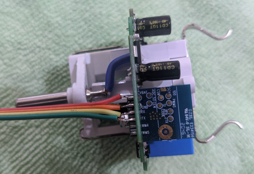

  • Desolder only VCC and isolate module for flashing
    #130 19878131
    pepesuriano
    Posts: 33
    boozeman wrote:
    Apologies, but I got confused, you mean to desolder only VCC from WB2S from the mainboard (keeping all the rest soldered like GND, TX, RX, etc)? Or do you mean to remove the whole WB2S module from the mainboard and flash it?
    Yeah once I heard the relay clicking over and over, I thought I lost it, but for the moment there are 0 casutalties :P
    What about CEN, is GND of the PL2303 good to connect it or I need to connect it in another place? I saw that you typed CND, was it a typo and it was supposed to say GND right?
    Thanks so much for your help
    Cheers

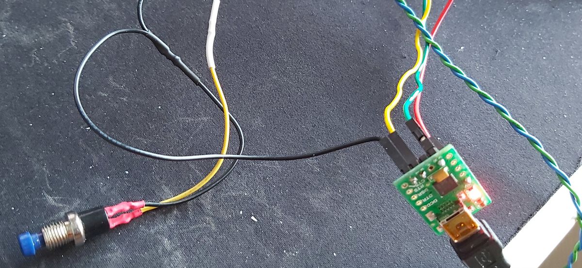

  • Desolder only VCC for first BK7231T flash
    #131 19878254
    boozeman
    Posts: 73
    Yep, try to desolder only VCC pin so your usb2serial converter do not power rest of the plug's circuit. This is the only way I have successfully do for first flash. After then you can solder it back. No relay or light flickering for the next flashes with OpenBK firmware.
    You can connect CEN to PL2303 GND or do some jump wire to sort CEN pad and thar circuilar big copper area from the right side of WB2s module. I have GND wire with CEN wire and push button. I recon it is safer than sorting CEN and GND directly at the board. you know "Uups! s***t the manufacturing smoke is gone now!" :)
    My GND wire. with push button operated CEN/I00 wire.
  • USB-serial 3.3v may not power the MCU reliably
    #132 19878267
    btsimonh
    Posts: 66
    Rate: 14
    Even with this, the power from 3.3v of USB to Serial is probably not *normally* good enough to power the MCU, so if you have failure to start flashing.... (it's designed more as a 3.3v signal than a supply?)
    Based on ESP, you might expect it to need >500mA from the 3.3v
    On my mains powered device, I used the 3.3v from a breadboard supply (with the mains disconnected!!!), and it was fine.
    For my 12v LED strip controller, I powered it via the 12v (not scared of killing myself with a 12v wall-wart....)

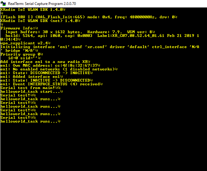

  • XR809 platform support and serial hello world test
    #149 19880572
    Posts: 14724
    Rate: 12806

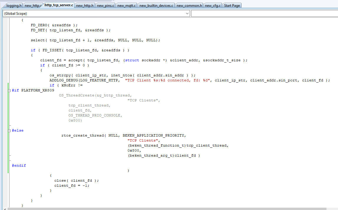

    Initial XR809 platform support progress:
    Code: C / C++
    Setup:
    Of course, this is a hello world app, but the OpenBK7231T app also will be running on XR809, so most of the OpenBK7231T will be also available on XRadioTech devices.
    Repo:
    https://github.com/openshwprojects/OpenXR809
