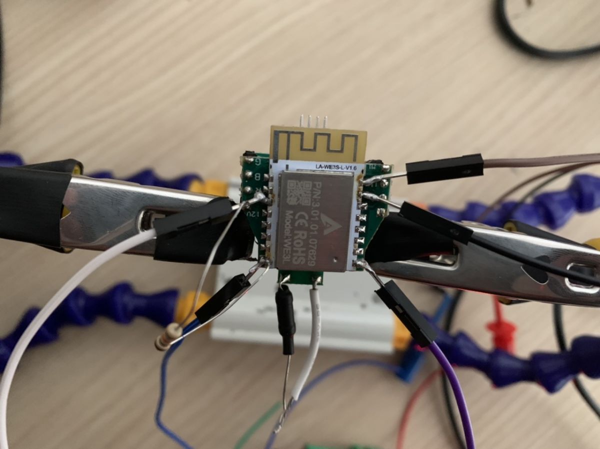

    The one thing is soldering to the pads. I'm just to shaky to get that to ever work out. Are you guys using pogo pins/clips or some other tool to connect to those pads?
    Would it make sense to get one of these: Amazon link

    You could print one of this and use acupuncture pins, works for me
    https://www.thingiverse.com/thing:3615910

    Jesus H Christ! That is an excellent rig! I only have a SLA printer so it will be a mess but I will look into other solutions. I always forget I have a printer for some reason. Thanks!

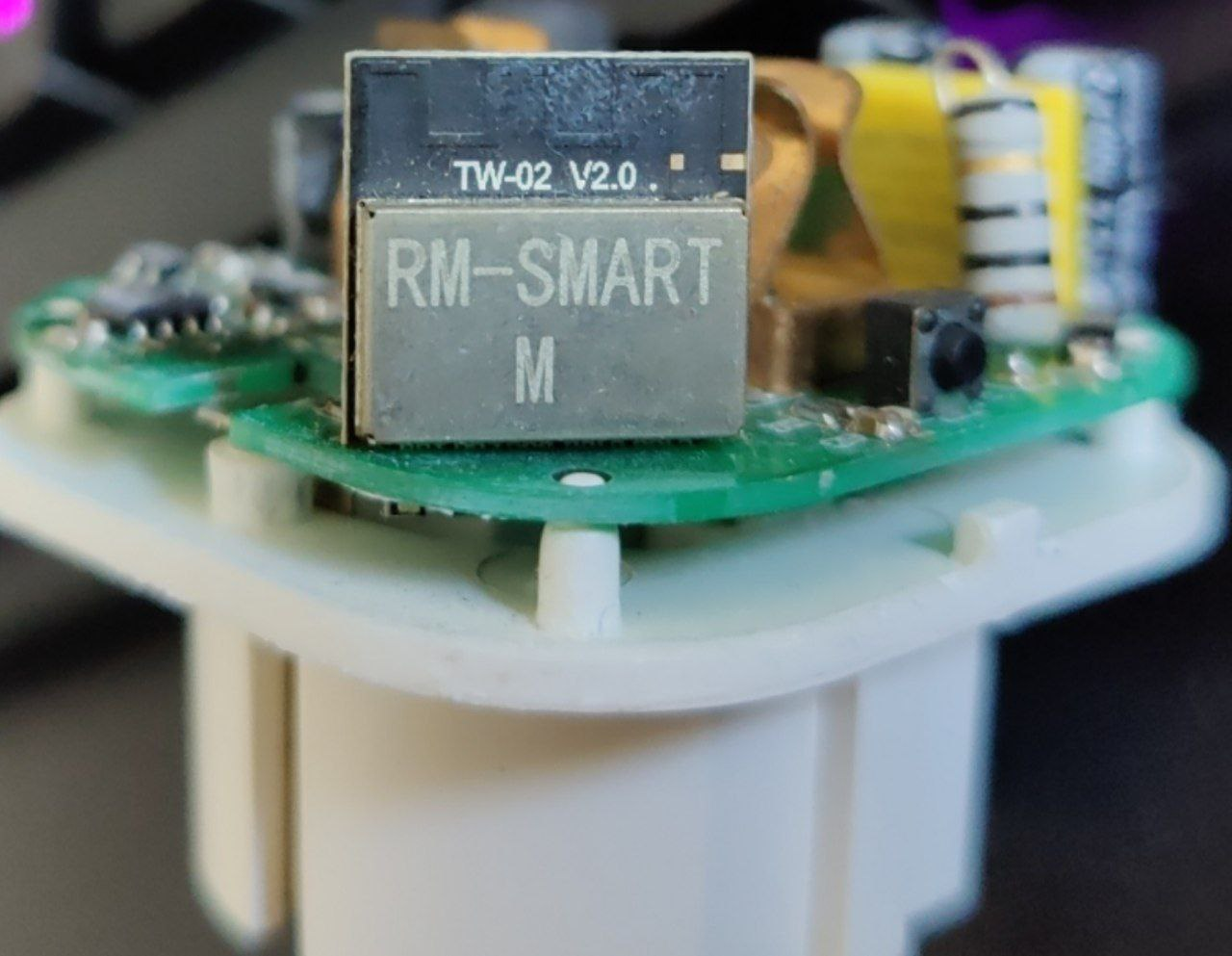

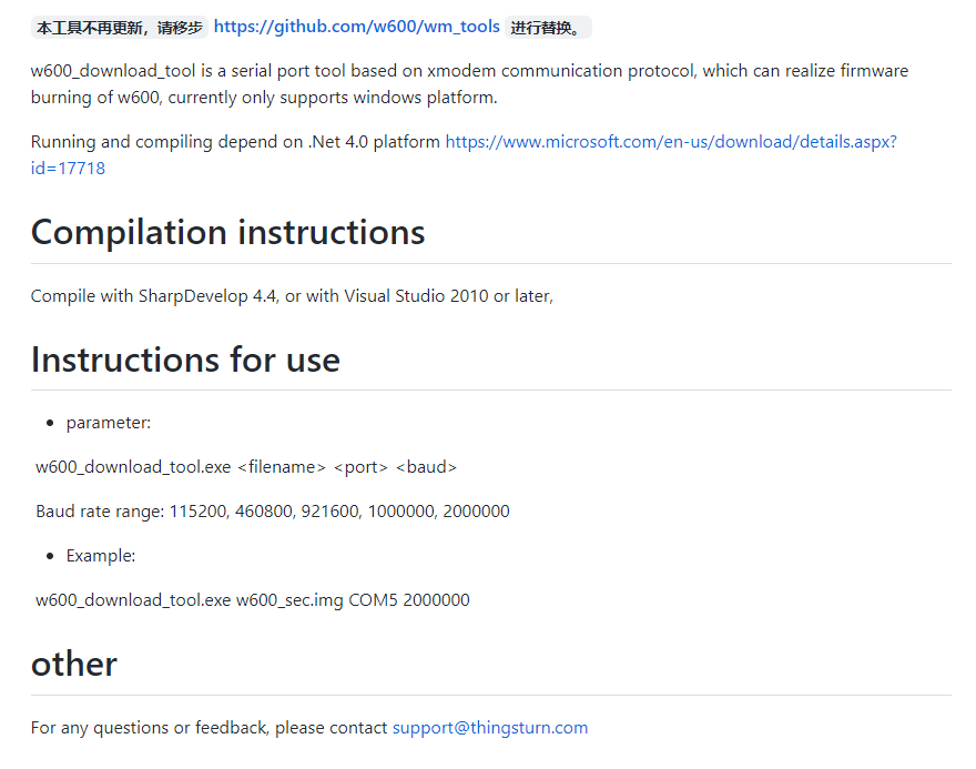

    Hi! I just opened this module:
    Seems to be a TW-02 (W600 based see attachment for info)
    Any experience with that here?
    • User-manual-4211029.pdf (1.58 MB) You must be logged in to download this attachment.

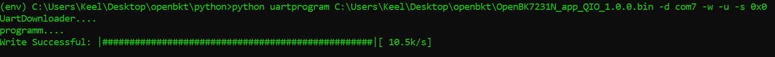

  • OTA upload requires a URL, not local bin files
    #245 19898449
    ferbulous
    Posts: 419
    Help: 8
    Rate: 56
    @p.kaczmarek2
    update..nevermind, just some wiring issue
    Also, can we actually use the ota option to upload the bin files? since it needs the url address for it
    What should I do if the AP doesn't show up?
    I've been at this for half an hour but it's still not visible (using QIO bin)
    I did get the AP at first, setup wifi/mqtt in the settings. Restart it again, but it's still not connected to my wifi yet

    #246 19898498
    ExploWare
    Posts: 48
    Retry with the UA bin.
    Also, for the OTA option, you'll have to serve the .rbl fild on a webserver.
    I started
    pip3 install http-here; http-here --host 0.0.0.0 8000
    in the output-folder and set http://ipaddress:8000/OpenBK7231T_App_e896a81e.rbl in the URL field

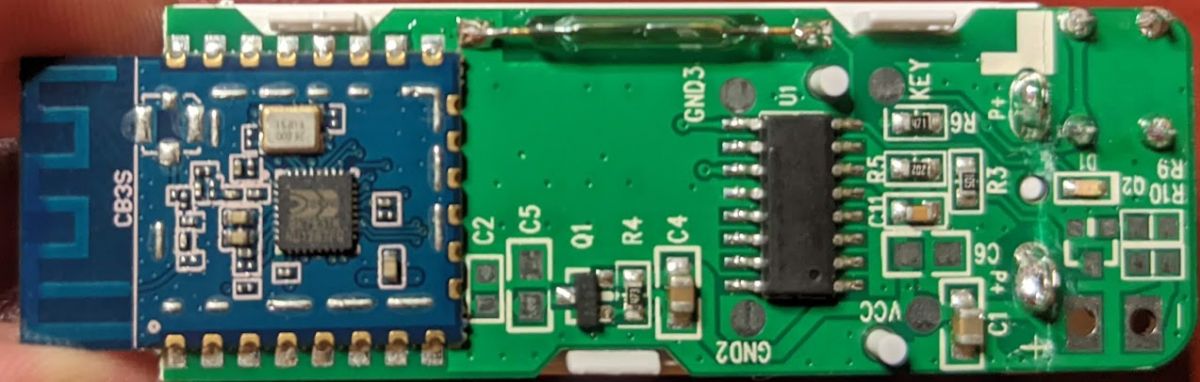

  • CB3S module now uses BK7231N
    #249 19900350
    MustangMatt
    Posts: 19
    I ordered some of these (https://templates.blakadder.com/D06.html) but they have CB3S (bk7231N) now. (I bent the PCB in the process of removing it unfortunately.)
    I'll try to pull the firmware off tonight. I haven't been able to do it successfully yet I guess I need to re-read the thread and make sure I understand exactly what I should be doing.
  • TuyaMCU flashing may require grounding MCU reset
    Looks very promising, albeit some of sdk urls looks like expired.
    https://github.com/w600
    it could be possible to get my app running on this module, but I'd need to at least get one for testing. Where did you buy that smart device?

    MustangMatt wrote:
    I ordered some of these (https://templates.blakadder.com/D06.html) but they have CB3S (bk7231N) now. (I bent the PCB in the process of removing it unfortunately.).
    is the same uart port used for flashing and for communication with mcu? maybe you need to ground the RESET pin of mcu if it's present. TuyaMCU is on my TODO list. I might need to buy this door sensor for development
  • #251 19900496
    MustangMatt
    Posts: 19
    I tried grounding reset but I can never get it to connect to the chip. I'm not sure if it's my poor soldering job or if I've fried it. I have a different device I'll try tomorrow if I can get the chip off the pcb to access all the pins.

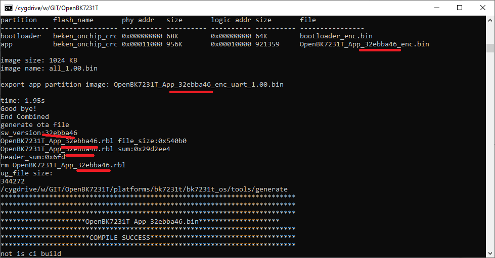

  • Need Cygwin Windows build testing
    #252 19900533
    ExploWare
    Posts: 48
    [quote="p.kaczmarek2"I have accepted the pull request but now I realized that something might be missing. Have you tested it with Cygwin build on Windows platform?
    [/quote]
    I have not. I don't have such a setup at hand right now.
    I think defining a version by hand would always overrule any errors, but sure worth testing.
    If someone can confirm with a Cygwin setup, please do, otherwise I think I'll have time to do this in in the coming weekend.
  • 10k pull-up on CEN for reset access
    #253 19900628
    Posts: 14724
    Rate: 12806
    Connect permanently a 10k resistor between CEN and 3.3V. Then try everything again. Do not disconnect 10k while resetting, just pull CEN temporarily to ground.
    For me, it gives "unknown command git", most likely because git is installed on Windows through SourceTree and build process is on Cygwin. I have modified the script to check again (after calling git) the value of version and default it to 1.0.0 if it's empty. I will try to get it working properly with Cygwin soon.
  • Cygwin git detection fallback to 1.0.0
    #254 19900718
    ExploWare
    Posts: 48
    Aah, true, the git part is done in windows.
    Well, the directory structure should be the same, so the .git/refs/heads/main should contain the latest branch. At least it does in my tree.
    Can you verify this? The pull request has been created.

  • #255 19900739
    Posts: 14724
    Rate: 12806
    Great, it seems correct now. Thanks!

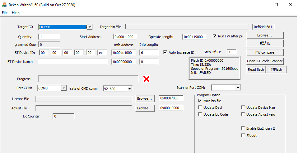

    Hi, if I want to test serial connection before flashing, is it ok the following procedure?
    1- wire vcc, tx, rx, gnd to the module
    2- launch putty on serial connection mode and set bauds to 921600
    3- see output in console, interact with keyboard?
  • Using bk_writer read flash as a serial test
    #257 19901507
    ExploWare
    Posts: 48
    If you use the bk_writer tool and press read the " read flash" button and then power on the the module, you'll be performing a more informative test
  • #258 19901511
    MustangMatt
    Posts: 19
    For some reason bkwriter never sees com ports for me. Python does though.

    I tested:
    - Wire UART adapter 1 to 1RX, 1TX, GND
    - Wire UART adapter 2 to 2RX, 2TX and it's GND to CEN
    - Launch putty on adapter 1 and beken writer on adapter 2
    - Click "Read flash" on beken writer, in 2 seconds plug VCC, and in another 2 seconds, unplug CEN from GND
    - Serial output shows on putty, but seems just normal boot and beken writer failed
    See picture:
    I have the pending suggestion from previous posts to desolder VCC from mainboard, since logs show fine on debug output, do I need it anyway? Or if it was the case it has just to restart or have the debugguing output not working?
    I clicked beken writer read flash with the plug on "idle" watching serial output, nothing happens just as it should be unwired (it's perfectly wired).
    Any ideas on how to continue?

  • WB3S flashed successfully, CBU AP still missing
    #267 19902604
    ferbulous
    Posts: 419
    Help: 8
    Rate: 56
    @p.kaczmarek2
    Wb3s
    I ended up desoldering the wb3s and was able to flash firmware and it boot up with ap.
    Cbu
    As for the cbu chip, I’m still having problem getting the AP with even with successful flashing each time.
    How do i get the logs if I’m not using bkwriter?

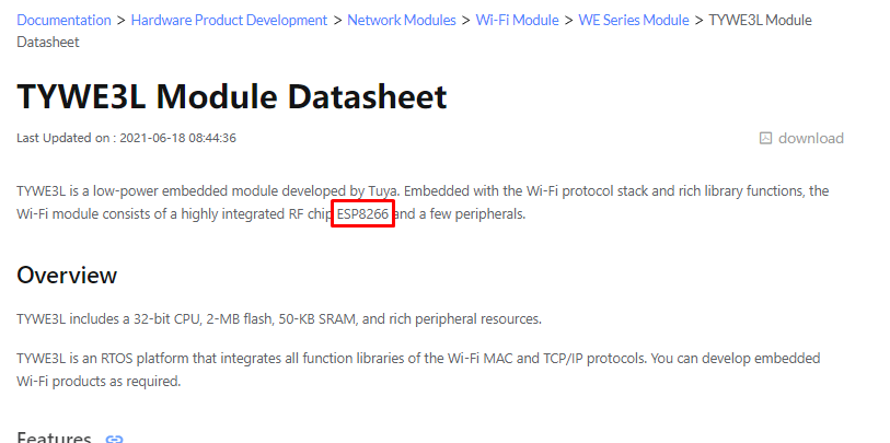

    WE3L
    Still trying to flash it but I’m not succesful yet
  • #268 19902615
    Posts: 14724
    Rate: 12806
    ferbulous wrote:
    WE3L
    Are you trying to flash ESP8266 chip with BKwriter 1.60?
    Also, please post full photos of your setup. What kind of UART converter are you using?
  • Clarifying chip type and UART flashing setup

    ferbulous
    Posts: 419
    Help: 8
    Rate: 56
    ferbulous wrote:
    WE3L
    Oh wow, this in an esp? I thought it was another bk7321t variant, i ordered like a dozen of these bulbs and the rest were wb3L

    #270 19902772
    pepesuriano
    Posts: 33
    boozeman wrote:
    What kind of device you are trying to flash? Can you check with multimeter if there is some pull-up or pull-down resistors in RX1 or TX1 pins.
    I have one smart plug where RX1 is pulled up to 3.3V because it is used for relay activating button. This prevents flashing for me.
    Here are some pictures:
