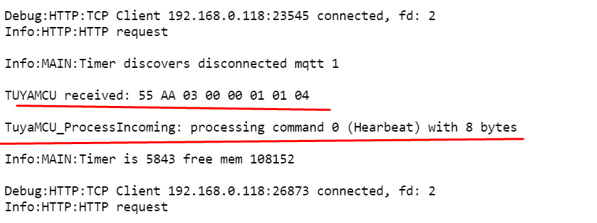

    Posts: 14724
    Rate: 12806
    @absinth84 I don't know the exact device you're referring to (thermostat BHT-002), I'd need to get one somehow for testing, maybe I can buy one with money from donations, we will see, but TuyaMCU support is on the way. Can you provide more information where one can buy BHT-002 WB3S version (not ESP)? It would be a shame if I bought one and received an ESP8266-based version...
    but in general, I have already started to work on TuyaMCU, I am using TH06 clock/temperature/humidity LCD display for development.
    Some WIP screenshots/photos:

    Posts: 14724
    Rate: 12806
    I might try ordering this device from Banggood but I don't know what are the chances that I will get a WB3S-based one.
    The TuyaMCU development is in the main branch of App repository (not SDK). It's very far from being complete. Right now I am able to send RTCC data (date + time) from TuyaMCU to TH06 clock calendar LCD.
    Today I also added NTP support - getting time from network, so I will be able to send this time to TH06 soon.
    Of course TuyaMCU is much more than that, and everything is still to be done.
    If you want to test, there is a uartSendHex command in the current App, and soon I will add more advanced command which computes Tuya MCU checksum automatically, so it's easier to send.
    Futhermore, current codebase is able to receive and partially decode TuyaMCU packets:

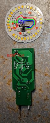

    pepesuriano
    Posts: 33
    What I would suggest to you:
    Example of working setup:
    Ok, so I did literally that (double checked and tried with different PL2303 modules and python/bkwriter). No luck...
    What I found different is that now powering via the AMS1117 the SSID shows up (powering via 3v3 of WB2S does not).
    Also (hope this is useful) if you remember this picture:
    I found with a multimeter that AMS1117 VIN (third pin from left to right) has continuity with upper connection of C6, and lower connection of C6 has continuity with left connection of R3. Is that useful?
    Cheers

    Ok, I've made some more progress on the ARLEC RGB SMART LED globes. I have flashed OpenBK7231T_App using the hid_download uartflash tool and that works nicely. My WB2L boots up and I was able to connect it to my WiFi. Great!
    I started looking at the LED PWM controller. As mentioned earlier it's a SM2135E Multi-Channel dimmer LED driver and uses I2C to control it. I have a translated Chinese PDF datasheet which has a basic explanation of the protocol, and I believe Tasmota has some level of support implemented (that's where I found the datasheet).
    I think the next step then would be some sort of I2C library for OpenBK7231.
    Is there one already in the SDK?
    I had a look but couldn't find one...
    BK7231 Pin layout:
    PWM4 I2C CLK
    PWM5 I2C DATA (Incorrectly labelled as PWM2 on the bottom of PCB)
    PDU:
    Byte | Purpose
    0 | Address Instruction
    1 | Max Current Control
    2 | RGB or W/Y Select
    3 | R Value
    4 | G Value
    5 | B Value
    6 | W Value
    7 | Y Value
    I gather bytes 3-7 are straight forward since there's 256 levels per output
    Further details about Bytes 0-2 will require some more deciphering as the translation from Chinese is not perfect... It might be easier to go and see what the state of the Tasmota support is and maybe use that as a reference...
