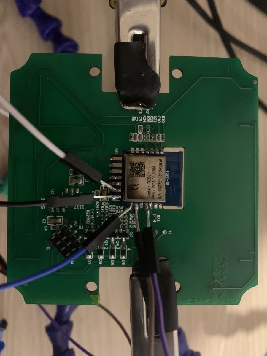

    pepesuriano wrote:
    boozeman wrote:
    pepesuriano wrote:
    Any ideas on how to continue?
    What kind of device you are trying to flash? Can you check with multimeter if there is some pull-up or pull-down resistors in RX1 or TX1 pins.
    I have one smart plug where RX1 is pulled up to 3.3V because it is used for relay activating button. This prevents flashing for me.
    Here are some pictures:
    Can you follow the copper trace from RX1 marked as K. Where it goes and what components this path contain. Is there's pull-up resistors to 3.3V that might prevent the flashing. I have one type where I have to remove one resistor/jump wire, but 2 other types I can flash without any modifications.
    When you try to flash this device (Start programming and then sort CEN to GND), does the leds flicker and/or relay klicking? Or is that just 15sec of nothing?
    What kind of USB2Serial device you have? Check the chip and do some seaching if it is cabable of 921600 bps.

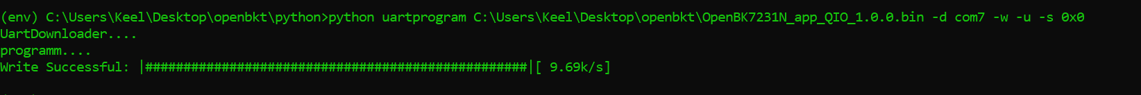

  • CH340G works on 2RX/2TX at 921600
    #272 19902947
    ExploWare
    Posts: 48
    1: in your first post, you mention you've connected the bkwriter to the 2tx and 2rx lines. In my experience that would not work.
    2: I've used a original FTDI UART dongle on the 1RX and 1TX lines, these were able to read perfectly on 115200, but failed to write. It did not work at all at 921600
    At the same time I had a CH340G dongle on the 2RX/2TX pair.
    I swapped them over and that device did write and read at 921600 without complaining.
    I have programmed 5 Bk7231T chips, multiple times, succesfully. Just sharing my experiences

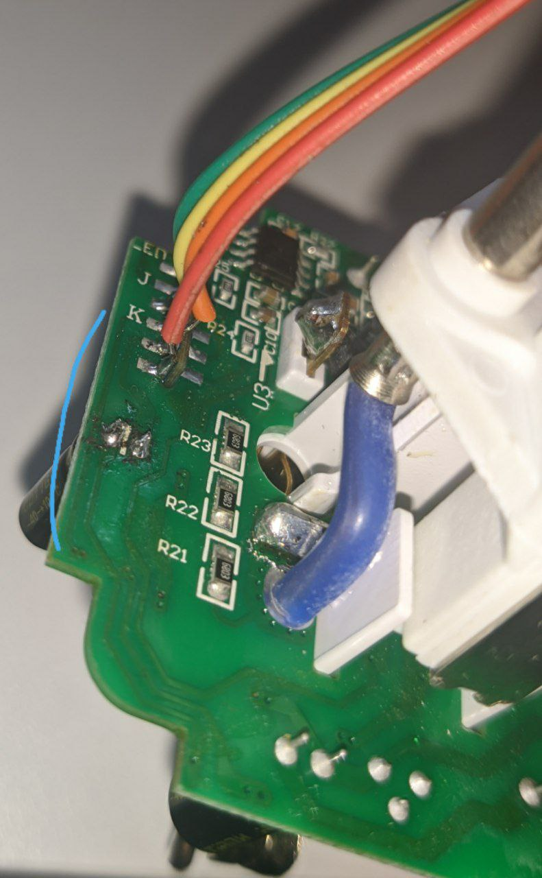

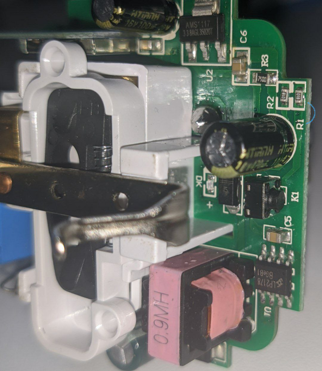

  • Tracing RX1 path and checking flash procedure

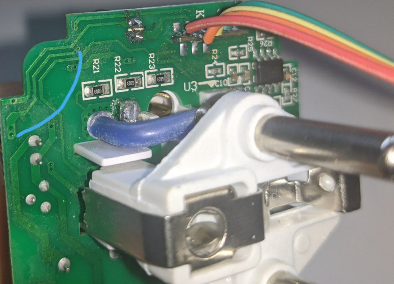

    #277 19903018
    pepesuriano
    Posts: 33
    I tried to follow but I am not sure, here are some pictures that might be helpful, highlighting what I suppose to be the path
    Maybe it ends on R1?
    It's just 15 seconds of nothing, but I did this order: Click read flash (with cen already to GND), then plug VCC and after that unplug CEN, is that correct?
    My usb2serial is a PL2303, in previous posts it was already checkd and it's capable of 921600bps
    Cheers
  • #278 19903080
    boozeman
    Posts: 73
    In my devices the read flash worked only 115200. Writing the firmware with program button needs that 921600
  • Read flash by toggling CEN after starting capture

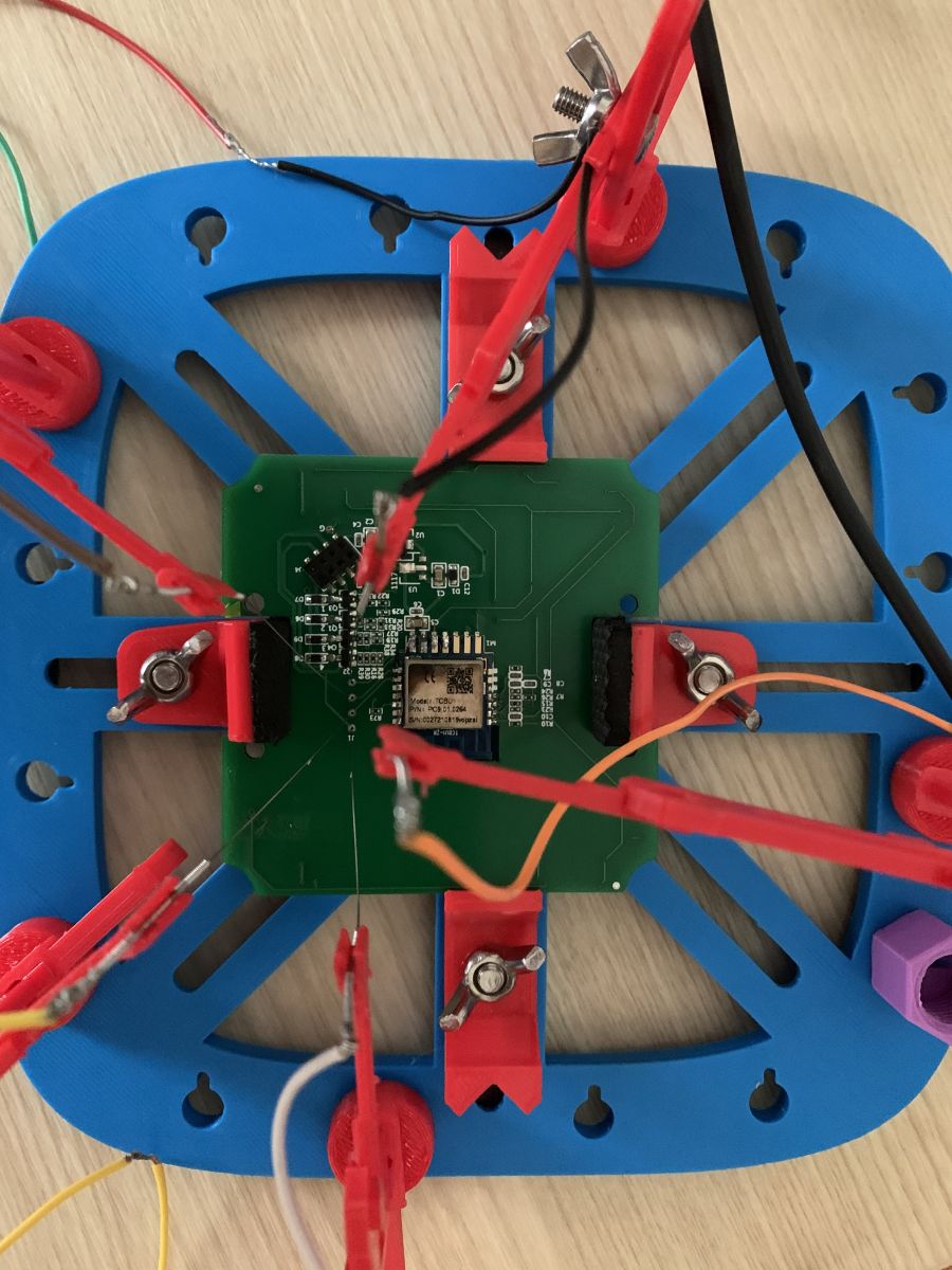

    #279 19903108
    ExploWare
    Posts: 48
    The CEN (Chip Enable) is like a reset switch. Pulling it to ground resets the chip. As long as you hold it down,it does not start again (it's not Enabled). Releasing CEN from ground, or pulling it High with a resistor to 3v3 is Enabling the chip to start.
    VCC can be supplied all the time. Once you press Read Flash, the serial device will search with a timeout of 15sec for the boot sequence on the serial line. That means, if you reset the device, it will detect that.
    So: boot everything, start Read Flash, pull CEN to Ground and release that, then (if everything is wired correctly) the device will be sending the flash data to the computer.
  • Missing flash read despite reset and relay click
    #280 19903522
    pepesuriano
    Posts: 33
    Ok I did just that, I hear the relay clicking when I put CEN to GND, but still there is nothing on beken writer (just like my previous picture), I inverted TX1 and RX1, tried read flash with 115200 and 15000000, read in BK7231N but nothing got me a different message from failed. While I put CEN to GND I see on debug output that device restarts just fine, what could be missing? I also changed the PL2303 adapter and got the same.

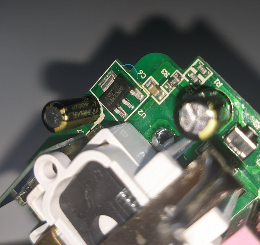

  • 5 V supply needed for AMS1117 input
    #281 19903560
    ExploWare
    Posts: 48
    I see one thing:
    When I flashed my SmartPlug, I needed to supply 5volt to the LDO In, where I could do with 3v3 to for my relay-modules. Maybe you could desolder the VBAT line and supply 5v to the AMS1117 chip on your module. Advisable: not the 5v from the USB to Serial device. Maybe a spare phonecharger, and combine the ground with the ground from the USB to Serial, to make sure they reference to the same 0v

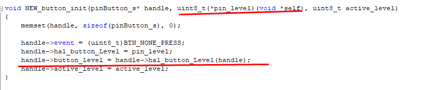

    ExploWare wrote:
    1: I wanted to view the MQTT state of any Pin which is configured
    If I understand correctly, it's easy to do, I can add such functionality right away, watch for the App commit in the next hours.
    ExploWare wrote:
    2: A Push signal, or Edge Detect signal, instead of State Switch function, so when the button is pushed, state is 1, when de button is released, state is 0, unlike the current function: Push and Release is State Change.
    Could this actually be done? I think so, as the original firmware is triggered by holding a button down.
    see new_pins.c the PIN_Input_Handler function.
    We have BTN_PRESS_UP, BTN_LONG_PRESS_START, BTN_PRESS_DOWN, BTN_PRESS_REPEAT, BTN_SINGLE_CLICK, BTN_DOUBLE_CLICK.
    It's just they are not accessible from user GUI yet.
    I will add such functionality to gui soon. [EDIT] it sounds like you want something simpler - just let the relay state reflect the button state, right?
    But note that I also am going to add ability to create more advanced scripts for buttons soon, something like:
    Code: C / C++
    etc, just a pseudocode. Maybe something like LUA or maybe my own scripting language, I already wrote about 5 scripting language interpreters in the past so maybe I could create something that would fit our purpose better than LUA...
    But of course I also used LUA with C in the past as well. But not on MCUs.
    ExploWare wrote:
    3: The btn and btn_n do not seem to make a difference, is that correct? I can trigger both by pulling to ground
    Really? That is very possible.
    It seems you are correct.
    There is a missing logic value invert from button_generic_get_gpio_value . I shall add it there soon.

    ExploWare wrote:
    Code: Diff
    it would work but why so much code?
    But wait wait wait a minute....
    You should do this change inside button_generic_get_gpio_value, because it is also used to check the initial state of the button (to avoid generating fake press on init):
    Code: C / C++
    or at least it's supposed to... anyway, I fixed it and commited invert buttons fix:

    #292 19905355
    ferbulous
    Posts: 419
    Help: 8
    Rate: 56
    @p.kaczmarek2 ok, i will try that tool as well
    As for the logs from tx2, rx2.
    Do you get output only after ground the CEN pin?

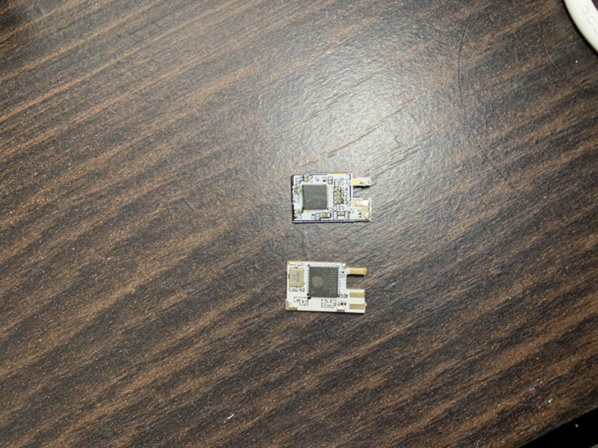

    @MustangMatt
    I have a bunch of these after did a transplant on ewelink bulbs. The one i got is similar to esp-01d
    Spoiler:
    [BK7231T] My HTTP server, configurator, MQTT support from Home Assistant [BK7231T] My HTTP server, configurator, MQTT support from Home Assistant [BK7231T] My HTTP server, configurator, MQTT support from Home Assistant
