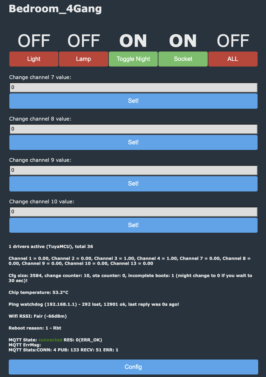

  • HomeMate Wi-Fi + Bluetooth Smart 4 Gang Touch Switch for Roma fitting uses a CB3S module with BK7231N and TuyaMCU control.
  • The switch stacks three soldered boards: touch/controller, relay board, and power board, with long header pins linking them together.
  • It exposes 12 dpIds and uses 4× 5A 230V relays, a ULN2003A Darlington array, and an HLK-PM01L power module.
  • OpenBK7231T firmware is installed by running TuyaMCU, mapping channels with autoexec.bat, then uploading the file, rebooting, and configuring MQTT.
  • Two datapoints remain unclear: Delay-off Schedule on dpId 19 and Memory Status on dpId 14.

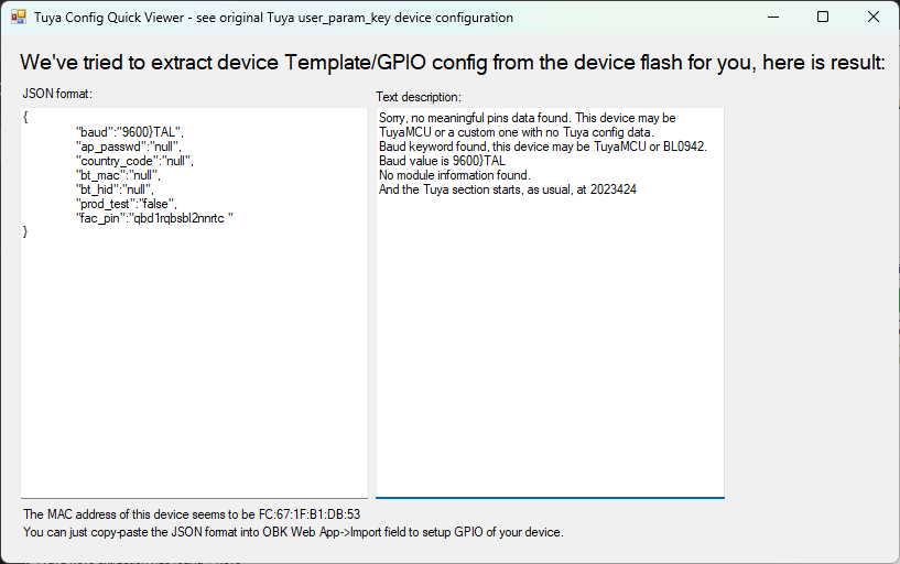

    latocheski
    Posts: 8
    >>20746246
    Yes, I used it but removed it from the account.
    I got a similar model, do you think you can add it to my Tuya account to extract the MCU settings?
    I tried to make a backup and restore the old model but without success, the Tuya application did not find the device.
    Screenshot of Tuya Config Quick Viewer showing attempts to extract device GPIO configuration.
  • #32 20915516
    Posts: 14792
    Rate: 12937
    @latocheski are you really, really, 100% sure that you have rebooted device after applying that config?
    It really should not blink constantly once it has WiFi state 0x04 applied.
  • #33 20915852
    latocheski
    Posts: 8
    Yes! Hundred times! Burned the firmware some times too. No logs when press the physical buttons in the web app, no bind turn off button to correct channel. I set channel 1 to turn on and ch 7 send text "1" to off the relay. Very weird.
  • #34 20920117

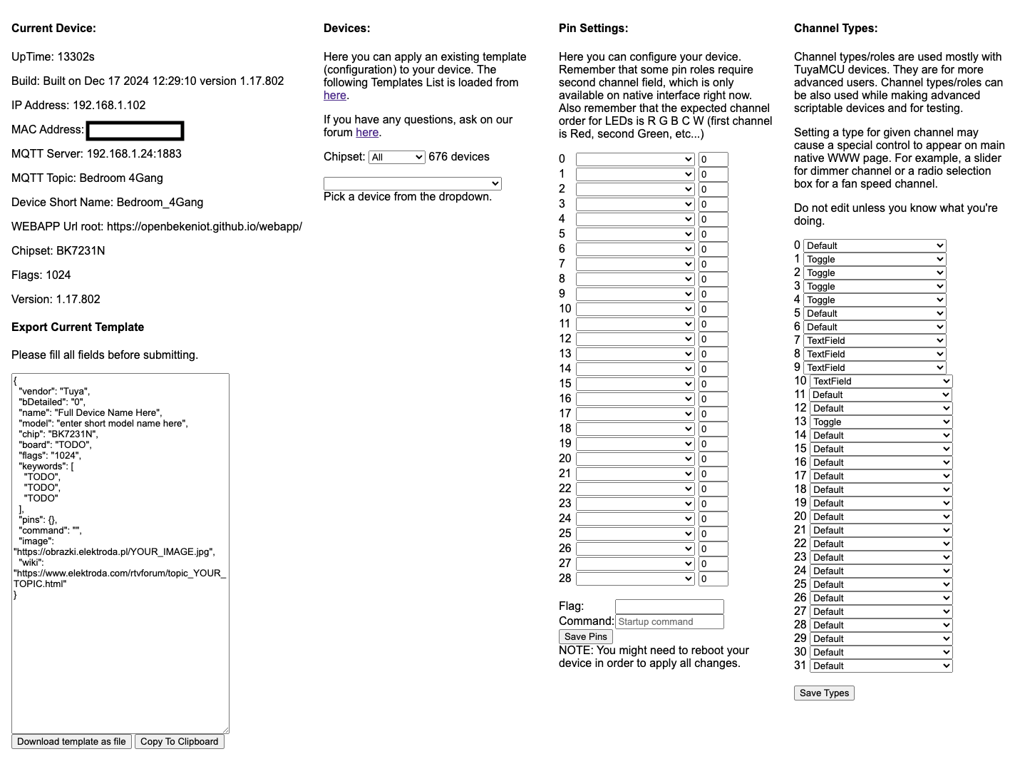

  • Clarifying DP14 and DP15 enum settings
    #36 20934983
    rt400yuval
    Level 4  
    Posts: 15
    >>20742733
    Hi.
    I did like you said about DP14 and i see the option (OFF ON REMEMBER) so how can we set it on the correct option ?
    for me its on Remember but in GUI its mark on OFF...
    also i have other DP 15 that is set on light_mode:
    "15": {
                    "code": "light_mode",
                    "type": "Enum",
                    "values": {
                        "range": [
                            "none",
                            "relay",
                            "pos"
    cant found any match for that...
    thanks for you help..

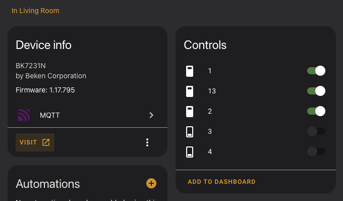

  • Cloudcutter flashing process reaches firmware selection
    #42 21355940
    gavashkarraju
    Thankyou.

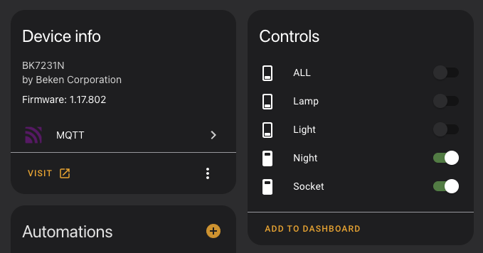

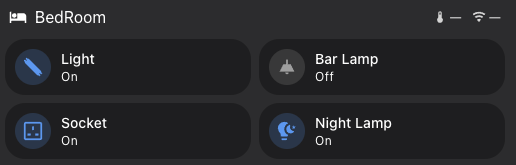

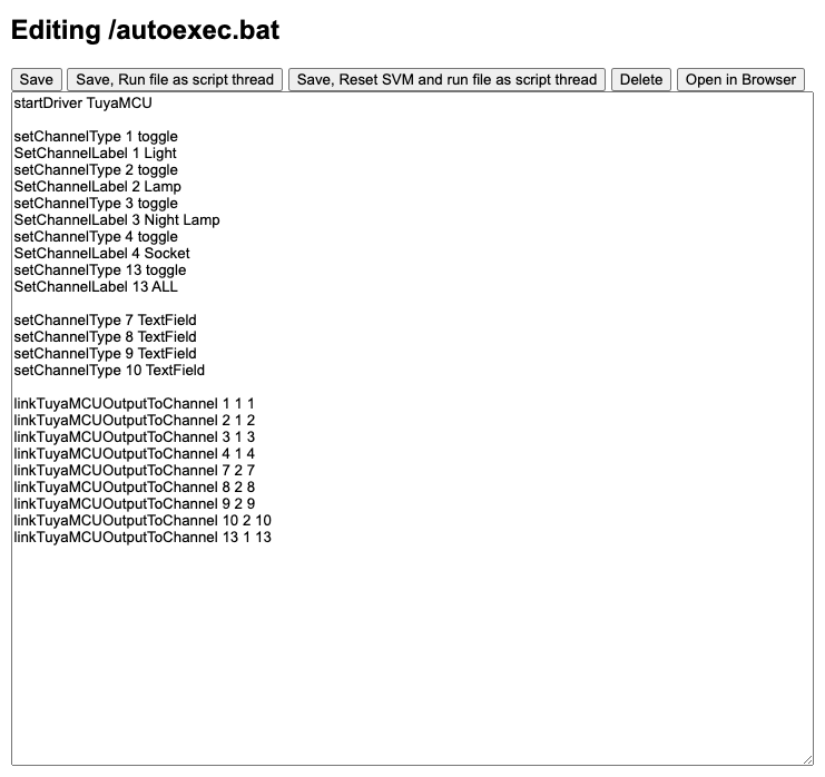

    User interface of a bedroom 4-gang smart switch application. Screenshot of editing the /autoexec.bat file with various channel settings and configurations. OpenBeken configuration interface for BK7231N device. Smart device control interface with firmware details and control switches.
    Home Assistant interface for a bedroom with four devices: light on, bar lamp off, socket on, and night lamp on.

3. What goes into autoexec.bat for full 4-relay control?
Paste the 23-line script posted by marioalmeida, which sets channel types, links dpIDs 1-4 & 13 to toggles, maps timers as TextFields, then reboot [Elektroda, 20103196]

10. Is there a known failure edge-case?
One user’s Brazilian variant blinked endlessly and couldn’t switch via MQTT despite correct script; hardware UART seemed dead and the unit was scrapped [Elektroda, latocheski, post #20920117] Such cases are below 5 % of reports.
