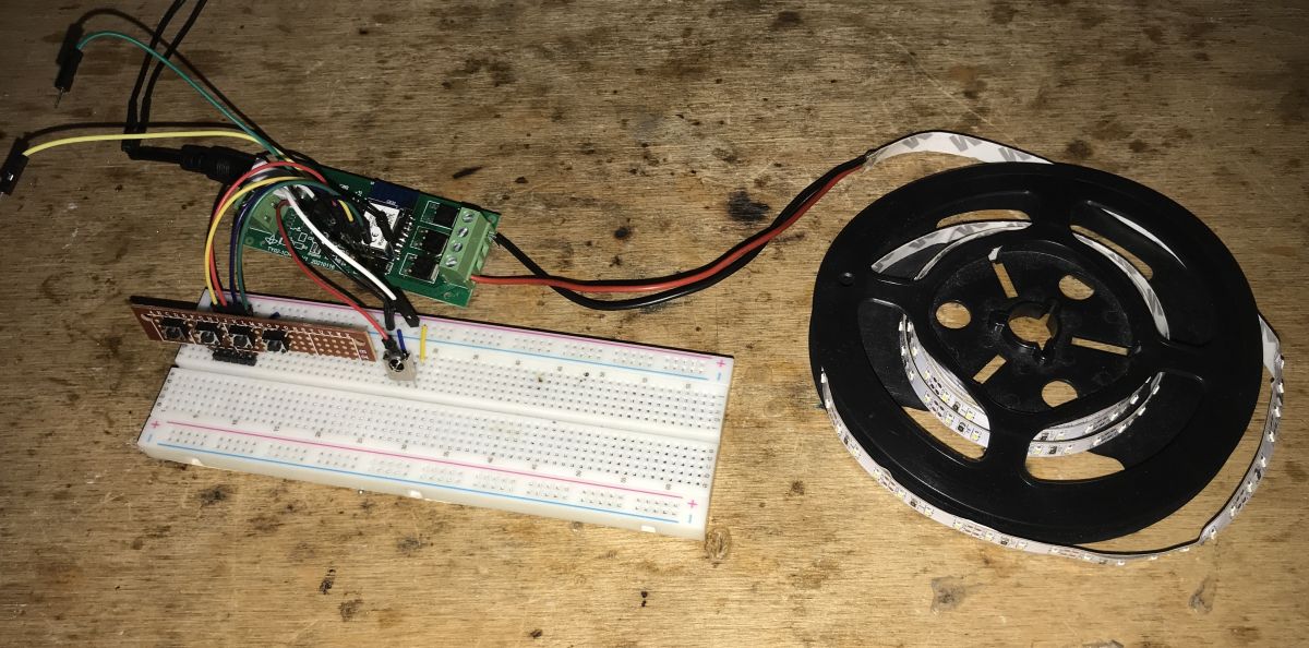

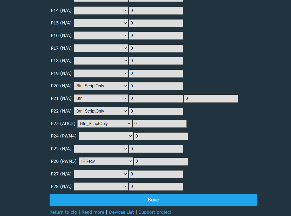

    In a meantime - take a look here. I have added a scrap buttons and IR receiver from DVD player to LED strip and it works:
    BK7231N - Universal IR Remote Contorl
    SetButtonTimes 10 3 3
    alias add_turnoff_event addRepeatingEvent 4 1 led_enableAll 0
    addEventHandler OnHold 23 add_dimmer 10
    addEventHandler OnHold 22 add_dimmer -10
    addEventHandler OnDblClick 22 led_dimmer 5
    addEventHandler OnDblClick 23 led_dimmer 100
    addEventHandler OnClick 20 add_turnoff_event
    addEventHandler2 IR_Samsung 0x707 0x62 add_dimmer 10
    addEventHandler2 IR_Samsung 0x707 0x65 add_dimmer -10
    addEventHandler2 IR_Samsung 0x707 0x61 led_enableAll 0
    addEventHandler2 IR_Samsung 0x707 0x60 led_enableAll 1
    First button is On/Off, second and third are brightness (hold to increase/decrease, double click to set lowest/highest), fourth is a delayed turn off (for testing purposes, it turns off after few seconds).

    avdm wrote:
    Below as screenshot of my config of the s08.
    Thank you for the screenshot - with the correct pin for IRSend I can now pick up flashes with my phone's camera when doing something like:
    IRSend NEC 0x08 0x04 1
    Unfortunately looks like my aircon remote just shows unknown as below. The brand is EcoAire but the remote is ZH/TY-01 which appears to be used for several different brands and is listed as supported on https://github.com/crankyoldgit/IRremoteESP8266/blob/master/SupportedProtocols.md
    Info:MQTT:Publishing val IR_UNKNOWN 0x0 0 to obk1218B3C1/ir/get retain=0
    Info:IR:IR MQTT publish IR_UNKNOWN 0x0 0 took 5ms
    Info:MQTT:Publishing val {"IrReceived":{"Protocol":"UNKNOWN","Bits":0,"Data":"0x0"}} to obk1218B3C1/RESULT retain=0

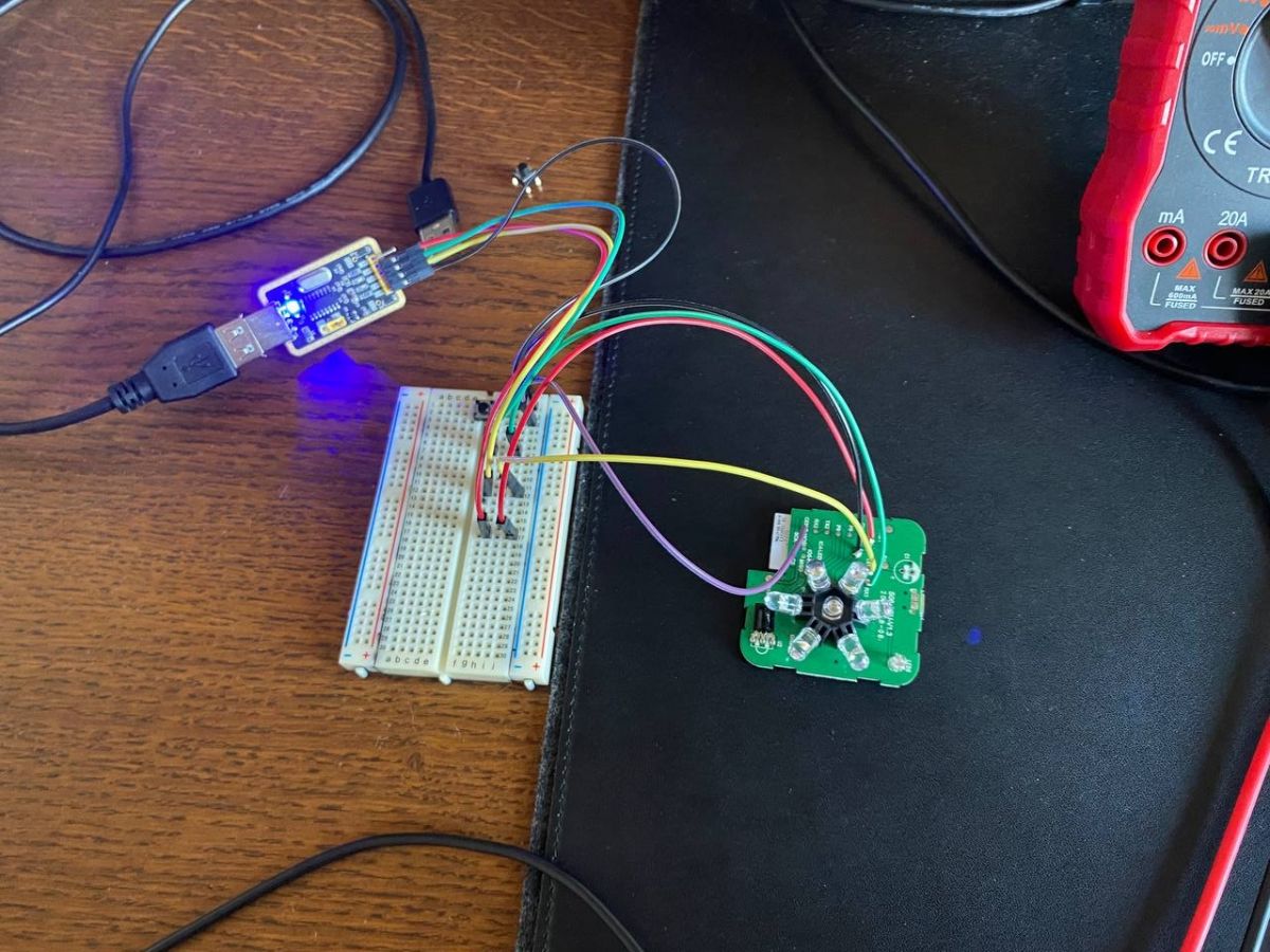

    thinhvq wrote:
    Hi,
    I have a S06 IR (PCB: S06-CBU-V1.3) and want to flash BK7231N firmware. Is anyone help me how to flash it via serial? Circuit board of an open Wi-Fi IR controller case. A circuit board with an electronic module in an open casing.
    Thanks you
    I've been able to flash it with the following command:
    ./uartprogram OpenBK7231N_QIO_1.15.240.bin -d /dev/ttyUSB0 -w -s 0x0 -u
    I previously tried without "-u" and "-s 0x0" and I was unable to flash it.
    The connections I use are the common one: VCC:VCC, GND:GND, TX:RX, RX:TX, CEN:GND, as shown in the following pic.
    I will now proceed with the configuration via the webUI.

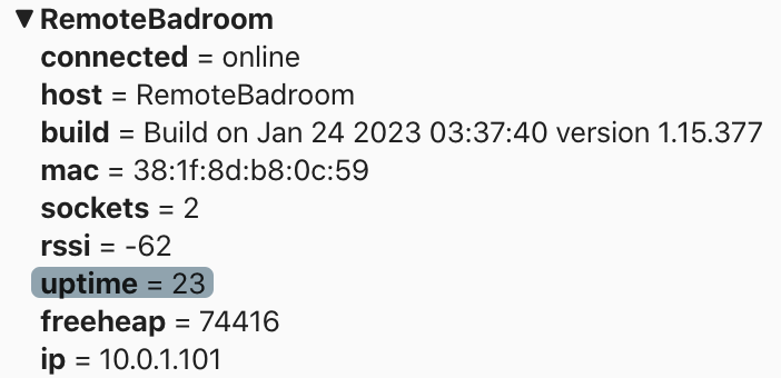

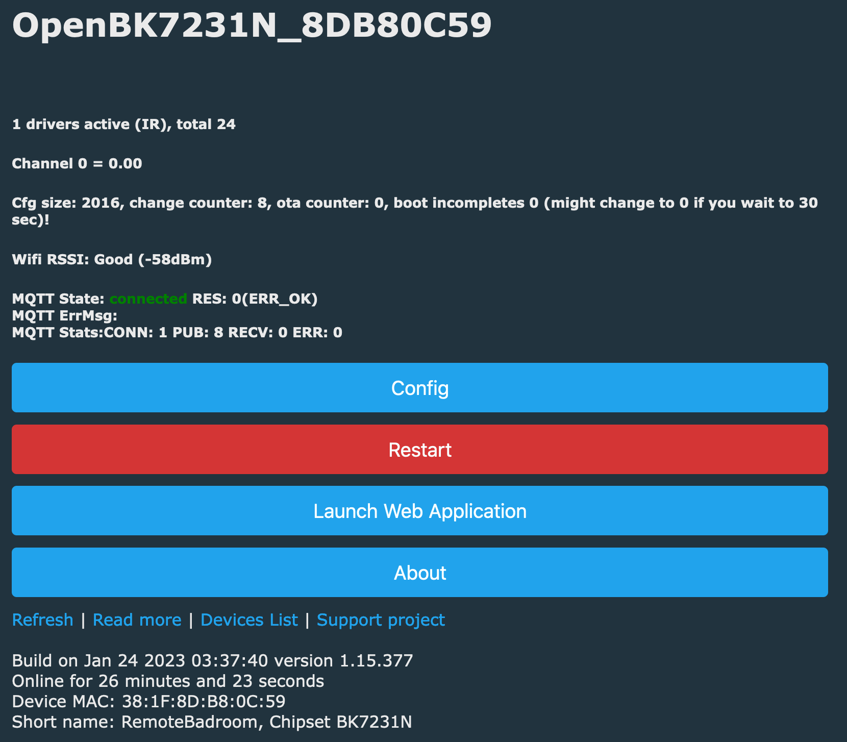

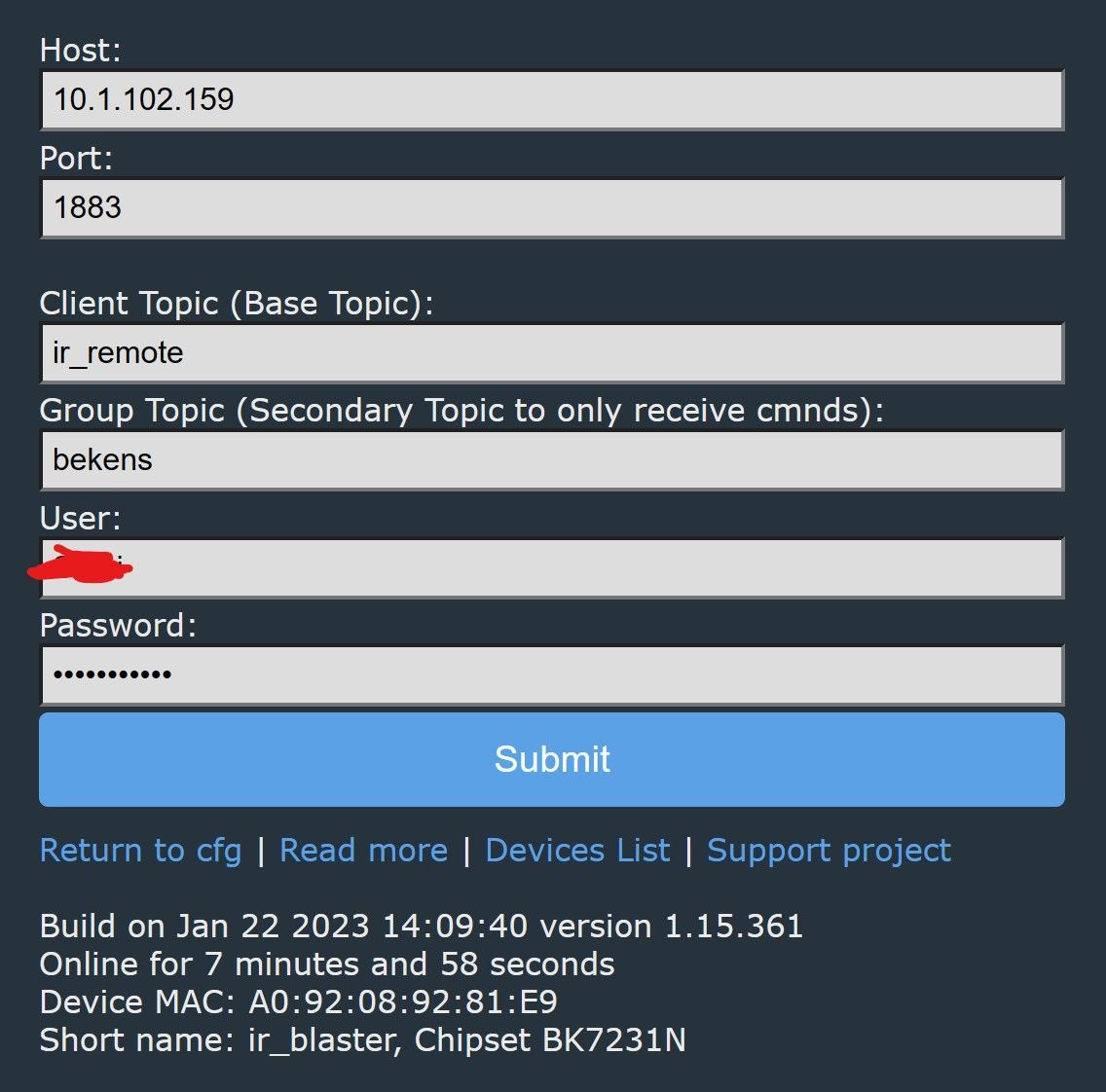

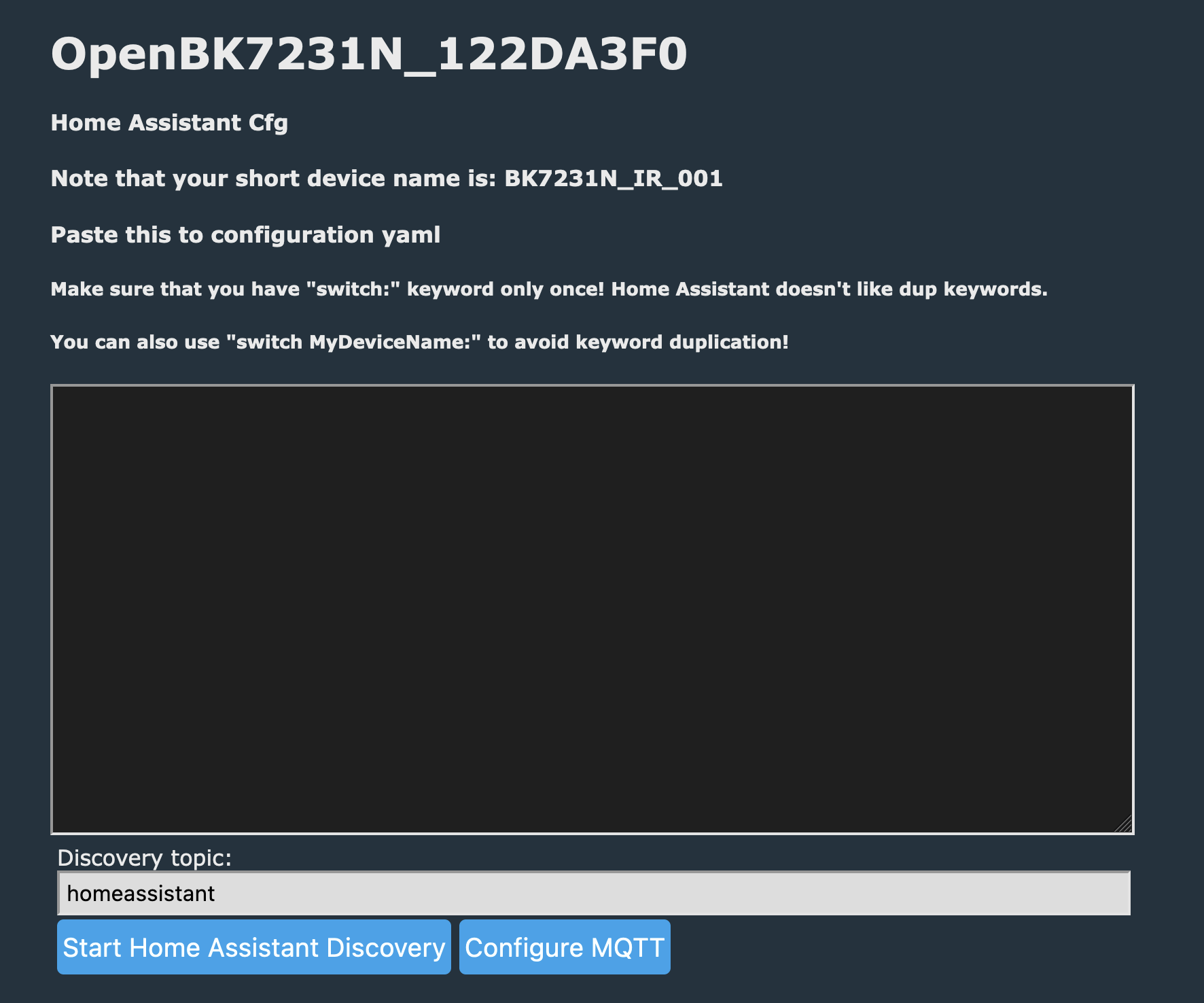

    I have an S06 Universal Remote IR Blaster and can't set it up to work with Home Assistant.
    I installed the firmware and configured mqtt
    BK7231N - Universal IR Remote Contorl BK7231N - Universal IR Remote Contorl

    Antiheld
    e2ret wrote:
    Hi
    In the Git Repo is writte:
    Note: Currently, discovery is only implemented for light and relay entities.
    You have to put mqtt-config manually.
  • #104 20402630
    e2ret
    how to do it?
  • #105 20402633
    Antiheld
    e2ret wrote:
    how to do it?
    I think you already did as it says "connected". Just try to send mqtt-messages to your divices topic.
    Did you setup MQTT-Config?

    #106 20402643
    e2ret
    Antiheld wrote:
    e2ret wrote:
    how to do it?
    yes i have it set up
    mqtt explorer
    Added after 1 [hours] 54 [minutes]:
    I got the command to work
    Code: YAML
    how to send mqtt from home assistant?
    Code: YAML
    this does not work
  • Add cmnd prefix to Tasmota-style MQTT commands
    #107 20402877
    Posts: 14805
    Rate: 12972
    Hey @e2ret , sorry for being not active in this topic, I am doing finalizations of Alexa and ioBroker compatibility (just a tiny fixes because we already mimic Tasmota device well), but it seems your issue is here:
    RemoteBadroom/IRSend
    The topic for commands is like in Tasmota,
    cmnd/RemoteBadroom/IRSend
    So you need to add a "cmnd".
    You can also try (just to debug stuff) to use POWER command on your sockets/lights, it works like in Tasmota, but all commands require cmnd prefix.
    cmnd/RemoteBadroom/POWER

  • #115 20482995
    alekindre
    >>20481993
    Thank you very much! Ended up flashing it with the new tool.
    I'm stuck now in trying to add it to Home Assistnat. I connected the MQTT but what's next?
    It does not provide me with the yaml conf.
    How do it import entities?
    Thank you for your help!
