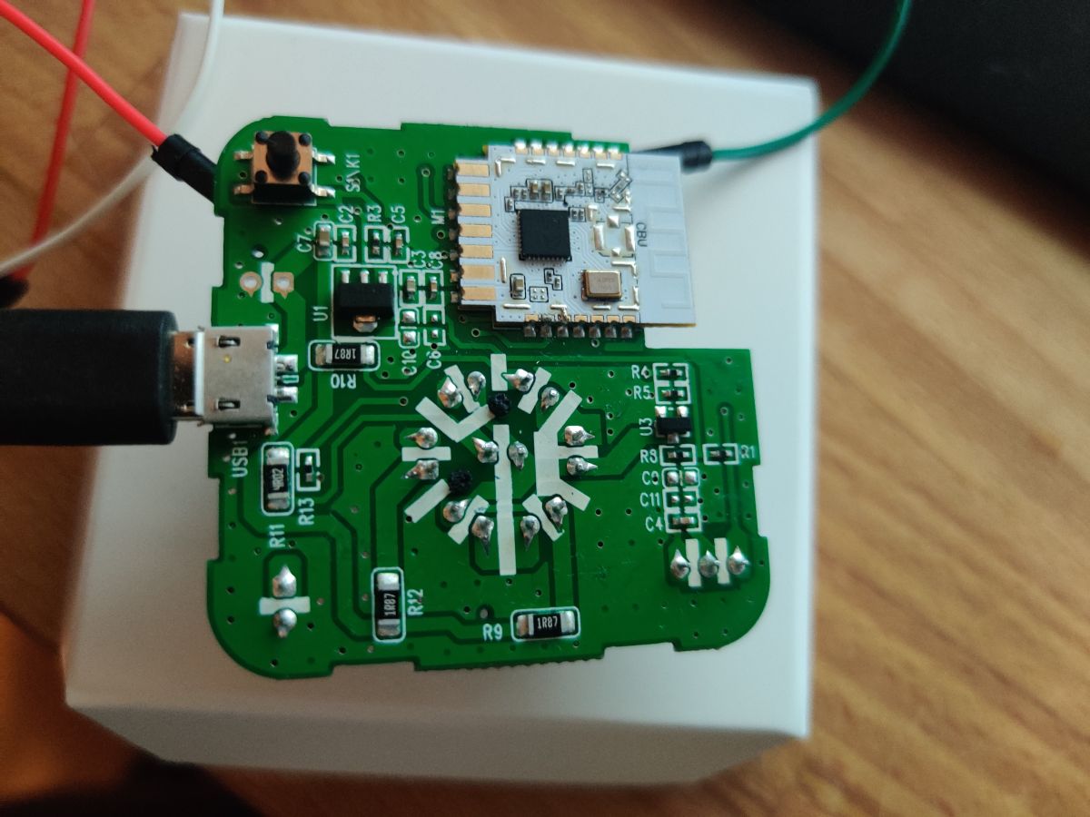

    I've received a second version of the blaster. Here's a tear down of both blasters and the Pin connections that seem to work for me.
    Model: iH-F8260 / PCB: v4
    Photos:
    Spoiler:
    BK7231N - Universal IR Remote Contorl BK7231N - Universal IR Remote Contorl
    Model: iH-F8260 / PCB: v4 pin
    Pin Symbol I/O type Function Possible connection
    14 P7 I/O GPIOP_7, which corresponds to P7 of the IC, PWM 1 IRRecv
    5 P26 I/O GPIOP_26, which corresponds to P26 of the IC, PWM 5 IRSend
    13 P8 I/O GPIOP_8, which corresponds to P8 of the IC, PWM 2 (wifi) status led
    Model S08 / PCB: S06-CBU-V1.2
    Photos:
    Spoiler:
    Model S08 / PCB: S06-CBU-V1.2 Pin
    8 P8 I/O Support hardware PWM (Correspond to Pin 24 of the IC) IRrecv
    9 P7 I/O Support hardware PWM (Correspond to Pin 23 of the IC) IRsend
    12 P24 I/O GPIOP_24, which corresponds to P24 of the IC, PWM 4 (wifi) status led
    They can receive each other’s commands. Testing a command can be done trough the terminal/log screen. Example:

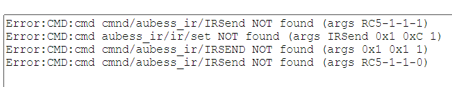

  • MQTT IRSend command format for BK7231N blaster
    #73 20309296
    avdm
    Posts: 9
    ionoleinic wrote:
    Hi people, which is the correct mqtt topic for sending IR comands ?
    I have tried cmnd/ir_name/IRSend RC5-1-1-0 and cmnd/ir_name/IRSend RC5 0x1 0x1 0.
    Both aren't recognized.
    I have this device : https://www.elektroda.com/rtvforum/topic3933390.html
    Thanks.
    Strange, this works for me:
    cmnd/IRBlaster/IRSend
    Raw: NEC 0x80 0x12
    Here are screenshots of mqtt explorer and the log.

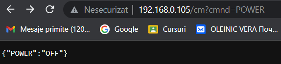

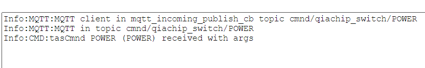

  • Clarifying POWER command behavior over HTTP
    #81 20315543
    Posts: 14771
    Rate: 12914
    ionoleinic wrote:
    And i have one problem.When i send cmnd/name/POWER without payload i should get current power status without do nothing, but your obk ignore it and power off the relay.
    This is not supposed to happen. I will try to fix it, but first, I need more information.
    Does the problem also happen if you send it by HTTP, like in Tasmota?
    I mean:
    http://127.0.0.1/cm?cmnd=POWER
    it should just return current state.
    On the other hand, this should power off:
    http://127.0.0.1/cm?cmnd=POWER%20OFF
    and this power on
    http://127.0.0.1/cm?cmnd=POWER%20ON
    Please check and provide the information about which I asked above.

  • MQTT get command fails to publish current state
    #83 20321723
    ionoleinic
    Posts: 48
    I mean:
    and this power on
    HTTP works
    But with mqtt, it doesn't publish current state to the topic qiachip_switch/1/get.

  • Mitsubishi IRSend produces no LED output
    #87 20324766
    doe699450
    Hello @p.kaczmarek2 ,
    According to info on Tasmota docs (https://tasmota.github.io/docs/Tasmota-IR/) , the protocol of my Aircon should be supported (MITSUBISHI_AC) in IRremoteESP8266 library that used by Tasmota.
    If I type a command like "IRSend Mitsubishi 0x08 0x04 1" and send it in command prompt, I get
    Info:IR:Delay 100ms
    Info:IR:IR send Mitsubishi 0x4 0x8 protocol 0 addr 0x4 cmd 0x8 repeats 0
    But I can't see any data transmition by IR LED. At the same time command like "IRSend NEC 0x08 0x04 1" work out right and I can see IR LED transmition.

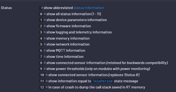

    SENZOR publish -> cmnd/mqtt_name/STATUS 8 reply -> stat/mqtt_name/STATUS8
    ex. result -> {StatusSNS: {
    Time: '0000-00-00T00:00:00',
    ENERGY: {
    TotalStartTime: '2022-10-13T16:13:07',
    Total: '-:-',
    Yesterday: '-:-',
    Today: '-:-',
    Power: '-:-',
    ApparentPower: '-:-',
    ReactivePower: '-:-',
    Factor: '-:-',
    Voltage: '-:-',
    Current: '-:-',
    if device hasn't sensors, return will be -> {StatusSNS: {Time: '0000-00-00T00:00:00'}}
    NET INFO publish -> cmnd/mqtt_name/STATUS 5 reply -> stat/mqtt_name/STATUS5
