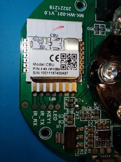

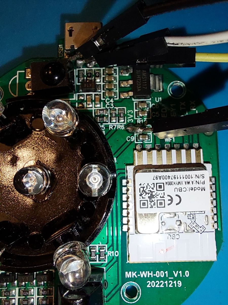

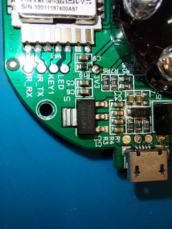

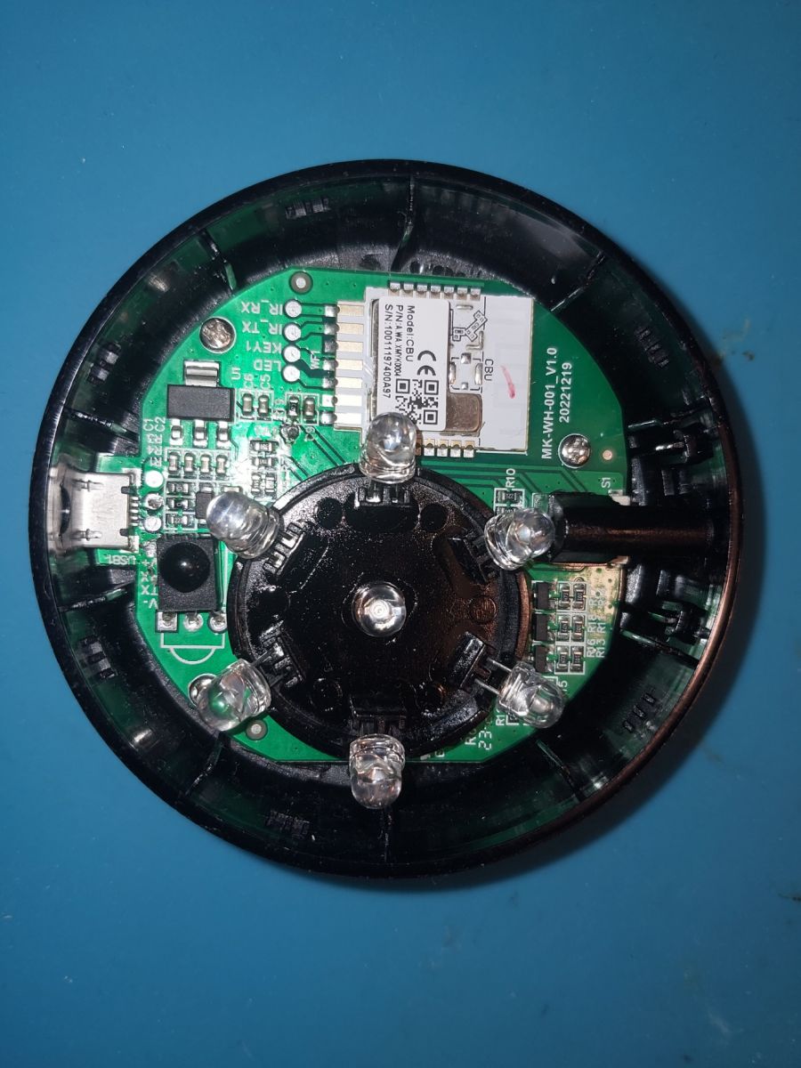

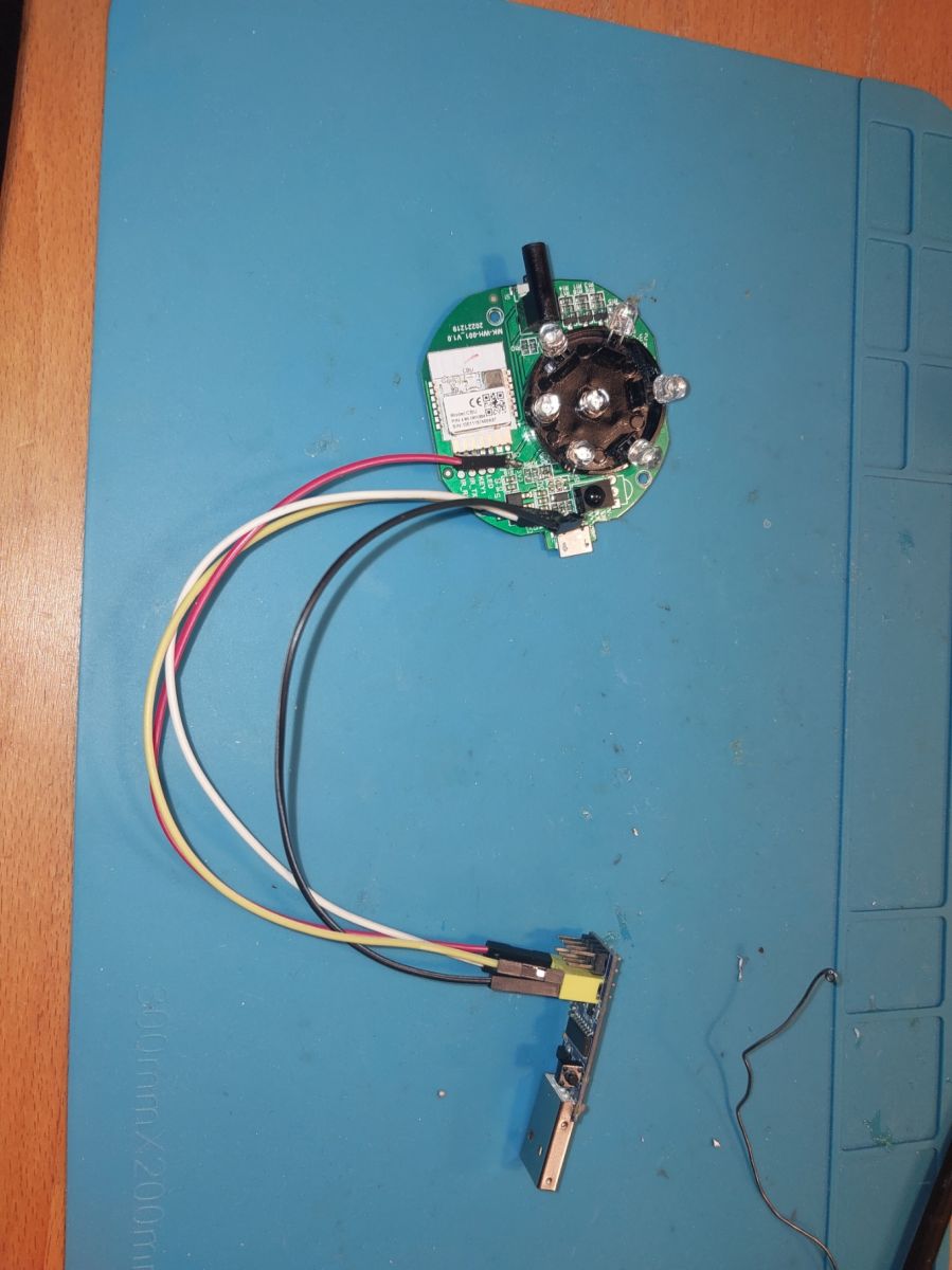

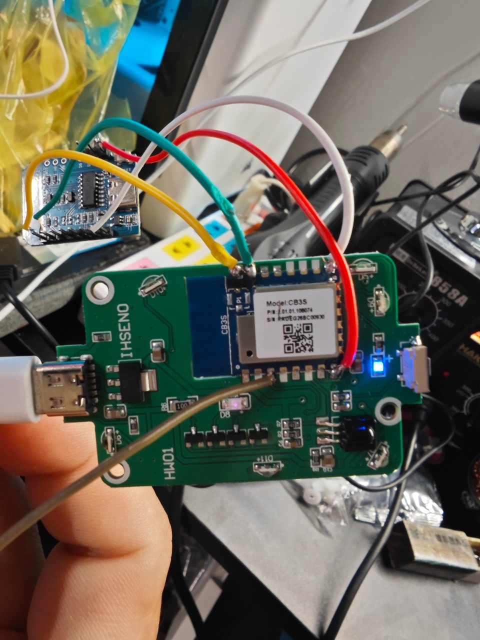

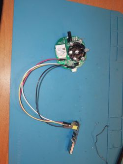

  • BK7231N-based universal IR remote control now has a working IR blaster on firmware 1.15.x, tested on a Model S08 / PCB S06-CBU-V1.2.
  • All flashing pins are exposed on the board, including TX1, RX1, GND, 3.3v, and CEN for reset.
  • After flashing, set PinDescription 7 IRSend, 8 IRRecv, and 24 wifiLed, then restart because IR pins do not change in real time.
  • Firmware 1.15.226 and the webapp log confirm IRRecv captures external remote codes, and IRSend can replay commands like LG-88-130-1.

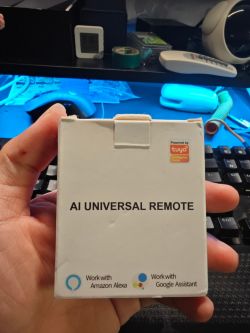

    Hi team, I flashed OpenBK7231N on AI Smart Remote Control (model:IH-F8260), received from Aliexpress and it's working with Home Assistant very well with the configuration below:
      "vendor": "Tuya",
      "bDetailed": "0",
      "name": "AI Smart Remote Control",
      "model": "IH-F8260",
      "chip": "BK7231N",
      "board": "TODO",
      "flags": "4244480",
      "keywords": [
        "TODO",
        "TODO",
        "TODO"
      "pins": {
        "7": "IRRecv;0",
        "8": "WifiLED;0",
        "26": "IRSend;0"
      "command": "startdriver IR",

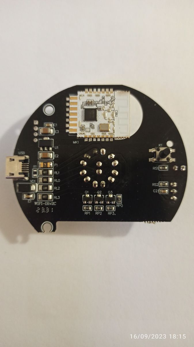

    #127 20735380
    badgerman
    Posts: 177

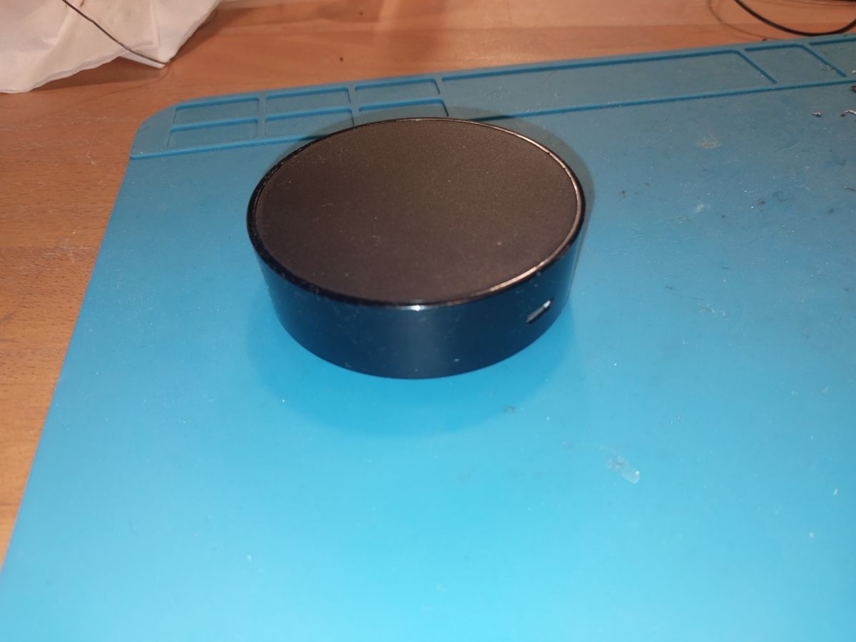

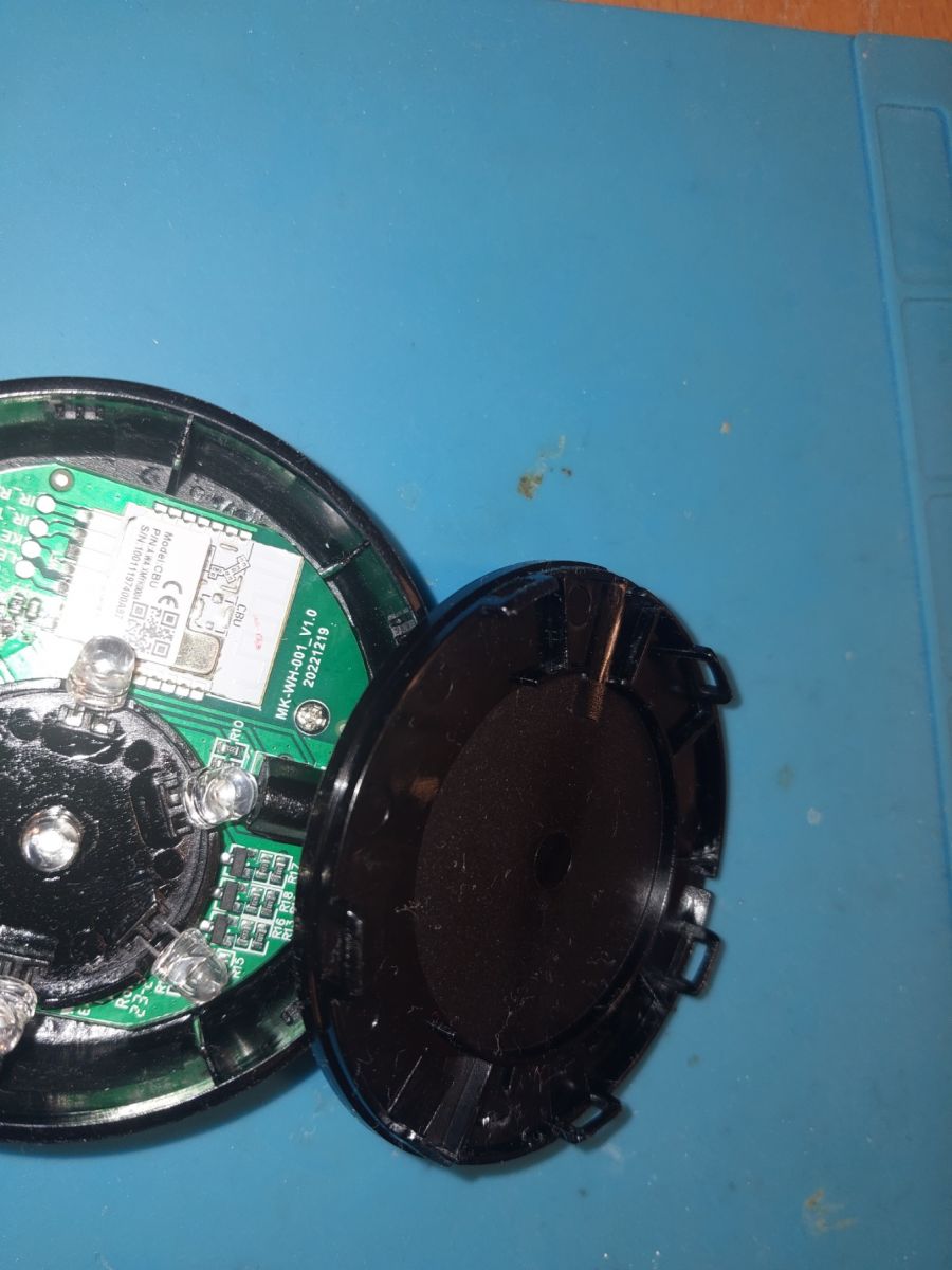

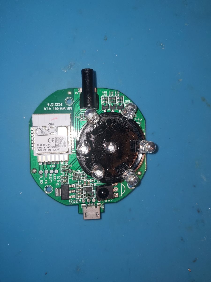

    Hello, dear community of Elektroda.pl.
    I bought an IR Blaster from AuBees - unfortunately, the manufacturer did not create models for it, but it did not do it itself, so it is highly probable that someone else did it and provided an appropriate model.
    Electronic module of an IR Blaster with LED diodes. Photo of the box for the Aubess WiFi Smart IR Controller. WiFi Smart IR Controller packaging with technical details. Black, round AuBees IR Blaster held in hand. Close-up photograph of the IR Blaster AuBees circuit board with a CBU Becken 7231N component.
    As you can see, the device is based on a CBU based on Becken 7231N and I managed to flash it with OpenBecken. The device responds normally on the network.
    Now I have a few questions (edit - I found the answers - I'm posting them for posterity - maybe someone else will need them):
    1. How can I make sure that the 3 pins are correctly assigned - at this point I signed a bit, suggesting in the first post I assigned - pin 7 (PWM1) as IRSend, pin 8 (PWM2) as IRRecv and pin 24 (PWM4) as WiFi Led.
    In the OpenBecken web application it is possible to select a device - if it is on the list (and it is), the pins are provided. If not, I suspect that you need a voltmeter and a script that will send something (and a remote control that will catalyze the receiver to find the receive pin)
    2. I would like to integrate this device with HomeAssistant - what is the best way to do it? MQTT ? Script control? something else?

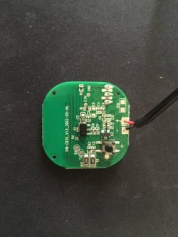

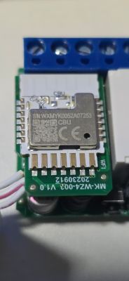

    Hi all. I have this IR module (without the box) and trying to make it work. I applied config for Tuya Generic Smart Wi-Fi IR Remote Control from Temu IRC02 and it works for sending IR commands, which I can verify with flipper zero, but it doesn't receive anything. I tried to set each pin to IRRecv and rebooting the module but so far no luck. What should I try to do?
    Spoiler:
    IR electronic module with visible components and soldered connections. IR module with an integrated circuit on a dark background.

    nvm I figured it out manually) I was sending irsend NEC-EF00-2 from the module to the flipper and when I sent it back to the module it was not showing up in the logs. I enabled flag 15 to allow unknown protocols and then it showed up as Info:IR:IR IR_UNKNOWN 0x8CBEE187 0
    here are the pins if it helps anyone
    Spoiler:
    "pins": {
    "6": "Btn;1",
    "7": "IRRecv;1",
    "8": "WifiLED;1",
    "26": "IRSend;1"

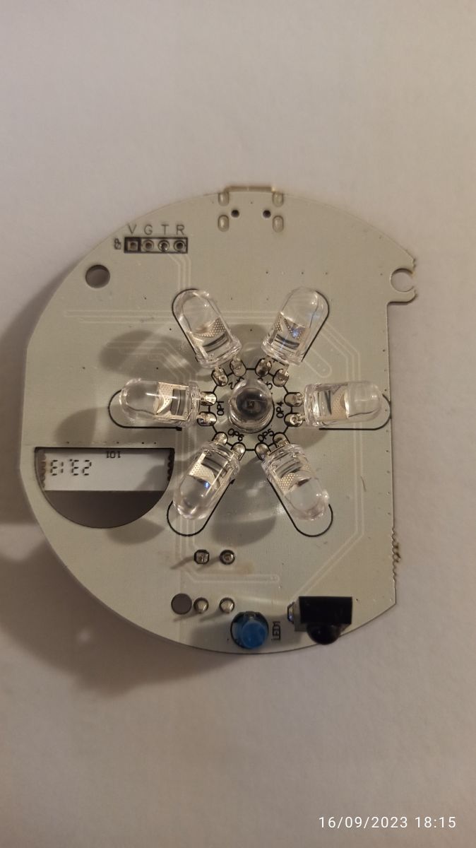

    Hi everyone, I bought an IR controller and flashed it successfully but I don't know how to set the GPIO pins to make it work. Please help me do this. A person holding an AI Universal Remote box compatible with Amazon Alexa and Google Assistant. The image shows a printed circuit board with a mounted CB3S module, connected with multicolored wires. The board includes a USB port and an LED.
    This is json code when flashing :

    Hey @thanhli113 I also got stuck on this when the generated script in the "Import" tab of the web app didn't work for me.
    I went through all the PWM pins (6, 7, 8, 9, 24, 26) til I got everything working, with:
      "pins": {
         "6": "Btn;1",
         "7": "IRRecv;0",
         "8": "WifiLED;0",
         "26": "IRSend;0"
    However, it was only then that I spotted those pin numbers in my JSON.
      "crc": 1,
      "infre": 26,
      "infrr": 7,
      "netnc": 0,
      "netyc": 1,
      "owm": 0,
      "reset_lv": 0,
      "reset_pin": 6,
      "rsthold": 3,
      "wfst_lv": 1,
      "wfst_pin": 8
    So, I think the key fields in your json code are:
    reset_pin: 6 # pin6(PWM0)  - "RESET" button?
    reset_lv: 0  #             - ???
    wfst_pin: 8  # pin8(PWM2)  - "WiFi STatus" LED?
    wfst_lv: 1   #             - ???
    infrr: 7     # pin7(PWM1)  - "INFRared Receive"?
    infre: 26    # pin26(PWM5) - "INFRared Emit"?
    ie. as you have the same JSON as mine (just with a bunch of additional fields).
    (although we do differ on values for owm (0 vs 1) and crc (1 vs 42) ... whatever they are?!?)
    Nb. I could tell I had mine setup correctly because:
    * reset shows up in the logs as `Info:GEN:6 key_short_press` when I press the button
    * wfst LED flashes when connecting to wifi and stays on when connected
    * infrr shows up in the logs when I point a remote at the device and I have `Flag 15 - [IR] Allow 'unknown' protocol` enabled
    * infre shows up when sending an example command `IRSend Onkyo 0x7A 0x354A 1` and looking at the device with an android phone to see the actual Infrared flashes of light
    I then went spelunking around the code looking for why the script generation wasn't working.
    However I don't see any sign of these fields in the templateParser.js.
    Perhaps someone has a PR in the works to add mappings for these extra fields?

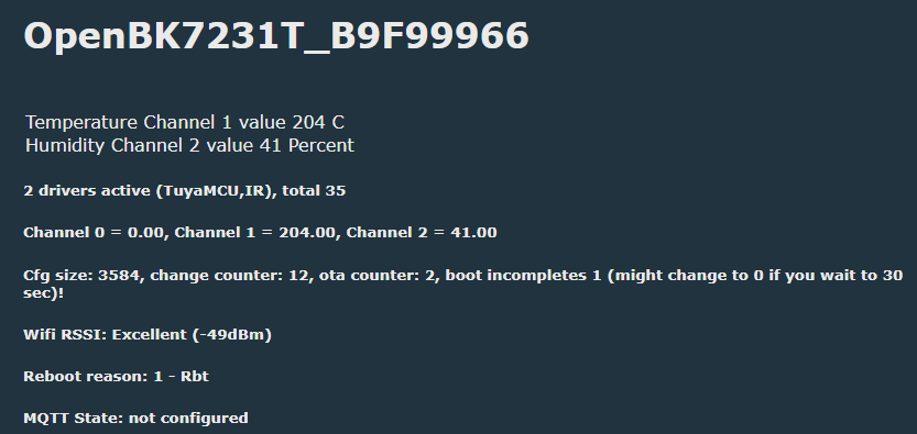

    #134 20840390
    brianroy86
    Posts: 31
    I ended up giving up on esphome and put OpenBKon this, but I have the S08 Pro which has the temp/humidity sensors in it. How would I go about configuring them in OpenBK? They are DP ID's 101 for temp and 102 for humidity.
    In esphome I had to set the uart config as follows.
    uart:
    rx_pin: RX1
    tx_pin: TX1
    baud_rate: 9600
    and the sensors portion to
    sensor:
    - platform: tuya
    sensor_datapoint: 101
    unit_of_measurement: ""
    accuracy_decimals: 1
    filters:
    - lambda: return (x * 0.1) * (9.0/5.0) + 32.0;
    - platform: tuya
    sensor_datapoint: 102
    unit_of_measurement: "%"
    How would this translate to OpenBK?

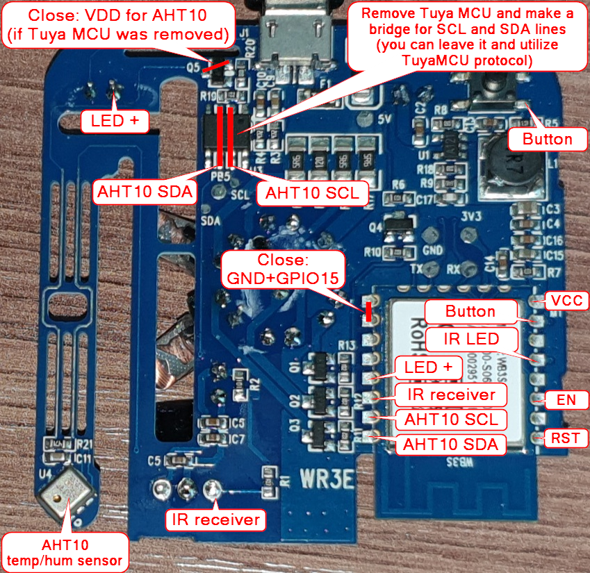

    Ok, so please check my autoexec.bat , save it to the device, reboot it, and open web app log to check if there are any TuyaMCU messages received. We'll know if it's TuyaMCU soon enough.
    Added after 44 [seconds]:
    EDIT: That github makes it clear it's TuyaMCU:
    Circuit board with labeled components such as AHT10 SDA/SCL, buttons, and LED.
    They suggest MCU removal, but that's not needed with OBK
  • #140 20840657
    brianroy86
    Posts: 31
    Your script seems to have worked. I went and added the humidity as well. The only issue, is the temperature is not formatted correctly. It is showing as 205 degrees Celsius, I think I need to move the decimal and convert to Fahrenheit. Any idea how I would do that?
    Screenshot from a console displaying temperature and humidity values.
  • Temperature_div10 channel type for Home Assistant integration
    #141 20840661
    Posts: 14805
    Rate: 12972
    Yes, as specified in our docs:
    https://github.com/openshwprojects/OpenBK7231T_App/blob/main/docs/README.md
    You may change channel type from temperature to temperature_div10. Here are channel types:
    https://github.com/openshwprojects/OpenBK7231T_App/blob/main/docs/channelTypes.md
    Then you will most likely want to do a Home Assistant configuration, that can be done via automatic HASS Discovery:
    EDIT: If you want a display in F I can add it as well, but we don't have this unit yet.

    #148 20846752
    Nargo
    Posts: 495
    Help: 45
    Rate: 206

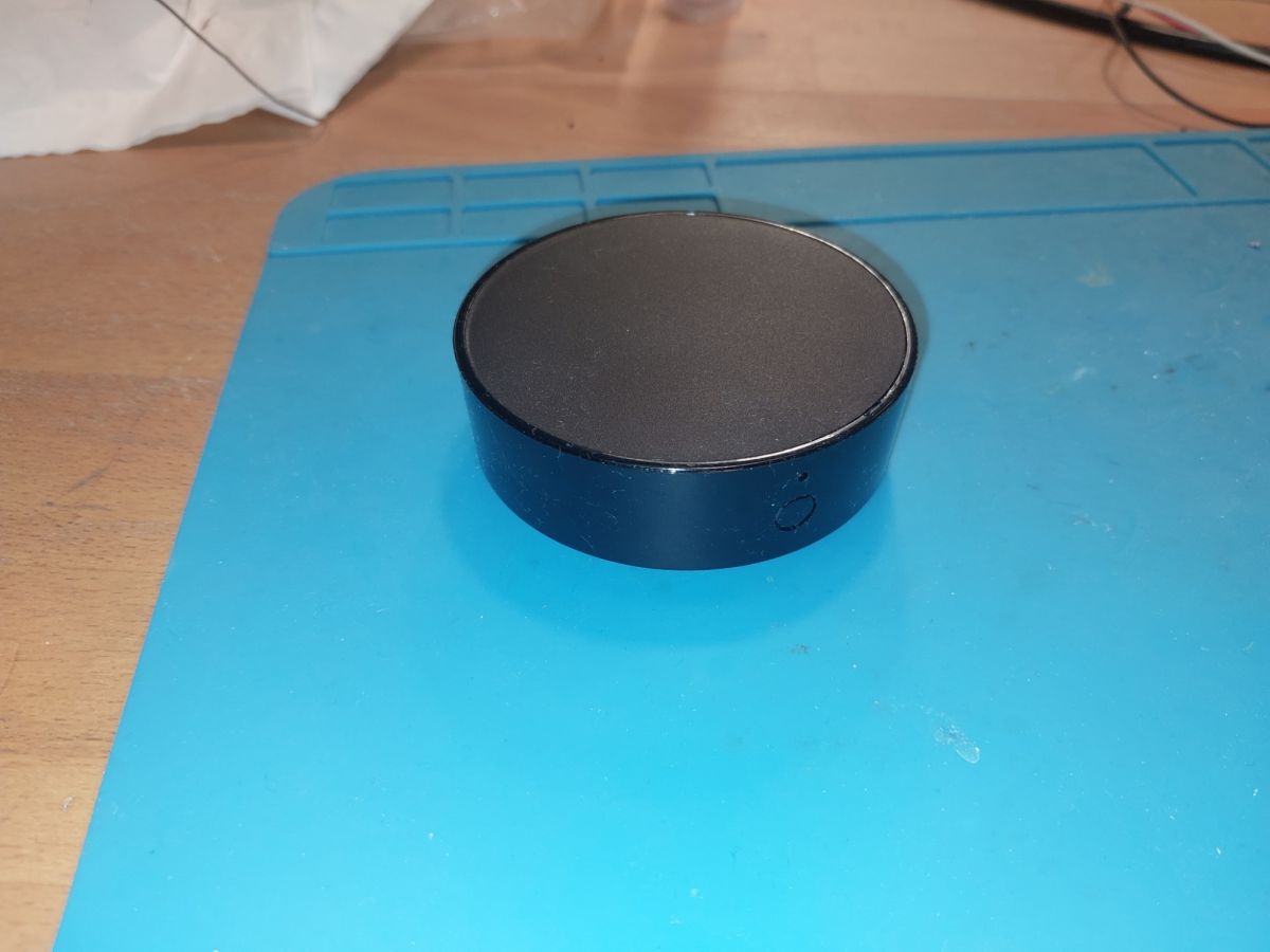

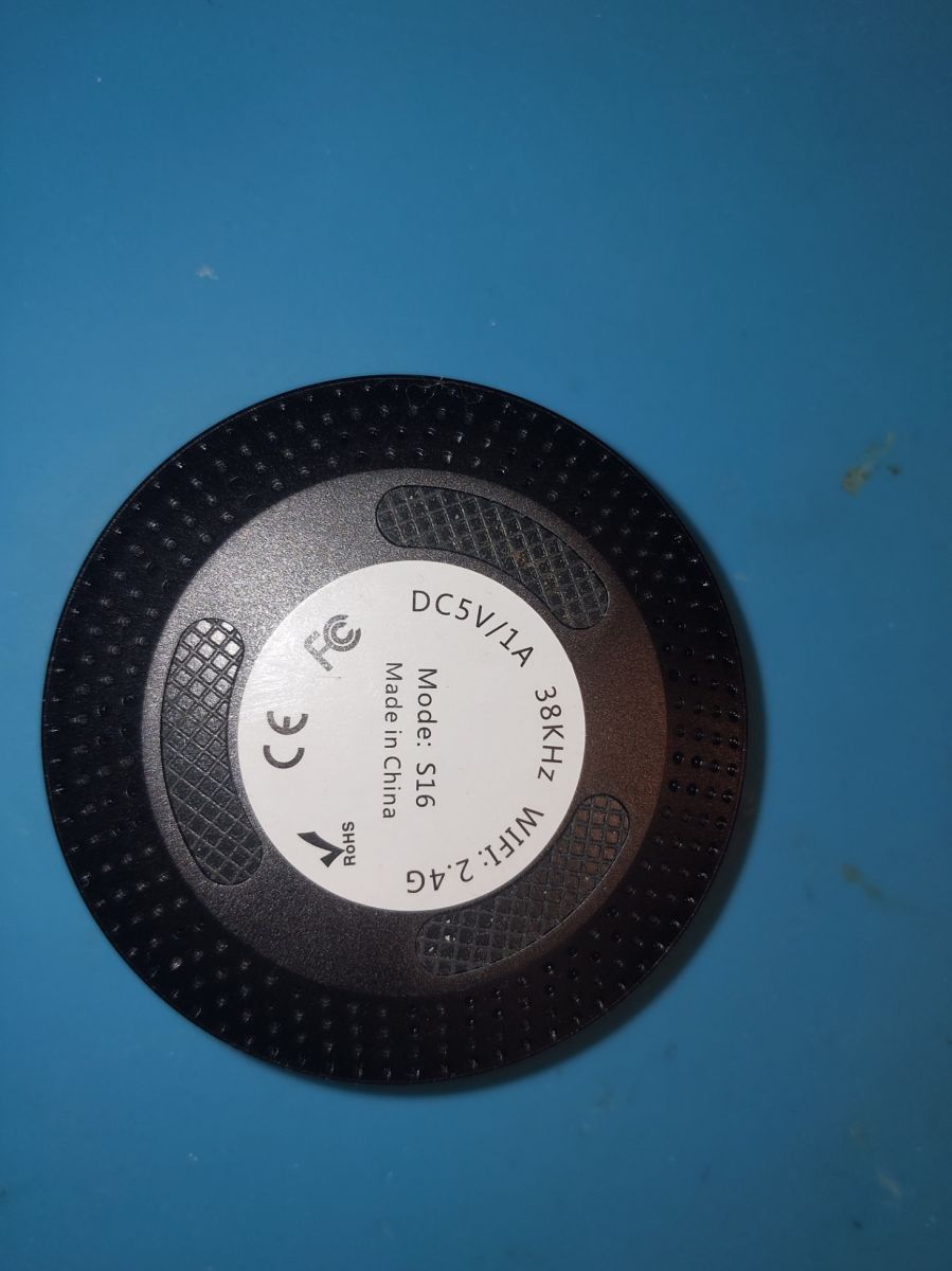

    Today I released the AVATTO S16 IR transmitter purchased a few days ago in "Kleoshop". Below are photos of the device and pin configuration
     "pins": {
        "7": "IRSend;0",
        "8": "IRRecv;0",
        "24": "LED_n;10",
        "26": "Btn;12"
    The board has individual +V, GND, Rx and Tx fields.
    To my unprofessional eye, Rx and Tx are connected to the USB port.
    Reading the batch did not pose any problem.
    The recording failed with the YP-05 converter, probably due to the lack of a decent 3.3V voltage.
    The ESP-01 programmer saved everything on the first try.
    IR Transmitter AVATTO S16 on a blue mat AVATTO S16 IR transmitter on a blue mat. AVATTO S16 IR transmitter on blue background View of the interior of the AVATTO S16 IR transmitter with an open casing. Top view of the AVATTO S16 IR transmitter circuit board with mounted diodes. IR AVATTO S16 board on a blue background Bottom view of a PCB with visible traces. Close-up of a circuit board with a CBU module and pin labels. Close-up of the AVATTO S16 IR transmitter circuit board showing connection pads and electronic components. Close-up of a circuit board with various electronic components and a wireless module. IR AVATTO S16 with wires and adapter on a service mat Box of AVATTO S16 IR Transmitter on a blue mat. Packaging of the AVATTO S16 IR Transmitter with barcode and technical specifications. SmartIR Remote Control (S16) manual on a blue background.
    The problem noticed is that the device does not correctly decode air conditioning remote controls:
    I have Daikin and Kaisai and it's a problem.
