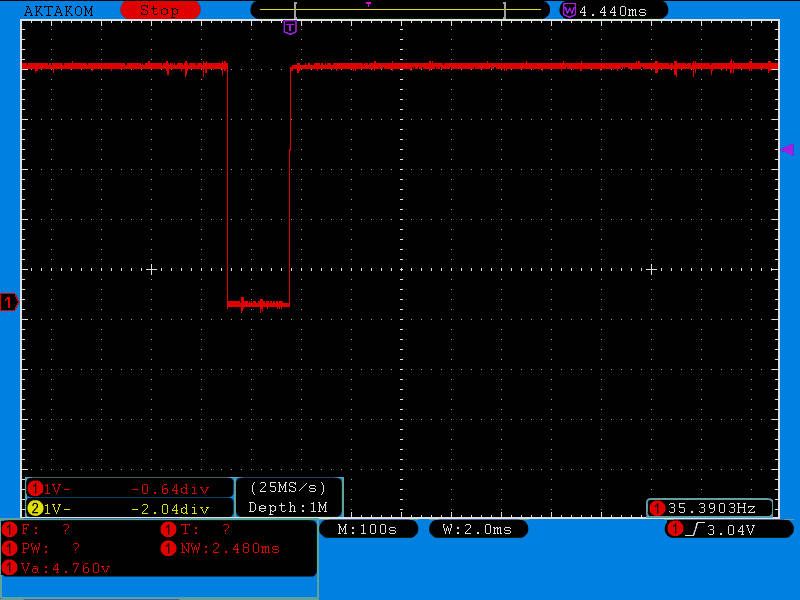

    darkling07
    a little deeper) In my opinion what is happening is as follows:
    Sony remote, button Vol- :
    Info:IR:IR IR_Sony 0x10 0x13 0
    Info:IR:IR IR_Sony 0x10 0x13 1
    Oscilloscope waveform of an IR signal for a Sony remote.
    send command:
    irsend sony-10-13-1
    info:IR:IR send sony-10-13-1 protocol 21 addr 0x10 cmd 0x13 repeats 1
    result:
    Signal waveform at a frequency of 35.3903 Hz displayed on an oscilloscope.
    Just the start bit!
    The command is sent like this:
    drv_ir.cpp:459
    IRData data;
    memset(&data, 0, sizeof(data));
    here the numberofbits value in the structure becomes zero and when you parse the command, it's not set
    drv_ir.cpp:474
    pIRsend->write(&data, (int_fast8_t) repeats);
    IRSend.hpp:152...
    size_t IRsend::write(IRData *aIRSendData, int_fast8_t aNumberOfRepeats) {
    IRSend.hpp:205
    sendSony(tAddress, tCommand, aNumberOfRepeats, aIRSendData->numberOfBits);
    ir_Sony.hpp:
    sendPulseDistanceWidth(&SonyProtocolConstants, tData, numberOfBits, aNumberOfRepeats);
    In other protocols (e.g. NEC) the number of bits is a constant, so everything works there.
    I don't know how to fix this better. Maybe use sony for protocol sony12 and add protocols sony15,sony20. Or some other way

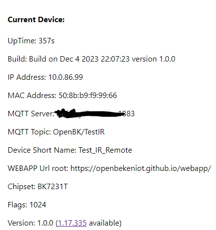

    brianroy86
    Posts: 31
    Following back up on this. Is there a different firmware I should be installing to get the IRSend pin working? Is the VFonov version the ir-update-test branch?
    One odd thing that I've noticed is that even though I install the 1.17.135 version the web interface shows version 1.0.0. I use the OpenBK7231T_1.17.335.rbl file from the github, but the config page and the main page both show that I'm on 1.0.0, but the build was from December 4th.
    Screenshot showing device information with a software version discrepancy.

    brianroy86
    Posts: 31
    Just updated to the newest version (343) and the version issue is fixed, the wlan light still never lights up and the IRSend doesn't work. @p.kaczmarek2 do you have any recommendations on things I could try? I'd love to get this working.

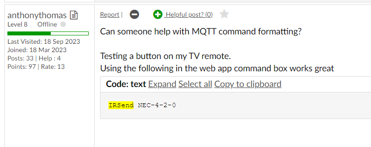

  • #158 20861773
    brianroy86
    Posts: 31
    I'm just trying to get it to send anything at this point.
    I'm just trying now from a random IR remote for some Christmas lights and sent the following command.
    IRSend IR_NEC 0x0 0x45 0
    And in the logs I see the following:
    Info:IR:IR send IR_NEC 0x0 0x45 0 protocol 0 addr 0x0 cmd 0x45 repeats 0
    Info:CMD:[WebApp Cmd 'IRSend IR_NEC 0x0 0x45 0' Result] OK
    Info:IR:IR IR_RC5 0x0 0x40 0
    But nothing happens and I don't see the leds light up through my phone.

  • #163 20862511
    Posts: 14677
    Help: 656
    Rate: 12700
    You need to include protocol name in the IR string, without IR_ suffix
    Take a look, this is from a previous page of this thread, it was reported by user to work correctly:
    BK7231N - Universal IR Remote Contorl
  • #164 20862526
    brianroy86
    Posts: 31
    Dude thank you so much! That did the trick! Also, it turned out that the pins on the S08Pro are different from the S08 I believe. I had to use
    P8 (PWM2) for IRRecv
    P9 (PWM3) for WifiLED_n
    P26 (PWM5) for IRSend
    Then when I put in your command IRSend NEC-4-2-1 it worked! Now to get it working with mqtt and HA, then I'll finally be able to add all my IR Christmas decorations.

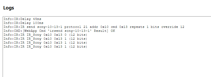

  • #166 20883323
    Posts: 14677
    Help: 656
    Rate: 12700
    Thank you, it's fixed now.
    irsend sony-10-13-1
    this will send by default 12 bit Sony, you can override with:
    irsend sony-10-13-1-NUMBITS
    Can you check if it works now?

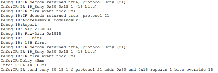

  • #173 20951181
    wing76
    Sony 12-bit command work good for TV,
    Sony 15-bit command for AV_Reciver and 20-bit command for blu-ray player are sent judging by the logs but do not trigger the devices(
    Screenshot of logs for decoding and sending IR commands using Sony protocol.
    no any device reaction
    p/s
    I found the reason, I need to send it
    Sony 30 15 3 F
    then it will work

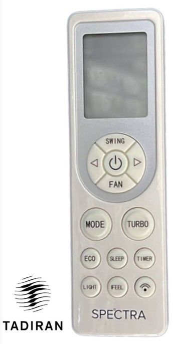

  • #175 21067241
    yarix2
    Posts: 23
    Rate: 15
    hi
    using version 1.17.566, I can't receive any code from my A.C. remote.
    i have a "Spectra\Tadiran" A.C. with remote model "RC1A3" (or RC1A4) - BTW, it may also be similar to "SANLUX Sanyo"
    when i try to learn the codes, most keys does not send anything, except to 1 or 2 keys which generates the following log lines:
    Debug:IR:IR decode returned true, protocol 1
    Debug:IR: Raw-Data=0xC800
    Debug:IR: 48 bits
    Debug:IR: LSB first
    Debug:IR:IR decode returned true, protocol PulseDistance (1)
    Info:IR:IR IR_PulseDistance 0x919 0x908 0 (48 bits)
    Debug:IR:IR fire event took 0ms
    Debug:IR: 48 bits
    Debug:IR: LSB first
    Info:IR:IR IR_PulseDistance 0x918 0x908 0 (48 bits)
    Debug:IR: 48 bits
    Debug:IR: LSB first
    Info:IR:IR IR_PulseDistance 0xA18 0xA07 0 (48 bits)
    can you help me debugging this? how can i get the codes from the remote?
    thanks!
    Remote control for Tadiran Spectra air conditioner.

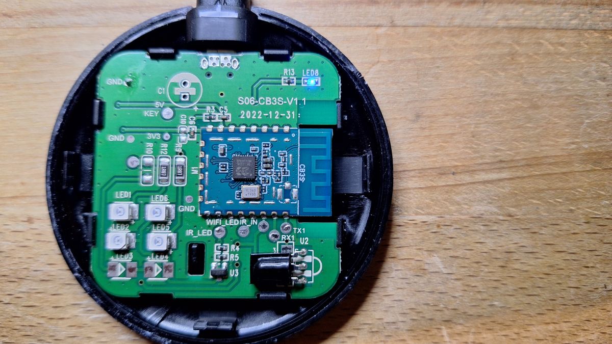

    Hello, I have this one too. How can we flash this?

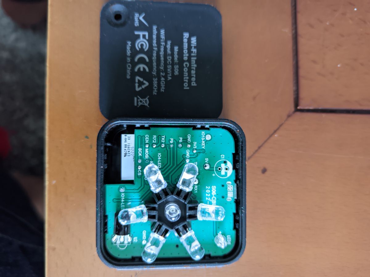

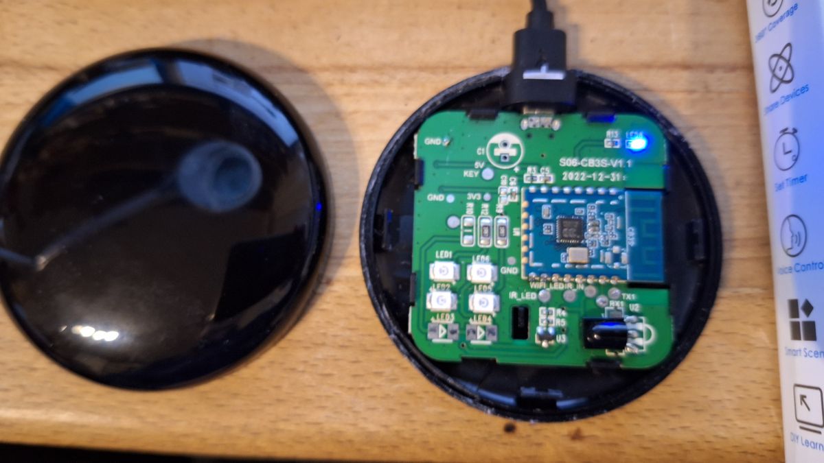

  • BK7231N pin mapping for S06-CB3S-V1.1 board
    #177 21424769
    dixy1
    today I opend my Universal IR Remote Control S08 and find inside another board:
    S06-CB3S-V1.1
    2022-12-31
    I flashed it with BK7231N and test the GPIO
    P6: Btn ,1
    P7: IRRecv ,0
    P8: Wifi LED ,0
    P26: IRSend ,0
    Greatings
    Dixy1
    Interior of a universal infrared remote with visible PCB labeled as S06-CB3S-V1.1.
    Packaging of universal infrared remote control S08 with barcode and technical specifications.
    Close-up of an opened device with an internal circuit board showing labels and a connected cable.

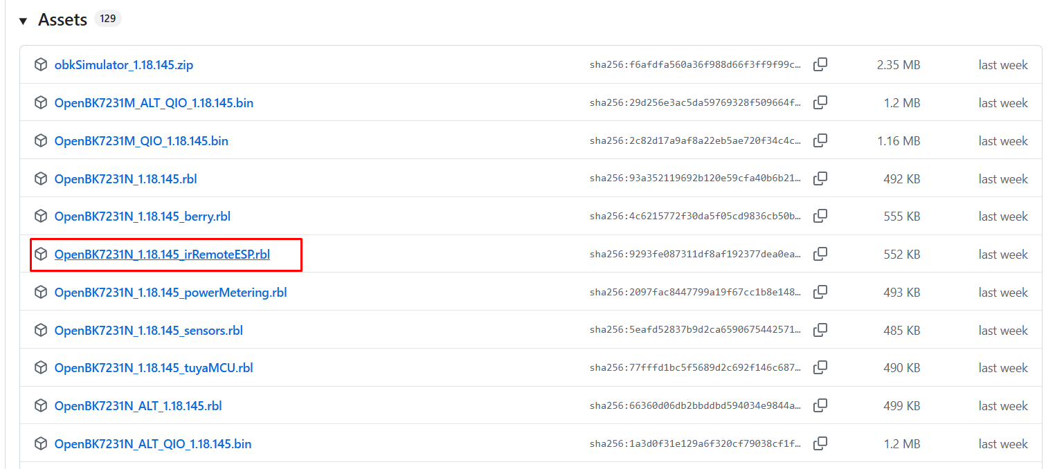

    Posts: 14677
    Help: 656
    Rate: 12700
    vfranchi wrote:
    Has anyone tried to compile and flash this pull request?
    I have a Fujitsu AC that the IR Receiver can't recognize. I'd like to try that out since that's not yet merged.
    This has been merged but now is only available as a variant, here, on releases page:
    File list from OpenBK7231N 1.18.145 release with irRemoteESP.rbl file highlighted in red

Sony commands send only the start bit—fix?
Update to ≥ v1.17.566. Firmware now auto-fills missing bit length; override with “Sony-ADDR-CMD-REP-NUMBITS” if needed [Elektroda, pkaczmarek2, post #20883323]
