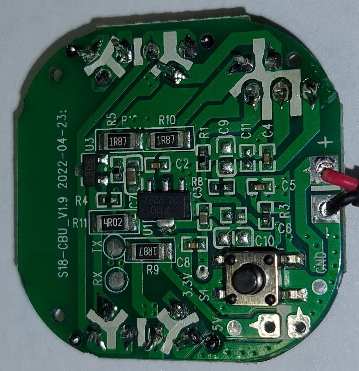

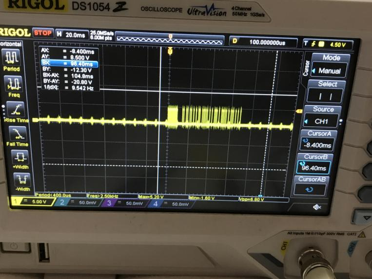

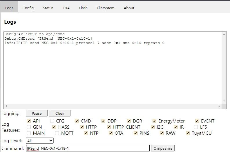

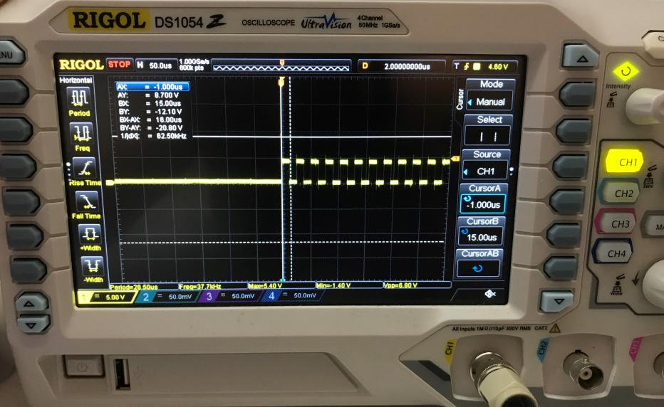

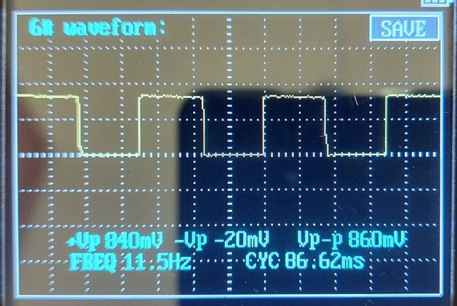

    A small test of the output of P26, IROur, BK7231T was carried out.
    In relay mode, the output is 0.
    In relay mode, the inversion is output 1, about 0.8 volts on the transistor bases.
    IRSend mode - output 0, does not respond to commands in any way, everything is OK in the logs.
    When rebooting, the output is a meander with a frequency of 11.5 hertz.
    There is no reaction to the commands at the exit.
    BK7231N - Universal IR Remote Contorl

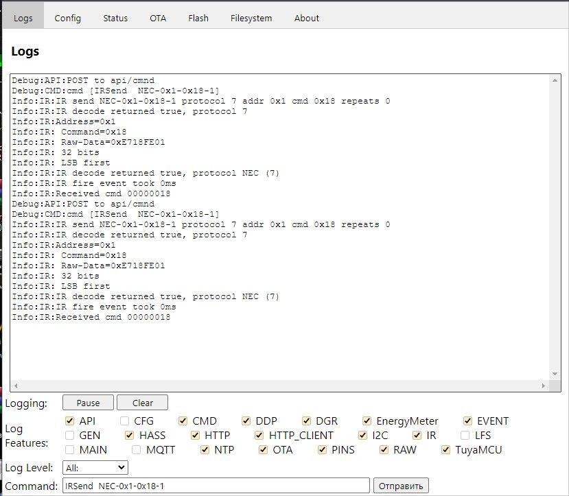

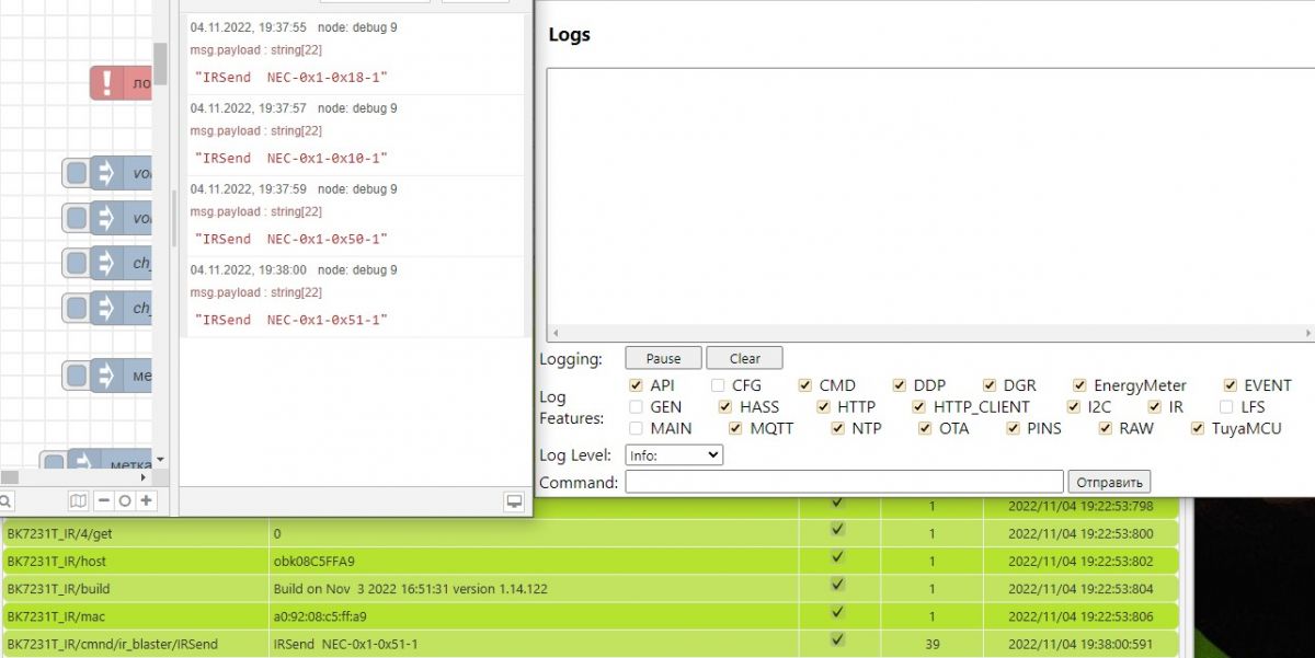

    Debug:CMD:loglevel set 6
    Debug:API:POST to api/cmnd
    Debug:CMD:cmd [IRSend  NEC-0x1-0x18-1]
    Info:IR:IR send NEC-0x1-0x18-1 protocol 7 addr 0x1 cmd 0x18 repeats 0

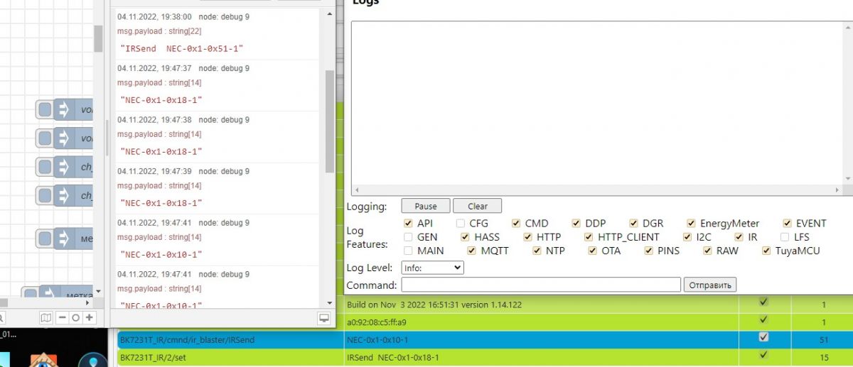

    Debug:CMD:cmd [IRSend NEC-0x1-0x18-0x7]
    Info:IR:IR send NEC-0x1-0x18-0x7 protocol 7 addr 0x1 cmd 0x18 repeats 0
    Debug:CMD:cmd [IRSend NEC-0x1-0x18-a]
    Info:IR:IR send NEC-0x1-0x18-a protocol 7 addr 0x1 cmd 0x18 repeats 0
    Debug:CMD:cmd [startDriver IR]
    Info:IR:Log from extern C CPP
    Info:IR:DRV_IR_Init: recv pin -1
    Error:CMD:command with name IRSend already exists!
    Debug:CMD:cmd [IRSend NEC-1-18-1]
    Info:IR:IR send NEC-1-18-1 protocol 7 addr 0x1 cmd 0x18 repeats 0
    There is no difference between the teams.
    The output is still a meander of 11.6 hertz.

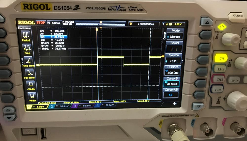

    I just checked mine (whilst checking NEC-0x0-0x1a-0x1) and it pulses nicely.
    I'm not on the exact same device, min is T LED strip, IRSend drive red leds, so can't confirm IR is perfect, but flashes look good.
    P.S. just pur a PR in so you can send like [IRsend NEC-0-1a] ,[IRsend NEC-0-1a-2], [IRsend NEC 0 1a], [IRsend NEC 0 1a 3],
    and implemented repeats (currently no repeats on .123 firmware.
    Are you sure you have the right pin?
    11 hz is odd... not even 38khz carrier from PWM.
    You rebooted after config?

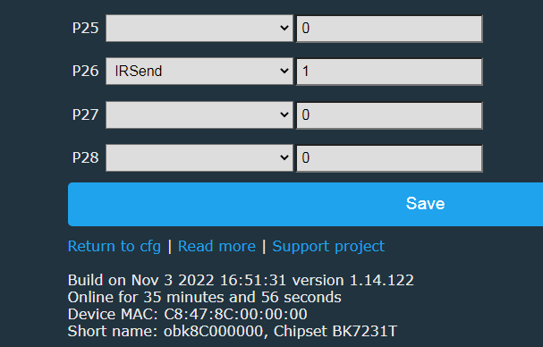

    Any pin, if assigned as IRSend, outputs a meander after reboot.
    What channel number should be assigned to the IRSend output?
  • #36 20267343
    Posts: 14676
    Help: 656
    Rate: 12700
    Channel numbers are currently ignored for IR pins. It doesn't matter which channel number you set.

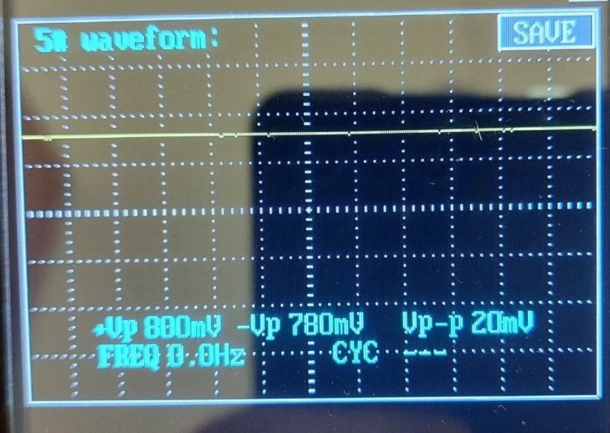

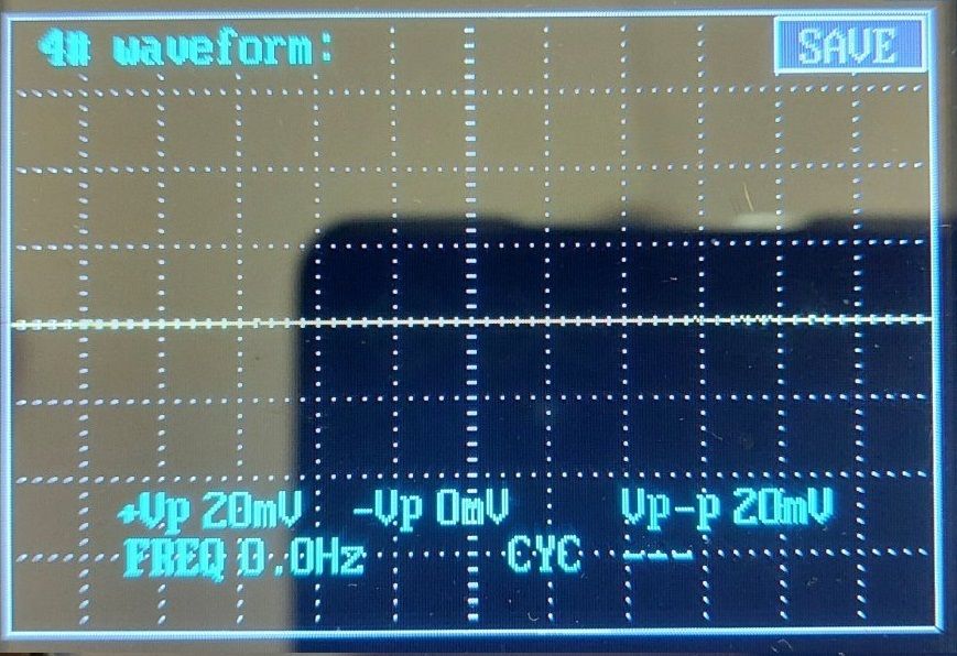

    On this module, the meander is unchanged when the IR transmission is activated.
    I'll try it on another module later.
    This is 100% this output - if I bind the button and designate it as a relay - switches like a relay.

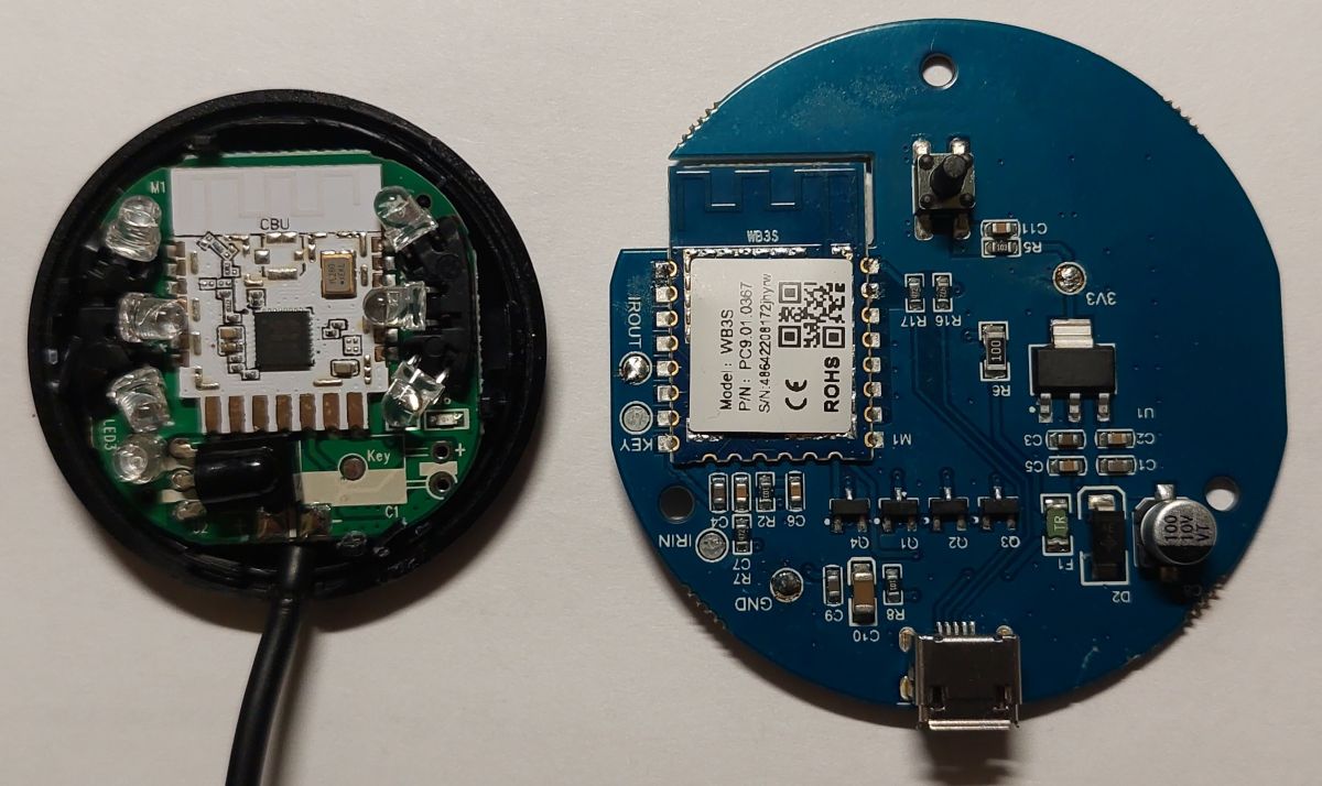

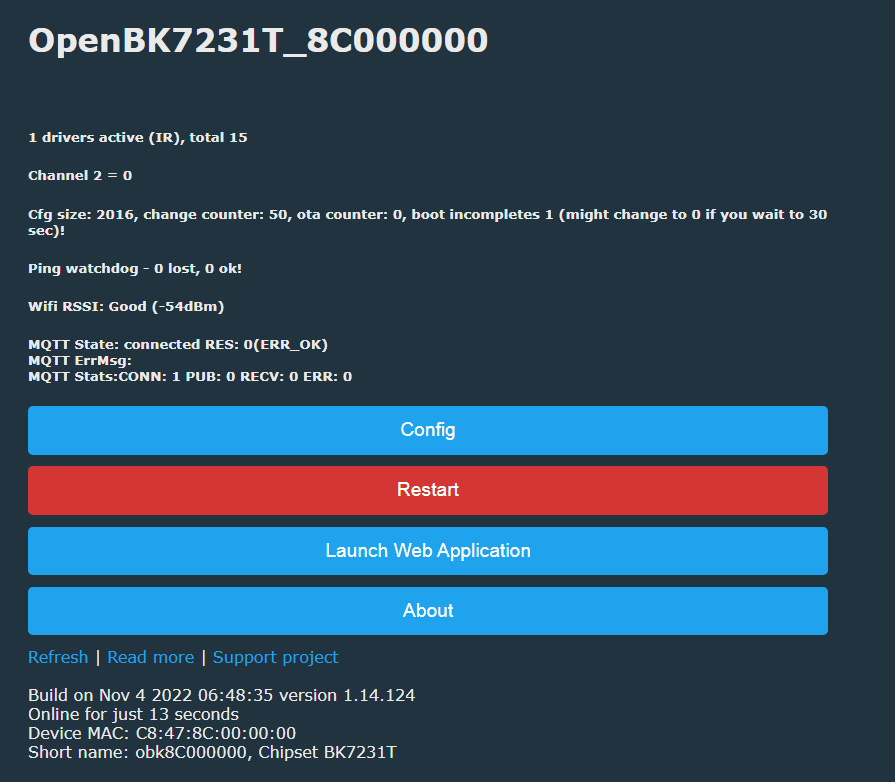

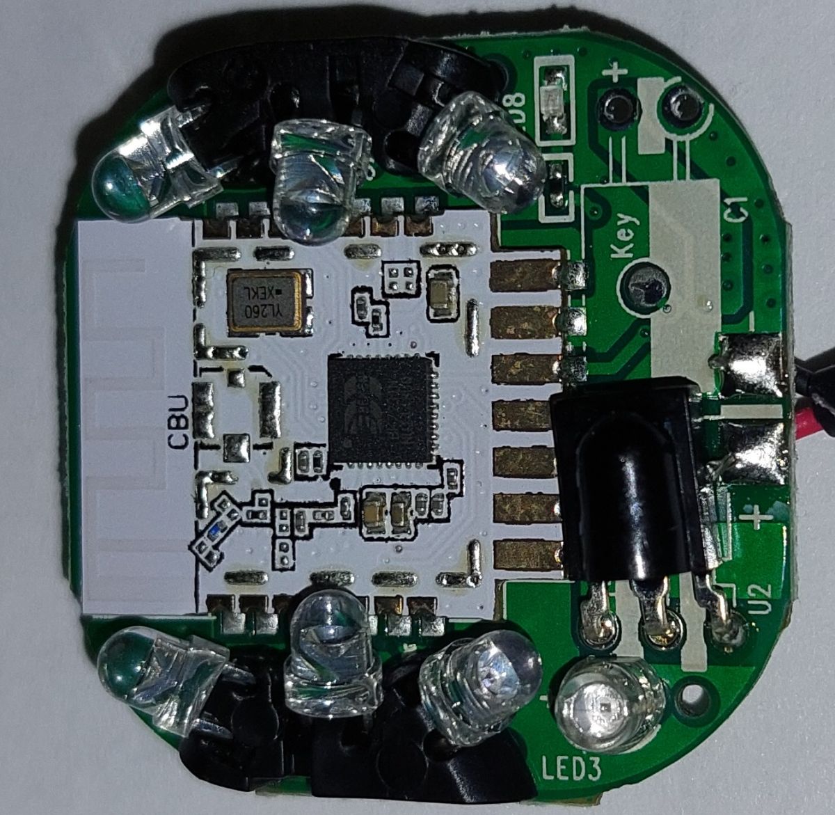

    Hmm... picture of the exact BK chip? And start of bootlog (i.e. log BEFORE our boot, then up to ~10s with IR driver enabled at startup?)
    Maybe there is a version without PWM....
    ohhh... you don't have PWM outputs enabled? If so try without. Surely each PWM pin is linked to an exact PWM channel number - so there cannot be a conflict.
    Does the device have IRRecv - if so does it work? (would prove 20khz timer was running, required for TX.).
    Hmm2... maybe TX does not work unless Rx is enabled!!! Ensure you have an RX pin.... did not think of that, and can't check right now....

    @omelchuk890 I see you have your MAC cleared. Most likely your TLV header is also lost. You can consider going to Web App, Flash tab, and using new "Restore RF Partition" button. It is not tested much but should work. Do only if you have (in worst case) flashing wires handy. But I think it should work.

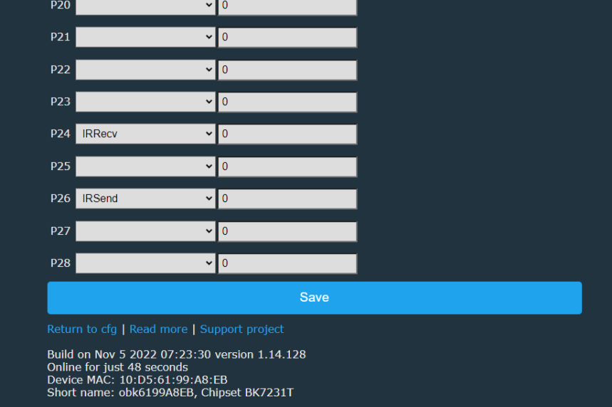

    @btsimonh @p.kaczmarek2
    I had the reception input disabled, it wasn't there at all. The reason is the reception of interference in the form of the RC5 protocol.
    After the appointment of Irrecv, everything worked.
    How can I disable the RC5 protocol reception?
    Look at my posts in this topic - everything is shown there.

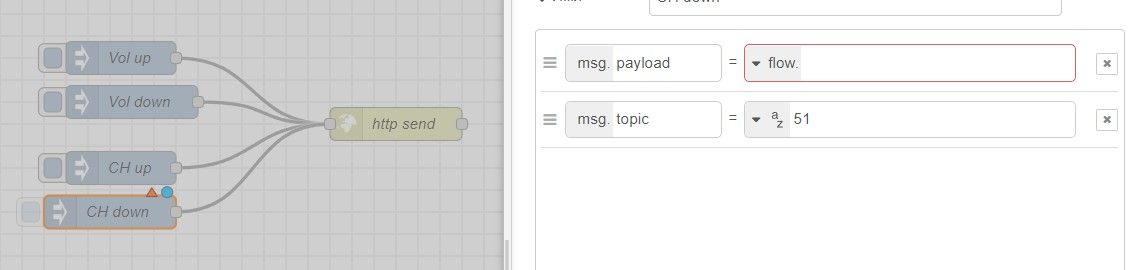

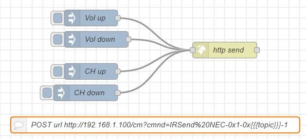

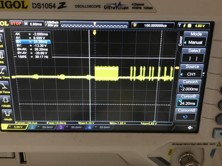

    instead of the real input on which the IR receiver has installed the LED, it is pulled up to the power supply. in this case, there is no "echo" from the transmitter.
    the transfer works only from the command line, there is no way through mqtt, I tried the topic from post 27 - cmnd/ir_blaster/IRSend
    NEC protocol
    is there no way to send commands via MQTT? - that is something we should resolve....
    cmnd/ir_blaster/IRSend = no way, surely not impemented!!!
    using a false pin is an interim solution. One question is, why are you getting IR on real input?

    If I connect a receiver located directly on the board, it works, but there is a lot of false data with the RC5 code.
    I don't have an rc5 remote control at all.
    When sending from the command line with the receiver turned on, I get an "echo"

    yes, you will get echo. it does not currently disable RX during TX.....
    I have PR in to allow TX with RX not configured.... solves original issue...

    Although it is important for me personally to read the remote control codes once, and then send them through node-red, so then I'll just choose the input for the receiver that is not used.
  • #51 20268207
    btsimonh
    Posts: 66
    Rate: 14
    does TX work for you with your device?
  • #52 20268212
    omelchuk890
    Posts: 70
    Rate: 10
    Yes, only command line.
    how to do multiple repetitions of a command by changing the last argument does not help

    I will definitely conduct tests, but on Monday - my wife demands to arrange a shopping trip for her. who invented husbands to go shopping with their wives?
    I still have one - I found it in a box for experiments today. I still have one - I found it in a box for experiments today. The size compared to the current module is significantly smaller.
  • #55 20269074
    Posts: 14676
    Help: 656
    Rate: 12700
    @omelchuk890 if you have a new device, please submit a separate teardown and include the photos of casing, box and screenshots from the site where you bought it, also a pinout data, if possible. Which pin is IR input, etc, etc.
    @btsimonh here are scope measurements from the latest release build with IR Send:
    BK7231N - Universal IR Remote Contorl BK7231N - Universal IR Remote Contorl BK7231N - Universal IR Remote Contorl BK7231N - Universal IR Remote Contorl BK7231N - Universal IR Remote Contorl BK7231N - Universal IR Remote Contorl

    Can you tell me if there is currently a way to send a command to the module to send an IR command from node-red? Maybe via http post or something else while mqtt is not working.
    Otherwise, for now it's just a trinket...
  • #57 20270850
    Posts: 14676
    Help: 656
    Rate: 12700
    Have you checked HTTP interface?
    http://192.168.0.100/cm?cmnd=led_enableAll%201
  • #58 20270945
    omelchuk890
    Posts: 70
    Rate: 10
    @p.kaczmarek2
    Sorry, I'm not an expert in web and http.
    It works from the browser bar!
    I will figure out how to send from Node-Red.
    http://192.168.21.100/cm?cmnd=IRSend NEC-0x1-0x10-1
  • #59 20271001
    Posts: 14676
    Help: 656
    Rate: 12700
    That strange %20 is a special way of writing a space character for HTML links. In our App, those characters are processed by urldecode2_safe function.
  • #60 20271156
    omelchuk890
    Posts: 70
    Rate: 10
    Everything worked out - there was a problem with the network, with routes. Raspberry and the module are in different networks, then I'll figure it out, moved it to connected networks - everything is fine.
