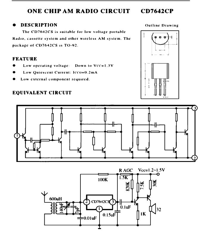

  • CD7642CP single-chip AM receiver in TO-92 package
    #40 20943244
    TechEkspert
    Editor
    Posts: 7318
    Help: 17
    Rate: 5690
    Today I came across a Chinese integrated circuit CD7642CP and I remembered this matchbox AM radio project. Here in the project we have an AM radio without an integrated circuit, while the CD7642CP is a Shaoxing Silicore Technology chip, it is a single-chip AM receiver.
    You may say that it is nothing extraordinary, but the manufacturer insisted and enclosed its system in a housing TO-92!
    You can make a mistake and think that it is, for example, a transistor :)
    Schematic of the CD7642CP AM radio integrated circuit.
