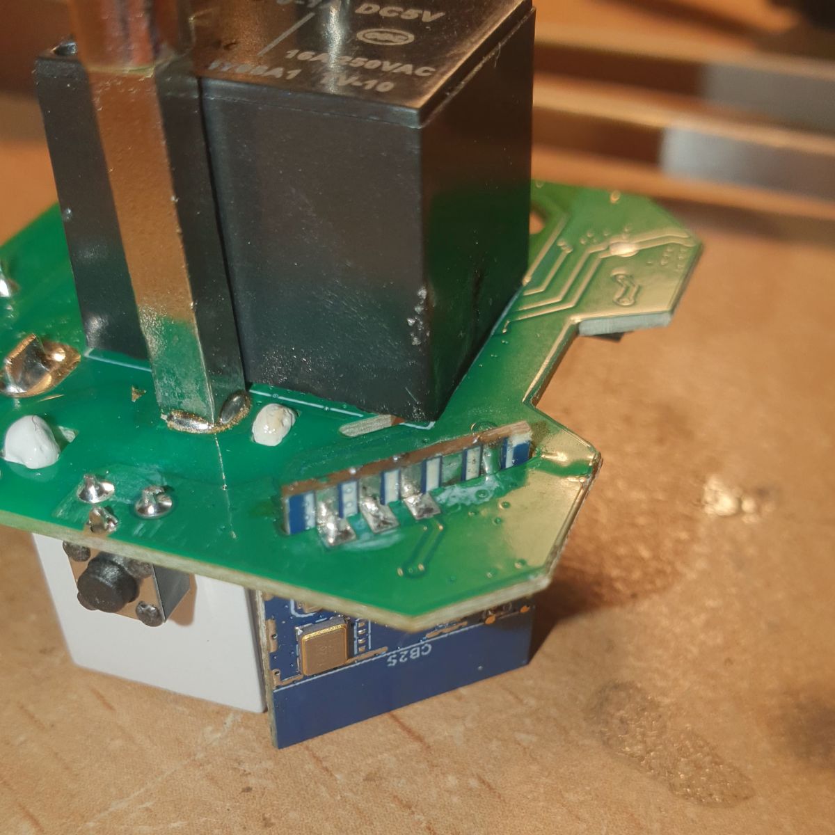

    I had the same issue, check your soldering of CB2S. Then it's back to normal Close-up of a circuit board with an attached relay and soldering on CB2S contacts.

    Is this a factory solder joint on the photo?

    No, bad soldering after putting CB2S back after programming. Voltage, amp values were ValA, ValV. Fixed by resoldering.
