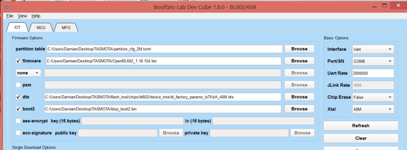

    did you backup original firmware before flashing?
    that 'single download option' should not be used with the release binary, it is for flashing back full bootable flash files/backups.
    If you can get Easy Flasher running in your OS (Mono?) then you can do the whole lot within Easy Flasher https://github.com/divadiow/BK7231GUIFlashTool

    with BL602 we don't use lab dev cube software ?
    i've try to flash bulb with easyguiflashtool but i've always problem to enter flash mode
    (i've allready flash lsc action plug whitout problem...)
    Added after 4 [minutes]:
    i've try with https://openshwprojects.github.io/EasyGUIFlashTool/
    and that's the logs "Unsupported operation: _newZLibInflateFilter" :

    ok, i've installed mono on ubuntu 20.04
    and now the result ...
    the boot pin is high, what more can I do?

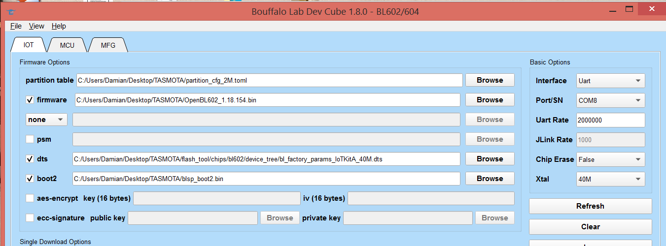

    what baud? tried others?

    Many many thanks !
    with your screenshot i've sucessfully flashed sonoff B05-BL-A19 bulb with DevCube
    now all is working fine...
    have a good day !

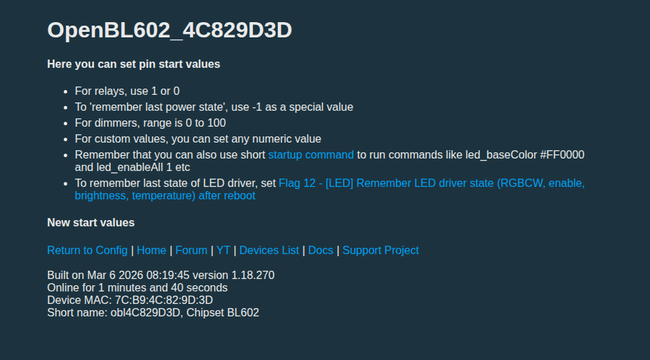

    ok, again one thing to resolve...
    color are not OK, when i choose green on web i've blue on bulb, and all others colors are mixed...
    thank again

    I think you'd benefit a lot from reading the full topic and guide. Look, I think this hint may help with swapped colors order:
    https://github.com/openshwprojects/OpenBK7231T_App/blob/main/docs/commands.md LED_Map command

    >>21857957 it's OK now,
    i've use this command BP5758D_Map 2 1 0 3 4
    last thing i've checked flag 12 but light don't keep brightness or color when reboot
    regards
    Added after 45 [minutes]:
    it's strange in startup menu i've no possibility to change values...
    Screenshot of OpenBeken “OpenBL602_4C829D3D” page listing pin start values and a note about Flag 12.
