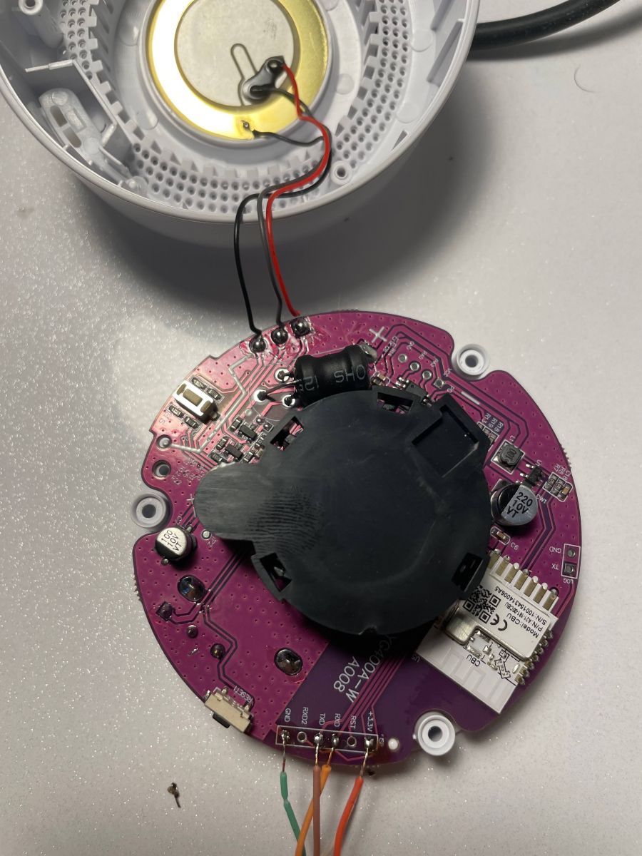

    I believe I am not a noob just a newbie on OpenBeken but have no any success with flashing the similar device what you did.
    1. connect my usb flasher RX to YG400A-W RX
    2. connect my usb flasher TX to YG400A-W TX
    3. connect my usb flasher GND to YG400A-W GND
    4. run OpenBeken, set up COM port, link is ok
    5. start flashing ask me to GND the CBU'S CEN which is port 18, very next to the led chamber
    6. I ground it to another free GND port for a really short time
    7. flashing program keep counting and counting and nothing happen
    1. I try it with connect my usb flasher 3.3V to YG400A-W 3.3V as it was suggested by vitya but it was written in this topic #82 it is not working and was not working for me too
    Ideas:
    - my usb flasher is wrong, but when I connect it to YG400A-W I see it has communication, when I GND the CEN I see it has another type of communication via the flasher's LEDs and this flasher work as a dream with tasmota
    - my YG400A-W not compatible, it is exactly the same what some other people successfully flashed before, I've checked the wifi and CBU chips
    - the YG400A-W is wrong, but it still has its original firmware and works on my app
    - I must be a noob really after dozens of flashed iot devices...
    May I ask any idea or just forget OpenBeken? In this case can someone offer me a homeassistant compatible smoke sensor which is available on the market right now and not the Nest brand which is so expensive?
    These are wrong: Rx goes to Tx and vice versa.
    Also, it is a good idea to start with connecting the GNDs.

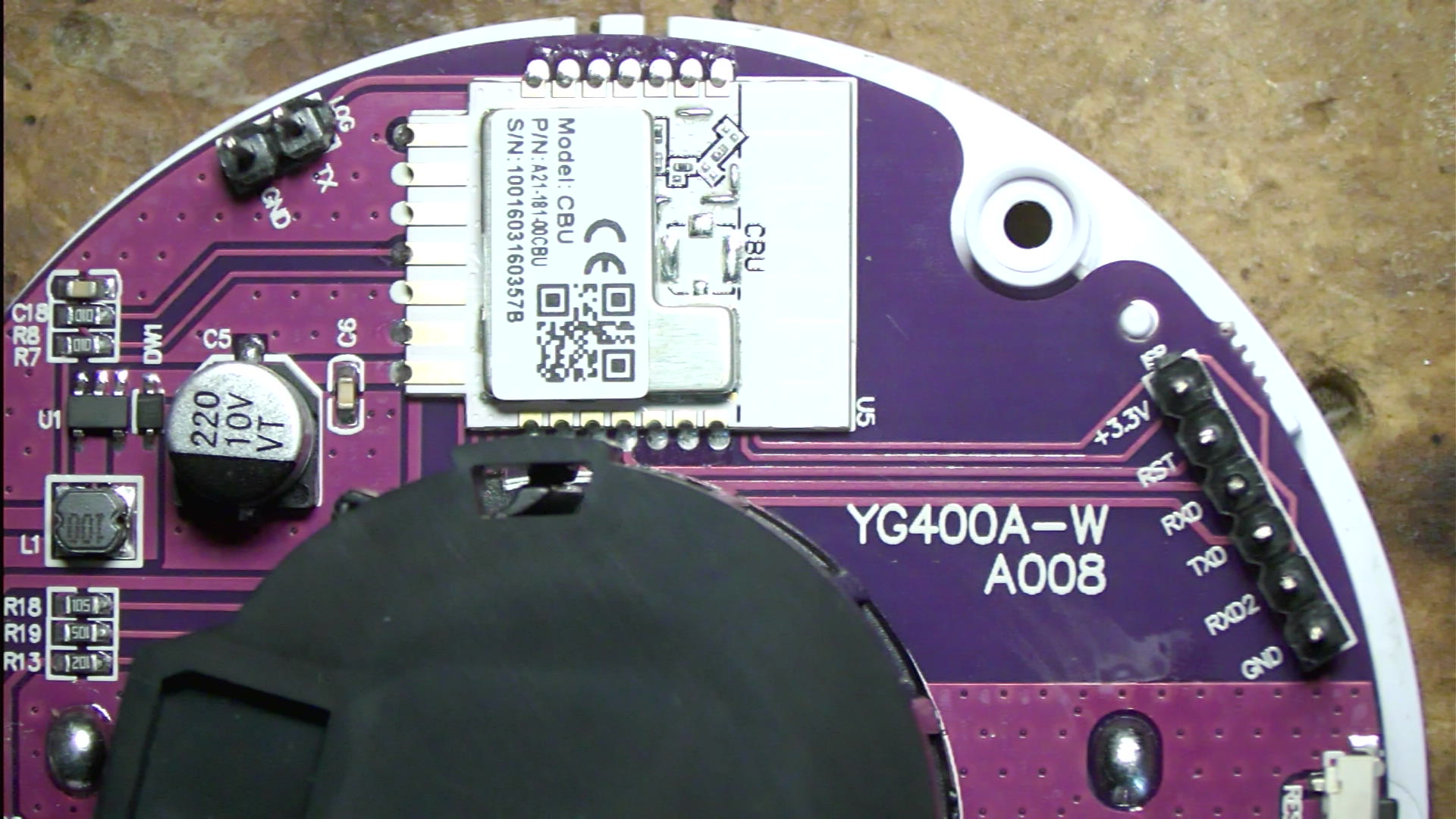

    Is this how your board looks like?
    Circuit board with electronic components on a purple background.
  • #127 21347751
    drkaresz
    Posts: 14
    Exactly the same my friend!
    And I believe (I hope) I found something.
    Under the light chamber, there is a small, deep scratch on the integrated wire of port 18. So I've ordered another one, and give a second run for this stuff.
    I hope next week I'll get good news.
    Anyway, thank you again for your patience and help!

    According to this, pin 18 is the reset line.
    You don't really need it: you can just remove power (3.3V) for a moment AFTER you clicked flash/backup in the flasher utility. Can you try that? Just make sure you don't remove the Rx/Tx lines..
    (and yes, I am Hungarian, too :) )

    To be sure not do any mistake i welded the tx,rx,gnd and try yesterday what you offer with 3.3v. But when i disconnect 3.3v the usb flasher's led keep flashing and nothing else happen.
    Maybe i was who made that scratch when the RST output do not respont my GND short circuit when the program ask me to do. Because this i try to tap the 18th pin directly with a sharp tool. Maybe it happen during the assembly in the factory. Never find out.
    I see it is not a brain surgery so i've ordered an other sensor, i'll see. And as promise write you back when i try it again.

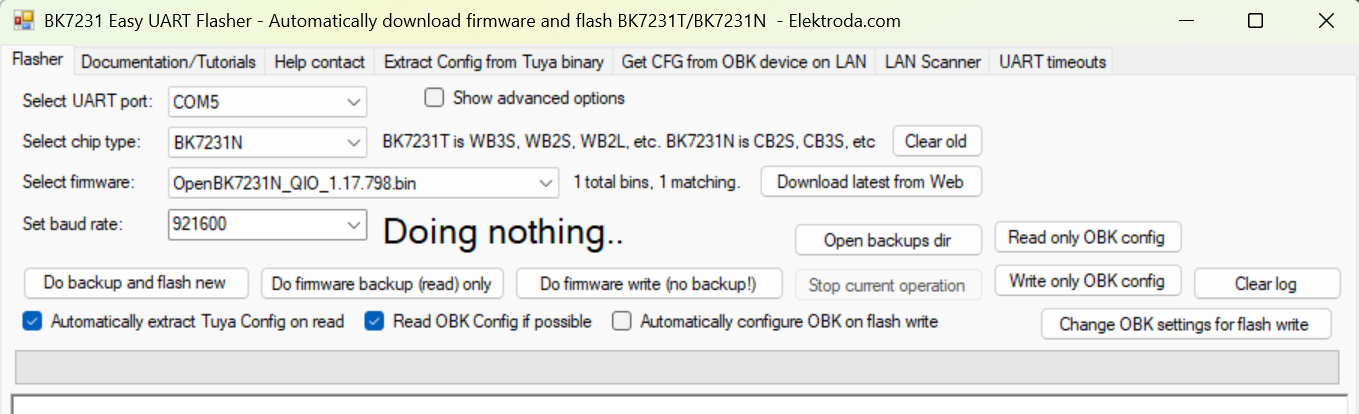

    Yet another idea: What baud did you use? Maybe you could try with a lower setting..
    This is how I did it:
    Screenshot of the BK7231 Easy UART Flasher program used for automatically downloading and flashing firmware.
    If this speed is not working for you, you can try a lower one.

    I was not sure before Christmas I would receive the new sensor, but it has arrived.
    And you were right, it needs the 3.3V. :)
    With this sensor, flashing is as simple as Tasmota, works like a dream. I'm wondering how long it will last with the batteries, I've set up 8 hours wake up.

    I have bought four devices after reading this article. Is there a complete instruction somewhere what to do or what order? I only know tasmota so far.
    The soldering is as easy as it gets.
    Interior of a smoke detector with a visible circuit board.

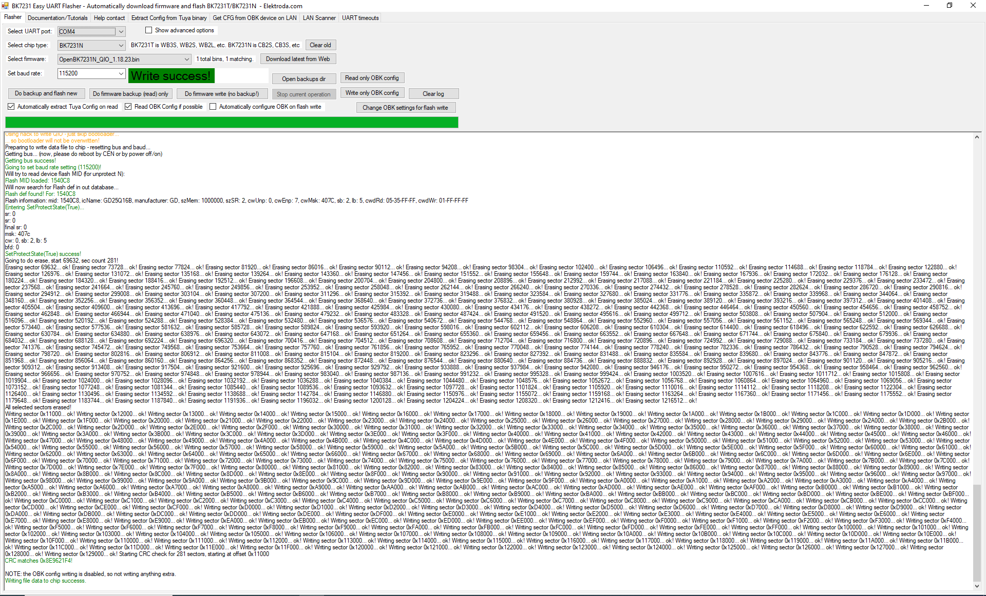

    ok you need install BK7231 EASY UART flasher, Select the N model, click download latest from web and hit flash. Maybe press the reset button on the smoke alert so it will be able to flash.
    I used the current build to this date Built on Jan 23 2025 22:12:58 version 1.18.24
    BK7231 Easy UART Flasher console showing write success.
    After the flash I have to disconnect the power and reconnect and wait for openbeken wifi AP to appear, connect to 192.168.4.1 in your browser.
    If no wifi shows, 5x reconnect power to reset the device and you should see the wifi eventually.
    After entering the PIN information and the autoexe.bat it seems to work as long as it get 3.3V from the UART flasher.

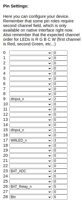

      "pins": {
        "9": "dInput_n;2",
        "15": "dInput_n;1",
        "17": "WifiLED_n;3",
        "23": "BAT_ADC;4",
        "26": "BAT_Relay_n;5",
        "28": "Btn;6"
      "command": "",
    Screenshot of device pin settings interface.

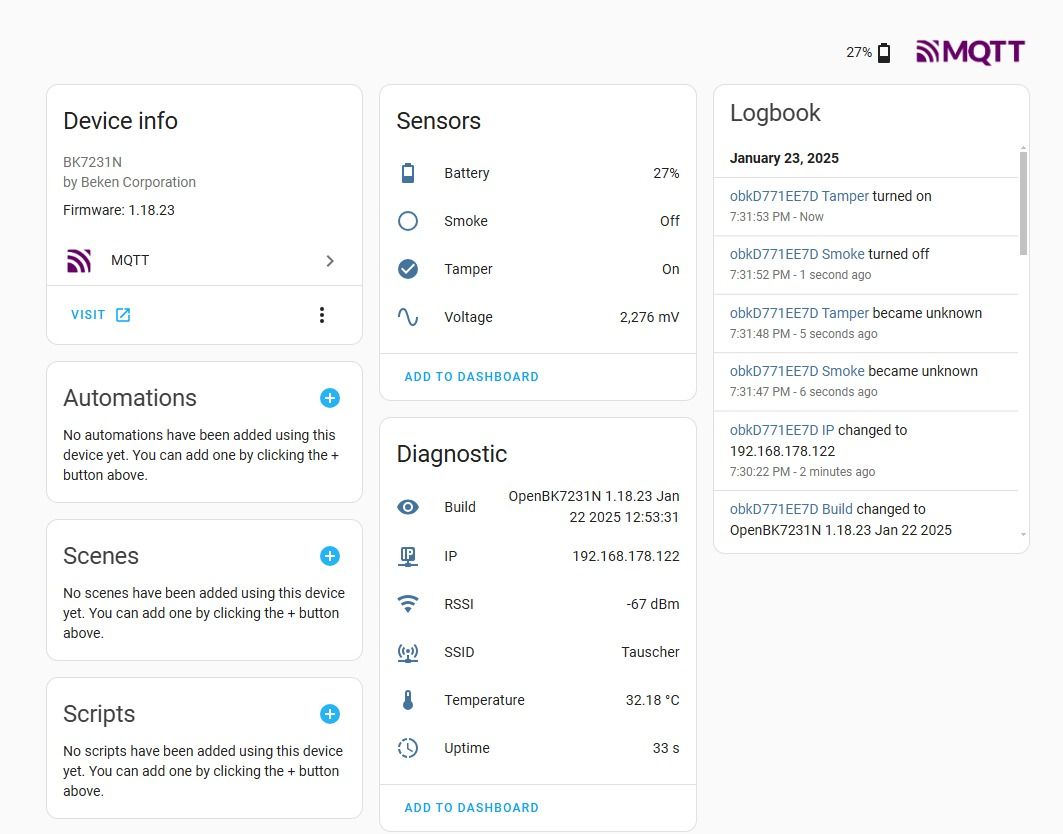

    Restart the device, enter mqtt information of home assistant and start the homeassistant discovery from openbeken config menu. Then you should see the sensor as mqtt device in homeassistant.
    User interface for BK7231N sensor with device information and logbook.
    With this everything works nice. Thank you everybody. I really like the tamper feature so I can see if the tenants removed the smoke detectors.
    However, the tamper pin will not wake up the device from deep sleep.

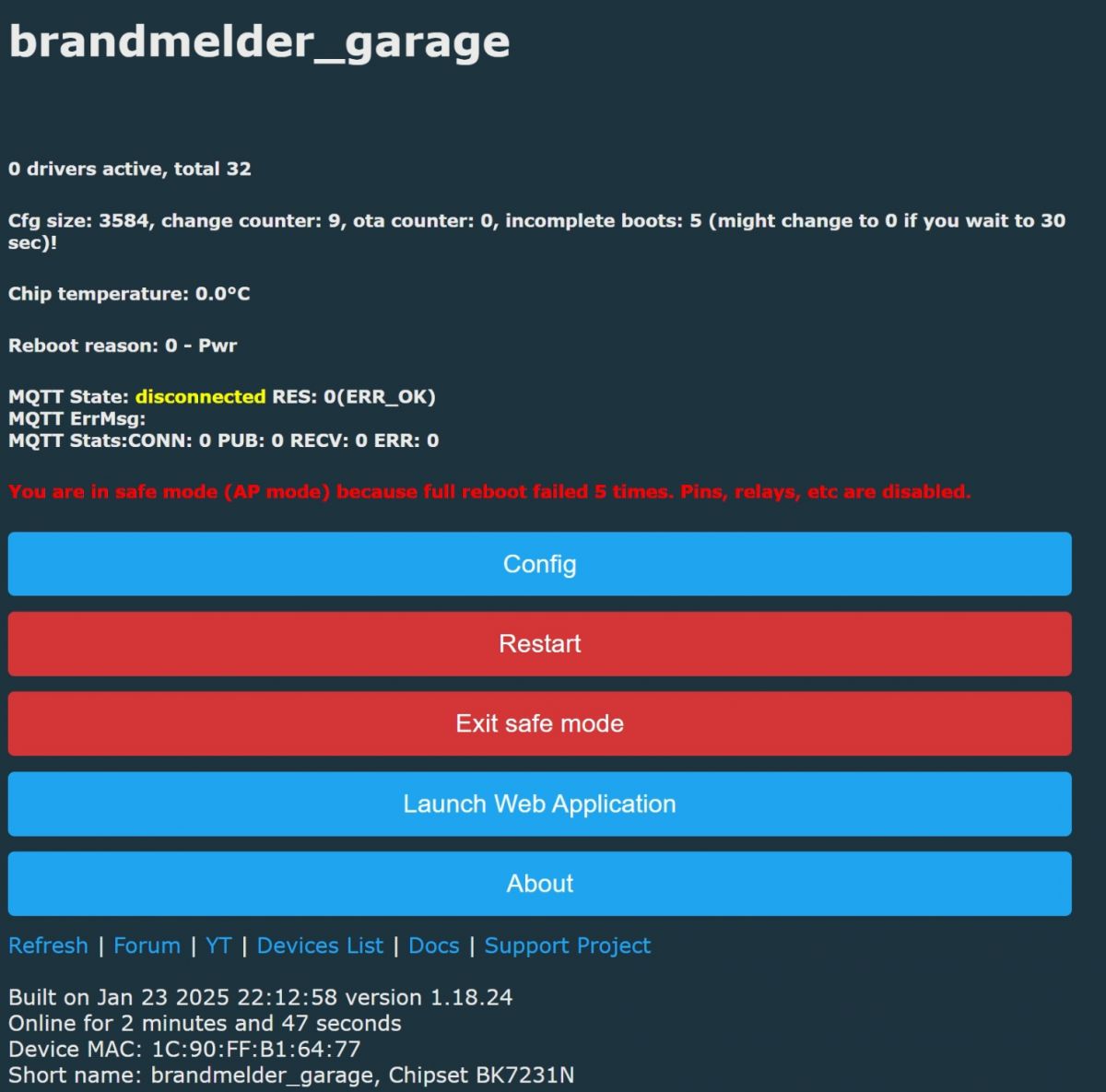

    I did it the same way as @dominictauscher.
    I can configure wifi but the device simply refuses to connect to the WLAN. Of course I tried many different WiFi's, with short keys and keys without special characters. I also tried different wifi encryptions - no luck.
    After a while it starts in save mode and broadcasts its own wifi again:
    Screenshot of the brandmelder_garage device interface in safe mode.
    Any idea on how I could debug the startup? Is there maybe a way to log via uart ?

  • #142 21409036
    sithyoda
    Posts: 37
    I am a professional network tech, so trust me, the wifi setup(s) are ok. I even tried an open wifi (no encryption at all), but the device does not want to connect.
    When it is in AP mode for initial configuration, it can even see wifi's after a scan. So I expect that the wifi chip is definitely OK.
    I simply need to find a way to get the bootlogs, I expect that it would reveal the problem.
  • #143 21409040
    dominictauscher
    >>21409036
    Maybe try to flash a different version,
    Something sounds wrong
  • #144 21409044
    sithyoda
    Posts: 37
    dominictauscher wrote:
    >>21409036
    Had version 1.17.772 on the board before, but I upgraded because of this problem.
  • #145 21409118
    dominictauscher
    Then I would just buy another one, I flashed four successfully and I’m not a network pro
  • #146 21411898
    Posts: 14621
    Help: 655
    Rate: 12636
    Maybe check UART 2 (TX2) log at 115200? Or maybe try to change one character in MAC, maybe you have MAC collision?
  • #147 21411903
    sithyoda
    Posts: 37
    @p.kaczmarek2 Thx! This was the hint I needed. Will have a look asap.
  • #148 21413001
    sithyoda
    Posts: 37
    Ok, it's not the MAC address, I've changed it with no difference.
    The bootlog ends with a deep sleep, even I installed a complete new config with flash tool. So in fact there should not be any startup nor autoexec.bat. Dunno why it falls into sleep before connecting to wifi.
    Attached bootlog
    • YG400bootFail.txt (2.56 KB) You must be logged in to download this attachment.
  • #149 21415281
    sithyoda
    Posts: 37
    @p.kaczmarek2 Any hint, what could cause the deep_sleep?
  • #150 21420610
    Posts: 14621
    Help: 655
    Rate: 12636
    There are 3 options:
    a) autoexec.bat
    b) short startup command
    c) you have DoorSensor pin defined
