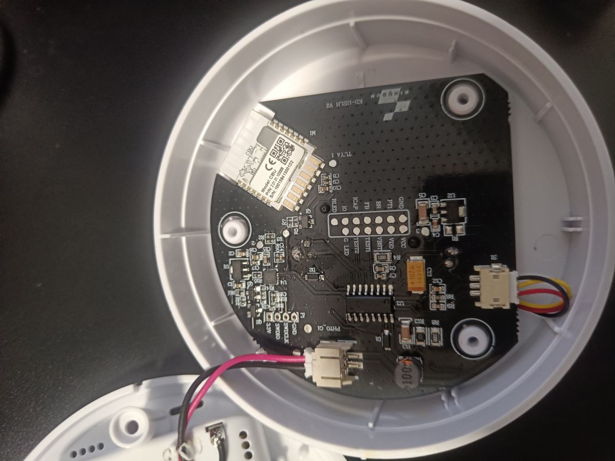

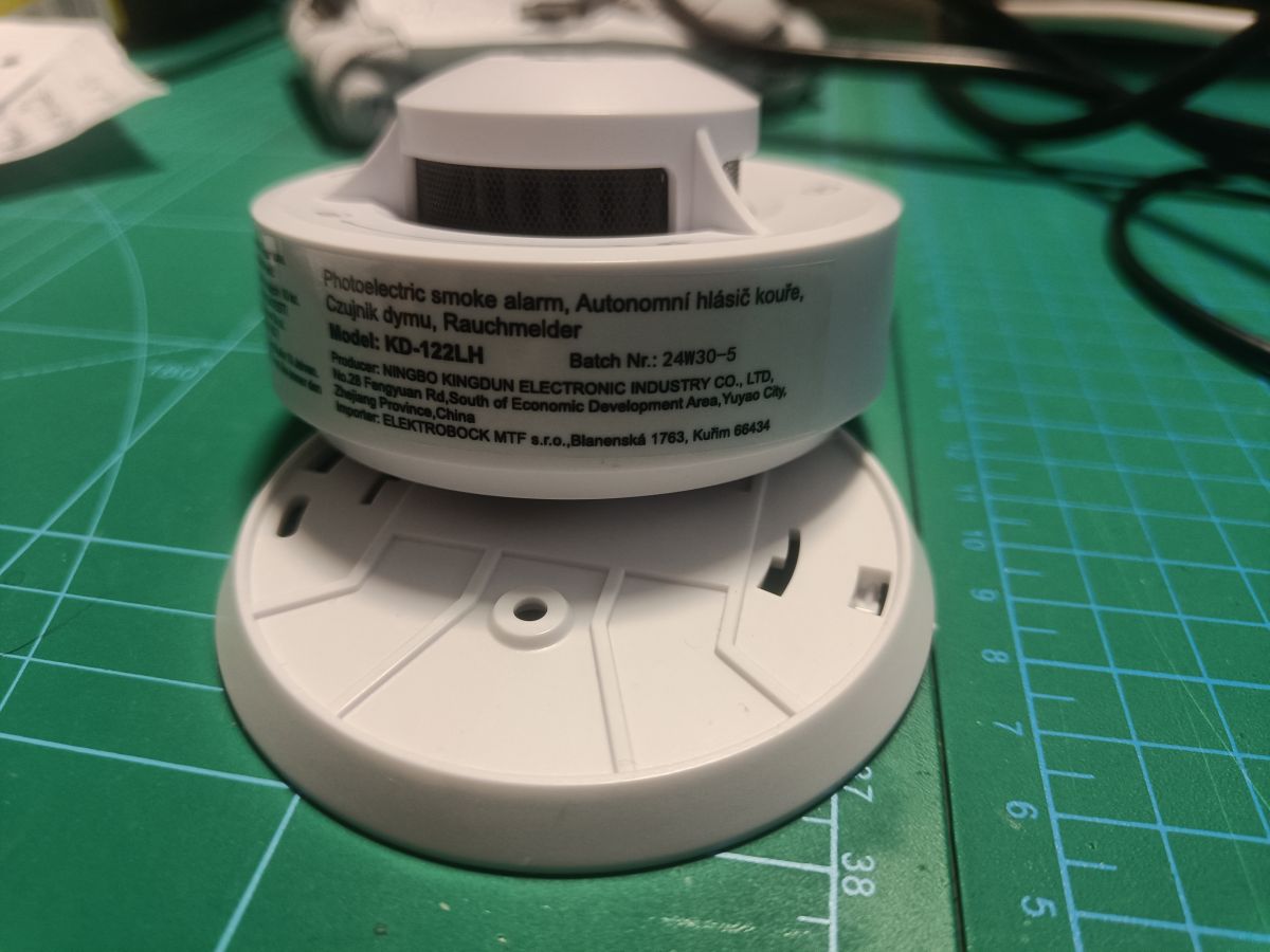

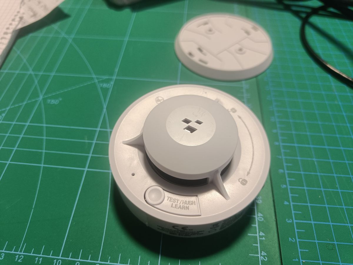

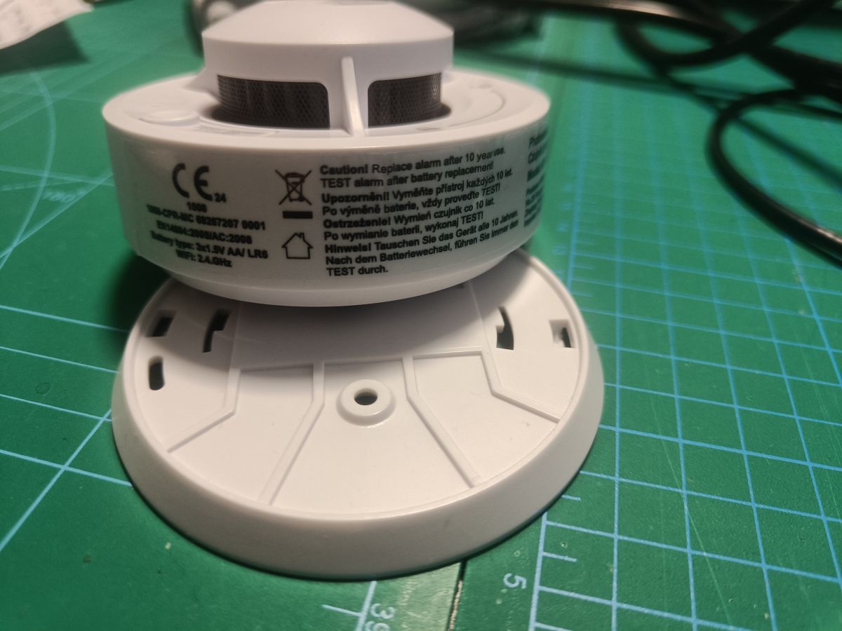

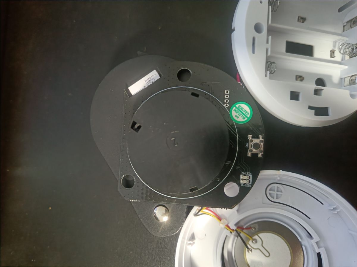

    mishak
    I bought a new kind of similar Tuya Smoke Detector (Wi-Fi)
    PCB is marked v2
    I tried all possible tuya-cloudcutter OTA devices and nothing worked.
    So the only thing left is flashing over wire.
    Which pins are UART TX and RX?
    Smoke detector with visible manufacturer label and model KD-122LH.

  • #154 21449209
    Posts: 14621
    Help: 655
    Rate: 12636

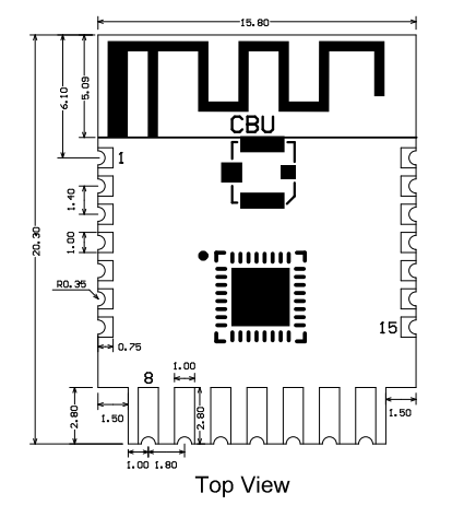

    Here's Tuya CBU module pinout:
    Top view of Tuya CBU module with pin layout.
    Pin numberSymbolI/O typeFunction
    1P14I/OCommon GPIO, which can be reused as SPI_SCK (Correspond to Pin 11 of the IC)
    2P16I/OCommon GPIO, which can be reused as SPI_MOSI (Correspond to Pin 12 of the IC)
    3P20I/OCommon GPIO (Correspond to Pin 20 of the IC)
    4P22I/OCommon GPIO (Correspond to Pin 18 of the IC)
    5ADCI/OADC, which corresponds to P23 on the internal IC (Correspond to Pin 17 of the IC)
    6RX2I/OUART_RX2, which corresponds to P1 on the internal IC. (Correspond to Pin 28 of the IC)
    7TX2I/OUART_TX2, which is used for outputting logs and corresponds to P0 of the internal IC (Correspond to Pin 29 of the IC)
    8P8I/OSupport hardware PWM (Correspond to Pin 24 of the IC)
    9P7I/OSupport hardware PWM (Correspond to Pin 23 of the IC)
    10P6I/OSupport hardware PWM (Correspond to Pin 22 of the IC)
    11P26I/OSupport hardware PWM (Correspond to Pin 15 of the IC)
    12P24I/OSupport hardware PWM (Correspond to Pin 16 of the IC)
    13GNDPPower supply reference ground
    143V3PPower supply 3V3
    15TX1I/OUART_TX1, which is used for transmitting user data and corresponds to Pin 27 of the IC. For the MCU solution, please refer to CBx Module.
    16RX1I/OUART_RX1, which is used for receiving user data and corresponds to Pin 26 of the IC. For the MCU solution, please refer to CBx Module.
    17P28I/OCommon GPIO (Correspond to Pin 10 of the IC)
    18CENI/OReset pin, low active (internally pulled high), compatible with other modules (Correspond to Pin 21 of the IC)
    19P9I/OCommon GPIO (Correspond to Pin 25 of the IC)
    20P17I/OCommon GPIO, which can be reused as SPI_MISO (Correspond to Pin 14 of the IC)
    21P15I/OCommon GPIO, which can be reused as SPI_CS (Correspond to Pin 13 of the IC)
    Test pointCSNI/OMode selection pin. If it is connected to the ground before being powered on, enter the firmware test mode. If it is not connected or connected to VCC before being powered on, enter the firmware application mode. Correspond to Pin 19 on the internal IC.
    You just need 3.3V, GND, UART_TX1 and UART_RX1.
    See flasher page:
    See our guides:
    https://www.youtube.com/@elektrodacom[/table]

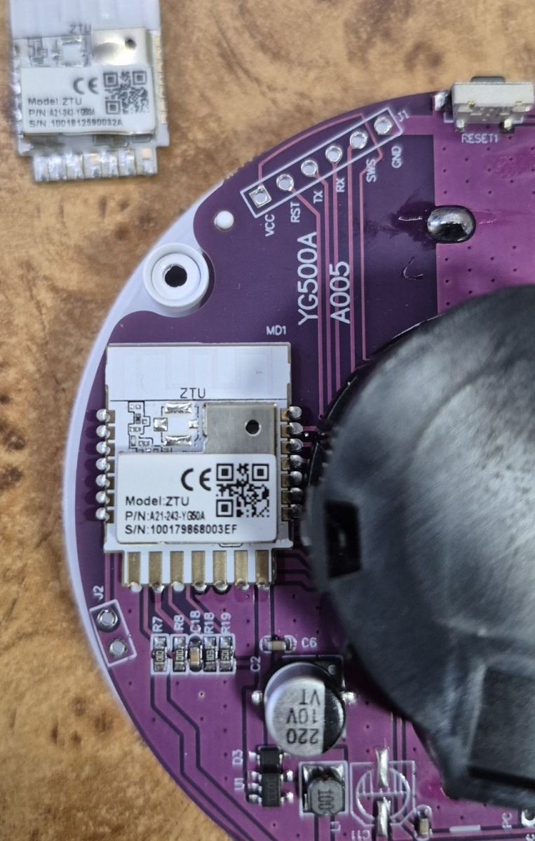

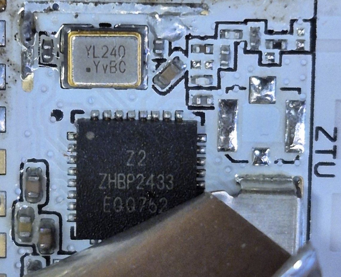

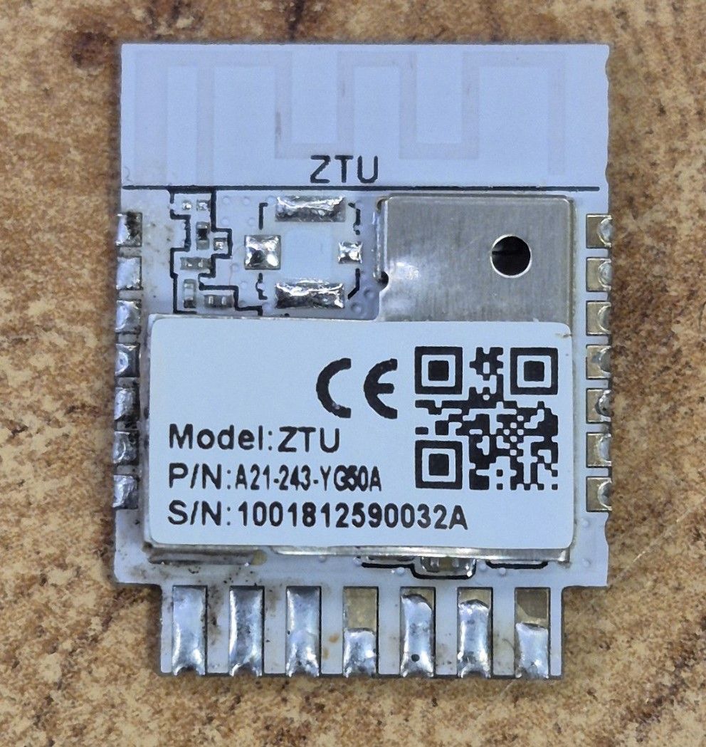

    Close-up of a purple printed circuit board with a mounted ZTU electronic module and visible technical markings.
    Close-up of a printed circuit board with an integrated circuit and other electronic components.
    ZTU electronic module with QR code and technical markings on a white label.
    Привет. Купил такой датчик, на ДИМ срабатывает, вайфай не видит. Может кто подскажет, что это за вайфай чип и как его прошить
  • #161 21540846
    insmod
    Posts: 1397
    Help: 164
    Rate: 436
    >>21540807
    ZTU is a Zigbee module, it contains TLSR825x chip.
    You either need a zigbee gateway or a pin compatible module to replace it.
    Personally i wouldn't bother to replace it, just buy a zigbee gateway if you don't already own one.
    And zigbee is much better for battery-powered devices, with 3xAAA it can live up to several years.

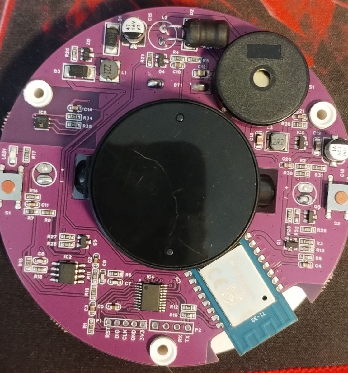

    mrdart

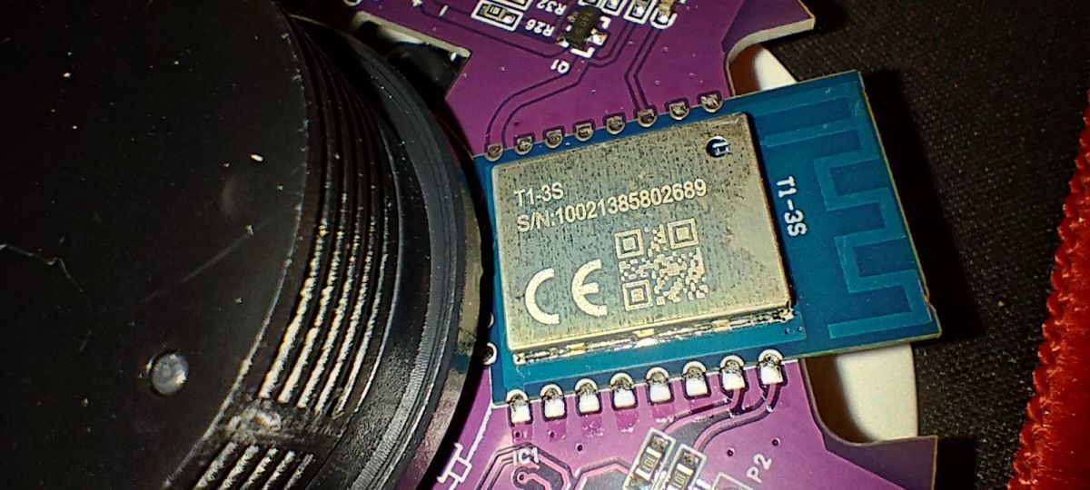

    Seems here is a new board from Tuya with T1-3S.
    Can it be flashed and work correctly?
    May be someone already tried it?
    Round purple PCB with SMD parts, a black buzzer/speaker, and a microSD socket with a blue card
    Close-up of a PCB with a TI-3S wireless module and a black threaded component on the left
  • #167 21923423
    groove6j
    Posts: 52
    Rate: 13
    >>21819552
    DSF4ever wrote:
    no longer equipped with the MCU 7231N, but with the MCU 7238 (T1-U-HL)
    For T1-U-HL model with BK7238 everything can be found easily in original firmware.
    Working battery config: Battery_Setup 2000 3100 3 2400 4096
    Pin config:
    6-BAT_Relay_n
    15-dinput_n
    17-WifiLED_n
    20-BAT_ADC
    21-dInput_NoPullUp
    28-Btn
    mrdart wrote:
    Seems here is a new board from Tuya with T1-3S.Can it be flashed and work correctly?May be someone already tried it?
    I haven't ordered these devices recently and haven't stumbled upon T1-3S. Dump original firmware, open with hex editor and search for this part, usually around 0x0EEF00:
    "...status_led_pin:17,basic_pin_pin‘ć:15,tamper_pin_pin:21,module:T1..."

What wiring is needed to flash the CBU module?
Connect 3 V3, GND, TX1→USB-RX, RX1→USB-TX. Pull CEN (pin 18) to GND while clicking “Flash” in BK7231 GUI Flash Tool, then release [Elektroda, vitya123, post #21347758]

ZTU (TLSR825x) Zigbee board—flashable with OpenBeken?
No. ZTU uses a Telink TLSR825x SoC; replace the module or use a Zigbee coordinator instead [Elektroda, insmod, post #21540846]
