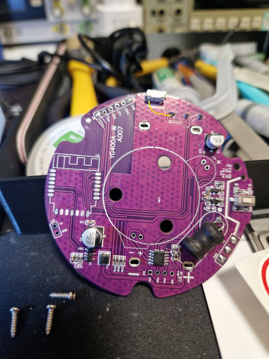

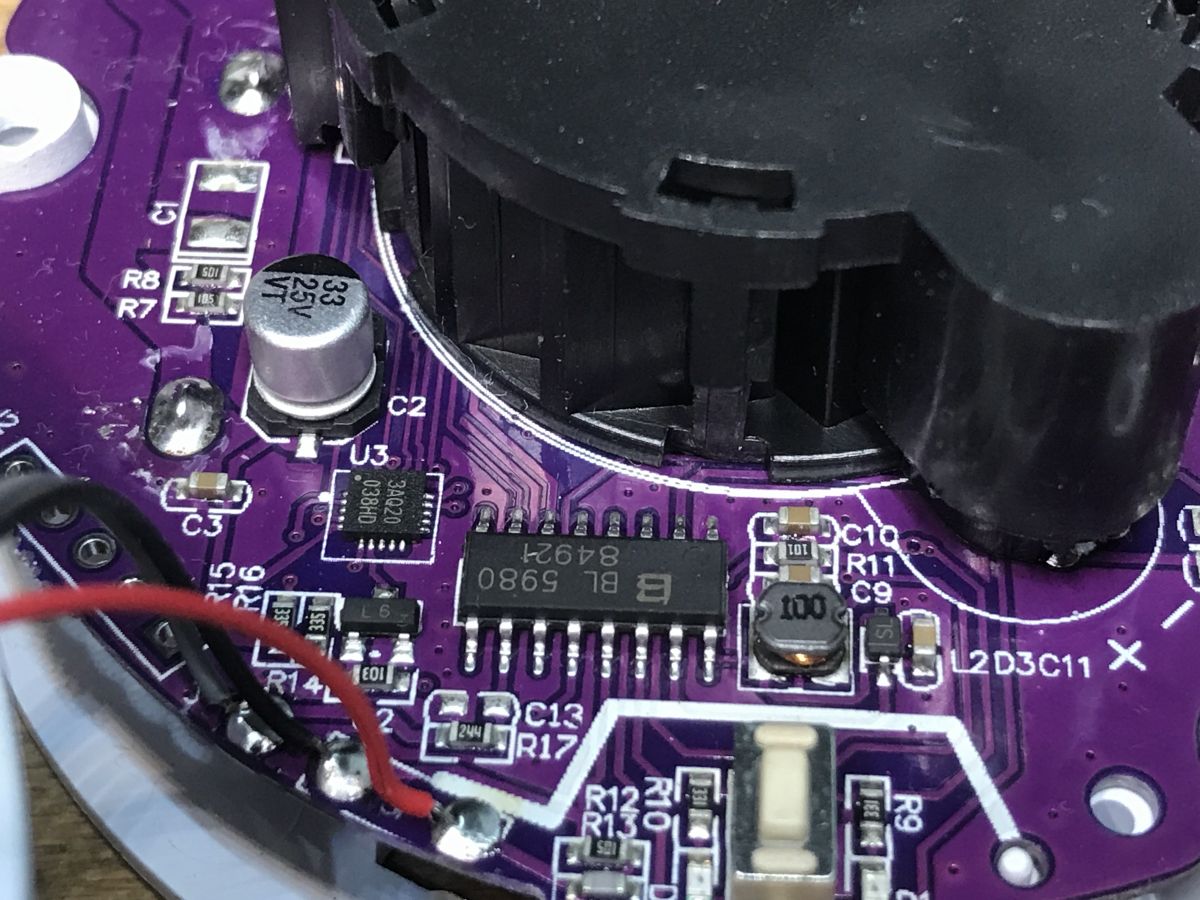

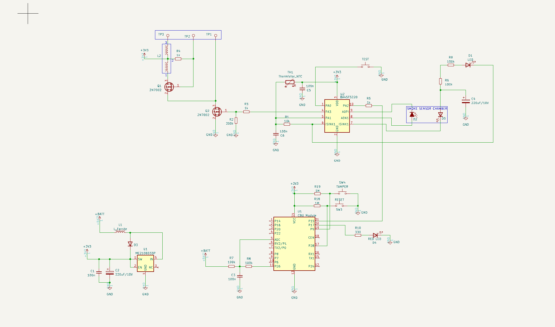

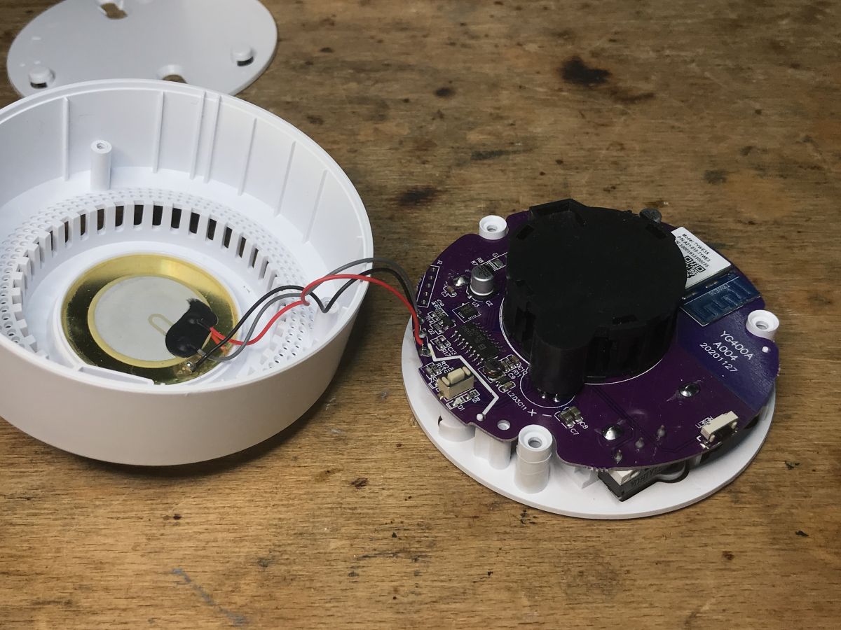

    Still working on this sensor - here is the reversed schematics for it.
    TP1, 2 and 3 are the Piezo siren.

    Very good job on schematic! I will also most likely have to draw one, as the door sensor I received about a month ago or so (thanks to one user's donation) is a TuyaMCU version, so I can't help much with testing here. I will most likely open a separate topic for that one:

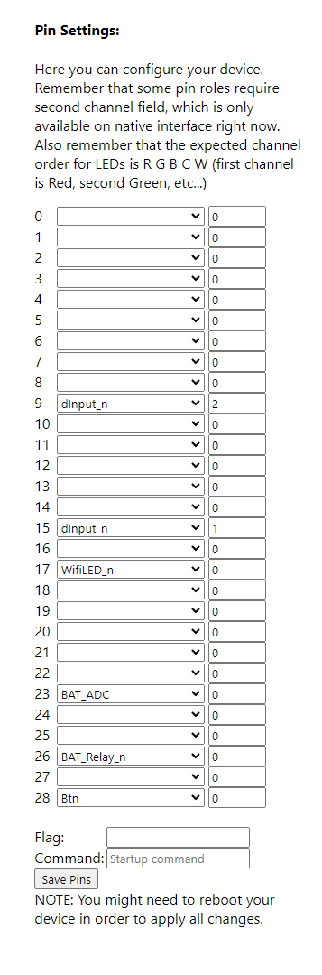

    Sorry for the delay regarding this device, here is the setup that is working for me:
    autoexec.bat
    Battery_Setup 2000 3000 2 2400 4096
    //measure batt every 2s
    Battery_cycle 2
    mqtt_broadcastInterval 1
    mqtt_broadcastItemsPerSec 5
    addEventHandler OnHold 10 SafeMode 5
    setChannelLabel 1 Smoke
    setChannelLabel 2 Tamper
    again1:
    delay_s 1
    if $CH2!=1 then goto again1
    delay_s 10
    goto again
    again:
    delay_s 1
    if $CH1!=1 then goto again
    delay_s 10
    PinDeepSleep
    and pin setup:
      "pins": {
        "9": "dInput_n;2",
        "15": "dInput_n;1",
        "17": "WifiLED_n;0",
        "23": "BAT_ADC;0",
        "26": "BAT_Relay_n;0",
        "28": "Btn;0"

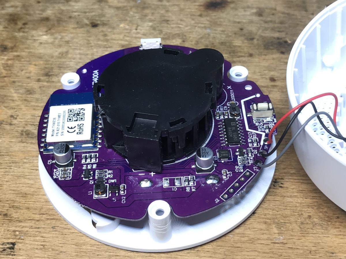

    One small HW modification that I did for tamper switch to raise the alarm if activated upon installation is that I connected a tamper switch floating pin to reset switch like this:
    OpenBeken on WiFi Smoke Detectors (Tuya CBU Chip) - ESP8266 Alternative, MQTT & Setup
    -not perfectly drawn but there is a yellow trace on the top :)

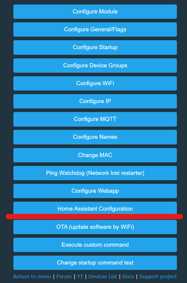

    1 - there is no provision atm for reporting battery without an event if device is in deep sleep, to get battery info you will have to wake up the device. And it is voltage that is being reported right now.
    2 - under config on your device you have Home Assistant Configuration
    You can start auto discovery form there.

    That the tamper switch does not wake up my device, if I fire the test button the state changes when the device wakes up and it goes to deep sleep when the tamper goes off again.
    Take a look at that bad picture of mine to add a jumper to the NO side of your tamper switch. It will wake the device from sleep state.

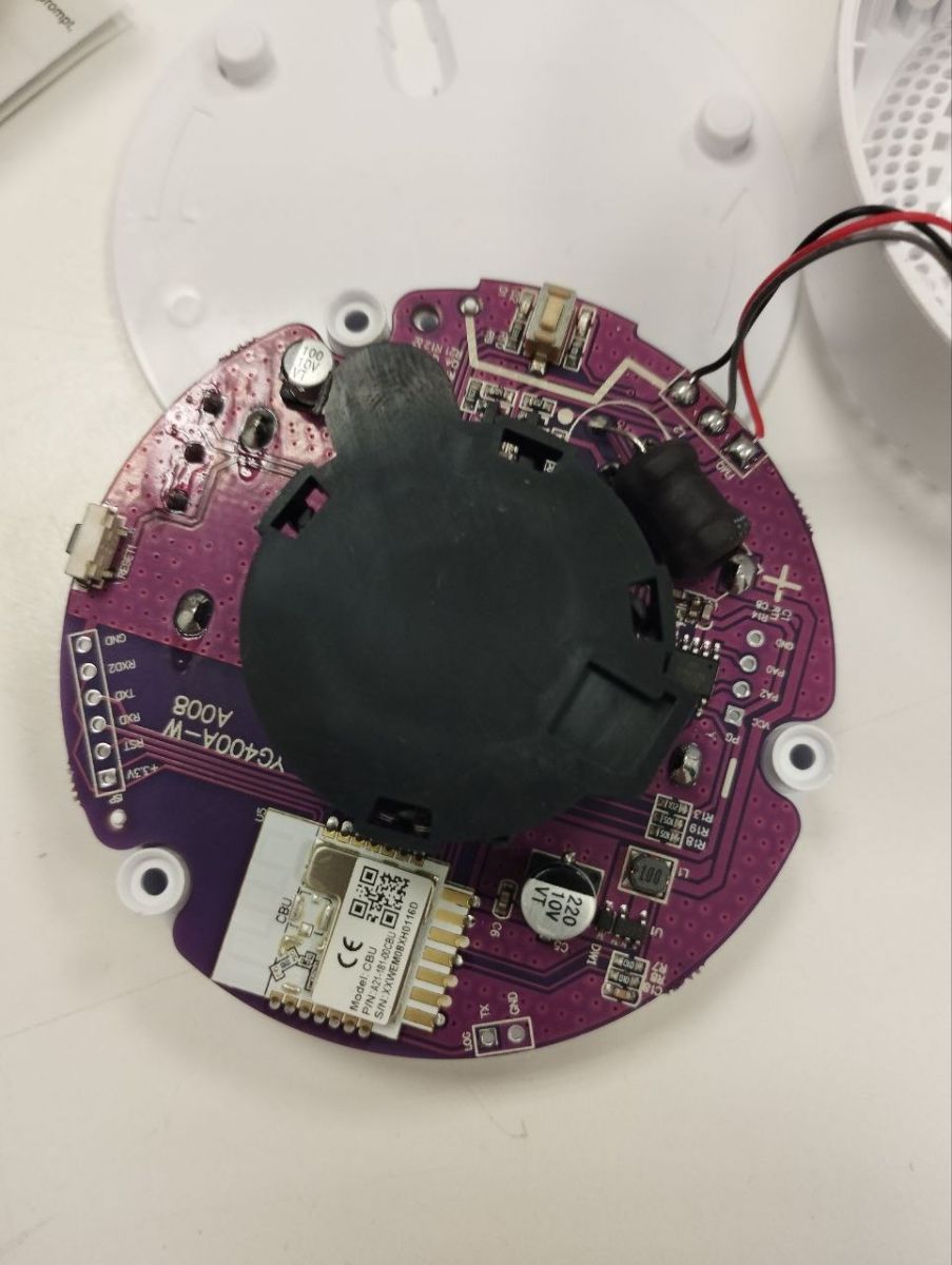

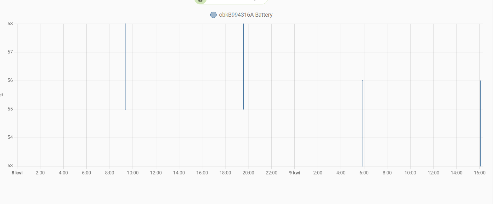

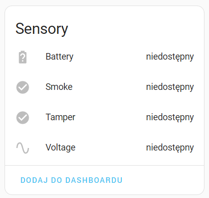

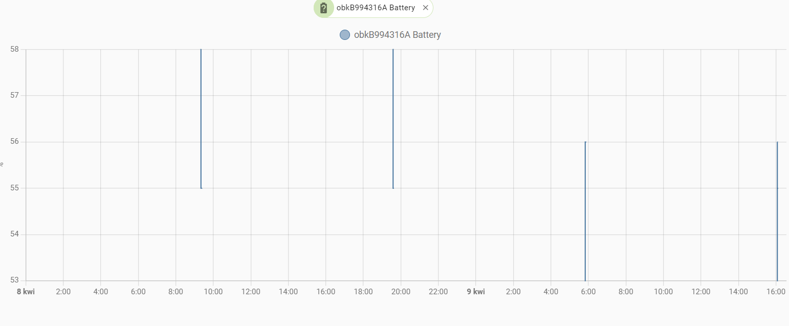

    I bought two YG400A - converted according to the recipe from this topic and from DeDaMrAz's advice - thank you. Autoexec works and such entities appear in Home Assistant.
    Screenshot of a sensor panel in Home Assistant, all marked as unavailable.
    But the sensor has not shown any signs of life on its own for 16 hours - it should wake up every few hours to provide information about its status and then go back to sleep, but this is not the case.
    The problem will be the battery running out - no one will know about it.
    When I press the test button or open it - it wakes up and gives information, but it doesn't do it on its own.
    What did I do wrong?

    I'm afraid everything is fine for now.
    The current firmware version does not support simultaneous wake-up from GPIO and timer. Either GPIO or timer. We are currently working on supporting both of these methods at the same time.
    You have to wait a bit, unless you know C, then let me know and I will show you more or less what to do. The problem comes down to the fact that the SDK used has no documentation, Beken does not provide anything and you have to guess.

    Hi - I am a OpenBeken noob and after searching through the wikis / docs I still have no clue what Flag 37 is and where to set it. Could you guide me through the config so the device can connect to my Wifi quicker? Thanks so much !
    Config -> Flags on OBK web panel
  • Home Assistant availability fix for retained MQTT topics
    #84 20825573
    seemebreakthis
    Thanks to @DeDaMrAz and @p.kaczmarek2's responses. I have managed to accomplish everything I wanted to do. Smoke detector is now permanently installed in my kitchen. 😊 Here are more tips:
    1. I have enabled flag 7 and flag 37. And yes the MQTT topics are now maintained, as can be checked easily with this command:
    mosquitto_sub -t "#" -v
    i.e. basically I just did the most direct test by simply probing directly into my MQTT broker, and have it spit out all the messages. This way I can know for sure that the MQTT messages for my smoke detector are now retained.
    2. But that did not change the behavior in my home assistant. After a few minutes of testing the alarm by pressing on the device's button, every parameter (including the alarm) still became 'unavailable'. The MQTT probing with the 'mosquitto_sub' command revealed what was happening - a topic was actively getting posted by the smoke detector just before it disconnects, with this message:
    <topic>/connected offline
    . So an 'offline' message gets interpreted by home assistant and makes everything related to the smoke detector become 'unavailable'. I changed this behavior at the end by modifying the configuration.yaml in the HA environment to remove the 'availability' section of the setup for my smoke detector (the yaml configuration was generated by OpenBeken that I copied and pasted to configuration.yaml in the first place). Now the alarm status is retained, but the 'RSSI' and 'Voltage' parameters would still get updated to 'unavailable' when the device goes offline for some reason (which doesn't really matter to me).

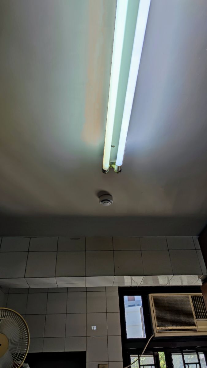

    ... up and running (and dirt cheap)! And very soon I will be utilizing the PayPal link to donate to OpenBeken. Thank you.
    Smoke detector installed on a kitchen ceiling with a fluorescent light.

    Hi all. It seems I got a new board rev. of this sensor. I flashed yesterday openbeken and I configured it as is written here. I noticed that when the battery was going to drain, the smoke sensor started to buzz until the battery finally ran out. Is this behavior only happening in this board revision? For the moment, I keep an eye on the dev repo to see when the gpio+timer sleep function is ready. Thanks for the hard work!
    Purple circular circuit board with mounted electronic components.

    In the new OpenBK7231N_1.17.539 software, waking up the smoke sensor via GPIO and Timer - command - DeepSleep xxxx - where these xxxx are seconds.
    I ran the command every 36000 seconds on my 2 sensors and since yesterday it shows me the battery status in my HomeAssistant every 10 hours.
    Here are the details.
    Graph showing battery level of sensor obkB994316A.
    https://www.elektroda.pl/rtvforum/topic4041971.html
    Now I`m completely happy and I know when the battery needs to be replaced

    In the new OpenBK7231N_1.17.539 software, works waking up the smoke sensor via GPIO and Timer - command - DeepSleep xxxx - where these xxxx are seconds.
    Graph showing battery level of smoke detector obkB994316A over time.
    Tuya WiFi smoke detector (CBU chip)
    Now I'm completely happy and I know when the battery needs to be replaced
