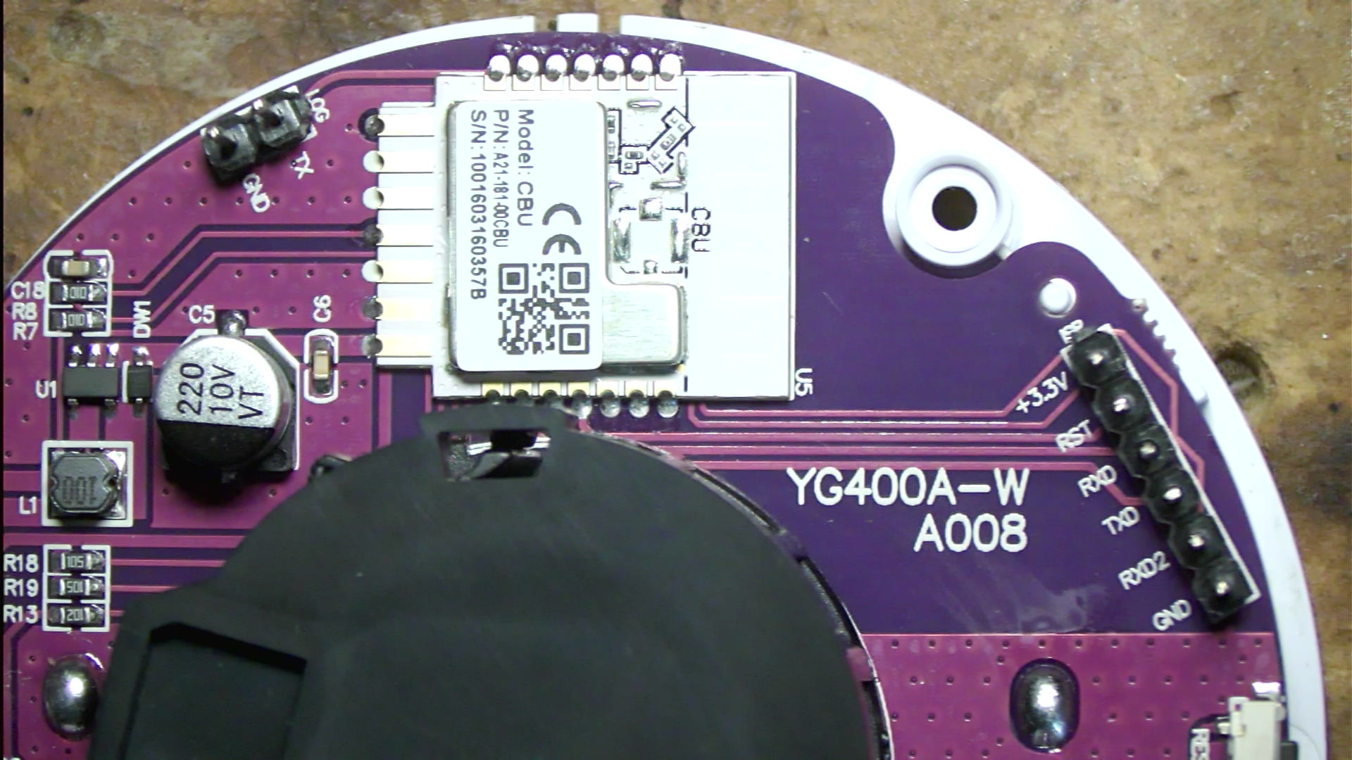

    Hello I am owner of a YG400A-W smoke detector and new to the forum.
    I have flashed the device with OpenBK7231T/OpenBeken release 1.17.553.
    A few facts:
    1) I don't get any MQTT message when device is sleeping and real smoke is detected (THE PROBLEM), however the buzzer goes off as expected.
    2) I get MQTT message when device is sleeping and I press the led button

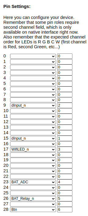

  • #100 21065934
    DeDaMrAz
    Posts: 621
    Help: 34
    Rate: 130
    @carlig833
    Can you take a screen shot of you pin configuration for us to possibly help you a bit better?
    I suspect that you have confusing channel selection.
    Thanks.
  • #101 21065943
    Posts: 14767
    Rate: 12907
    @DeDaMrAz if he has set two input roles for the same channel, then indeed, in that case he might get a race condition and unpredictable readouts. For example, if he has two digital inputs trying to write to a single channel...

    #102 21073585
    carlig833
    Posts: 23
    My YG400A-W smoke detector works fine now!
    My final setup:
    1) Firmware: OpenBK7231N_1.17.566.rbl
    2) Pin setup:
    Screenshot showing pin settings for the YG400A-W smoke detector.
    3) Autoexec.bat

  • Battery measurement appears stuck at 100 and 4800 mV
    #115 21295363
    vitya123
    Posts: 51
    Rate: 11
    Dear All,
    Are you guys sure that the battery measurement works? I am unable to get any other reading (in MQTT) than batter/get: 100 and voltage/get:4800...
    This is my config:
      "pins": {
        "9": "dInput_n;2",
        "15": "dInput_n;1",
        "17": "WifiLED_n;3",
        "23": "BAT_ADC;4",
        "26": "BAT_Relay;5",
        "28": "Btn;6"
    Autoexec.bat (I stole it from a few posts above...):
    Battery_Setup 2000 3000 2 2400 4096
    //measure batt every 2s
    Battery_cycle 2
    mqtt_broadcastInterval 1
    mqtt_broadcastItemsPerSec 5
    addEventHandler OnHold 10 SafeMode 5
    setChannelLabel 1 Smoke
    setChannelLabel 2 Tamper
    again1:
    delay_s 1
    if $CH2!=1 then goto again1
    delay_s 10
    goto again
    again:
    delay_s 1
    if $CH1!=1 then goto again
    delay_s 10
    PinDeepSleep
    My smoke sensor looks like this:
    Close-up of a circuit board with electronic components and a module with markings.
    Thanks for any pointers!
  • Reset-button flashing sequence not connecting to BA50F1V board
    #116 21346488
    drkaresz
    Posts: 14
    Hi Folks!
    I'm absolute new to OpenBeken but with some experience with ESP, I bought this device.
    I have YG400A-W A008 board and BA50F1V Y7T009G5 chip.
    My Tasmota flasher looks great for this goal so I try as written above.
    When I connect my flasher's RX, TX and GND to the panel the YG400A-W A008 starts crimping. No one write this earlier but I believe it is not a problem and do not happen every time.
    I run the flasher and try pushing the reset button but it can not connect to the device. As I see CAN has no direct output on the panel just via the R18 resistor to the reset button, and I think it is enough. Am I made a mistake?
    So I believe flashing this device:
    1. connect RX, TX, GND
    2. run flasher
    3. press reset on the board
    4. voila...
    But this not working for me
    Thank you for any kind of help!
  • Use CEN pin or power cycle to reset CBU module
    #117 21346518
    vitya123
    Posts: 51
    Rate: 11
    Step 3: you need to reset the module. The onboard button is not a reset button, just a button, that (from software) can or cannot restart the device.
    What you need to do is either use pin 18 (CEN) of the CBU module, or simply remove power and connect power again. Of course, only if you have the CBU version of the panel...
    See this page for reference: https://developer.tuya.com/en/docs/iot/cbu-module-datasheet?id=Ka07pykl5dk4u
  • #118 21346743
    drkaresz
    Posts: 14
    >>21346518
    Thank you very much for your fast reply vitya!
    I've checked your link, my chip is compatible, I've found the CBU, tried dozens and dozens to reset with GND but no success.
    Still thinking what is wrong but I do not have any idea right now.
    Anyway, thanks again!
  • Need 3.3V connection and exact flashing details
    #119 21346756
    vitya123
    Posts: 51
    Rate: 11
    I also just noticed that you didn't mention 3.3V, only Rx, Tx and Gnd. Can I assume you also connected the 3.3V to the battery terminals? :)
    Also, what do you mean: "tasmota flasher"? To flash this chip you need to use this: https://github.com/openshwprojects/BK7231GUIFlashTool
    Others might work, but this one definitely does.
    Also, when you say "But this is not working for me" what do you mean? What exactly did you do? What exactly happened?
  • BK flashtool works with RX, TX and GND only
    #120 21346906
    drkaresz
    Posts: 14
    Thank your vitya for your patience!
    So I connect only RX, TX and GND from my usb flasher (what I use for tasmota too) and run the BK flashtool.
    I do not connect 3.3V as it was mentioned in post #82 (https://www.elektroda.com/rtvforum/topic3941698-60.html#20824777) and there is no battery in the device.
    When the flashtool asks me to ground CBU I ground the CBU leg (18) to another free GND on the board for a very short time.
    This was what I tried in the last 2 hours :)
