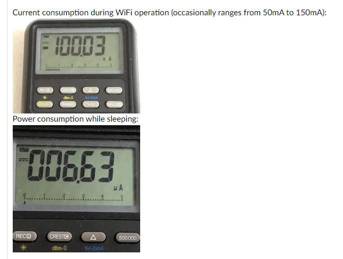

    Do both of you guys have a smoke sensors without TuyaMCU? The ones requiring deep sleep on the BK7231 side so the batteries won't drain in one day?
    I am asking because there are two types of low power devices on the market. First type is using TuyaMCU, an external MCU which works all the time in low power mode and only turns on and off WiFi module power (via MOSFET) when data is needed to be reported to the server, and the MCU is using TuyaMCU protocol to communicate with WiFi module, and the second type is where smoke sensor is connected directly to WiFI module and WiFi module is always on, but it's using deep sleep to save energy.
    Here is a measurement data of BK7231T current consumption in active WiFi mode and in deep sleep mode:
