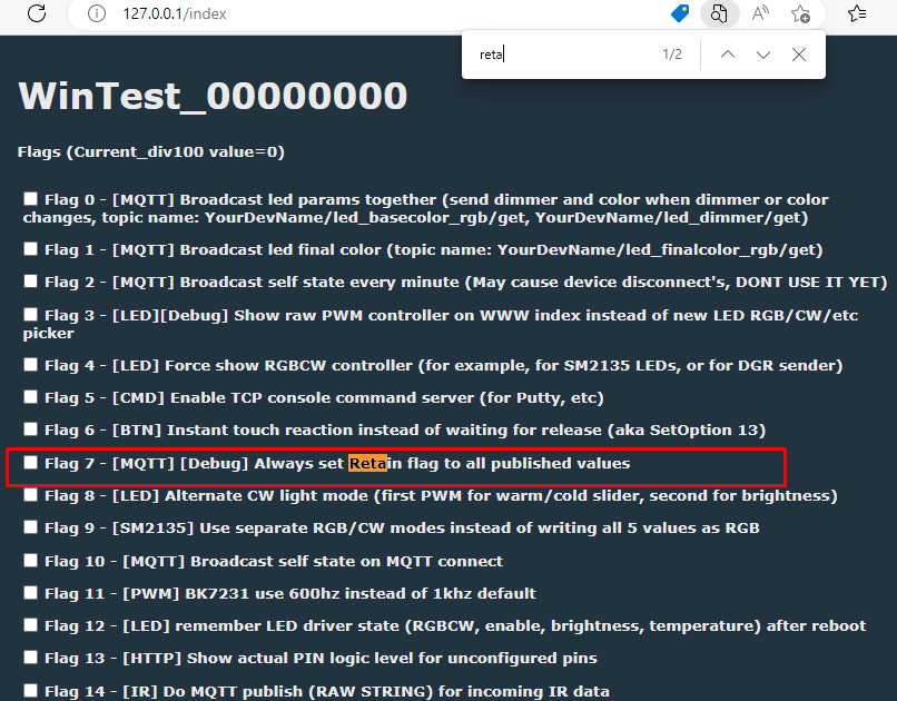

    Hi, how can I do that?
    Added after 47 [minutes]:
    Write sensor retain in the yaml?
  • #32 20325220
    Posts: 14810
    Rate: 12977
    @caubergjef57 you can write retain in yaml, yes, but you can also enable flag:
    Motion sensor with BK7231N and TuyaMCU battery powered devices protocol
  • #33 20326004

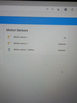

    caubergjef57
    Level 4  
    Posts: 42
    Hi, I set the flag but nothing changed in HA
    Flag 7 - [MQTT] [Debug] Always set Retain flag to all published values
    December 9, 2022
    Motion_sensor_1 became unknown
    11:10:28 AM - 13 minutes ago
    Motion_sensor_1 became unavailable
    11:10:27 AM - 13 minutes ago
    11:10:26 AM - 13 minutes ago

    Is retain also set in yaml?
  • #35 20326550
    caubergjef57
    Level 4  
    Posts: 42
    No I can't write it in yaml. Get an error when I want saved in Ha.
    I write retain: true but can't saved it in Ha
  • Retain option invalid in mqtt binary_sensor config

    Hi,
    I write this in the config.yaml
    binary_sensor:
    - unique_id: "OpenBK7231N_8c000000"
    state_topic: "obk8c000000/1/get"
    qos: 1
    payload_on: 1
    payload_off: 0
    retain: true
    availability_topic: "obk8c000000/connected"
    But when I want to save this I get this error
    Invalid config for [mqtt]: [retain] is an invalid option for [mqtt]. Check: mqtt->mqtt->binary_sensor->0->retain.
    When I delete the line retain: true
    then no problem for saving the config.yaml

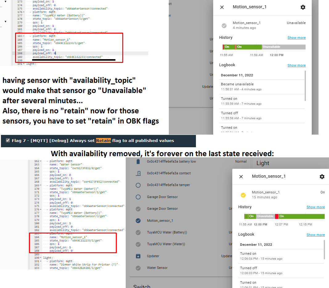

  • Remove availability topic and enable retain in OBK
    #37 20329316
    Posts: 14810
    Rate: 12977
    As I said in previous post, I apologize for slow reply, but please be a bit more understanding, I am a single person and I am helping in my free time.
    Ok, it seems that retain was removed from HA in the past. So that's not the way.
    You just need to set retain in OBK.
    You also need to remove the availability topic. Wait, I will check on my device.
    EDIT: Testing...
    ye, it seems that you just had to remove ability topic? Let me check more...
    Solution: remove availability topic because it makes device go unavailable and enable retain on OBK (ha no longer has this options for binary sensor)

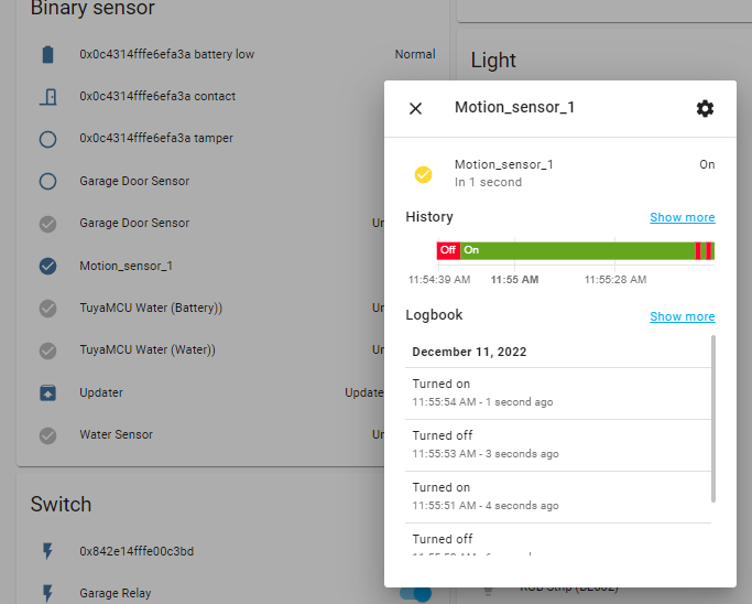

  • #38 20330584
    caubergjef57
    Level 4  
    Posts: 42
    H,
    I changed this in the config.yaml and now I can see the motion sensor on and off in HA.
    Thanks so far.

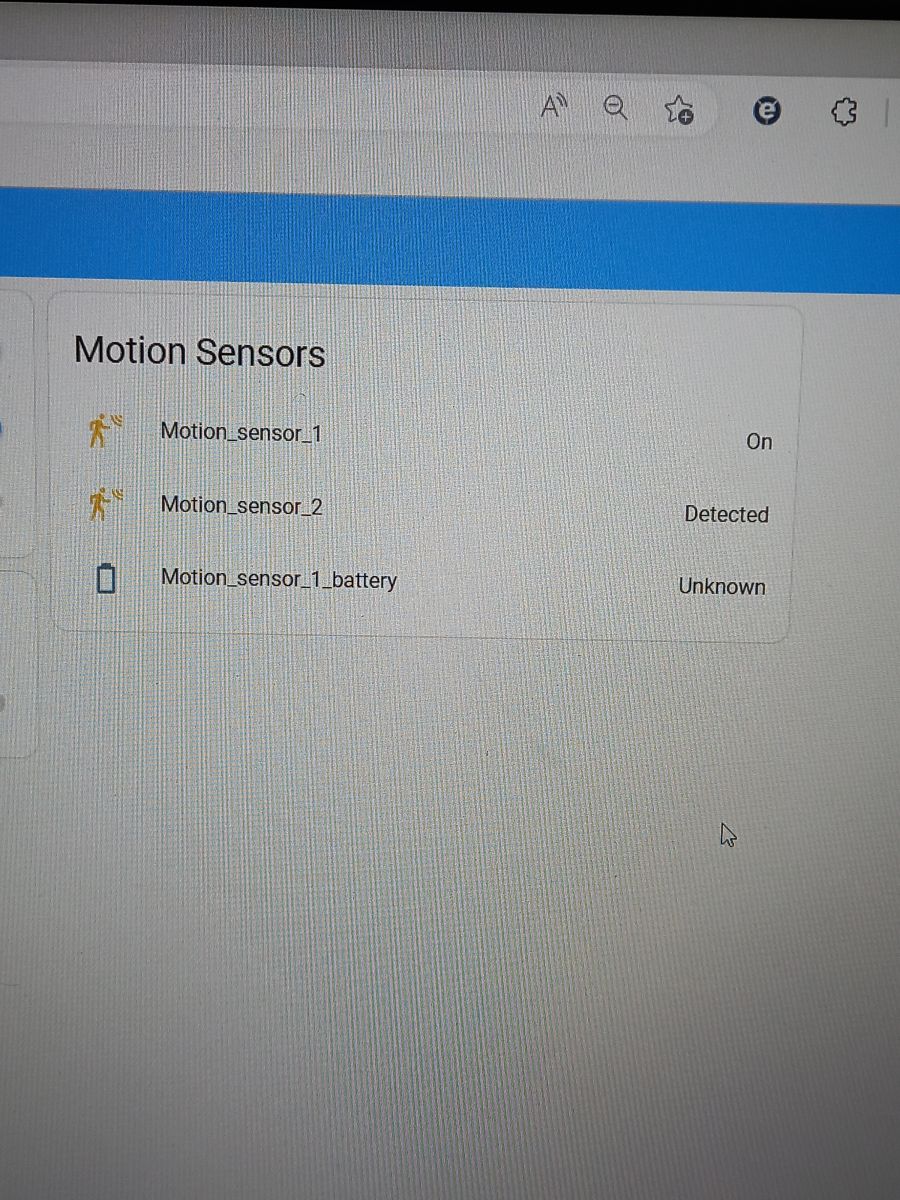

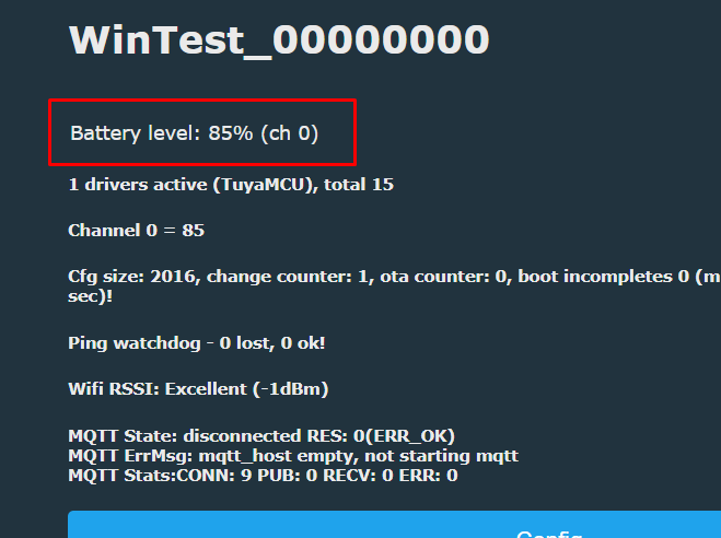

    Is there any change for seeing the battery status?

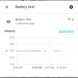

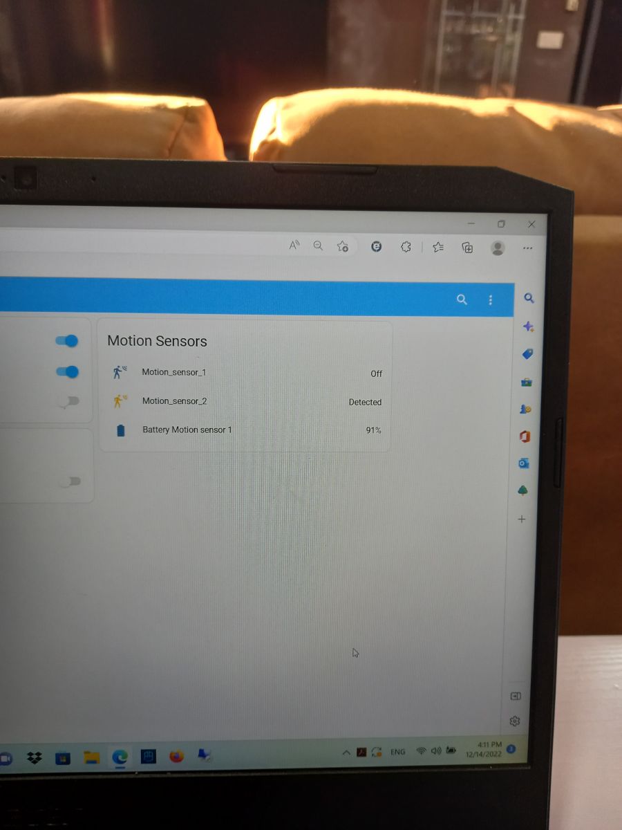

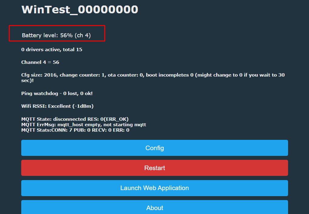

  • Check TuyaMCU logs for battery dpIds 2 and 3
    #41 20332361
    Posts: 14810
    Rate: 12977
    Hello, from what I know, it's possible to get battery status only if TuyaMCU is reporting it.
    Please check Web App logs to see what is being received.
    This is example log entry for detection state:
    Info:TuyaMCU:TUYAMCU received: 55 AA 00 05 00 05 01 04 00 01 01 10
    Info:TuyaMCU:TuyaMCU_ProcessIncoming[ver=0]: processing command 5 (WiFiSelect) with 12 bytes
    Info:TuyaMCU:TuyaMCU_V0_ParseRealTimeWithRecordStorage: processing dpId 1, dataType 4-DP_TYPE_ENUM and 1 data bytes
    Info:TuyaMCU:TuyaMCU_V0_ParseRealTimeWithRecordStorage: raw data 1 byte:
    So you know that dpId 1 is detection state.... there might be also two battery related dpIds:
    - dpId - 2 - Battery Level Percentage - values range: 0-100
    - dpId - 3 - Battery Level Enum - low, middle, high
    Are you able to see any dpId 2 or 3 in the logs?
    You could also try setting:
    setChannelType 2 readonly
    // link dpid to channel 2
    to see if anything is received... maybe do the same for '3'.... and just observe, if it doesn't do anything, remove it later.

    Added after 10 [minutes]:
    Hi,
    Try doing that but in the log nothing changed, i only see a dpId 4.
  • dpId 4 likely reports battery percentage
    #43 20332445
    Posts: 14810
    Rate: 12977
    You did great! dpId 4 must be a battery percentage! Good work.
    Info:TuyaMCU:TuyaMCU_ProcessIncoming[ver=0]: processing command 5 (WiFiSelect) with 15 bytes
    Info:TuyaMCU:TuyaMCU_V0_ParseRealTimeWithRecordStorage: processing dpId 4, dataType 2-DP_TYPE_VALUE and 4 data bytes
    Info:TuyaMCU:TuyaMCU_V0_ParseRealTimeWithRecordStorage: raw data 4 int: 78
    78 = 78%?
    Can you check if it slowly goes down over time?
    NOTE: the following example links dpId 4 to channel 4. You could map it to channel 2 when you don't use channel 2 and 3, but maybe it will be easier if we map it to the channel with the same number as dpId..
    setChannelType 4 readonly
    // link dpid to channel 4
    linkTuyaMCUOutputToChannel 4 val 4
    Anyway, now please check if it really is a battery percentage.
    In a meantime, I might try to add a special "Channel type" for a better display of battery percentage on the main HTTP page.... but it's not really needed, only a cosmetic change. You could already just configure it and receive channel 4 (or whichever you map it to) in HA and use it as a battery percentage.
  • TuyaMCU sends dpId 4 value 90

    UPDATE
    It is just a cosmetic change, but I added a channel type for you.
    If you do:
    setChannelType 4 BatteryLevelPercent
    it will display it as a battery level on HTTP page.
    Look:

  • Home Assistant MQTT config for motion and battery sensors
    #52 20333979
    caubergjef57
    Level 4  
    Posts: 42
    OpenBK7231N_8C000000
    Channel 1 = 1
    Battery level: 85% (ch 4)
    2 drivers active (TuyaMCU, tmSensor), total 17
    Channel 1 = 1, Channel 4 = 85
    Cfg size: 2016, change counter: 5, ota counter: 0, boot incompletes 0 (might change to 0 if you wait to 30 sec)!
    Ping watchdog - 0 lost, 0 ok!
    Wifi RSSI: Good (-57dBm)
    MQTT State: connected RES: 0(ERR_OK)
    MQTT ErrMsg:
    MQTT Stats:CONN: 1 PUB: 9 RECV: 3 ERR: 0
    This I get already, my mistake I write the battery level in the command line and not in the autoexec.bat
    That's okay now.
    Added after 5 [minutes]:
    binary_sensor:
    - unique_id: "OpenBK7231N_8C000000"
    state_topic: "obk8C000000/1/get"
    qos: 1
    payload_on: 1
    payload_off: 0
    - unique_id: "OpenBK7231N_8C000000_battery"
    state_topic: "obk8C000000/4/get"
    device_class: battery
    payload_on: low
    payload_off: normal
    qos: 1
    And I get this result
  • Battery should be configured as a sensor
    #53 20333999
    Posts: 14810
    Rate: 12977
    Binary sensor is binary, only and off. Why do you configure battery as binary sensor? Maybe try other way...
    Code: YAML
    I will still need to find out how to change icon. I will look into it more.
  • Config.yaml sensor setup for battery motion device
    #54 20334090
    caubergjef57
    Level 4  
    Posts: 42
    Finally I got it working.
    Write this in the config.yaml
    sensor:
    name: "Battery Motion sensor 1"
    unit_of_measurement: "%"
    value_template: "{{ value }}"
    Thanks
