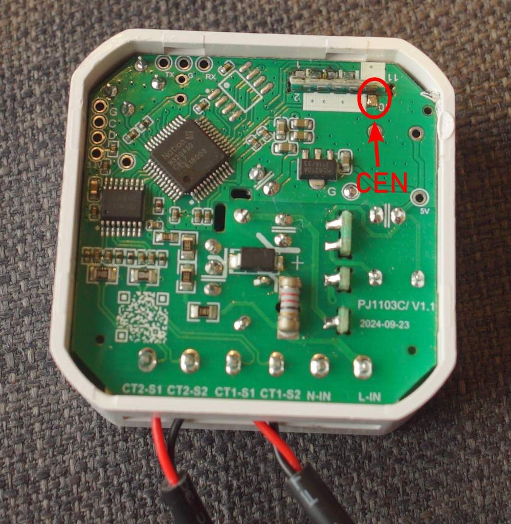

    randomalias324
    Posts: 46
    Have been having a lot of success with the 2 channel versions of these, and thought I'd post my configuration.
    Model: PJ-1103A
    Range: 0.2-80A
    Manufacturer: Dongguan Pinjia Technology CO.,LTD.
    Label on the box of PJ-1103A energy monitor by Dongguan Pinjia Technology CO, LTD.
    1st point is, I had some difficulty resetting the WiFi password once WiFi had been configured to a previous SSID. When booted into safe mode, to get Hopspot / wireless access point mode active, the MCU was resetting the device. As the TuyaMCU driver was not loaded during safe mode, the best way I found to stop this behaviour was to de-solder the reset / CEN pin, which is quite easy on these units. After this modification, I have removed tuyaMcu_defWiFiState 4 from my autoexec because the MCU also drives an LED that flashes based on state, which is handy feedback.
    PJ-1103A circuit board with marked CEN pin.
    I have been using one of these modules for about 12 months without the need to know the current direction. I may need that information soon, so I have updated my autoexec.bat. I have implemented current and power channels that go negative when the current direction is reversed. Note the polarity of the clamp wires if you want the current direction to make sense with respect to the arrow on the clamp. The intended polarity is not marked on the device or in the instruction manual.
    I didn't know you could set the update rate! Thats there too.

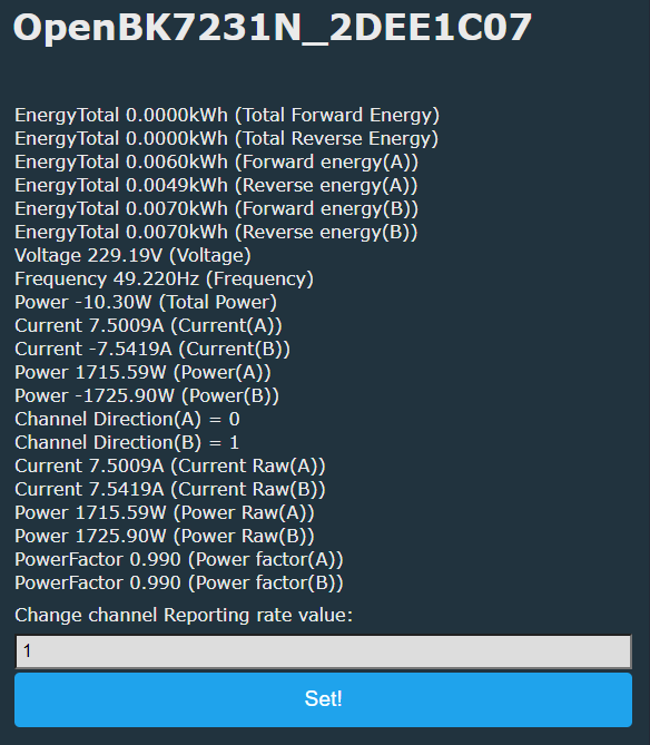

    The resulting UI page
    Screenshot of OpenBK7231N_2DEE1C07 user interface with energy data.

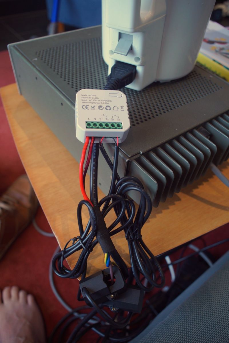

    It does not seem possible to calibrate these units, at least in the usual way. Scaling of the result could probably handled in a script, but the factory calibration does seem reasonably accurate. Tested with a kettle and verified with multimeters
    PJ-1103A measuring device with connected power wires.

    snkbrzmir4 wrote:
    alias positive setChannel 19 $CH3
    alias negative setChannel 19 $CH3*-1
    alias myset if $CH4==0 then positive else negative
    // WARNING 2 - PSEUDOCODE, NOT TESTED, may have syntax errors
    // now trigger it on every change
    addEventHandler OnChannelChange 3 myset
    addEventHandler OnChannelChange 4 myset
    It is quite easy and clear doing it branchless in one line, which might be a better addition to the example file
    randomalias324 wrote:
    addEventHandler OnChannelChange 16 SetChannel 10 $CH16-(2*$CH14*$CH16)
    Where $CH16 is the unsigned power figure, $CH14 is the boolean direction flag and 10 is the channel being set with a signed power figure
