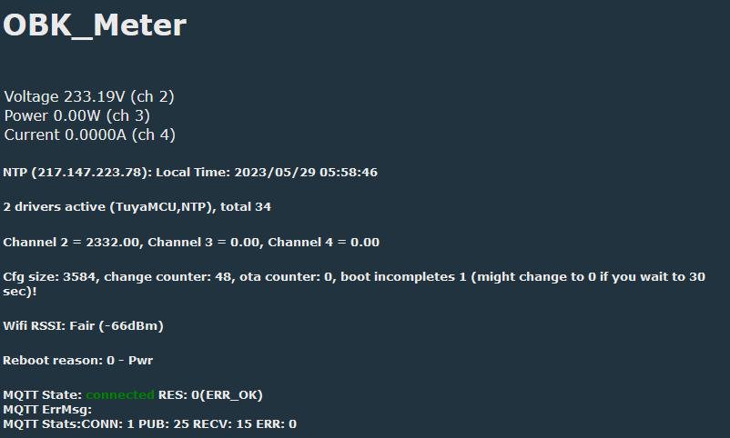

    Hi all, any news on this ?
    I'm pretty new to the templates / finding pins, and I can't make this energy meter to work.
    Installed Obk, but no info from the device.
    Created the autoexec with the info given, but still no luck.
    Well, not completely true, I can see voltage moving, but no power / current at all.

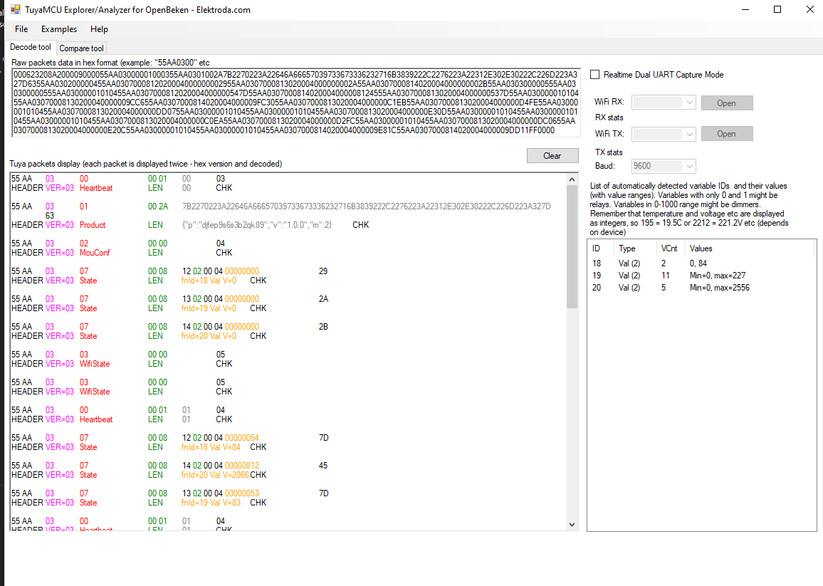

    Exploring the Inner Workings of PJ-MGW1103 CT-Clamp Energy Meter: Tuya, BL0942, CB2S Components
    It doesn't.
    But i (this afternoon) i will try to read more logs and try to find what dpi are missing.
    Info:TuyaMCU:TUYAMCU received: 55 AA 03 07 00 18 14 02 00 04 00 00 09 18 12 02 00 04 00 00 00 00 13 02 00 04 00 00 00 00 8D
    Info:TuyaMCU:TuyaMCU_ProcessIncoming[ver=3]: processing command 7 (State) with 31 bytes
    Info:TuyaMCU:TuyaMCU_ParseStateMessage: processing dpId 20, dataType 2-DP_TYPE_VALUE and 4 data bytes
    Info:TuyaMCU:TuyaMCU_ParseStateMessage: raw data 4 int: 2328
    Info:TuyaMCU:TuyaMCU_ParseStateMessage: processing dpId 18, dataType 2-DP_TYPE_VALUE and 4 data bytes
    Info:TuyaMCU:TuyaMCU_ParseStateMessage: raw data 4 int: 0
    Info:TuyaMCU:TuyaMCU_ParseStateMessage: processing dpId 19, dataType 2-DP_TYPE_VALUE and 4 data bytes
  • #35 20598234
    Posts: 14791
    Rate: 12937
    But in post 30, we have determined that dpID 19 and 18 are current/power, and in the log you've shown it seems that TuyaMCU sends 0 values there?

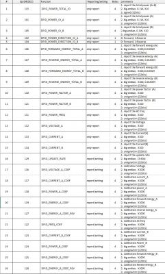

  • Confirming PJ-MGW1103 DP ID assignments
    #42 20627063
    elektradi
    Posts: 21
    Can someone confirm these DP IDs?
            "add_ele": 17
            "cur_current": 18
            "cur_power": 19
            "cur_voltage": 20
            "test_bit": 21
            "voltage_coe": 22
            "electric_coe": 23
            "power_coe": 24
            "electricity_coe": 25
            "fault": 26
            "power_reactive": 51
            "power_effective": 52
  • Tuya firmware reports only current, power, and voltage dpIDs

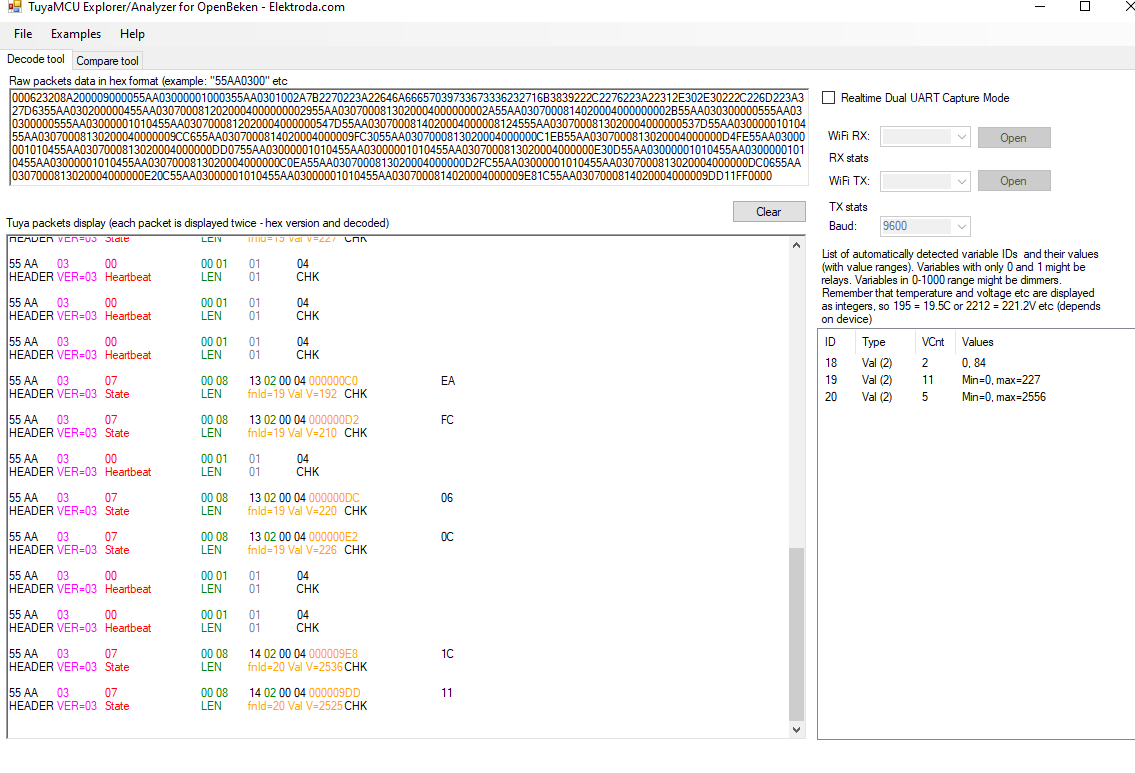

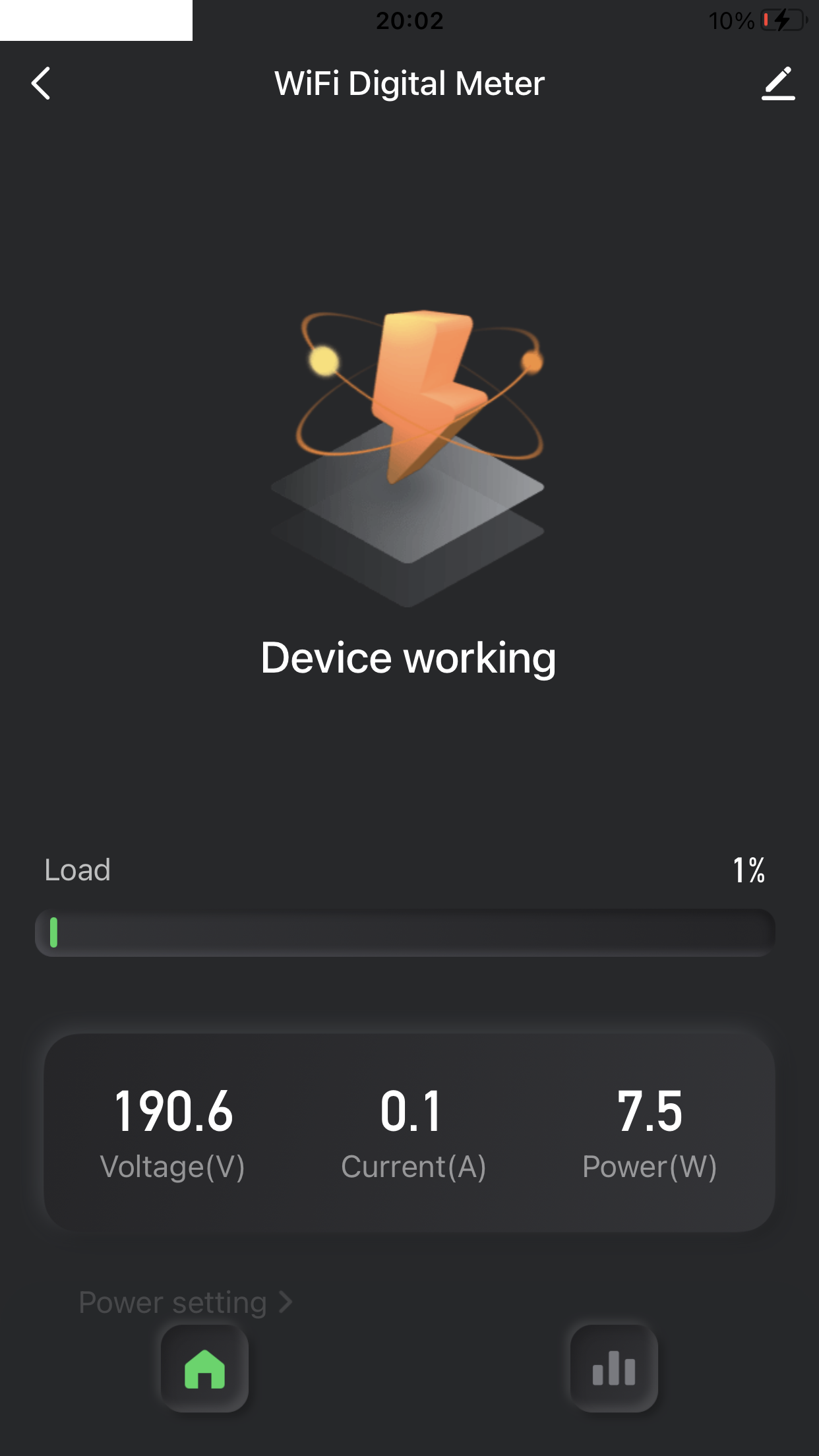

    I've got that device:
    Here is what I got with bulb test on Tuya firmware:
    As you can see, I got only the following dpIDs reported by Tuya firmware:
            "cur_current": 18
            "cur_power": 19
            "cur_voltage": 20
    I am not aware of the other ones, how did you get them to show up?

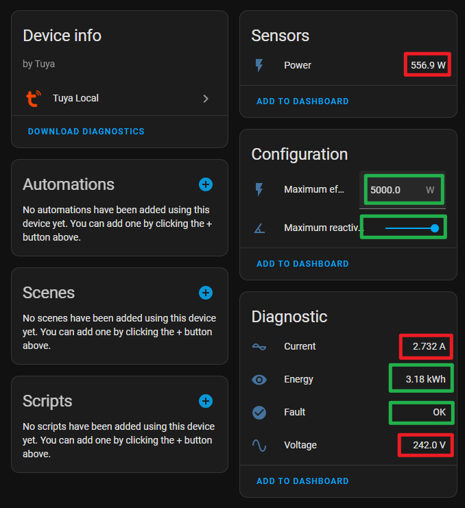

    elektradi
    Posts: 21
    1. I'm connected tuya original firmware to my HA. I see extra things in green boxes, and those seem to be missing.
    2. On my Smart App, I see Main Module v2.1.6, MCU Module is 1.0.0
  • Tuya energy is calculated server-side, not via dpIDs
    #50 20638571
    Posts: 14791
    Rate: 12937
    Hmmm, I didn't check that when I was testing with the Tuya app, and now the device is flashed with OBK and installed in a family member's house. I don't know which Main Module/MCU module version I had.
    But still, it looks like you don't have those even on Tuya?
    But I will say this:
    - Energy is calculated on the Tuya side, so I don't think it's dpID. They only have: add_ele which seems to reset periodically, it's like a delta
    - The Configuration params are things sent from the WiFi module to the MCU, they are not read results
    So currently it looks like you have almost everything the same as me...

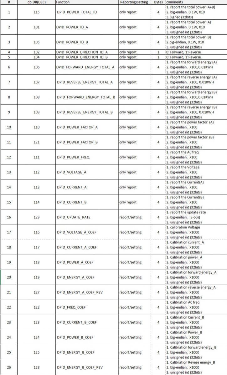

    madmak76
    Posts: 15
    Hello everyone,
    I bought a device very similar to yours from MatseePlus with only two terminals (terminals like yours 80A) but in the Zigbee version.
    I managed to get a DP map from them with a description of the functions.
    Unfortunately, the device in Zigbee2mqtt is currently unsupported but it is correctly detected.
    As a gateway, I use a Sonoff Zigbee plus USB dongle that detects the Tuya TS0601 device and the manufacturer is _TZE204_81yrt3lo.
    Can any of you, based on these DP, make some HA or Zigbee2mqtt config to make it work properly?

Can I invert power when the energy flow reverses?
Yes. Use the sign bit dpIDs (102 for clamp A, 104 for clamp B) and an event handler:
  1. alias pos setChannel X $CHp
  2. alias neg setChannel X $CHp*-1
  3. addEventHandler OnChannelChange p/ sign myset Full script in example file commit 1.17.619 [Elektroda, p.kaczmarek2, post #21125287]
Where are total kWh values stored?
The STM32 (MCU) accumulates Wh and exposes them as dpIDs 1/2 (device total) and 106-109 (per clamp). They survive Wi-Fi reflash but are lost if the MCU is power-cycled for several minutes [Elektroda, randomalias324, post #21429711]
How do I calibrate voltage or current?
Set dpIDs 116 (V), 117 (I₁), 118 (P₁), 122 (F), 123 (I₂) etc. via TextField channels, then write the desired integer. No BL0942 driver calibration is required because values are stored in MCU flash [Elektroda, erdeidominik1999, post #21114187]
