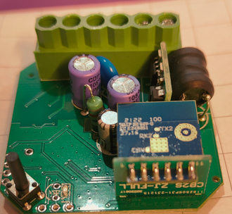

    Hi All,
    I would like to share that I've successfully got the two clamps version working;
    It did take me a while getting all the required information together, so here a quick write up on the two-clamp version;
    1. Flash the device using tuya-cloudcutter (the device is on the device list as generic "Tuya PJ-MGW1103 "
    2. connect to your wifi
    3. paste the correct autoexec.bat (post 77 https://www.elektroda.com/rtvforum/topic3946128-60.html#20851047)
    startDriver TuyaMCU
    tuyaMcu_setBaudRate 9600
    tuyaMcu_defWiFiState 4
    setChannelType 2 Voltage_div10
    setChannelType 3 Current_div1000
    setChannelType 4 Current_div1000
    setChannelType 5 Frequency_div100
    setChannelType 6 Power_div10
    setChannelType 7 Power_div10
    setChannelType 8 PowerFactor_div100
    setChannelType 9 PowerFactor_div100
    // linkTuyaMCUOutputToChannel dpId variableType tgChannel
    //ch 2(dpid 20) voltage
    linkTuyaMCUOutputToChannel  112 1 2
    //ch 3(dpid 19) power watts
    linkTuyaMCUOutputToChannel 113 1 3
    linkTuyaMCUOutputToChannel 114 1 4
    //ch 4(dpid 20) frequency
    linkTuyaMCUOutputToChannel  111 1 5
    linkTuyaMCUOutputToChannel  101 1 6
    linkTuyaMCUOutputToChannel  105 1 7
    linkTuyaMCUOutputToChannel  110 1 8
    linkTuyaMCUOutputToChannel  121 1 9
    4. reboot
    5. done!

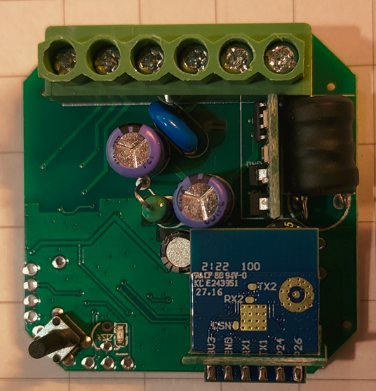

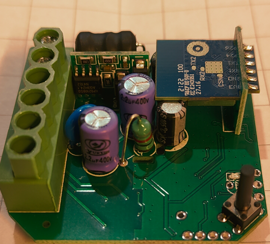

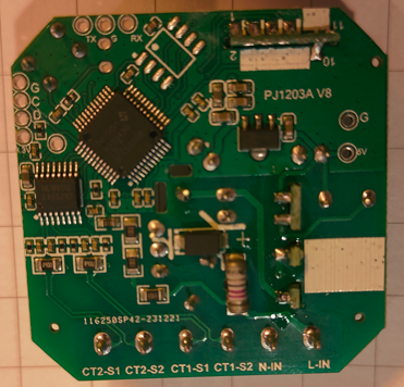

    My device:
    Circuit board of the Tuya PJ-MGW1103 device in a dual-clamp version.
    Image of a circuit board with electronic components and connectors.
    Circuit board with electronic components, including terminals and a blue module.
    Image of an electronic module with a green terminal block and various components.
    Electronic board with components for modifying a Tuya device.

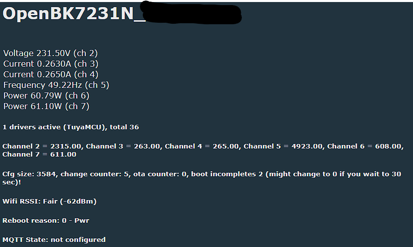

    Lessons learned:
    baud rate needs to be 9600
    no hardware fiddling is required
    Proof;:
    Screenshot showing information about the OpenBK7231N device.

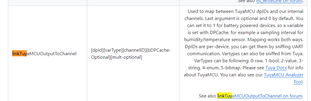

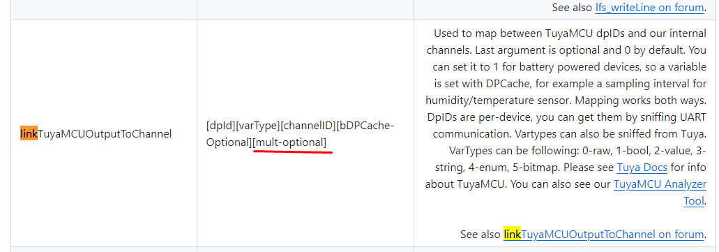

  • Multiplier -1 added for sign inversion
    #103 21049968
    Posts: 14791
    Rate: 12937
    snkbrzmir4 wrote:
    I haven't discovered how to invert the sign to show it in homeassistant, I believe that simply multiplying by -1 would solve it without any major problems.
    Sure, that's a good idea, I added a way to do that.
    Please update the firmware.
    You can now specify a multiplier, -1, for example.
    A section of documentation about the linkTuyaMCUOutputToChannel function with instructions and explanations.
    remember to also specify dpCache value (0 in your case)

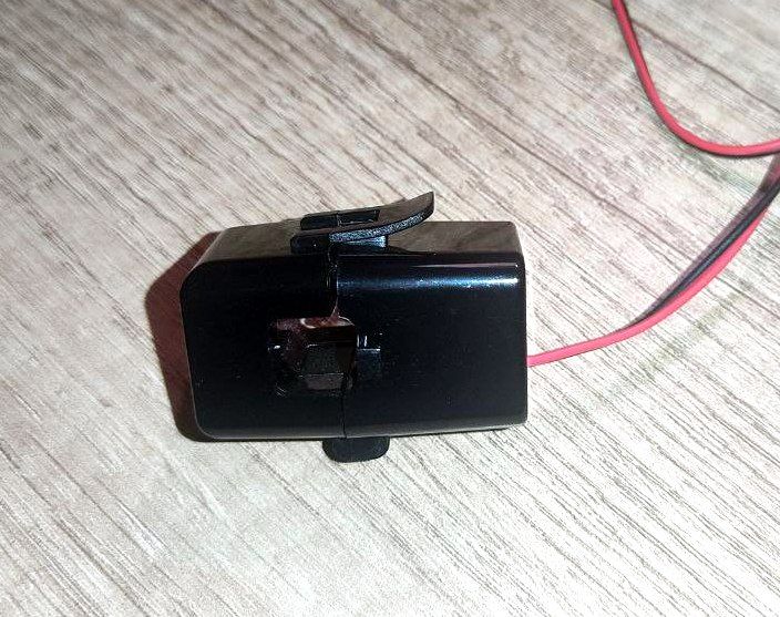

  • Inverted clamp caused incorrect current readings
    #104 21050425
    snkbrzmir4
    Level 4  
    Posts: 7
    Thank you for your feedback, after I thought a little I realized that the clamp can be placed in 2 positions and if I was measuring wrong I had placed it inverted, my fault, I apologize for this error. Regarding sending in a shorter time, it does not seem to be possible, the measurement only comes every 10 seconds, even using the tuyaMcu_sendQueryState command it only responds every 10 seconds. But I saw that the shellyEM that I'm wanting to replace and has a problem and measures incorrectly, sends more than 10s, so it's better than the shelly. Thank you for the help, I'll put names on all the channels and put the second clamp and generate a template to contribute to this at least :)

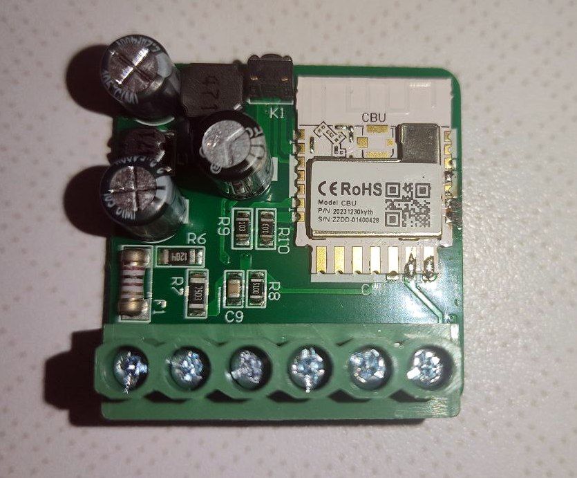

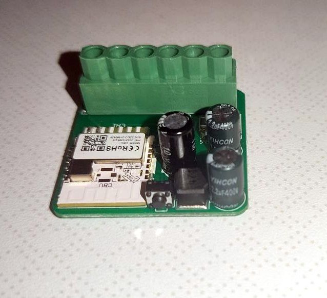

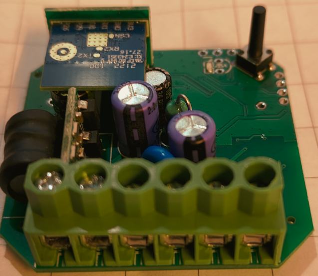

  • Dual BL0942 chips on separate UARTs identified
    #106 21050660
    bf1648
    Level 4  
    Here is a photo of my "Double Digital Meter" that I asked about above.
    Dual-channel single-phase clamp with Wi-Fi for current measurement. Image of a printed circuit board with electronic components. Photo of an electronic module with several capacitors and components soldered onto a circuit board. Image of a dual digital meter with visible capacitors and a Wi-Fi module on a green PCB. Black plastic sensor with a red wire on a wooden surface.
    Added after 4 [minutes]:
    p.kaczmarek2, can you help me with the firmware modification?
    Added after 7 [minutes]:
    One bl0942 is soldered to UART_TX1, UART_RX1 (pin 15, 16). The second bl0942 is soldered to UART_TX 2, UART_RX2 (pin 6, 7).
    wi-fi led on P9
  • #108 21108761

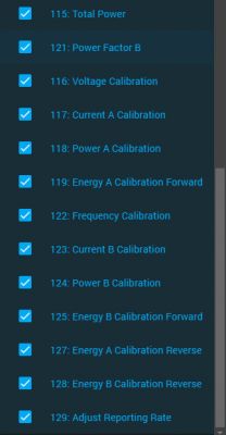

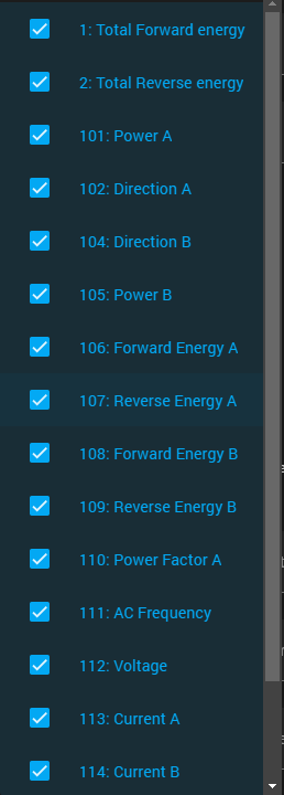

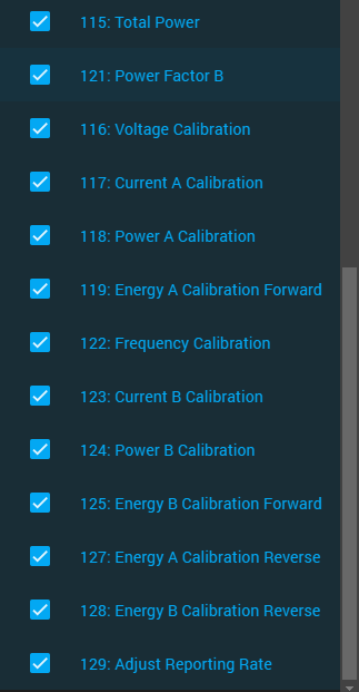

    Working TuyaMCU channel mapping and calibration setup
    #116 21114187
    erdeidominik1999
    Posts: 47
    I will try to check that, but in a meantime, have you tried to use the command to send dpID value directly?
    Okay, I think I made everything working, the total values, the calibration, and the update frequency also works. This is my autoexec.bat:

    I found the attached images, and the dps were correct.

    I found a problem, the EnergyTotal needs div 100 not div 1000, but the openbk has only EnergyTotal_kWh_div1000.
  • #120 21115933
    Posts: 14791
    Rate: 12937
    You can now add a custom mult while linking dpID to channel:
    Excerpt from technical documentation with syntax examples and links.
