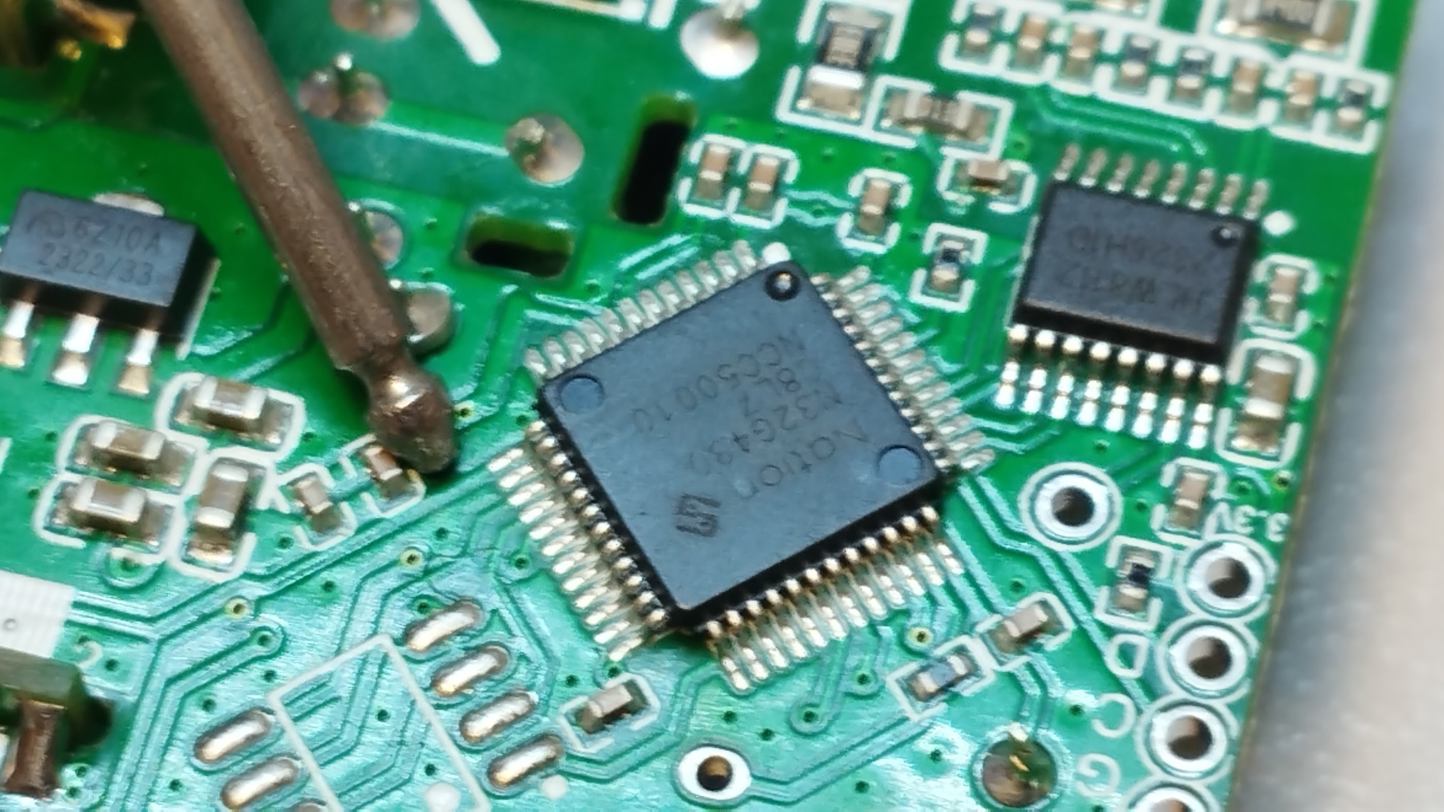

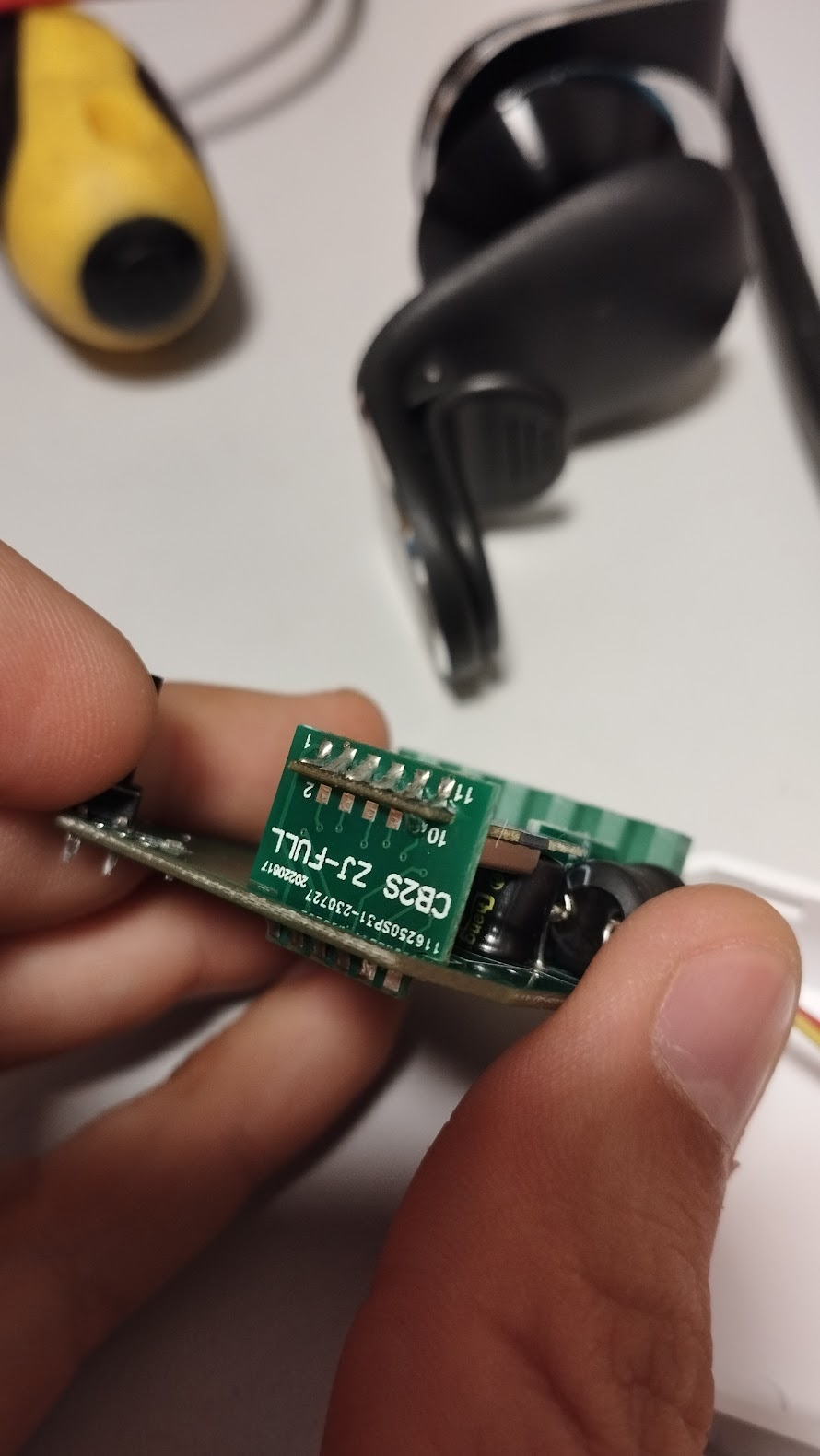

    CEN is soldered.
    Close-up of a hand holding a circuit board with an attached chip.

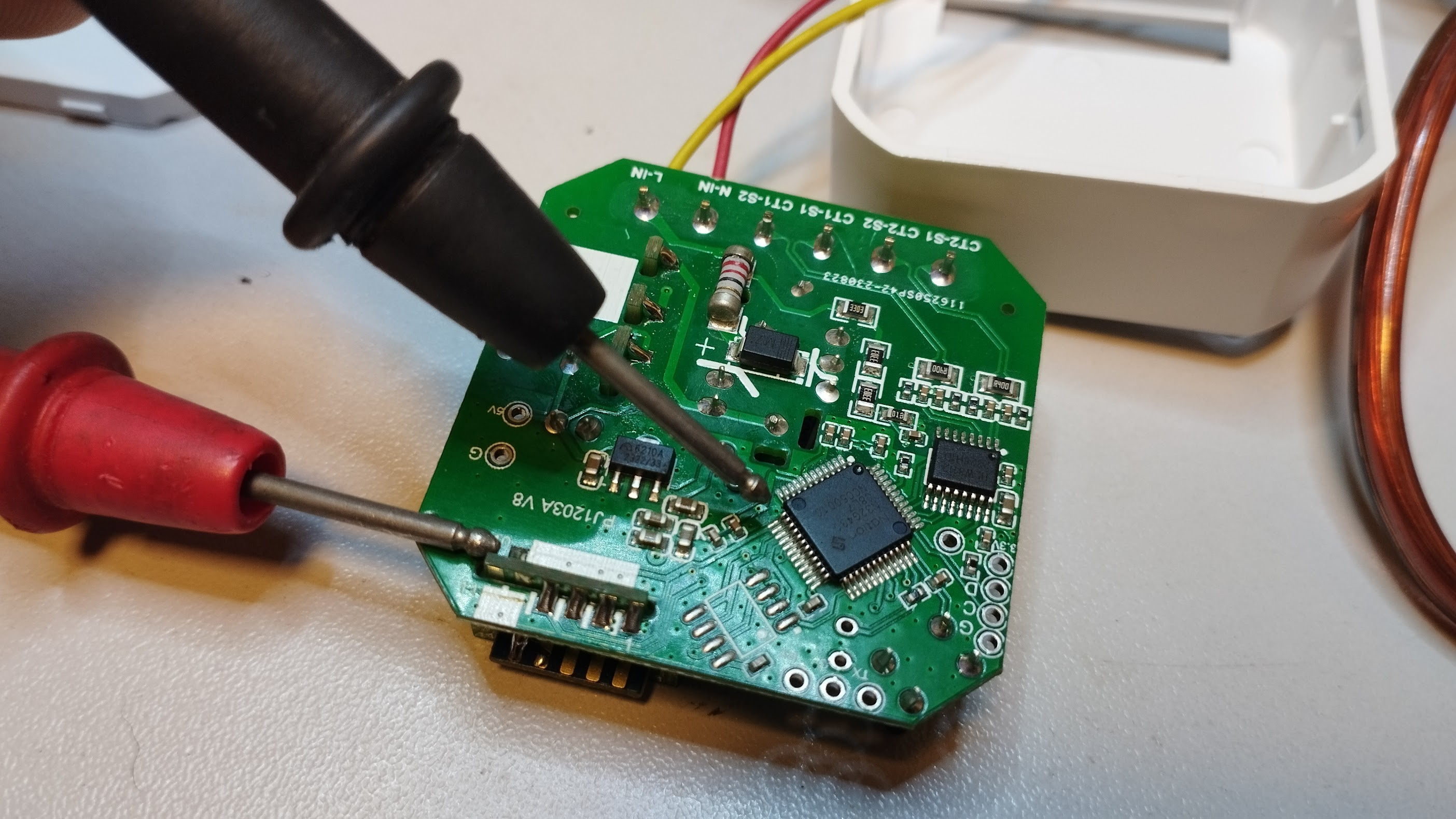

    After pin, I noticed that it goes to the MCU.
    Close-up of a circuit board with a probe touching one of its components.
    Microcontroller being soldered onto a green circuit board with visible traces and components.
  • #63 20847102
    Posts: 14791
    Rate: 12937
    So MCU may reset WiFi module if something is wrong.
    Now, the question is, what could wrong?
    Was TuyaMCU communication working for you?|
    Maybe it never worked in the first place and you need to remove baud setting:
    tuyaMcu_setBaudRate 115200
    maybe remove the line above and retry? Did you get any TuyaMCU packets in the Web App log when testing?

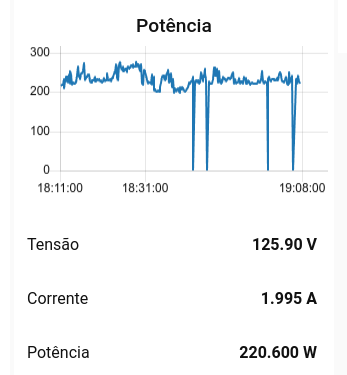

    Another question. Why does it go randomly to zero? I can't see any apparent reason. Is that normal or maybe the MCU is resetting?
    Graph showing power fluctuations over time with sudden drops to zero.
  • Suggests using Tuya DP queries and checking zero readings in logs
    #84 20851651
    Posts: 14791
    Rate: 12937
    thalesmaia wrote:
    I have no idea. I will just post-process it.
    Well. if you have unflashed device, you could do this:
    https://www.zigbee2mqtt.io/advanced/support-new-devices/03_find_tuya_data_points.html
    or just use tuyaMcu_sendQueryState in OBK, see which dpIDs are not mapped yet, write down their values, and try setting them with tuyaMcu_sendState. Just remember to restore the old value in case that something unexpected happens.

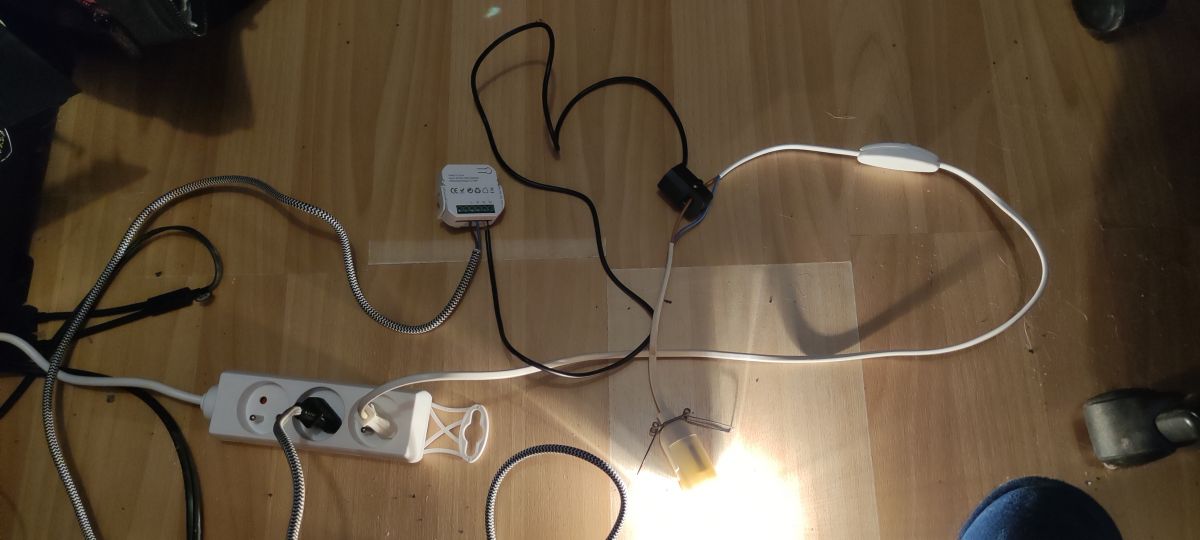

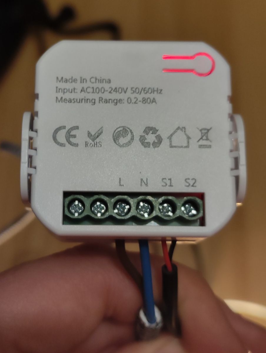

    Here are the photos of the model of my device and my electrical assembly:
    Close-up of an energy monitoring module with wire connections. Electrical circuit with an energy monitoring module connected to a power strip on the floor.
    Another question (for beginners), can we go back and install the official firmware of the device (that of the manufacturer)? If so, where to get it and how to install it?
    Thank you in advance for your invaluable help.
  • #86 20882289
    thalesmaia
    Posts: 17
    dpId in your log is the variable that refers to something, like current, voltage, power, and so on.
    You can copy my configuration above and change your dpId.
  • Question about adjusting consumption measurement frequency
    #87 20882488
    tony059560
    Level 4  
    Posts: 6
    Thank you very much for your remark about the low consumption of my bulb... Indeed, as it only consumes 16 watts, the clamp did not detect anything... So I used a 60 Watt bulb and there I obtained many values for dpID 18 and 19!
    Do you know if we can adjust the consumption measurement frequency? Currently, I only get values when I turn my bulb on or when I turn it off.
    Thank you again for your help.
