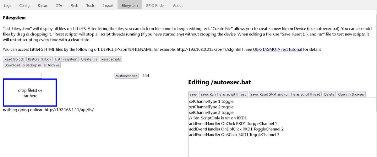

    Got it, didn't know this has to be done by autoexec.bat, thought changes had to be done inside the firmware or via "app".
    I tried
    "Question: How do I setup single button to control two relays (first on click, second on double click)?
    A: If you set a pin role to 'Button', you will get a second textbox after saving pins. First checkbox is a channel to toggle on single click, and second textbox is a channel to toggle on double click."
    under
    Web Application, Pin Settings:
    Here you can configure your device. "
    Could not find 'Button' in the drop down list (is it Btn??)
    Even Btn did not offer the toggle, just numbers.
    Since the switch of this unit is at RXD1
    https://www.elektroda.com/rtvforum/topic3958242.html#20836512
    would this be correct?
    setChannelType 1 toggle
    setChannelType 2 toggle
    setChannelType 3 toggle
    // Btn_ScriptOnly is set on RXD1
    addEventHandler OnClick RXD1 ToggleChannel 1
    addEventHandler OnDblClick RXD1 ToggleChannel 2
    addEventHandler On3Click RXD1 ToggleChannel 3

    Tried
    didn't work, bummer (did reboot etc)
    View of script editor in autoexec.bat file with button configuration on a device.
    Tried USART_ , nogo
    Looked up what pin RXD1 is (10)
    used this:
    // Btn_ScriptOnly is set on 10
    addEventHandler OnClick 10 ToggleChannel 1
    addEventHandler OnDblClick 10 ToggleChannel 2
    addEventHandler On3Click 10 ToggleChannel 3
    Now:
    1 click does nothing (there is a faint click, as if one of the relays wants to turn on but is stopped right immediately)
    when on, 1 click turns all off,
    2 clicks turn all on,
    2 clicks turn all off,
    3 clicks turn 3 on,
    3 clicks turn 3 off
    What am I doing wrong here?

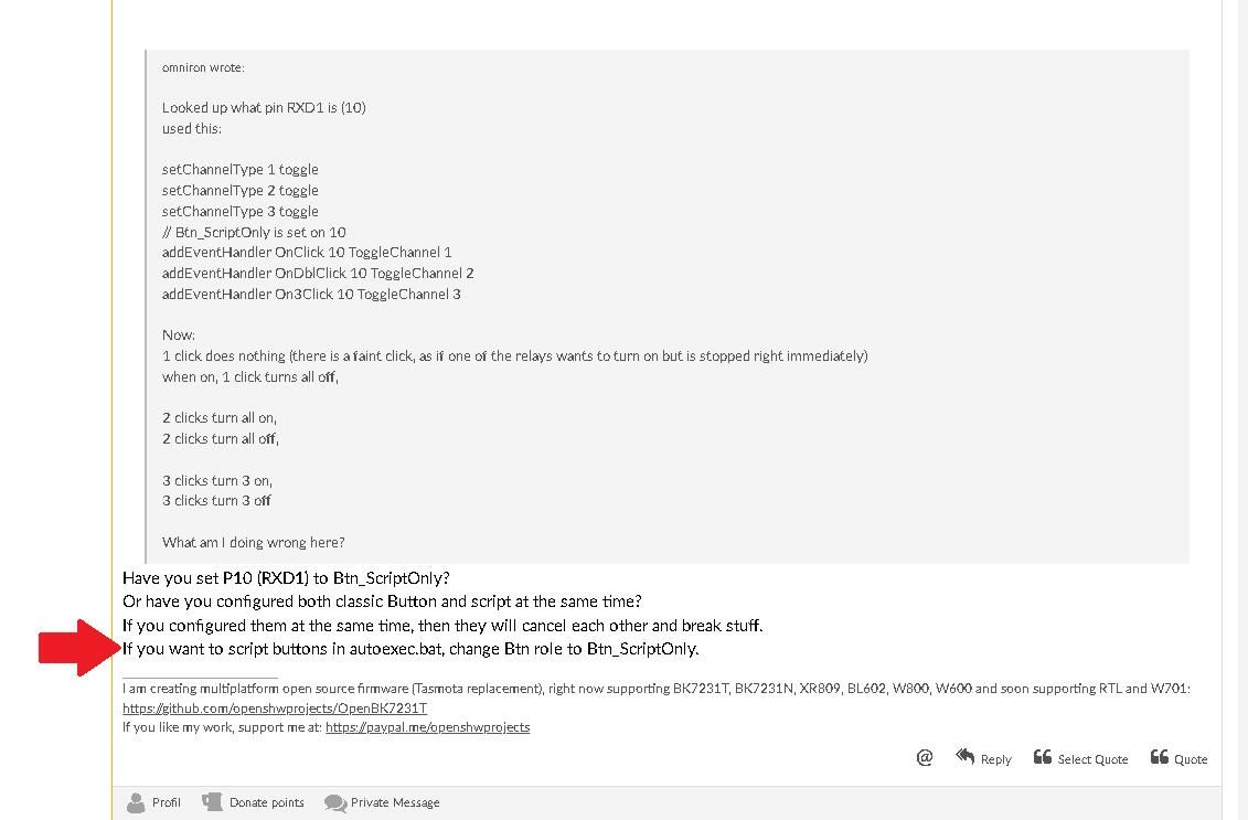

    under
    Btn, once saved, will show two text fields, where you can enter indexes of first and second channel.
    This will not work because command expects a P index, so it should be a number. Look up RXD1 in documentation to know which Px is it. Write P index in script without P.
    used this:
    Now:
    3 clicks turn 3 on,
    3 clicks turn 3 off
    Have you set P10 (RXD1) to Btn_ScriptOnly?
    Or have you configured both classic Button and script at the same time?
    If you configured them at the same time, then they will cancel each other and break stuff.
    If you want to script buttons in autoexec.bat, change Btn role to Btn_ScriptOnly.

    THAT was it!
    Screenshot showing sample script code and part of a conversation on a tech forum.
    I just added the autoexec.bat like you suggested, didn't know about scripts or btn script only stuff.
    Probably buried in some documentation, sorry.
    Thank you again!

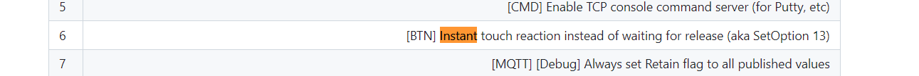

    First of all, do you have "instant button reaction" flag enabled? This will break double click event, etc.

    I did not set that instant button flag because you informed me:
    It's a known problem, you can make button react faster but it will break click and double click events.

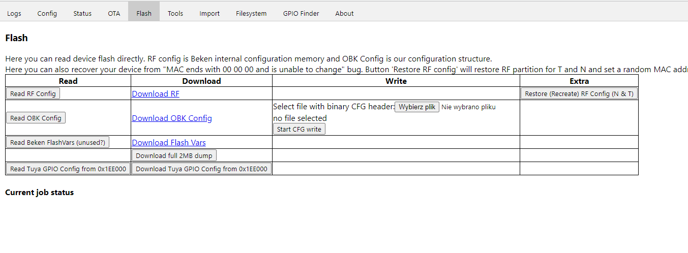

    I had tried to save the current condition/settings, how do I do that?
    It says
    It is better to just download only config partition and LittleFS TAR
    but could not find a "config partition" or "LittleFS TAR", sorry.
  • #39 20850767
    Posts: 14791
    Rate: 12937

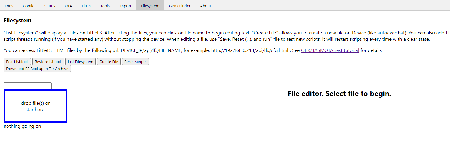

    It's in the web app:
    Screenshot of the Flash section in a web application with various options for reading, downloading, and writing device configurations.
    Screenshot of a web application filesystem interface with file management buttons.

    Yes, I checked that of course, there is no config partition, just a read RF config and OBK config.
    Considering that I did not configure the switch timing, I think the OBK config is useless?
    And it probably has nothing to do with RF config?
    Should I zip the contens of OBK config?
    Or is the config partition here: "read tuya GPIO config from 0X1EE000"?

    Here are some Read + Download files from "flash" tab
    • flashfiles.zip (14.25 KB) You must be logged in to download this attachment.
  • #42 20852326
    Posts: 14791
    Rate: 12937
    Please edit the attachment and remove OBK config binary data. It contains your SSID and password. If you want to share template with other users, just go to Web App and copy JSON from there.
    OBK config data is useful if you are making a backup for yourself.
    and
    could work.
    So I thought we first need to remove the timing from the old setting to be able to use the new setting.
    Now I tried it with even longer times
    SetButtonTimes 6 4 4
    and that's close to the Tasmota settings of my other switches.
    Here is the autoexec.bat file:
    // this is for the dreaded tuya-chip version of the 30407T, version 1.17.334
    // you must change the switch (button) role for this to work
    // on your unit's webpage/IP, select "Launch web Application"
    // select "Config"
    // under "Pin Settings:"
    // find "10" and change "Btn_Tgl_All" to "Btn_ScriptOnly"
    // click "Save Pins" at the bottom
    // select "File System"
    // select "Creat File"
    // type "autoexec.bat" (depending on your browser confirm with "ok")
    // click on new "autoexec.bat"
    // copy and paste below and click "Save"
    // back at unit's webpage/IP, click "Restart"
    // new roles of the channels (relays)
    // switch (button) is at Pin 10
    // press, release and hold times to toggle relays via unit's switch (button)
    Thank you!

  • Need to save firmware, pin template, and autoexec together
    #51 20861781
    omniron
    Posts: 114
    It works!
    MAC was there, hooked up wireshark and it was requesting a weird DNS.
    Changed my router to that (public,hardwired) IP and was then able to reroute.
    Flashed to newest FW, added pins and Autoexec .
    Can all those items (FW, pin template and Autoexec) be saved/flashed in one go?
    Or do I have to make the changes one by one, for each 30407t?
    Thanks again for getting these tuya chip units to work with your fine software and help!!

Can I back up and clone a working configuration?
Yes. In Web-App → Flash → Download OBKConfig (JSON) and LittleFS.tar. Restore them on another unit after flashing the same .ug image. Do not copy RF partition; each plug needs its own MAC [Elektroda, p.kaczmarek2, post #20852326]
Is it possible to flash firmware, template and autoexec in one pass?
Not today. Flash the .ug image first, then POST /upload for obkconfig.json and finally upload autoexec.bat. Batch support is on the OpenBeken roadmap (Q2-2025) [OpenBK Issue #642].
