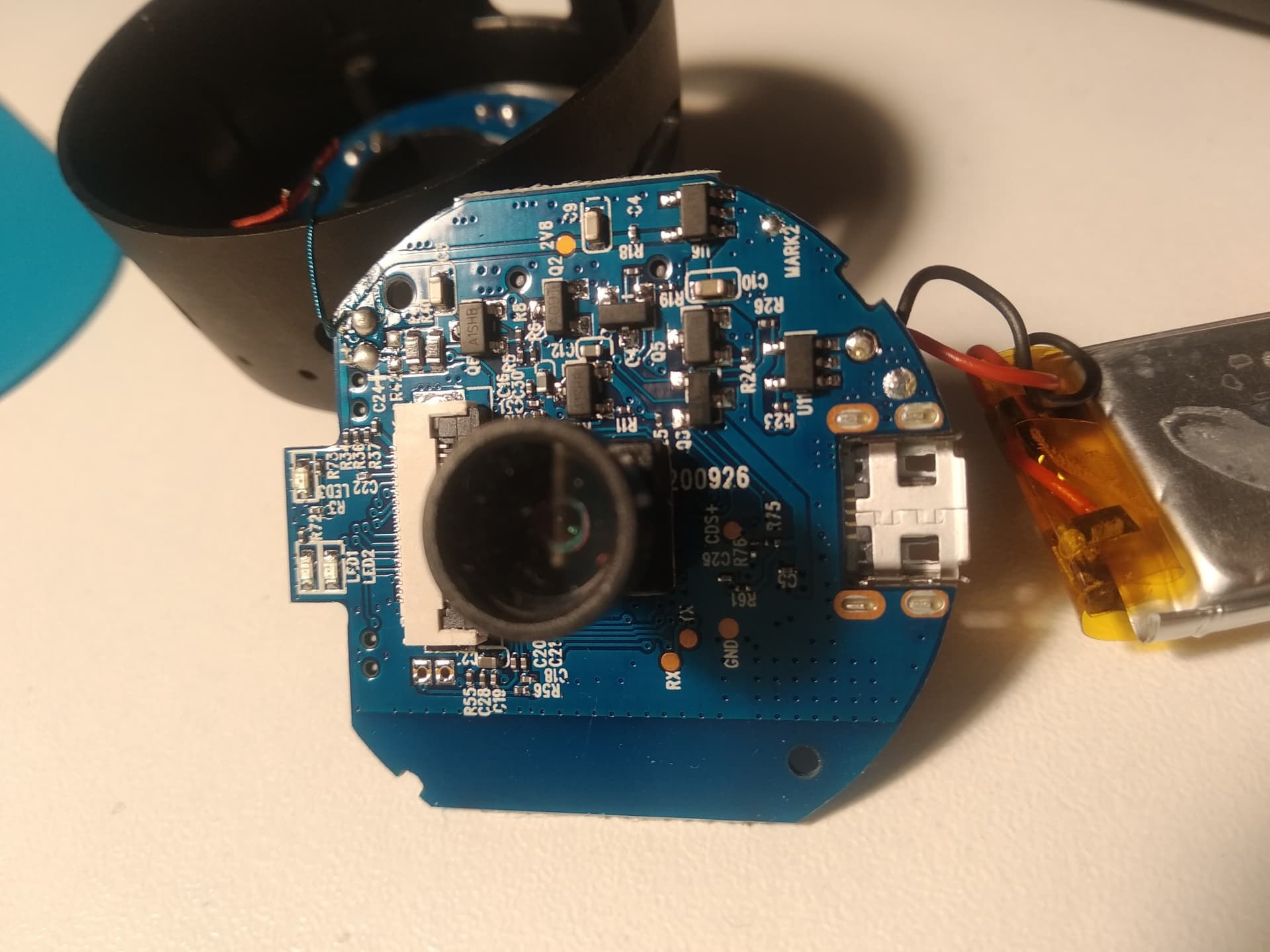

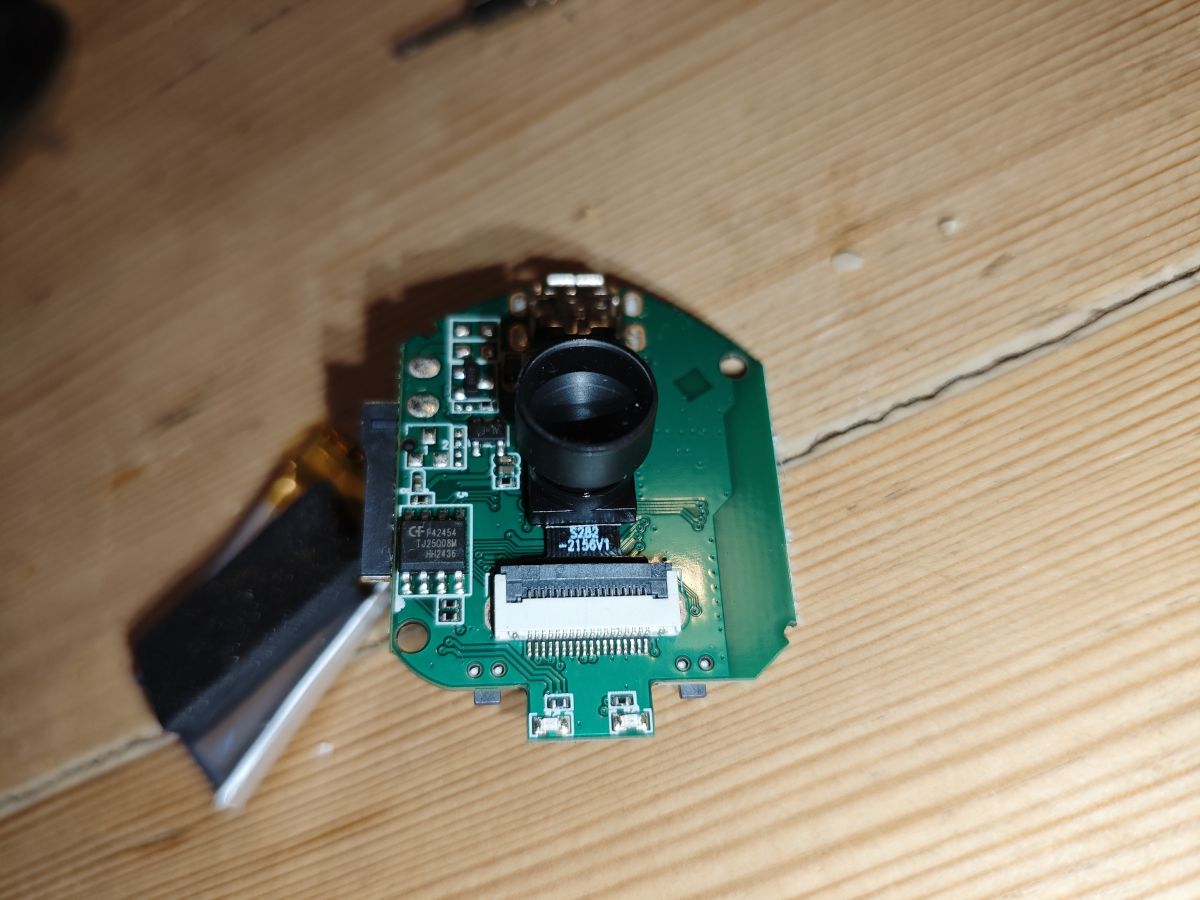

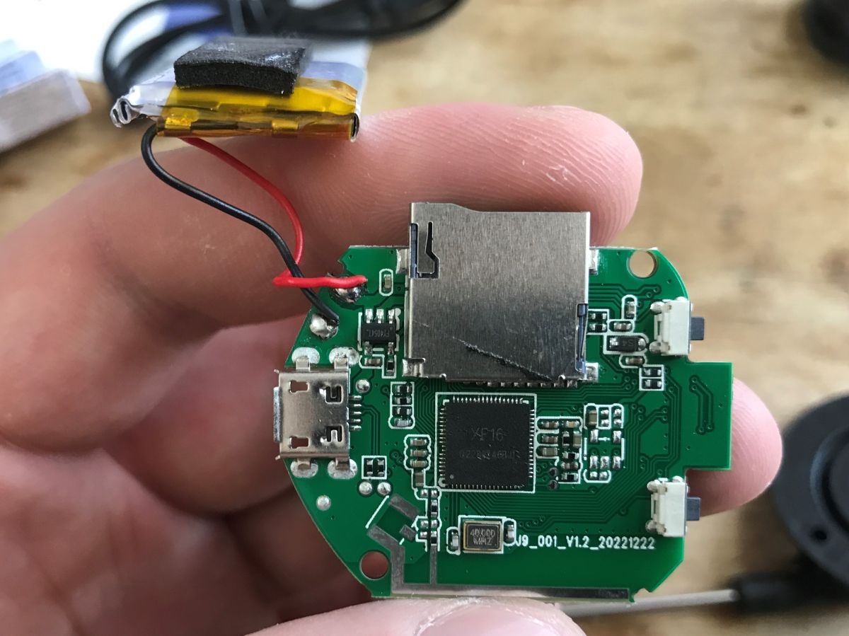

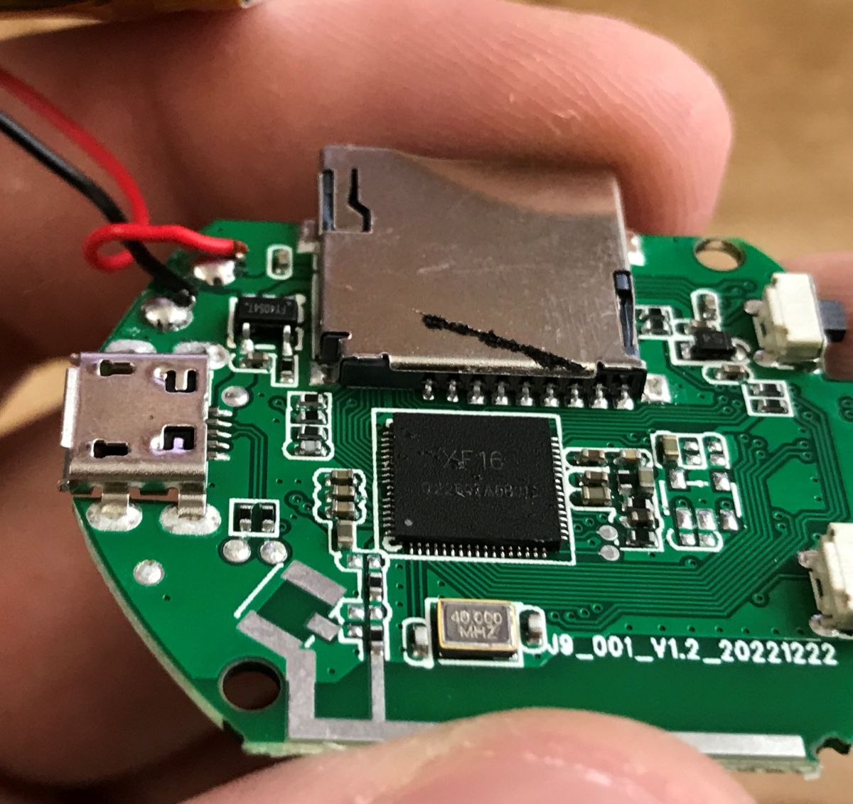

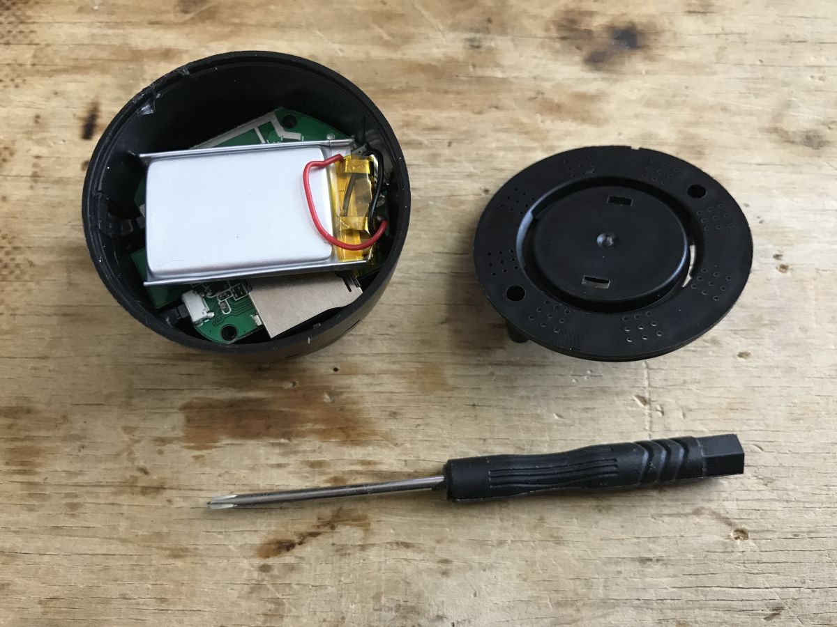

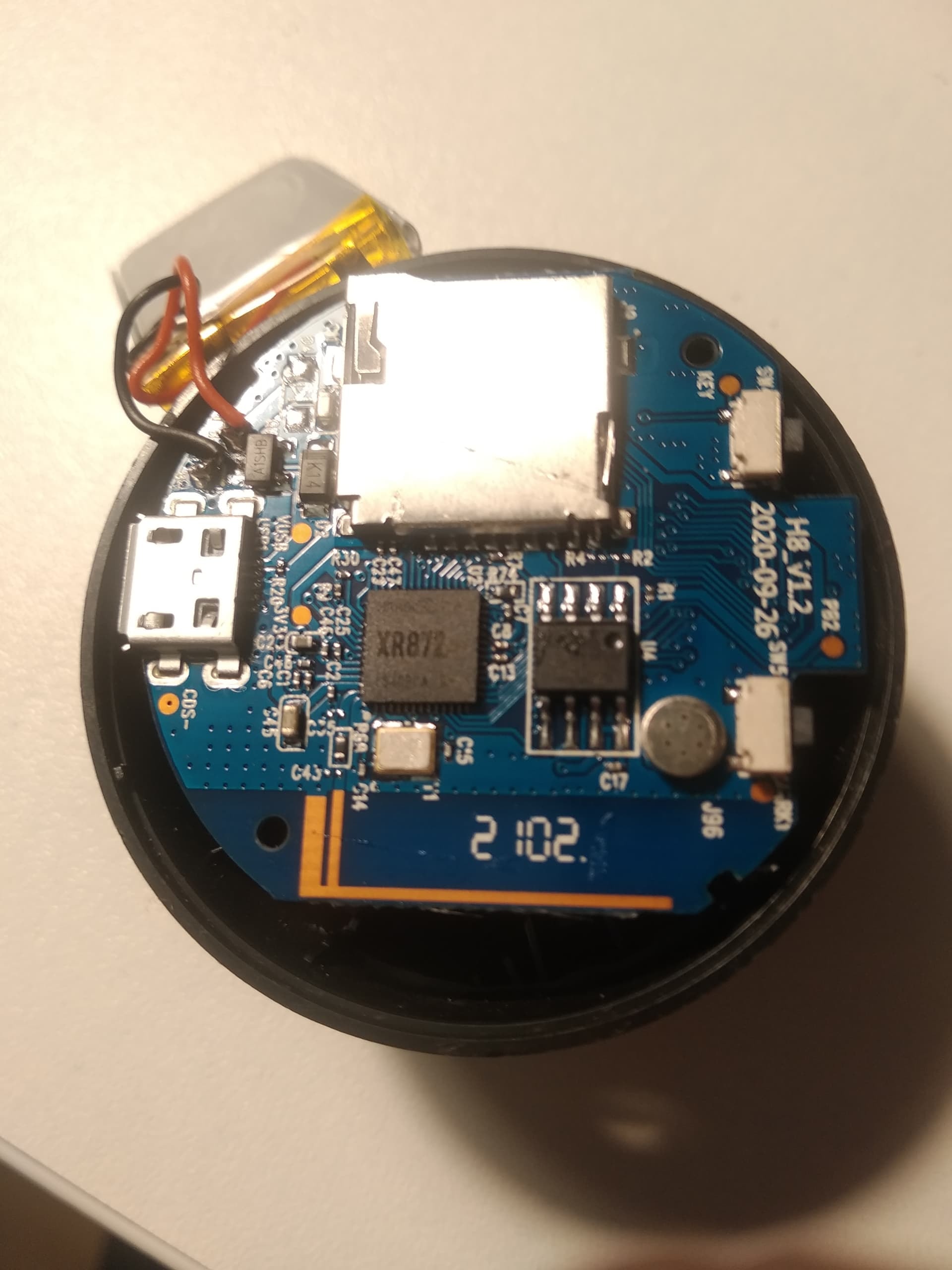

    I got another one. I tried to get BK7252 but sadly got again the same model.

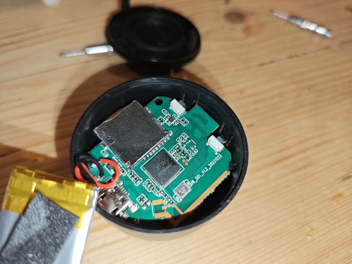

    PCB with microSD slot, micro USB port, battery and flash chip labeled XF16 Opened electronic device with exposed battery and small screwdriver on wooden surface Wi-Fi mini camera with USB cable, mount, and manuals on wooden surface A9 IP camera box with device image and function icons on wooden surface.
    Testing...

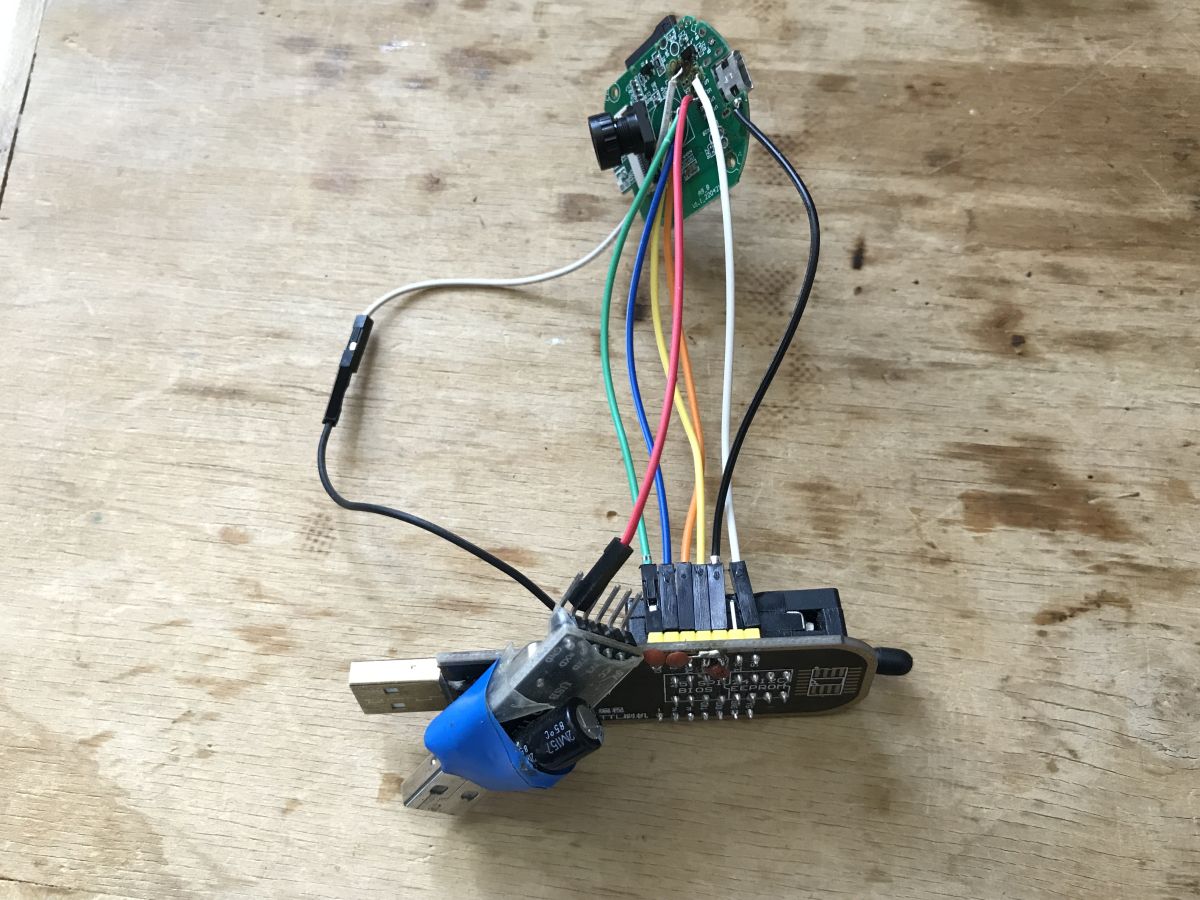

    SPI programmer connected to a circuit board with colored wires on a wooden workspace Camera module on PCB with lens and ribbon cable connector visible Close-up of PCB with flash chip C74014 and flat ribbon connector Close-up of a PCB with XF16 chip, microSD slot, and micro USB port

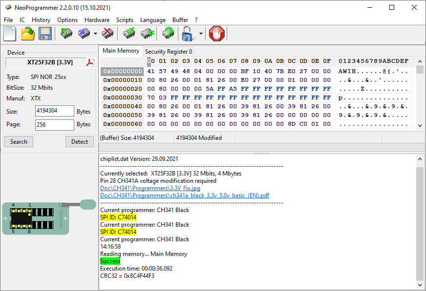

    C74014 flash id
    Screenshot of NeoProgrammer showing XT25F32B flash memory and hexadecimal data

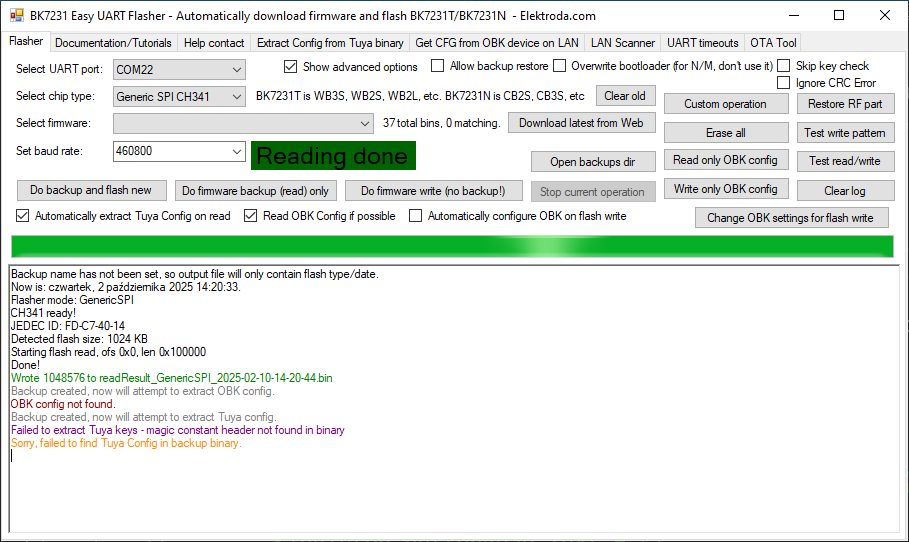

    NeoProgrammer can read it, EasyFlasher can read as well:
    Screenshot of Easy UART Flasher showing “Reading done” message for chip C74014
    However, both NeoProgrammer and EasyFlasher have issues with erase/write for this memory (C74014 ).

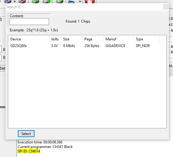

    That being said, they both work OK for, for example, for GD25Q80x:
    Screenshot of software showing detected GD25Q80x flash chip with SPI ID: C84014
    https://github.com/openshwprojects/FlashDumps/commit/51e1382e7e3a1e353d60ac216a55df3039f6dcae
    Backups works after flash back to other SPI chip.

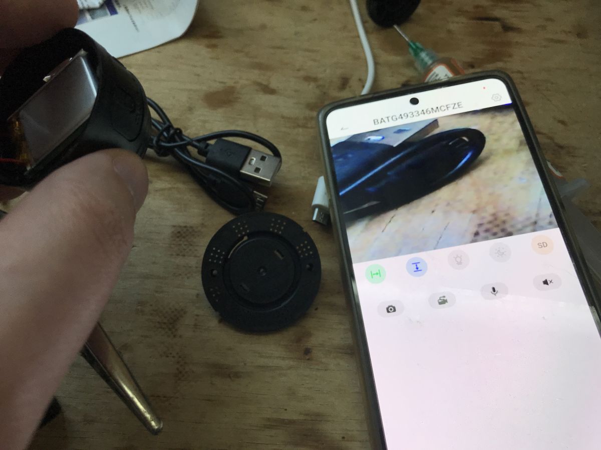

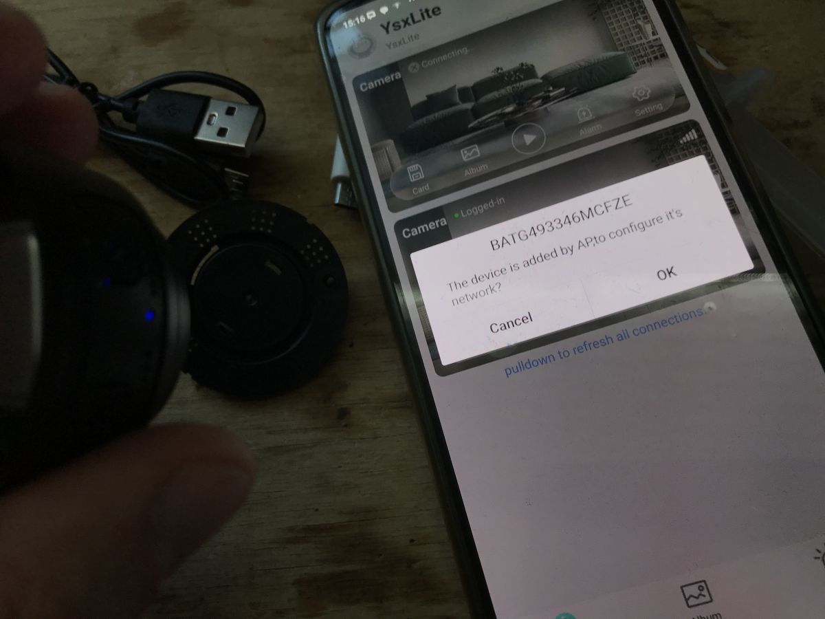

    Screenshot showing Wi-Fi network name BATG493346MCFZE
    Inspection camera connected to smartphone, electronic components on wooden desk
    Smartphone showing YSX Lite app with pop-up to configure Wi-Fi camera connection
    Open question: Why this particular flash chip is so problematic to flash in both NeoProgrammer and our EasyFlasher? @divadiow @insmod @max4elektroda
    I will try to order another A9 shortly, or maybe try doorbell...

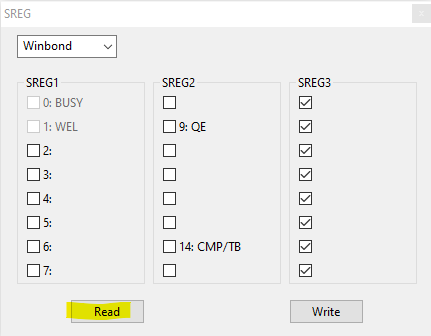

    A related (?) note, I find the Tuya doorbell needs additional unprotection steps before it can be written to. No Neo toggling is enough. I use ASProgrammer SREG read, untick the SREG2/3 checkboxes (I have highlighted the ones I think are usually checked) then click write. Switch back to Neo after that and writing is fine again.

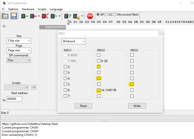

    AsProgrammer window with SREG settings for a Winbond chip displayed
    It's *possible* this wasn't the case when it first shipped and I did something to it. I'm not sure. Dunno if this relates, or is even something we may generally encounter and should be considered when troubleshooting SPI flasher function in EF.
    oh look. seems the Naxclow was the same
    divadiow wrote:
    SREG2 and SREG3 checkboxes required unticking in AsProgrammer before flash could be erased/written

    I did my tests with desoldered SPI.
    I will try with AsProgrammer, especially that we need to port their solution to our Easy Flasher.

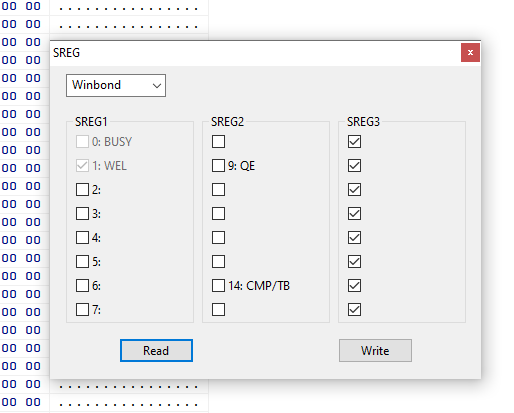

    Added after 55 [minutes]:
    If I untick them, press Write, and Read, I got back again this:
    SREG settings window with WEL checked and all SREG3 boxes selected
    Info about used flash chip:
    ID(9F): C74014(Unknown)
    ID(90): C713(Unknown)
    ID(AB): 13(Unknown)
    ID(15): FFFF(Unknown)

    yes, I think I remember similar if reading back. Did it make a difference to Neo writing though straight after write in AS?
  • #246 21707992
    Posts: 14580
    Help: 654
    Rate: 12604
    I don't think so, but I may need to try one more time to be sure.

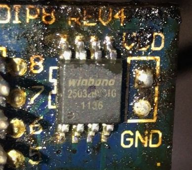

    Right now I am testing another flash chip with EF :
    JEDEC ID: FF-EF-40-16
    Detected flash size: 4096 KB
    Winbond 25032FVSIG chip on a PCB marked with GND and LED
    It seems to work... so we only have problems like NeoProgrammer and other flash tools, with some problematic flash chips

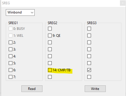

    had to uncheck this one just now for Naxclow. Neo wouldn't write otherwise
    Application window showing SREG settings for Winbond memory chip

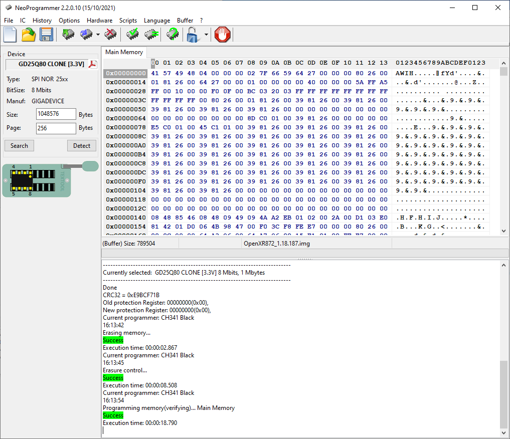

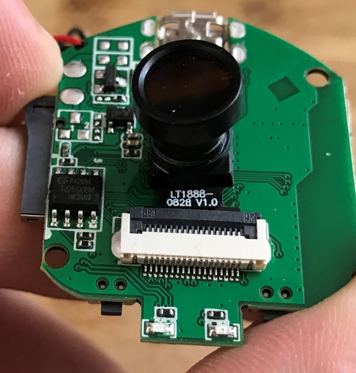

    Hm let's try from the start.
    Do you have this chip? The one from A9?
    C74014 - TJ25Q08M

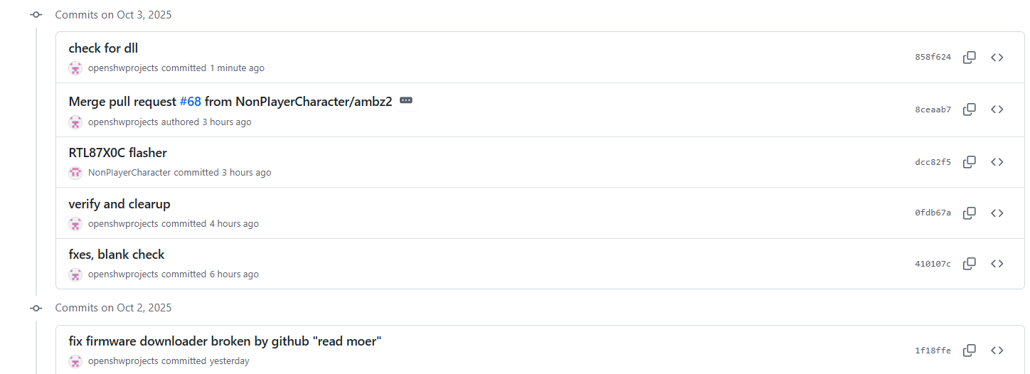

    Please check this out once you have some free time, I'm pushing fixes and features for SPI in EF but any help is welcome.
    Commit list from October 2–3, 2025 in a GitHub open-source repository

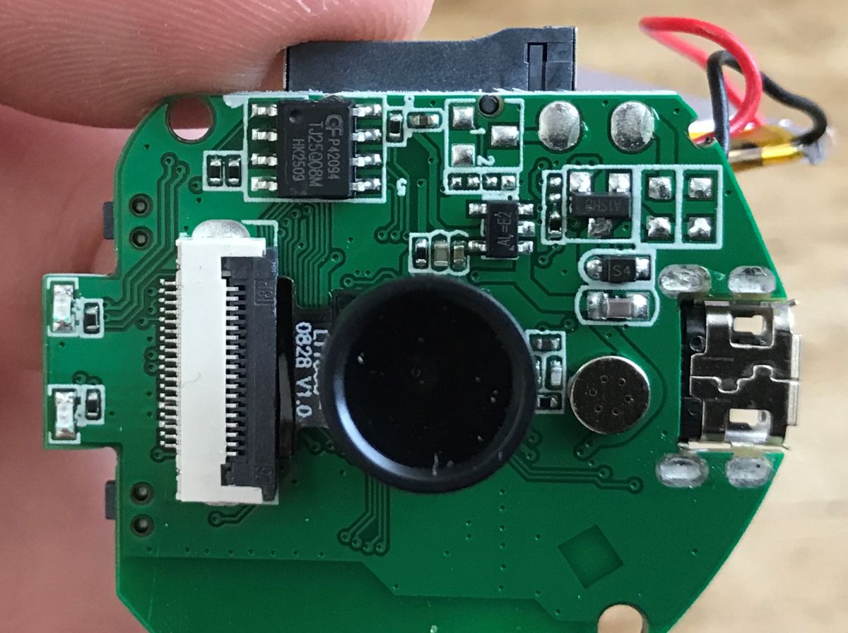

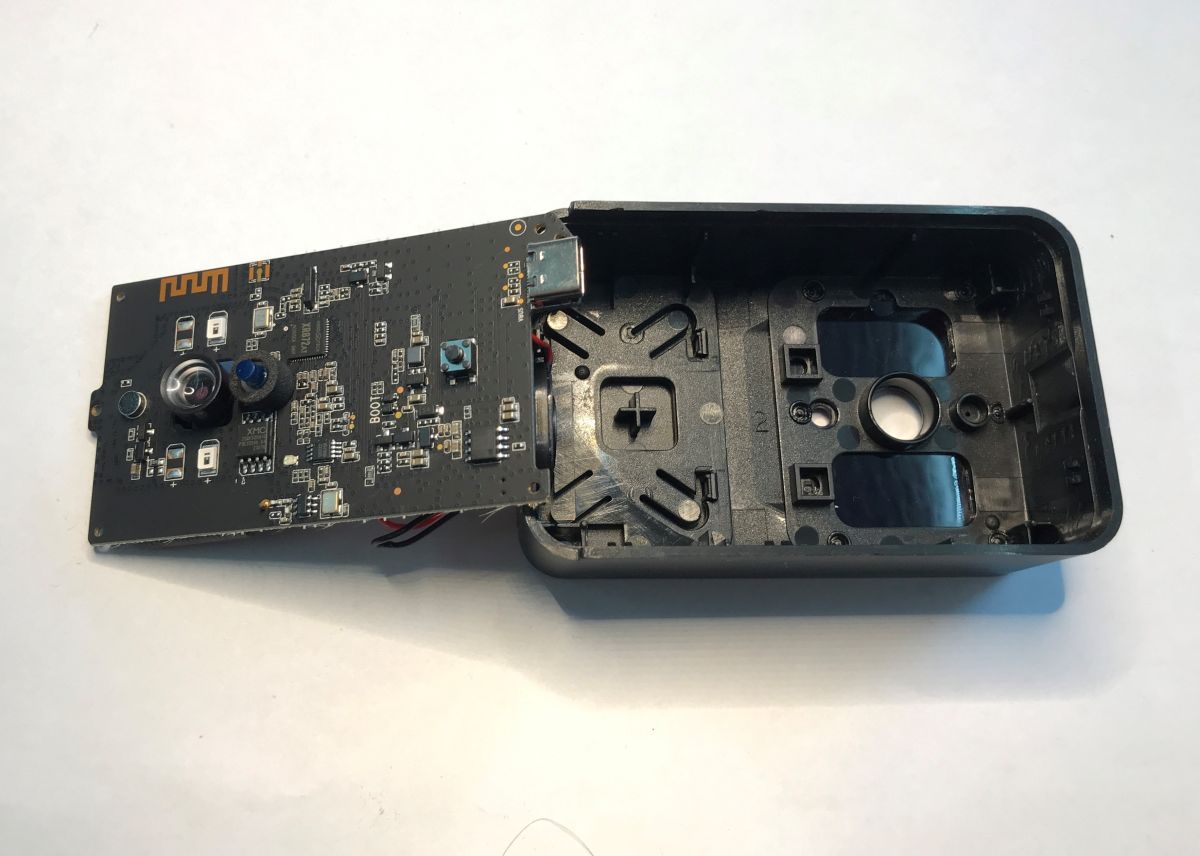

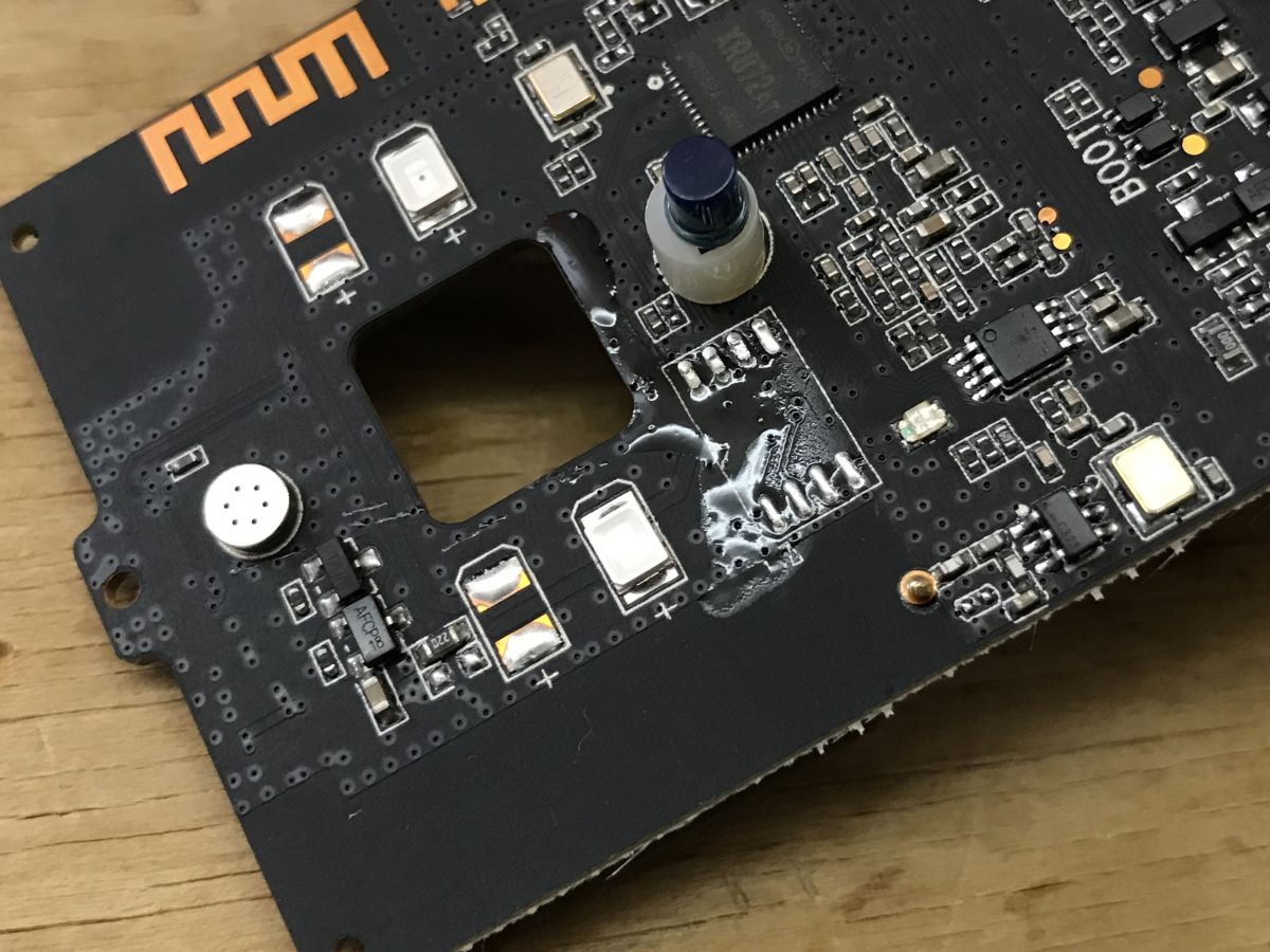

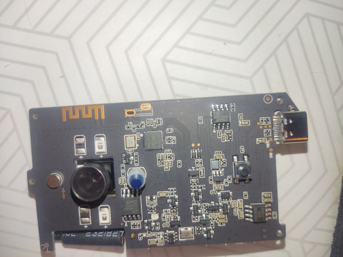

    Just opened this. Another XF16. Sp0828? Unsure yet
    Circuit board with a camera lens module on a wooden surfaceDismantled small electronic device showing circuit board and battery

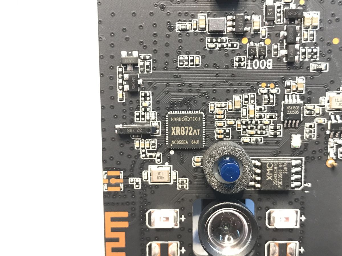

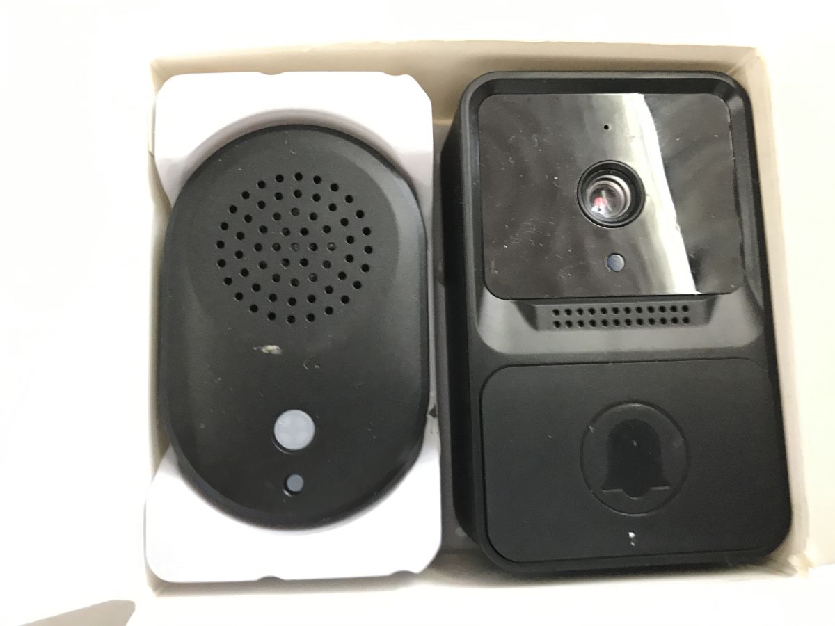

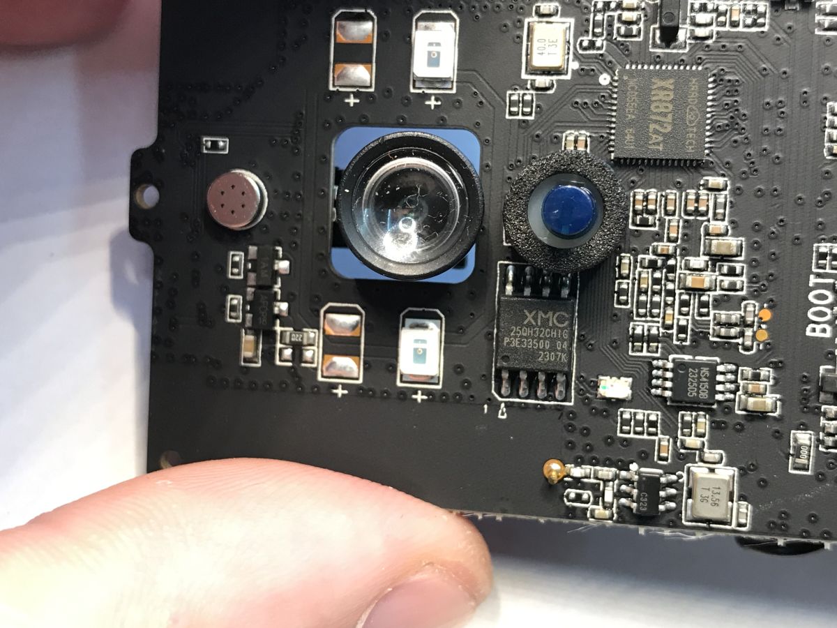

    I've ordered a Tuya Doorbell. expected to get something like this:
    https://www.elektroda.com/rtvforum/topic4073760.html
    but I got:
    Two black devices: video doorbell and speaker module in cardboard box PCB with camera and electronics inside doorbell housing
    Close-up of PCB with XR872AT chipset and XMC 25QH32CHIG SPI flash Close-up of PCB with camera lens, microphone, and XR872AT and XMC 25QH32CHIG chips
    Mode T2Kement
    https://github.com/openshwprojects/FlashDumps/commit/768e0579705c83a9970465517f7983f7f14a4fc8
    In flash dumps, I can see Kement_Doorbell_SPI-insmod.bin, what's that, did you have this device, @insmod ?
    Added after 29 [seconds]:
    XR872AT and 25QH32CHIG
    Added after 4 [minutes]:
    SPI ID: 204016
    Can't erase it with NeoProgrammer.
    Old protection Register: 00000000(0x00),
    New protection Register: 00000000(0x00),
    Current programmer: CH341 Black
    15:10:25
    Erasing memory...
    WARNING, probable erasure failure.
    Execution time: 00:00:00.057
    15:10:25
    Programming memory... Main Memory
    Success
    Execution time: 00:00:13.963

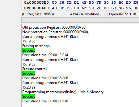

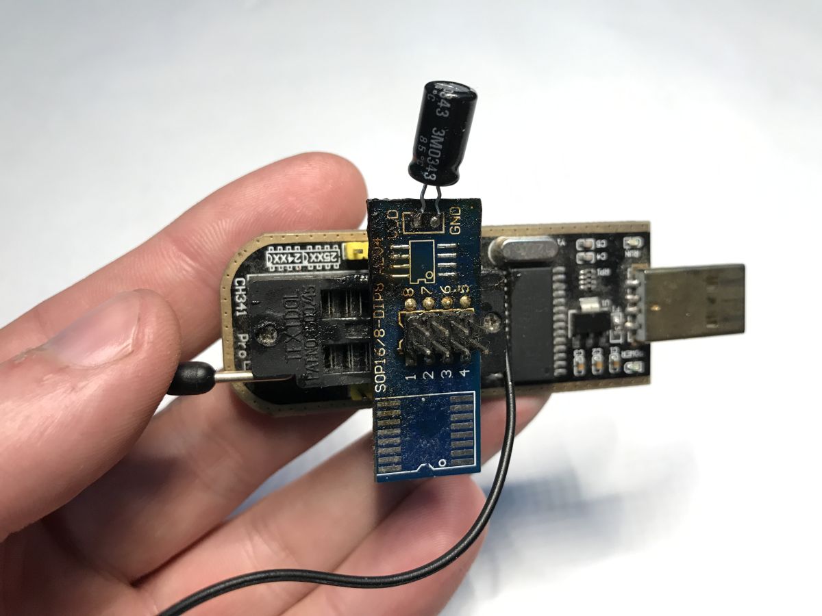

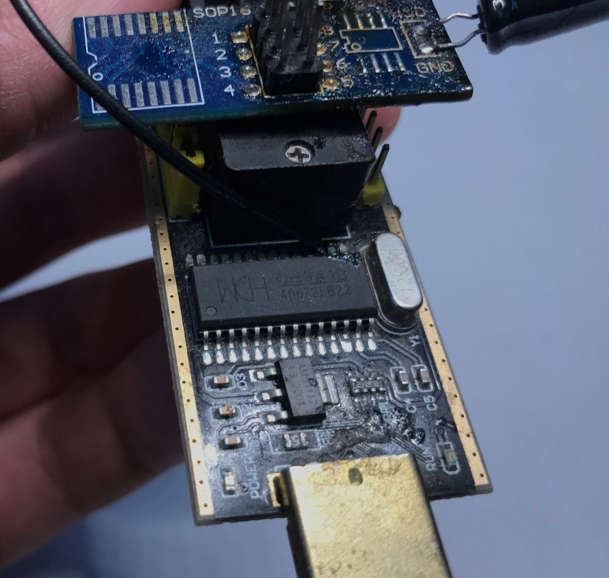

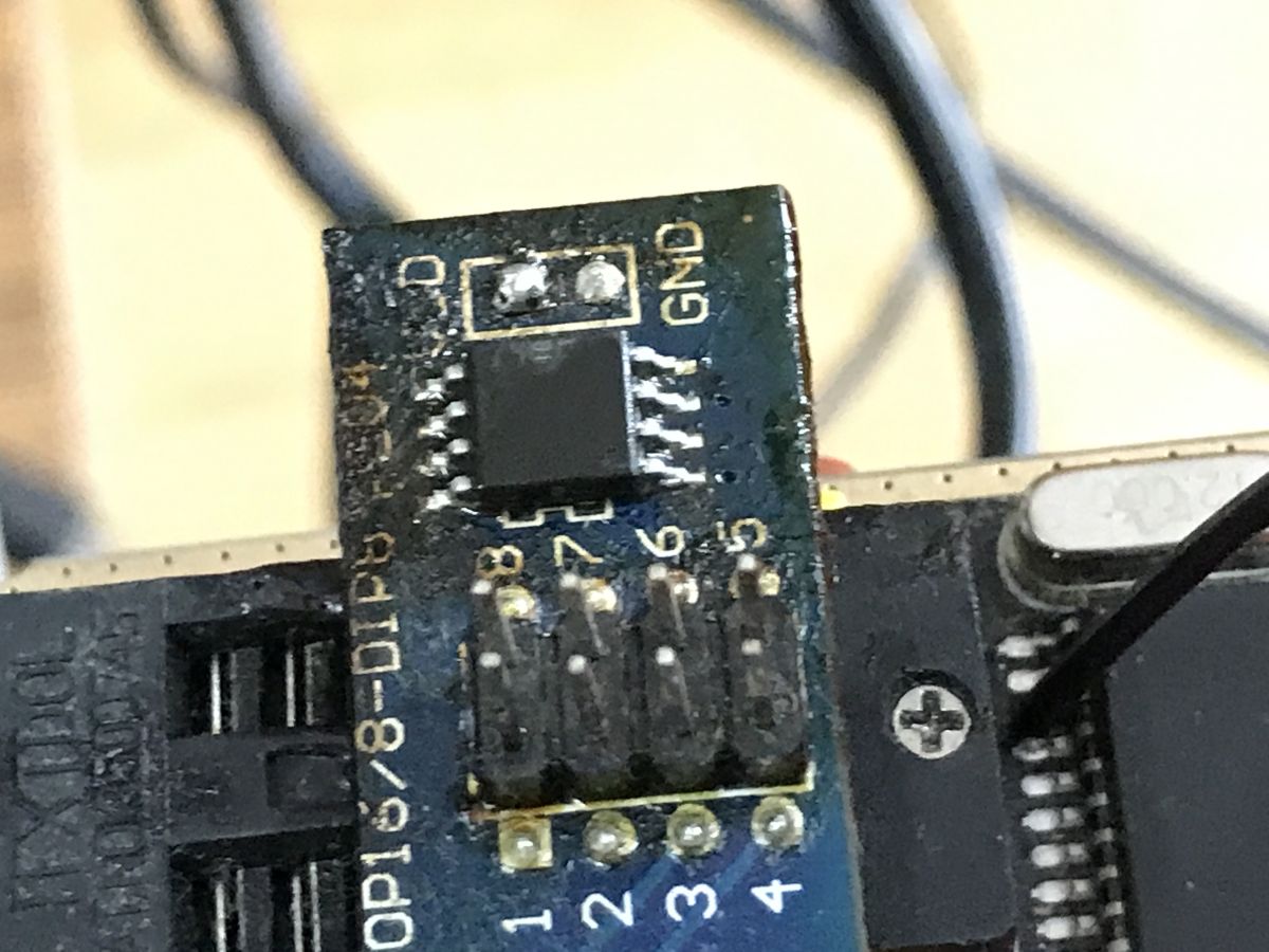

    You know what's crazy? It failed to erase and write, but when I now verify it against original dump, it shows verification errors as well. It's like... there is some noise or timing mismatch. Again.
    Added after 31 [seconds]:
    And, of course, I am flashing outside circuit!

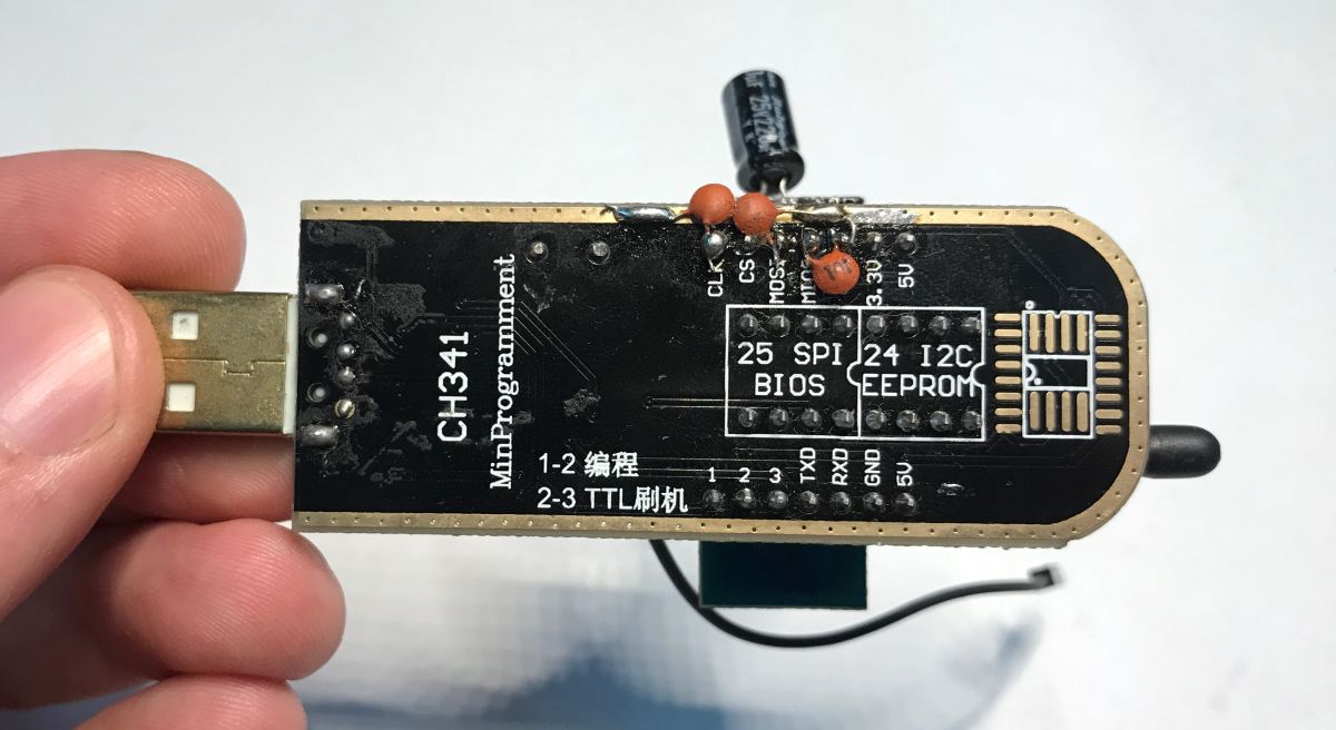

    I think I will retry with my capacitors trick:
    https://www.elektroda.com/rtvforum/topic4074636-30.html#21522488
    For reference, here is how it fails now:
    Close-up of a PCB with SMD components and solder flux residue Close-up of an integrated circuit connected to a programmer with labeled pins and wires
    Verify memory...
    Verification error on address: 0x00000008, Device: 0x00, Buffer: 0xFC

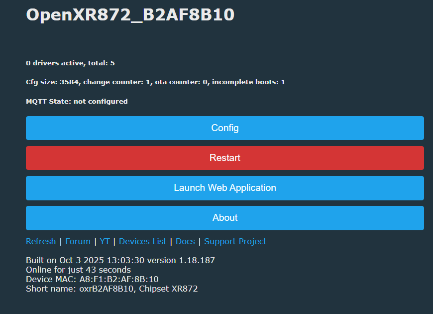

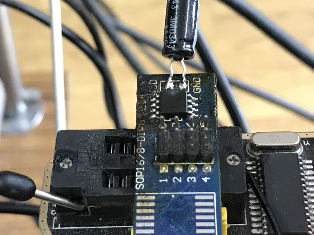

    I added a capacitor:
    Close-up of an electronic module with an added electrolytic capacitor.
    And it works now! I am very suprised. So it was.... an unstable vdd, for whole time? Again.
    Software window showing successful memory programming steps using CH341 Black.
    I really have no idea what's going on, but it looks like I ended up doing the same earlier in this topic, few pages ago back in the past. It really seems the trick is to add a capacitor.
    Wi-Fi network list showing selected OpenXR872_B2AF8B10 network
    Device interface screen for OpenXR872 showing system info and control buttons
    I can also control red LED, but toggling futher pins crashes.

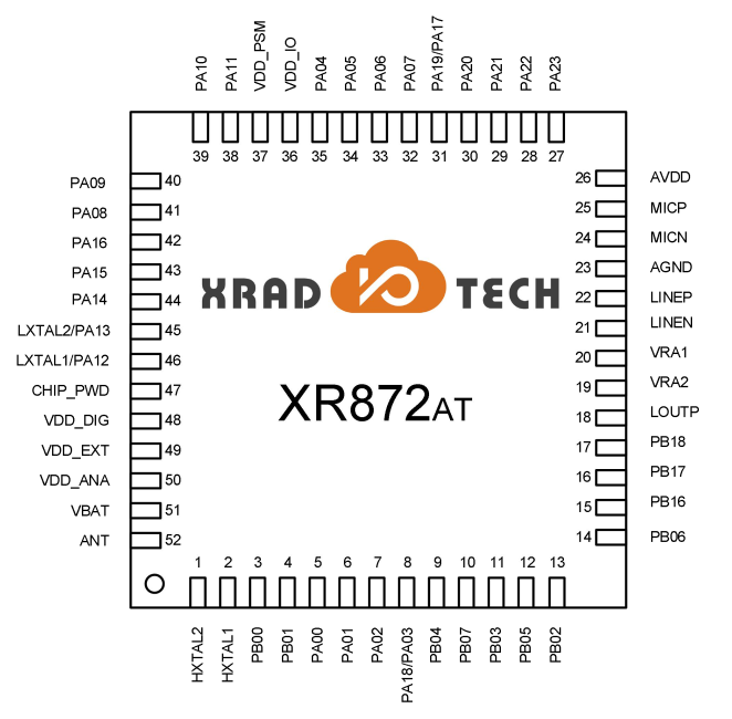

    I didn't determine yet which pin may be UART. Suggestions?
  • #259 21709870
    Posts: 5027
    Help: 438
    Rate: 891
    couldn't remember off the top of my head.
    PB00 - UART0_TX
    PA07 - UART1_TX
    PA22 - UART2_TX
    Pinout diagram of XR872AT chip by XRAD Tech with labeled signal names

    Well, how hard for you is it to desolder that? For me it's like 15 seconds with my hot air station (review here: https://www.elektroda.pl/rtvforum/topic4042887.html ). If you can, it would be good to have a confirmation, whether you can flash it out of the box, or does toggling checkboxes help, or do you need a capacitor like me...
    It's funny, actually, because I already solved this problem with capacitor, like few pages back in this topic, but then we both forgot about it...

    divadiow wrote:
    am I still de-soldering that 1mb SPI chip or do you think the capacitor is the key, so case closed?
    before any writes:
    AsProgrammer
    Program window showing SREG register settings for Winbond memory
    no capacitor. try write OpenXR872, no SREG touched. Only unprotect in Neo menu (all write options selected as above)
    success first time. hmm
    NeoProgrammer window displaying EEPROM GD25Q80 memory dump
    USB programmer with SOIC8 adapter for 25XXX EEPROM on a workbench.
    Added after 3 [minutes]:
    after power cycles, 2 more writes have been OK. AS SREG reading has not changed
    I *think* I remember the same unprotect issues with this same chip before though. Did you ever clamp onto your one? Maybe the clamping on with chip in-situ initially messes something up? Dunno, guessing.

    I never used clamp this month. Both A9 camera from few days ago and the doorbell from today were straight up desoldered SPI chip onto the CH341, as you can see on my photos. Currently I think that unprotect bits have nothing to do with the issue, and it was a capacitor missing all along. It's just strange that other flash chips (the one I have from laptop motherboards, from TV boards, etc), do not require it. It's like.... the particular brand used in XR872 cameras is more sensitive.
  • #265 21709944
    Posts: 5027
    Help: 438
    Rate: 891

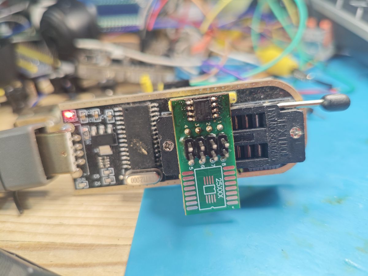

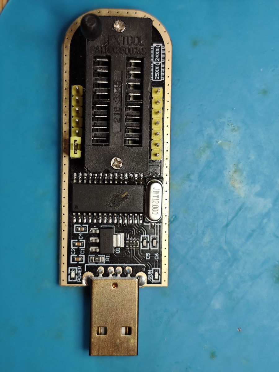

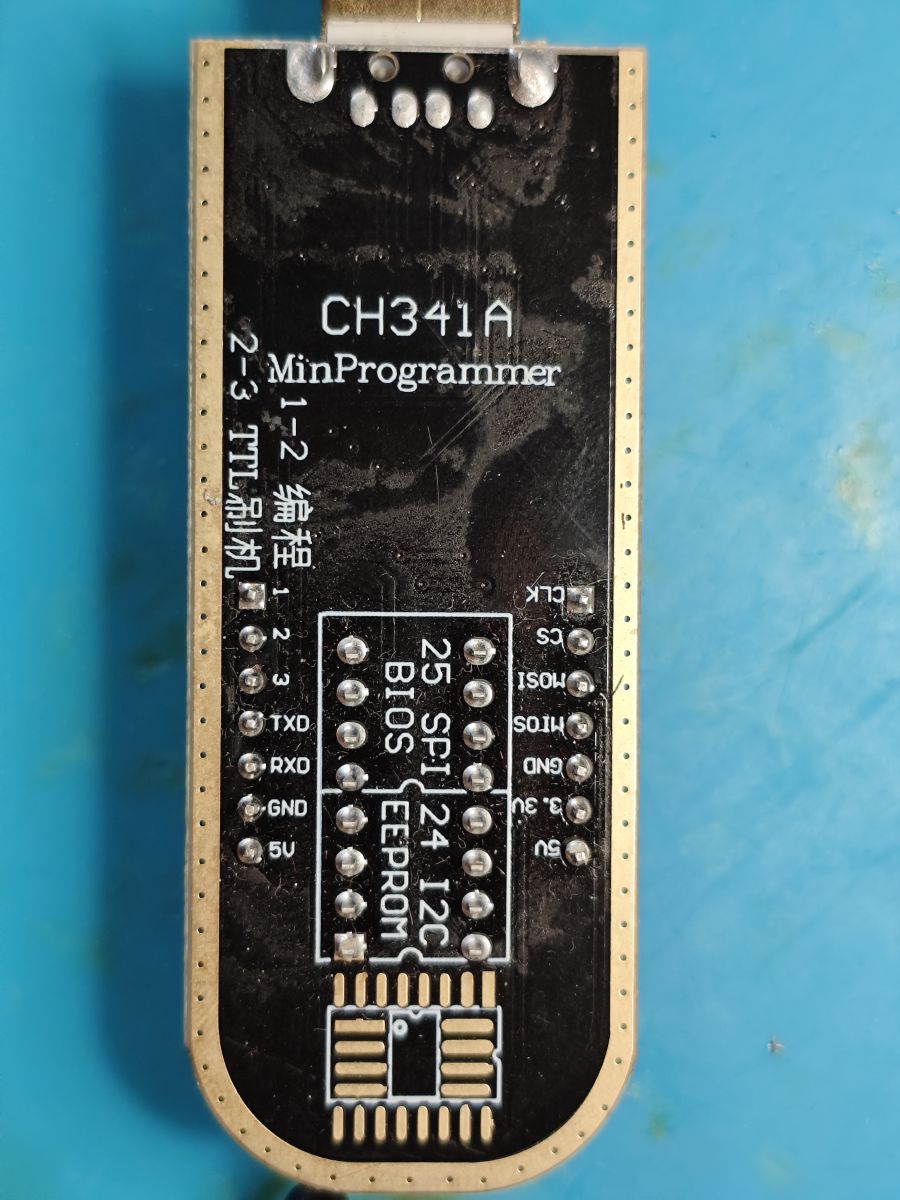

    yes, interesting OK. What does your exact CH341A look like? Ours identical?
    CH341A USB programmer with ZIF socket and pin headers on blue mat CH341A MiniProgrammer device for EEPROM chip programming
  • #266 21710002
    Posts: 14580
    Help: 654
    Rate: 12604
    Seems the same, just mine has some extra capacitors mods added so I can actually flash the chip I mentioned.
    ESP8266 module connected to USB programmer with capacitor Electronic module with USB connector and attached SOP16 adapter CH341 programmer with USB plug and labeled SPI/I2C memory pins

    divadiow wrote:
    Sp0828? Unsure yet
    yes. SP0828. I seem to be getting them more frequently. 320x240 is pretty lame. 640x480 is bad enough

  • #269 21711139
    Posts: 14580
    Help: 654
    Rate: 12604
    My Doorbell works with AIWIT APP, which is now missing from Google Play, but I managed to get APK from APKPure. I will also try if it works with @insmod dump.
    Anything else to try - any drivers, builds?
  • #270 21711150
    insmod
    Posts: 1388
    Help: 164
    Rate: 432
    It might not work though.
    My variant is XR872ET - simplified chip with no psram and less gpio.
    Flash chip - 25QH32DHIG. Backup was taken with AsProgrammer without any problems. I also used it to flash OBK.
    What is your camera module? I don't precisely know what mine is, but it says 7670 on it.
    Written on the back side of the board:
    MINI01-ET_MAIN_V2.0
    2023-04-07

PhoenixMC over UART Read/write on XF16/XR872 without opening some A9 units No desoldering; can restore stock dumps Custom builds may lose UART flashing after power cycle if console support is wrong
CH341A + SOIC8 clip Quick first dump attempts Cheap; widely available In-circuit reads often return bad IDs like 1313 or 8E8029
CH341A with desoldered flash Most reliable SPI backup/restore Stable verification; works with replacement chips Some flash chips still fail erase/write unless decoupling is added
Bus Pirate Usually poor choice here Can talk SPI/UART Backfeeds power and often fails chip detection

  • XF16 boot logs repeatedly report 240000000 Hz CPU, 40000000 Hz HF clock, and XRADIO Skylark SDK builds such as 1.2.0 Jun 20 2024 10:58:31 or 1.2.2 test builds, which makes the platform easy to fingerprint from UART alone. [#21219273]
  • The stock A9 XF16 camera flash is commonly 8 Mbit / 1 MB with IDs such as C74014 or 5E3214, while test replacements that booted OpenXR872 included 2 MB and even 64 Mbit chips. [#21522966]

How can I dump and restore firmware on an XF16 A9 minicam with a T25S80 or C74014 SPI flash chip using a CH341A, clip, or PhoenixMC over UART?
You can dump and restore XF16 firmware either over SPI or over UART. 1. For SPI, clip or desolder the 8-pin flash, then read it with a CH341A in NeoProgrammer, ASProgrammer, or EasyFlasher. 2. For UART, connect through the XF16 USB-routed RX/TX path and use PhoenixMC to read or flash without opening some cameras. 3. Always verify the dump and keep at least one known-good stock backup before testing OpenXR872. One contributor confirmed they clipped directly onto the flash and did not need reset mode first. [#21278253]
Why do some XF16 A9 cameras report strange SPI flash IDs like 1313, 8E8029, C74014, or 5E3214 when reading the flash in-circuit?
Those odd IDs usually mean the in-circuit SPI read is unstable, not that the chip is truly changing identity. The thread showed 1313, 8E8029, and then stable C74014 on the same 1MB camera, while a desoldered read later became consistent and verified correctly. Shared power rails, leakage from the rest of the board, bad clip contact, and marginal CH341A supply decoupling all caused false IDs. A clean off-board read or UART dump was much more trustworthy than an in-circuit first pass. [#21522287]

Why did OpenXR872 boot on a 2MB flash chip but initially fail on the stock 1MB flash chip in the XF16 A9 camera?
It failed because the early image layout still assumed space beyond the stock 1MB boundary. The same OpenXR872 image booted when the original dump was transplanted to a 2MB flash chip, but not on the original 1MB flash. That exposed a layout problem rather than a CPU or sensor problem. The boot logs showed image max size is invalid and missing XIP section errors on the 1MB setup, while the 2MB chip could tolerate the oversized placement. [#21525075]
How was the 1MB XF16 boot issue solved by changing the OpenXR872 image configuration and OTA header placement?
The fix was to shrink the effective image layout for 1MB flash and move the OTA header out of the failing location. First, contributors rebuilt with max_size around 880K. Later they proved that a no-OTA image booted on 1MB stock flash, then refined the layout so the OTA header sat at 1020K with 4K size instead of the breaking 1024K arrangement. After that, 1MB XF16 boards booted OpenXR872 normally. As one post put it, “ota was the problem.” [#21530564]

Why do some SPI flash chips like TJ25Q08M, T25S80, or 25QH32CHIG fail erase/write verification in NeoProgrammer or EasyFlasher unless extra capacitance or special handling is used?
These chips appear unusually sensitive to supply stability during SPI writes. The thread documented random verify errors, partial writes, and false erases on desoldered chips until extra capacitance was added directly on the CH341A setup; after that, the same chip verified cleanly. One test with a 25QH32CHIG failed repeatedly, then passed once a capacitor was added across the supply. Some users also had to experiment with protection-register handling, but the strongest repeated fix was better decoupling on the programmer side. [#21709832]
