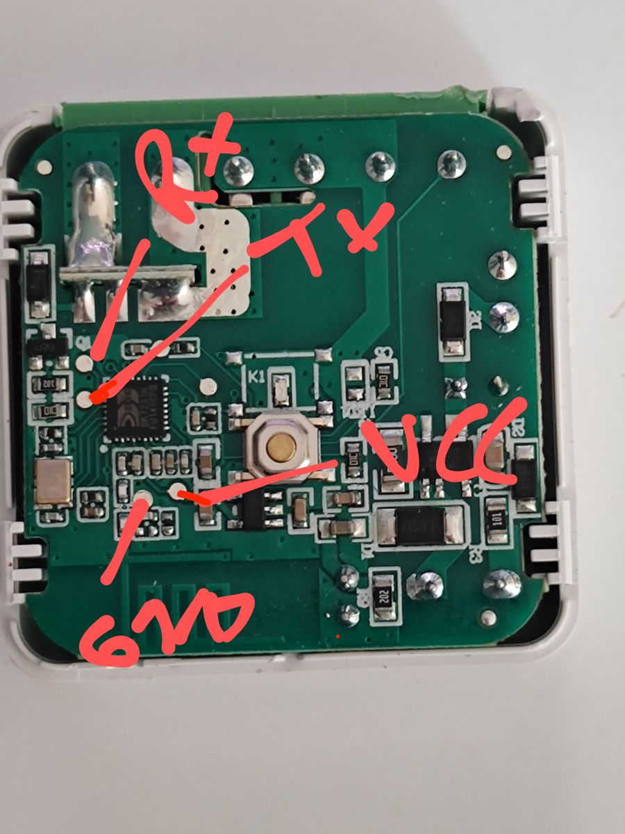

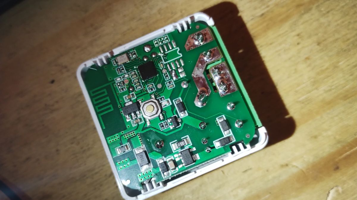

  • Working BK7231N pinout for DIY mini switch
    #36 21109527
    donut343
    Posts: 18
    I had two of these chips from different vendors in the "My Choice" section, both labeled as DIY Mini Smart Switch. Like others mentioned, I used the below pins to solder since it came with 1.3.10 firmware; I wasnt able to extract GPIO pin layout with the tool, the software failed there, but writing was fine. Below layout worked for me:
    - Pair/Toggle All Pin on P23
    - WiFi LED on P26
    - TglChannelToggle (channel 1) on P6
    - Relay (channel 1) on P7
    I accidentally desoldered a capacitor (https://www.elektroda.com/rtvforum/topic4056582.html) but havent run into issues so far
    Image of a circuit board with GPIO pin labels written in red.

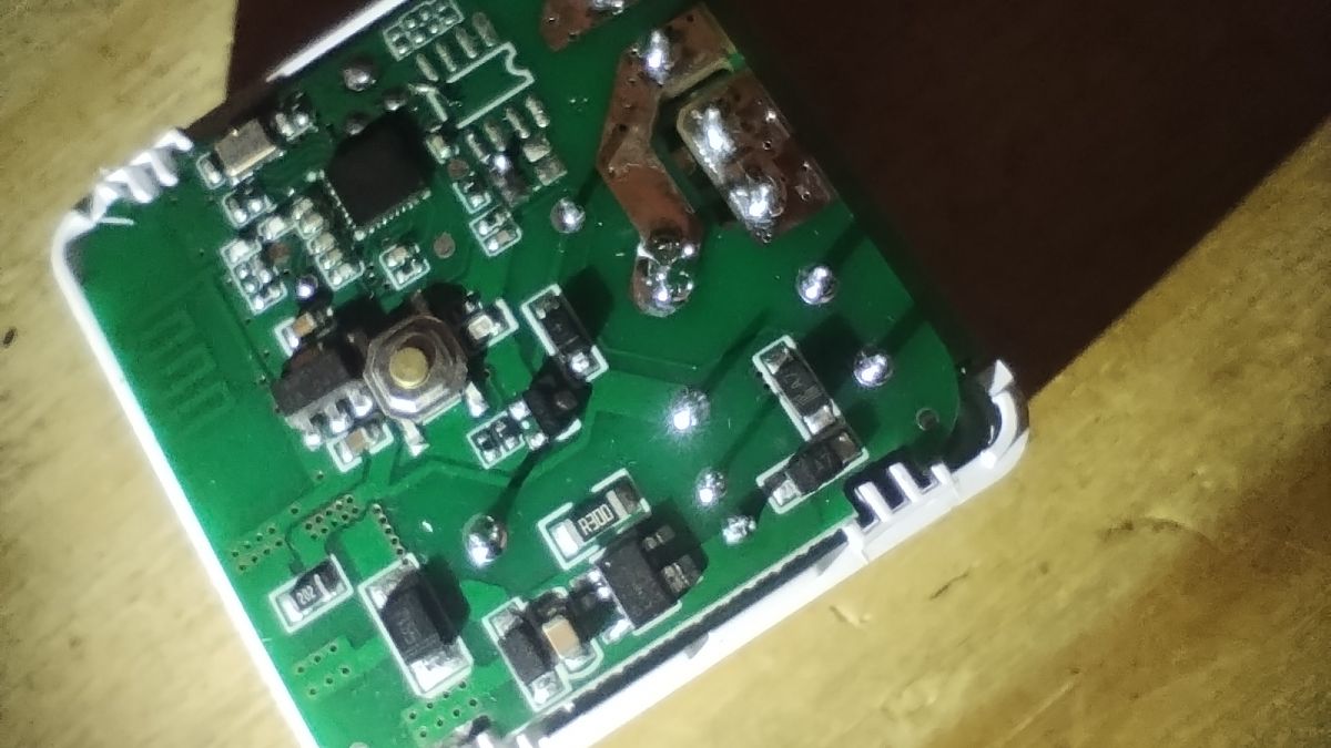

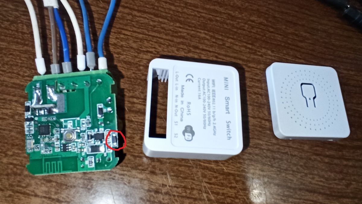

    bbv18121970
    Who has this type of board, tell me what kind of SMD part and what kind of marking?
    Printed circuit board of a mini smart switch with a highlighted SMD part.

    >>21285993 Sure, please share, you can also share 2MB flash backup if you made it without pairing it with Tuya.
    >>21197010 I would suggest finding the datasheet of the power supply IC and checking there.

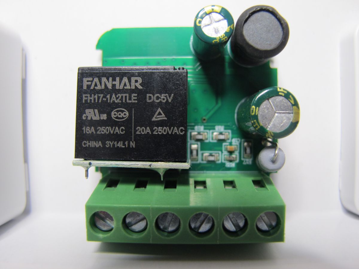

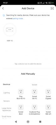

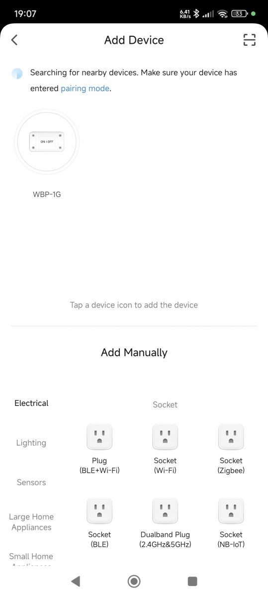

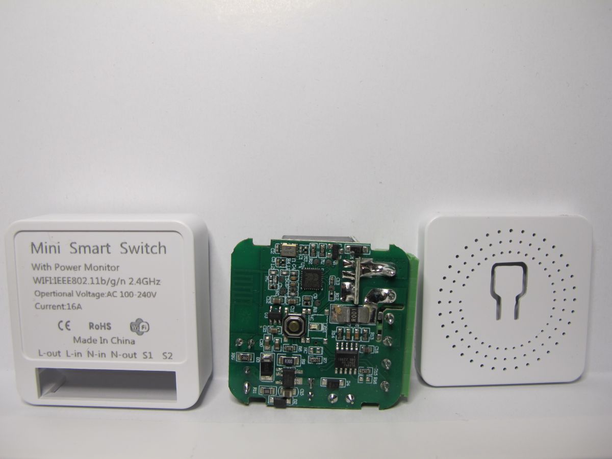

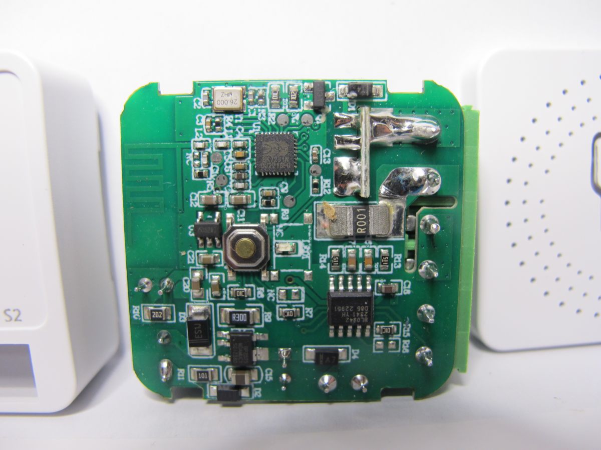

  • BL0942 power monitoring identified on BK7231N switch
    #50 21325656
    Posts: 5216
    Help: 448
    Rate: 917
    >>20737346
    yet another. but this one has power monitoring and it's a BL0942
    Mini smart switch with power monitor and visible PCB PCB with FANHAR relay and capacitors. Close-up view of an electronic device's circuit board with components.
    still 1.3.10

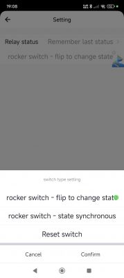

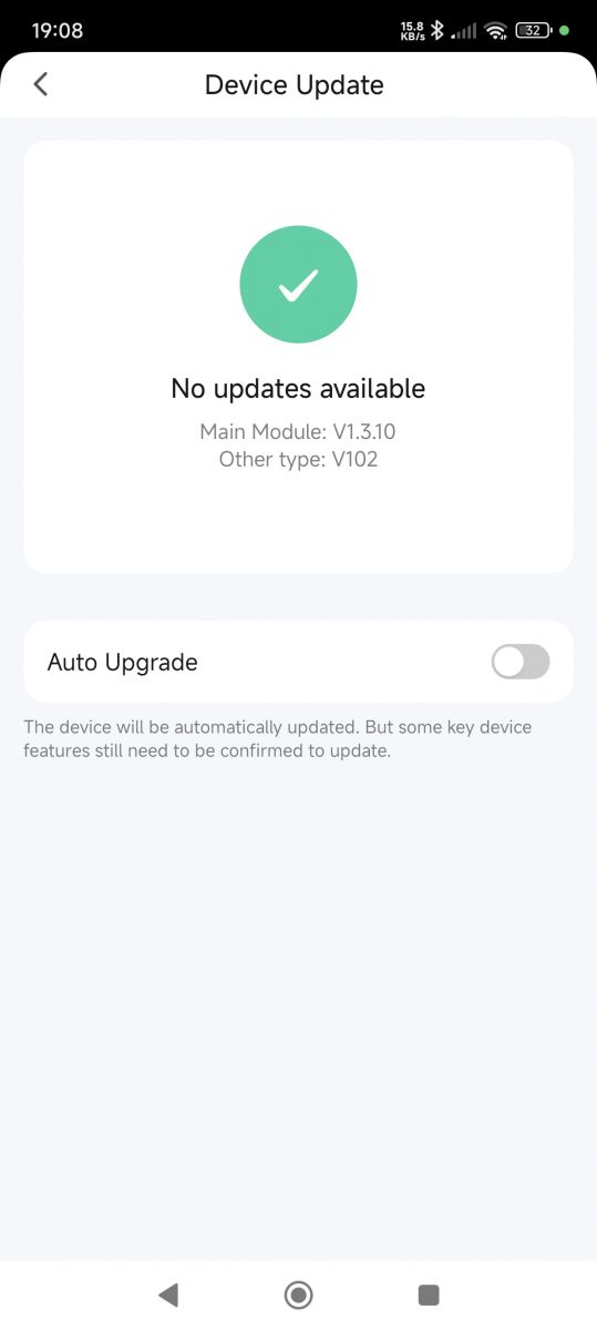

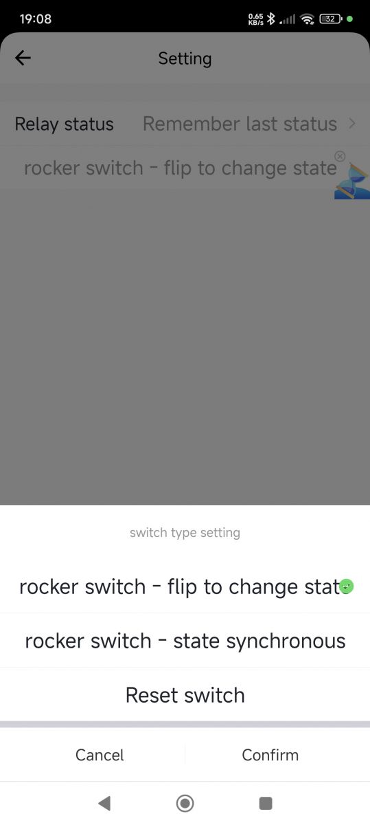

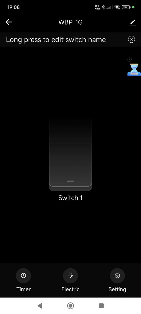

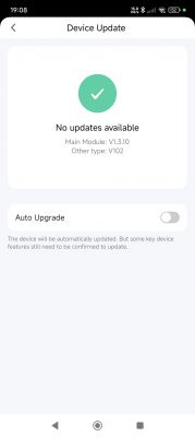

    Add device screen with the WBP-1G option selected and various socket types to choose from. Device update screen indicating no updates available. WBP-1G app interface with switch name editing feature Settings screen of an app for configuring switches with a reset option.
    and the OBK template:
    • readResult_BK7231N_QIO_2024-29-11-19-00-28.bin (2 MB) You must be logged in to download this attachment.
