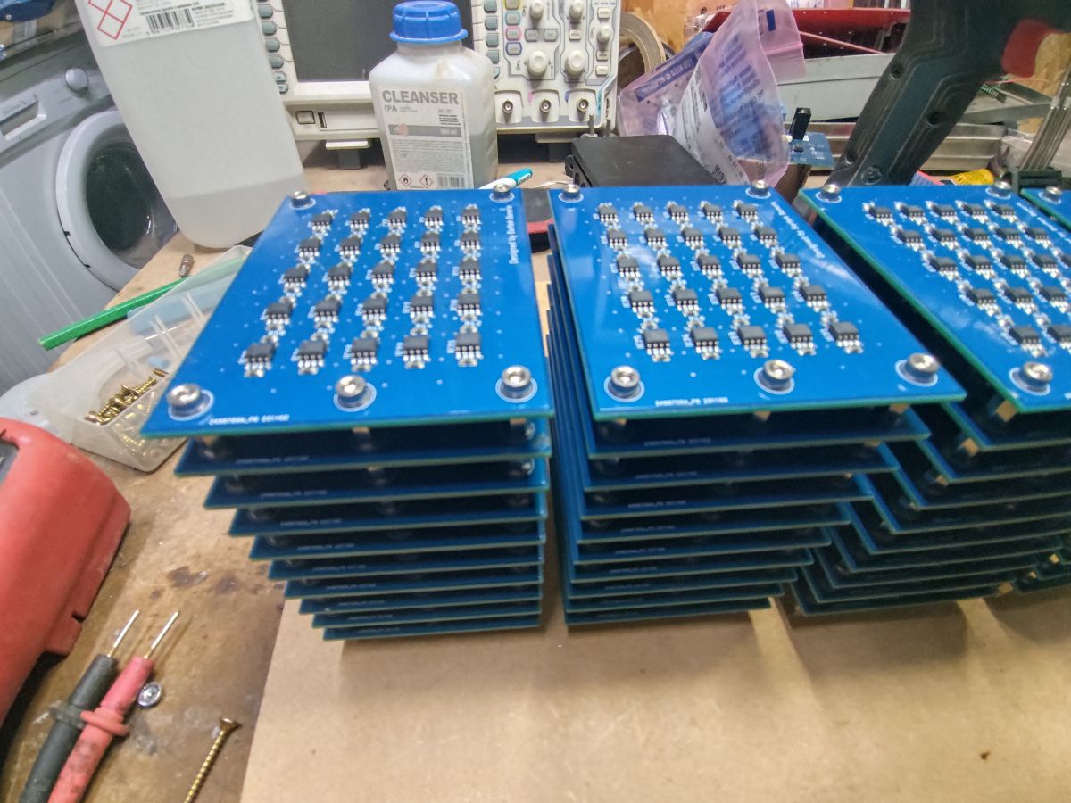

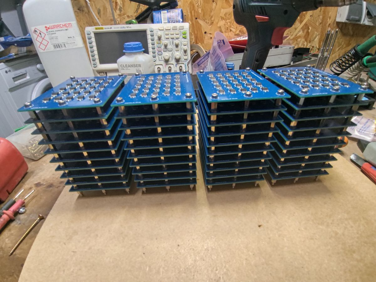

  • High current draw and overheating concern
    #73 20840893
  • #74 20841073

    w3501yyyy wrote:
    A block of 250 TL072 units connected in parallel, a total of 500 amplifiers, consumes 1A of current when powered by +-18V.
    Just enough? And maybe not more?
    And that's only at rest. When you drive this, the demand will be even greater.
    I power my "baby" (probably only 140 WO in total) from a 100W transformer.
    I signaled that it was heating up :)

    AVE...
    With 250 TL072, the maximum quiescent current can be up to 1.25A. The minimum is 625mA. 1A is a good result. Fortunately, with typical speaker impedances and this supply voltage, the maximum power consumption will not increase significantly above this value. For a speaker with an impedance of 4Ω, the maximum power will be approximately 30W. This means additional current consumption of ~840mA per channel. A transformer for such a stereo amplifier should have a current efficiency of ~4.1A and a power of ~150W, with up to 90W dissipated in the ICs in the idle state. It'll be warm...

    Urgon
    Posts: 7294
    Help: 197
    Rate: 2636
    AVE...
    Well, in such a scenario you will need a transformer of at least 400W, but the output power of the amplifier will be 110W per channel into 4Ω. It will definitely be an interesting construction...
  • Power budget and transformer sizing for 100 W amp
